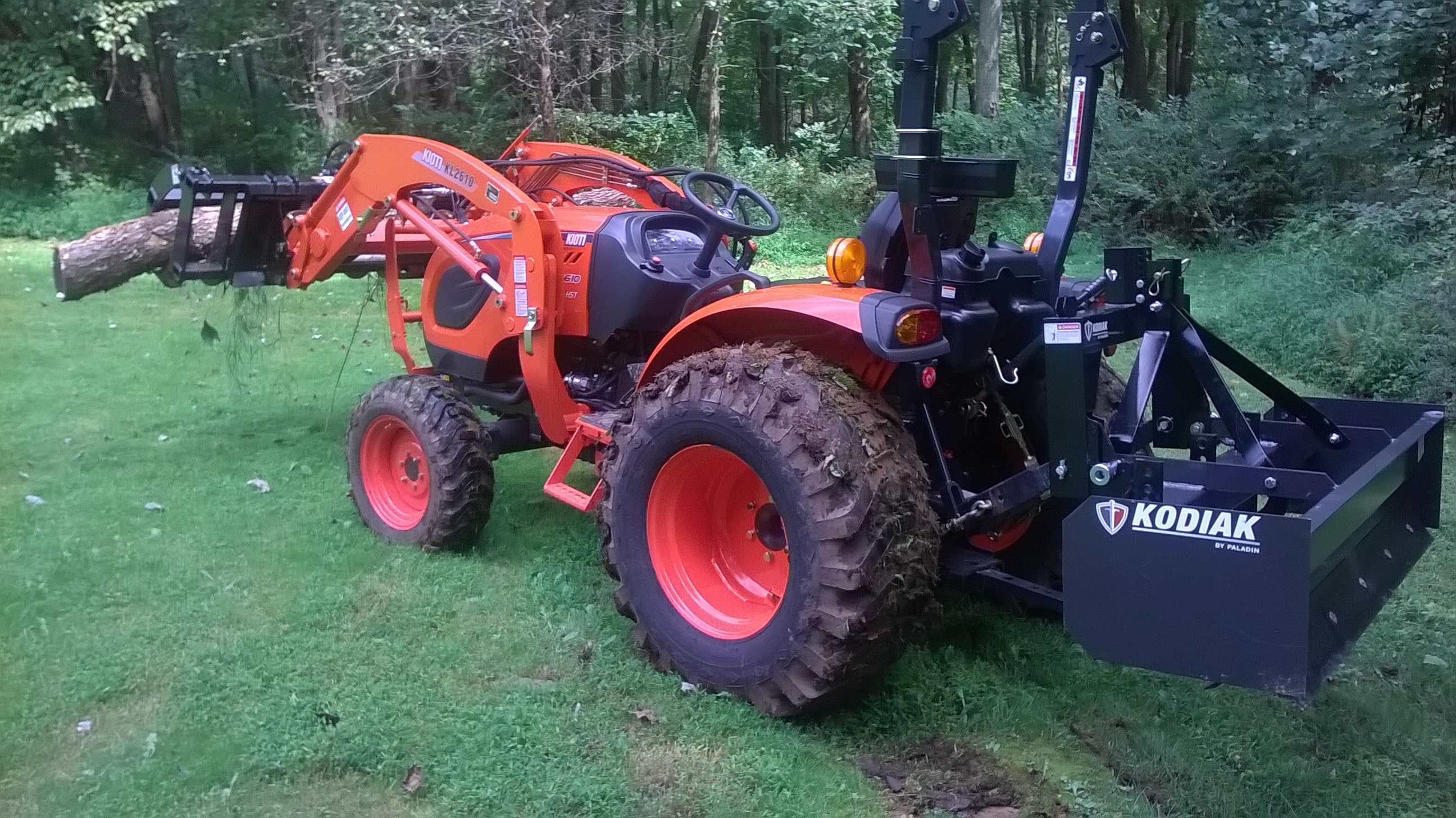

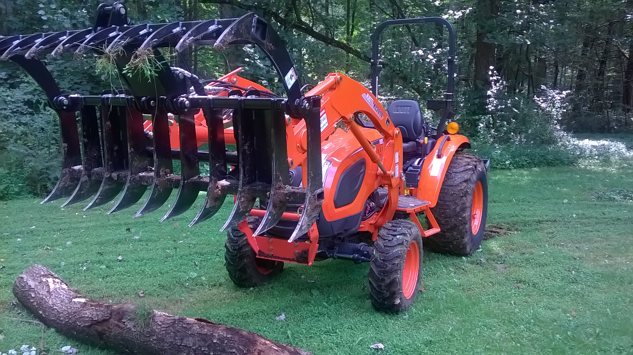

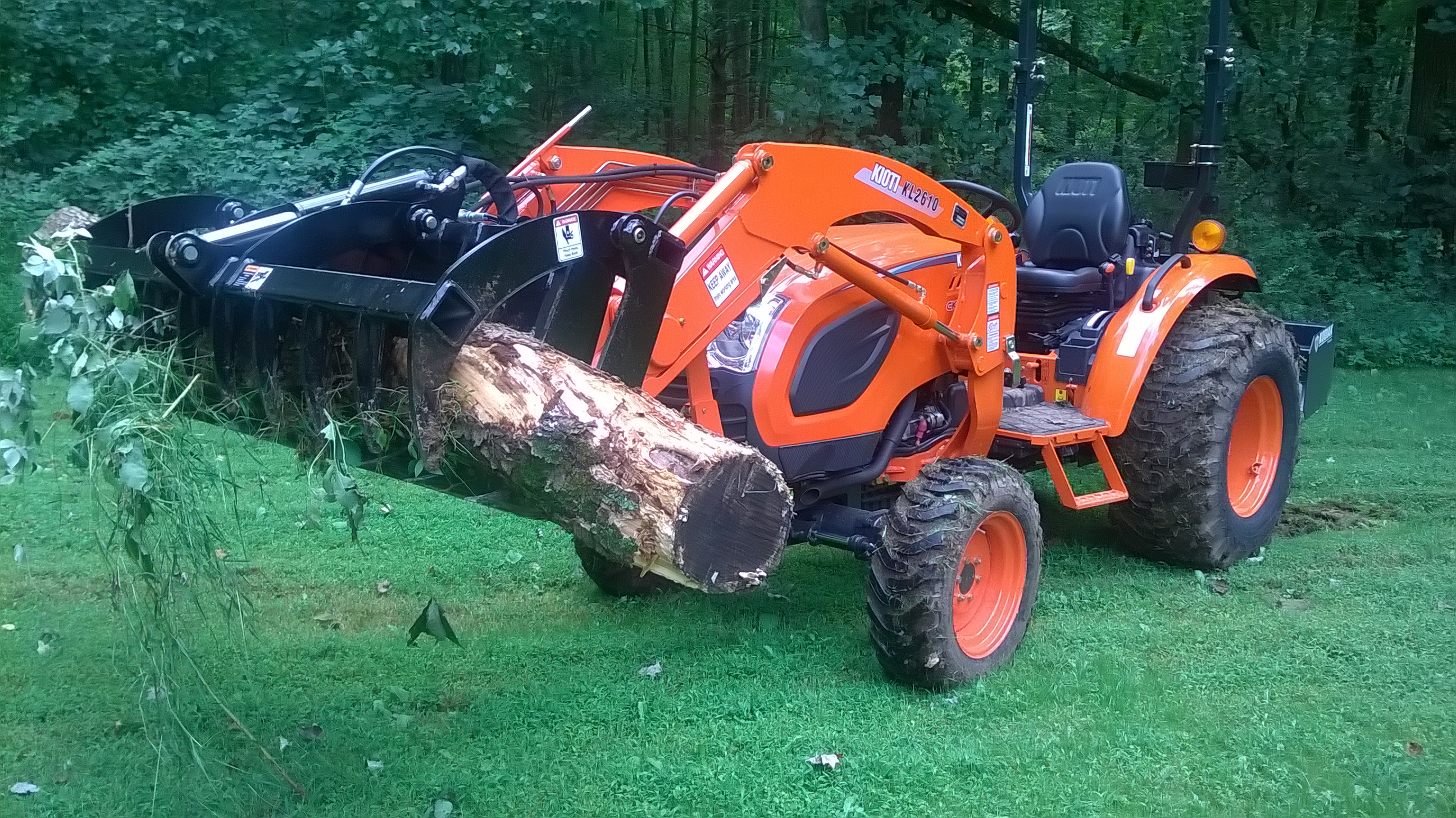

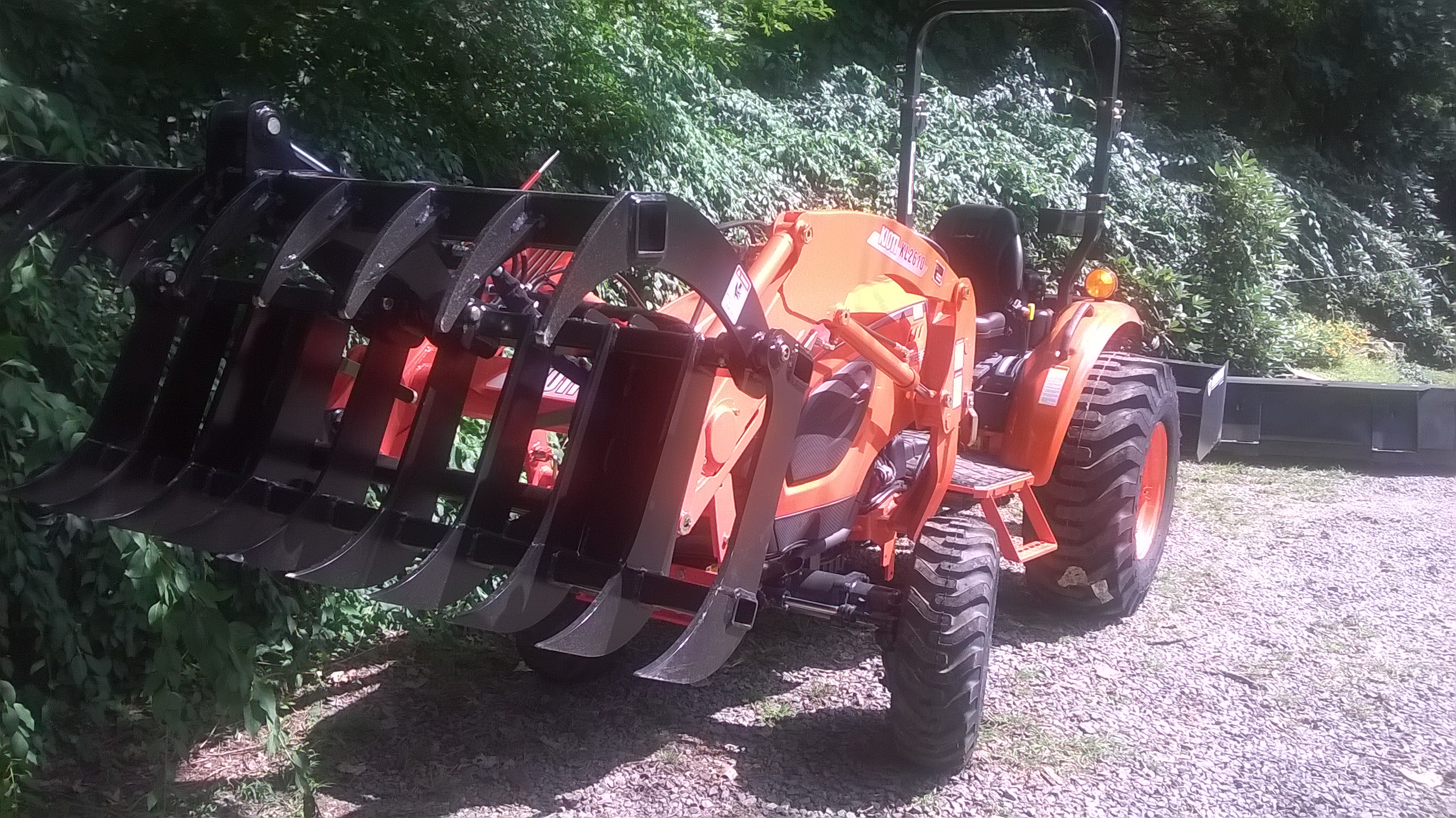

Well i have been busy playing with it the last few days. Learning a lot. Clearing the back woods. I was incorrect - it is the brush hog that is on back order, not the grapple. Probably a 48 inch might have been better but the die is cast. So far, I am happy with it. So here are a few picks.

I am going back out there as soon as the sun comes up. Talk to you in a couple days :)
