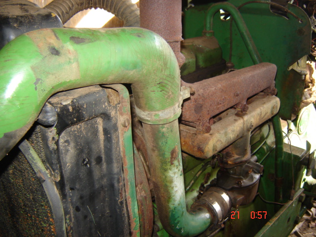

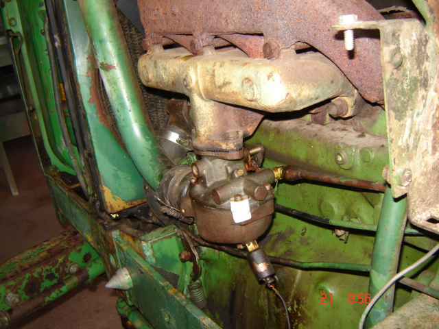

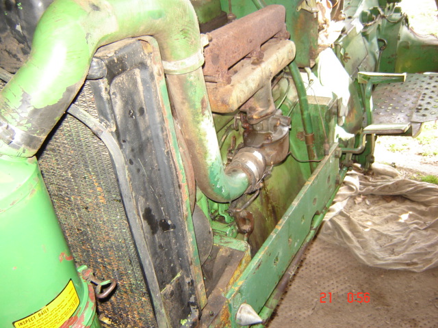

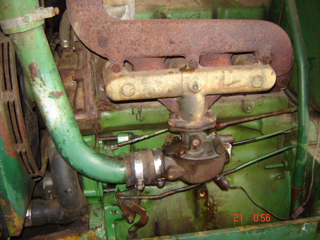

Here are some of the pictures of the tractor, the carb. manufacturer is Scribner.
This is what I have done since the last post. 1. Drained carb.(no water, fuel clean) 2. installed in line filter on opposite side of carb. just before the the
fuel pump (pic. did not come out, ) 3. Drained and cleaned fuel tank ( looks good) 4. Breather cup was cleaned and filled w/ new oil (not to dirty, but old )
I started the tractor with the breather hose off and it had some powerful suction, more so than any I have encountered in the past on other tractors, I don't know if this is good or bad, anyway I did squirt a few shots of carb. cleaner into the carb.
I believe the tractor is running better, however, I'm going to replace the plugs again since they have become sooty. With the new plugs I will be sure
I have covered all bases.

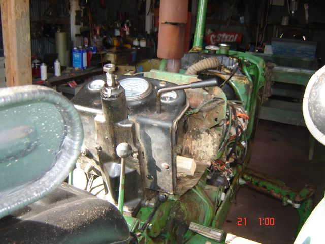

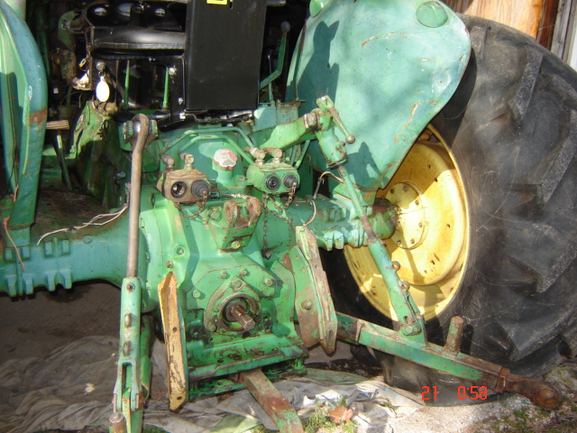

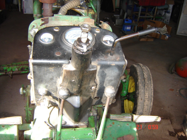

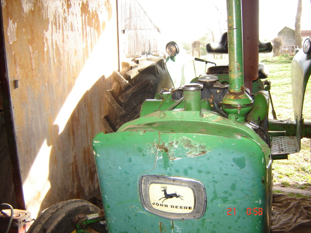

I noticed that the fuel pump is very similar to a diesel except it lacks the lift arm. I also added some pictures of the tractor in it's tear down process,
you may have noticed where I had to cut the old steering wheel off , first time I had to do that.
It's a shame this is not a diesel as it came from the factory with dual remotes which was a definite option back then as well as P/S ..
The tractor was stored inside a garage in Iowa for approx. 4 years, the gas had been drained before storage, this may have something to do with
it's problem, also we changed all the fluids and filters before we ran it for any length of time.
Well sir if the plugs take care of the problem I can continue tearing down the rest of the tractor and make it look new again. I'll show you the end result when finished.
The tractor is a 1971 with 3341 hours on a working tach, I'm not sure what type of gas was used.
