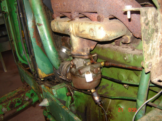

OK! Now I have a better idea what you're dealing with:eek::confused2:
For the moment forget about adding a fuel filter in line to the carb. I'd break out a can or two of PB Blaster or whatever you use to loosen up stuck/rusted stuff and hit every bolt and clamp near the carb and especially where the carb attaches to the intake manifold. Then at the end of the intake tube feeding the carb go to the bottom of where it says inspect daily or once per century, and undo the clamp and carefully take the oil bath pan and dump its contents into your neighbor's stream, so it flows toward his house:shocked: Just kidding- dump it into a container of waste oil to get rid of later on.
Then see if in fact there is an element of some sort in the big canister above the label I spoke of earlier. I'd go to your favorite JD dealer's web site and with your model, serial number and such search for a kit to rebuild your carb. And get an intake manifold gasket too in case you need to replace the one you have already on there.
The rubber hose between the carb and air cleaner tube will also likely need replacing, but not necessarily. You want to find parts available BEFORE you take the carb apart to clean it. All the brown gunk on the outside of the carb is varnish from gas leaking, and dirt too.
I noticed a solenoid looking thingy stuck into the carb near the back, with a wire barely attached to it. You should be careful not to break the connection to that sensor. I'm not sure of it's function yet but I can say it is most likely crucial to the carb running properly.
I need to know what year this tractor was made, and whether it ran on leaded or un-leaded, how many hours on the clock, etc.
Gimme some history!:confused3: Please.:)
Do you have a service manual or anything like that?
Can you tell me where the wire on the sensor runs?

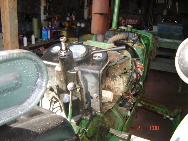

Good pics. Let's have some more of the wiring, fuse block?, anything that might proove useful.
What's the jumping deer insignia on the front grille for?:D

What is the solenoid thing at the bottom of the carb, near the rear, supposed to do for you?
How often do you find you need to adjust the timing/dwell, and valve train on these puppies?
Is there no fuel filter at all on these models? And what grade of gas do these tractors run well on?
Do the floats in the carb ever fill with gas and need replacement. I suspect they are metal right....

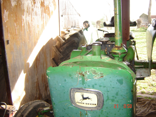

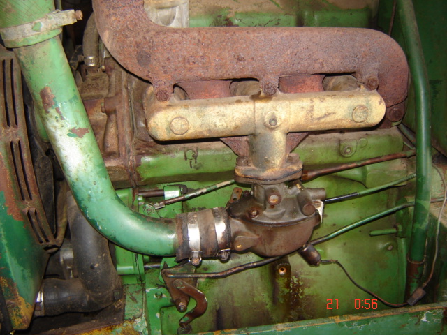

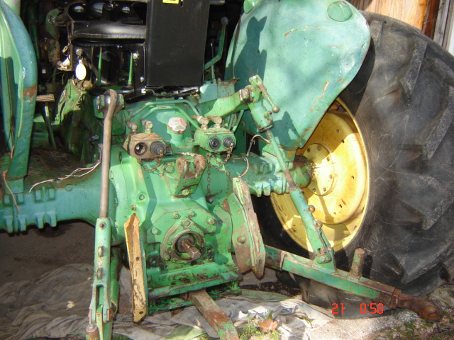

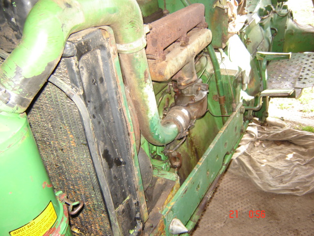

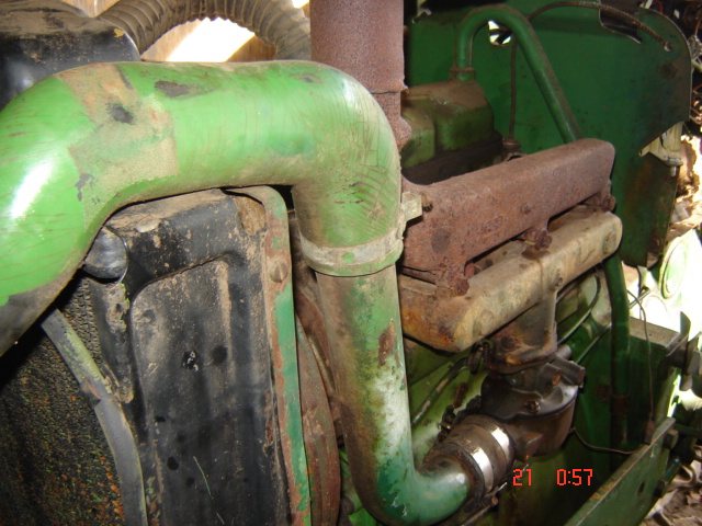

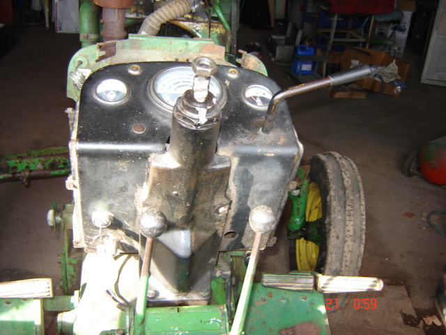

Here are some of the pictures of the tractor, the carb. manufacturer is Scribner.
This is what I have done since the last post. 1. Drained carb.(no water, fuel clean) 2. installed in line filter on opposite side of carb. just before the the
fuel pump (pic. did not come out, ) 3. Drained and cleaned fuel tank ( looks good) 4. Breather cup was cleaned and filled w/ new oil (not to dirty, but old )
I started the tractor with the breather hose off and it had some powerful suction, more so than any I have encountered in the past on other tractors, I don't know if this is good or bad, anyway I did squirt a few shots of carb. cleaner into the carb.
I believe the tractor is running better, however, I'm going to replace the plugs again since they have become sooty. With the new plugs I will be sure
I have covered all bases.
I noticed that the fuel pump is very similar to a diesel except it lacks the lift arm. I also added some pictures of the tractor in it's tear down process,
you may have noticed where I had to cut the old steering wheel off , first time I had to do that.
It's a shame this is not a diesel as it came from the factory with dual remotes which was a definite option back then as well as P/S ..
The tractor was stored inside a garage in Iowa for approx. 4 years, the gas had been drained before storage, this may have something to do with
it's problem, also we changed all the fluids and filters before we ran it for any length of time.
Well sir if the plugs take care of the problem I can continue tearing down the rest of the tractor and make it look new again. I'll show you the end result when finished.
The tractor is a 1971 with 3341 hours on a working tach, I'm not sure what type of gas was used.
Yes sir, I can take some pictures of the wiring from the solenoid to it's end and the fuse block as well.

Solenoid on bottom of carb is supposed to be an anti-dieseling device. Float is metal but can develop a hole in it to hold gasoline. Be sure and check parts key #18(strainer) for trash. It's unusual to see a utility tractor that age with dual scv's(rear remotes).
