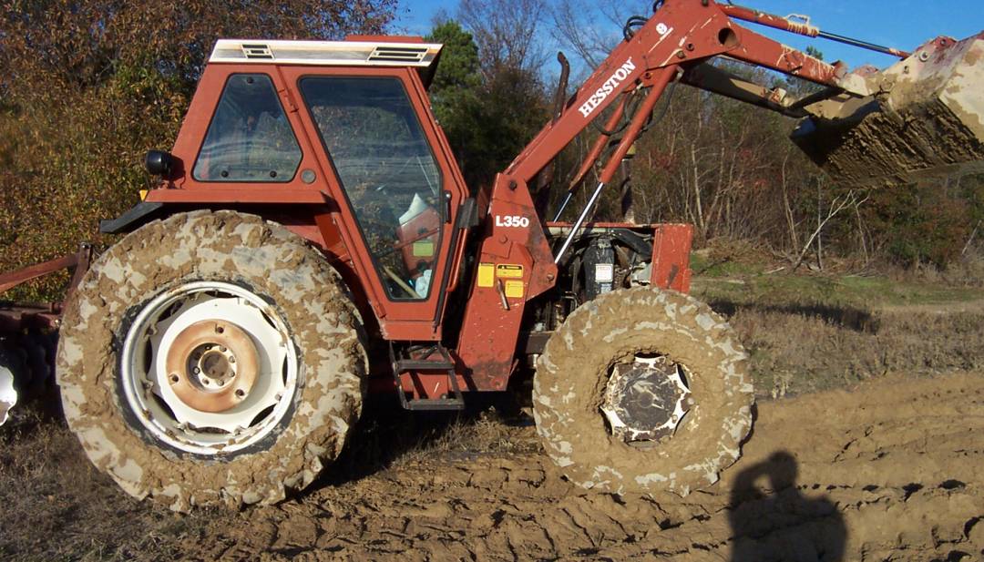

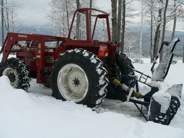

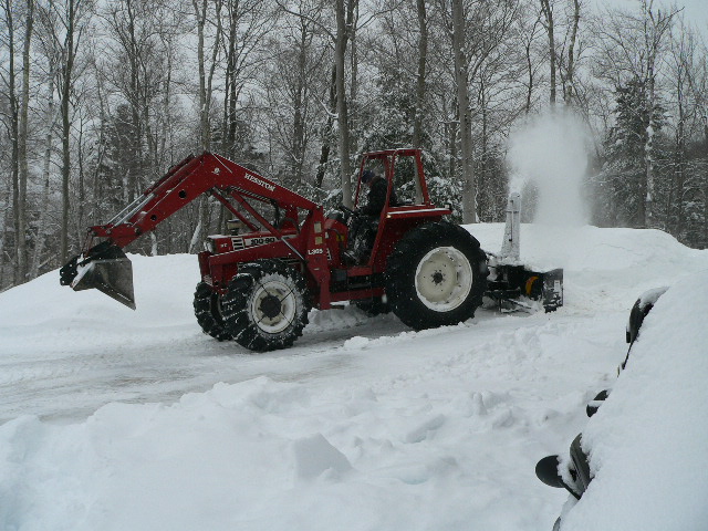

Who has one? I know JayDavis has a 90 90 DT and I have a 100 90 DT.
I wonder who else has one.
here is are a few pictures of mine.

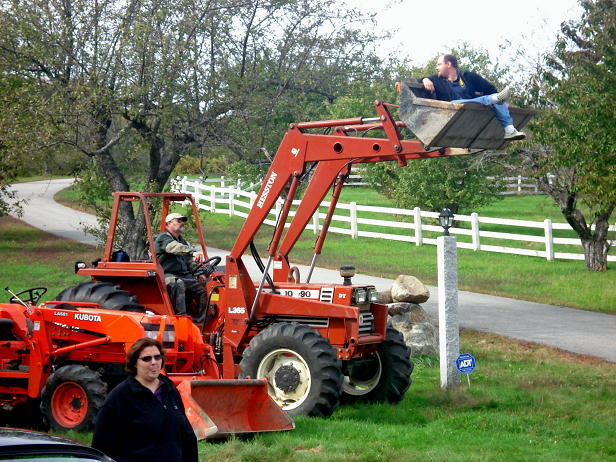

I have one, a 90-90DT as Dead Horse said. I think it is an 86 model. Not too sure on that. The first two pictures were taken before I found where my grandfather hid the front and side panels for the engine compartment.

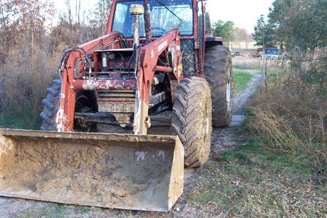

The last picture is of another Hesston I stumbled upon on one of my motorcycle rides. Saw it in a hay field so thought I'd ride up and take a pic. It has obviously had a hard life. Seems to be a 100-90 as well.

I work mine pretty hard for a weekender. Mowing all summer long, logging for firewood late summer, fall and winter as well as snow removal all winter.
For what it gets done it is cheap to run. It has been very reliable. Has 2350 hours on it and I have replaced a waterpump and an alternator.
I am very happy with it.
I bought a used Farmi 601 and have been logging with it the last two weekends. I it is a perfect match for the tractor.

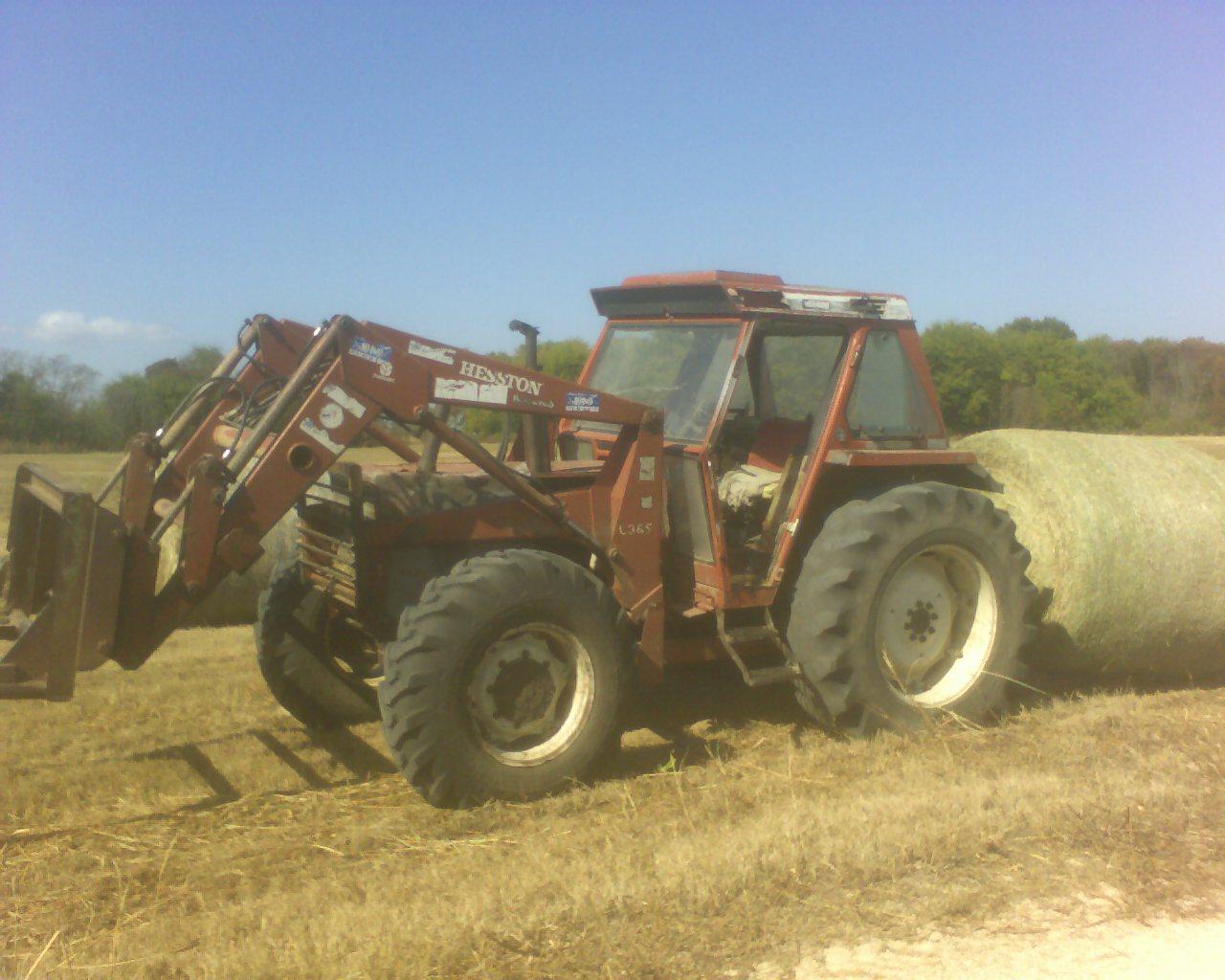

You can see in the picture that the front axle under the 100-90 is the same as under the New Holland TM series.
