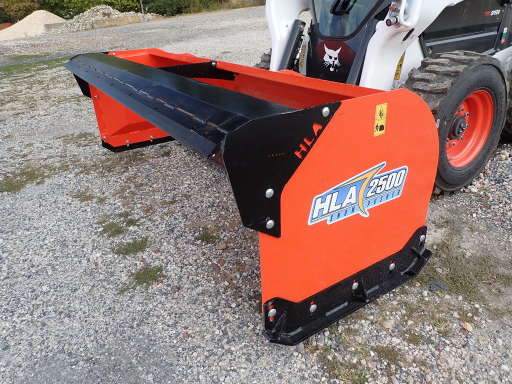

I don't think it would be that hard to fab up a back drag setup, but it would probably have to be a little bigger than just an edge. The top of the pusher is quite a bit further back than the leading edge. The back drag kit is the whole top black part in this pic (not my setup):
They advertise it as fully boxed in so that you have more back dragging capacity. Wether that really matters or not, I don't know.
As far as the chains/springs, what I was thinking wouldn't be so much a trip setup but more to support some of the weight of the pusher and FEL arms when I put the loader into float. Basically, so that some of the weight still hangs on the tractor rather than a full float. Currently, with the weight of the pusher and FEL arms riding entirely on the ground, there's very little weight on the front tires. Not a huge deal, but it would be nice to replicate how they use pushers on big wheel loaders.

Oh yeh, I see what you mean, the box doesn't have enough curl for that top edge to act as a scraper, so the back drag bar would have to jut out more.

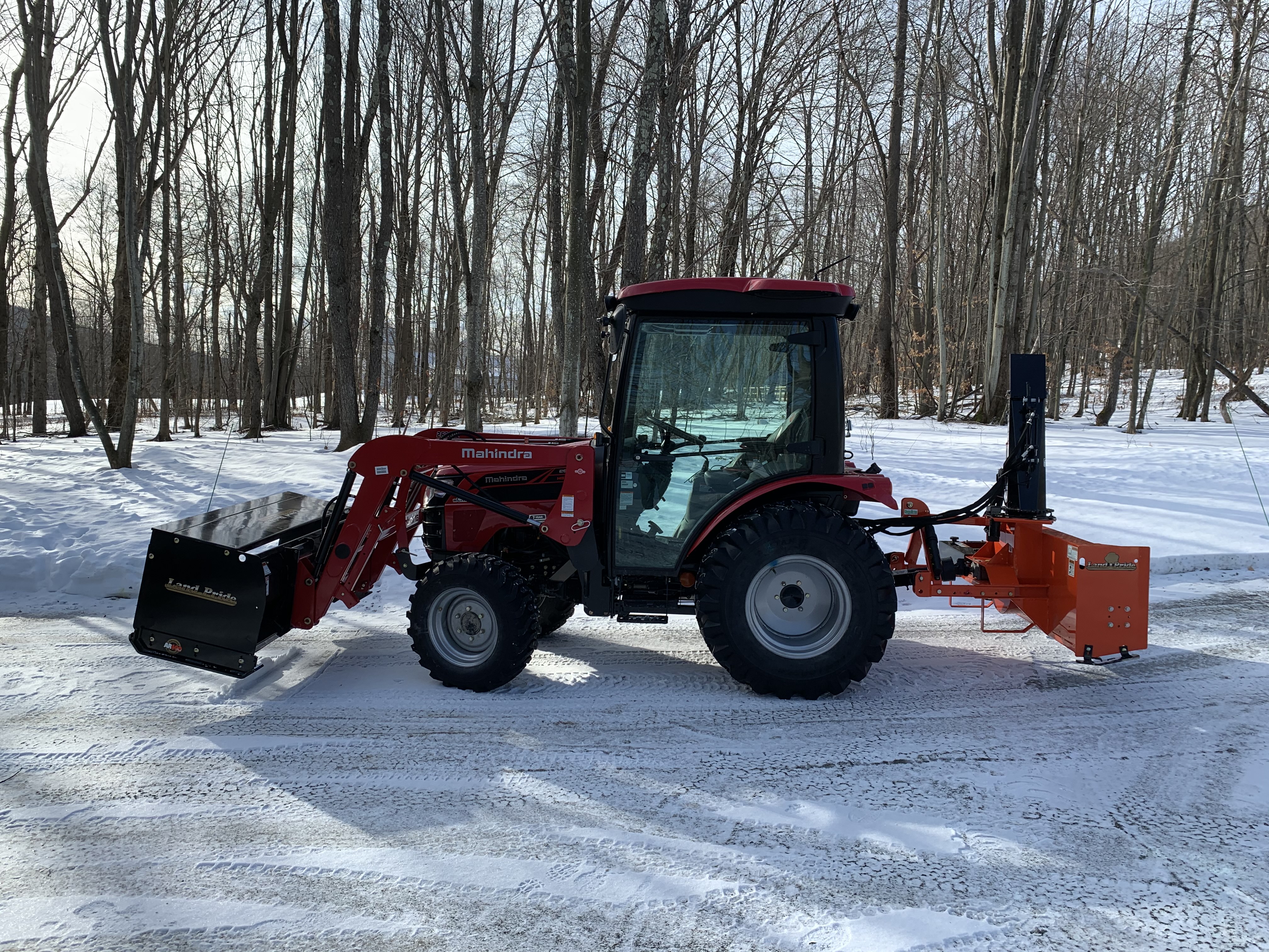

I have a Mahindra 2638, I use a snowblower on the back, and a snow push out front. The push box is 72" and I can push a good amount of snow. I find anything over 8 inches really slows things down on either end though.
Snow Push pros:
1) Can clean entrance by road right to pavement (rest is stone) when county plows mess it up
2)I get right up to areas I cannot snowblow, and can tilt my bucket completely for a steel drag edge to pull it back to an area I want to use the blower on.
3)That same steel edge allows me to scrap down ice/mush build up the driveway that can happen on warmer days when things thaw before they refreeze.
4) I can still push back snow banks and move piles around even though my buckets off
5) For quick clean ups, I can use it as a plow
There really aren't any cons, its just makes the machine a bit long IMO, but thats not a big deal. With a snowblower I think its a great option.
Link to my box:
