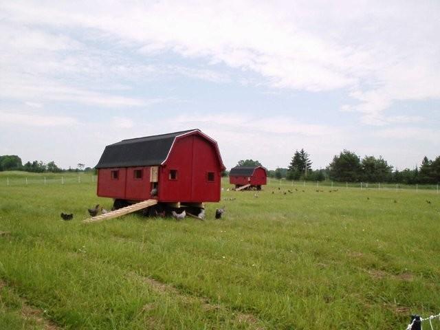

Most farmers around here have multiple tractors, and each is used for certain tasks. With only one tractor, I don't have that luxury. When my tri-ribbed front tires finally gave out on my tractor, the farmer next to me suggested used truck tires. Cost me $50 for the changeover, and that included the $5 per tire disposal fee. Bear in mind, though, that I primarily use my tractor to maintain pasture with my rotary cutter for my poultry operation. I'm not on the fields when it is muddy.
