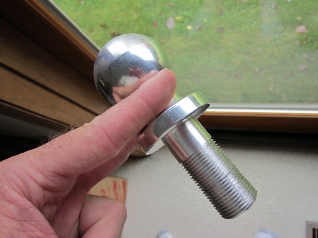

I made the ball and hitch on my home made dump trailer...
I was working at a tool and die shop and the owner was very generous letting employees come in Saturday mornings for personal projects...
To save weight, this 2" ball is made of aluminum.... :LOL:...no.....just used aluminum to prove out cnc program before using expensive stock.
Nice!
I know this was in jest, but many of those drop hitches are made of an aluminum or aluminum containing alloy
Considering the stress to yield properties of aluminum I don't know that I'd be thrilled about owning one of those...
