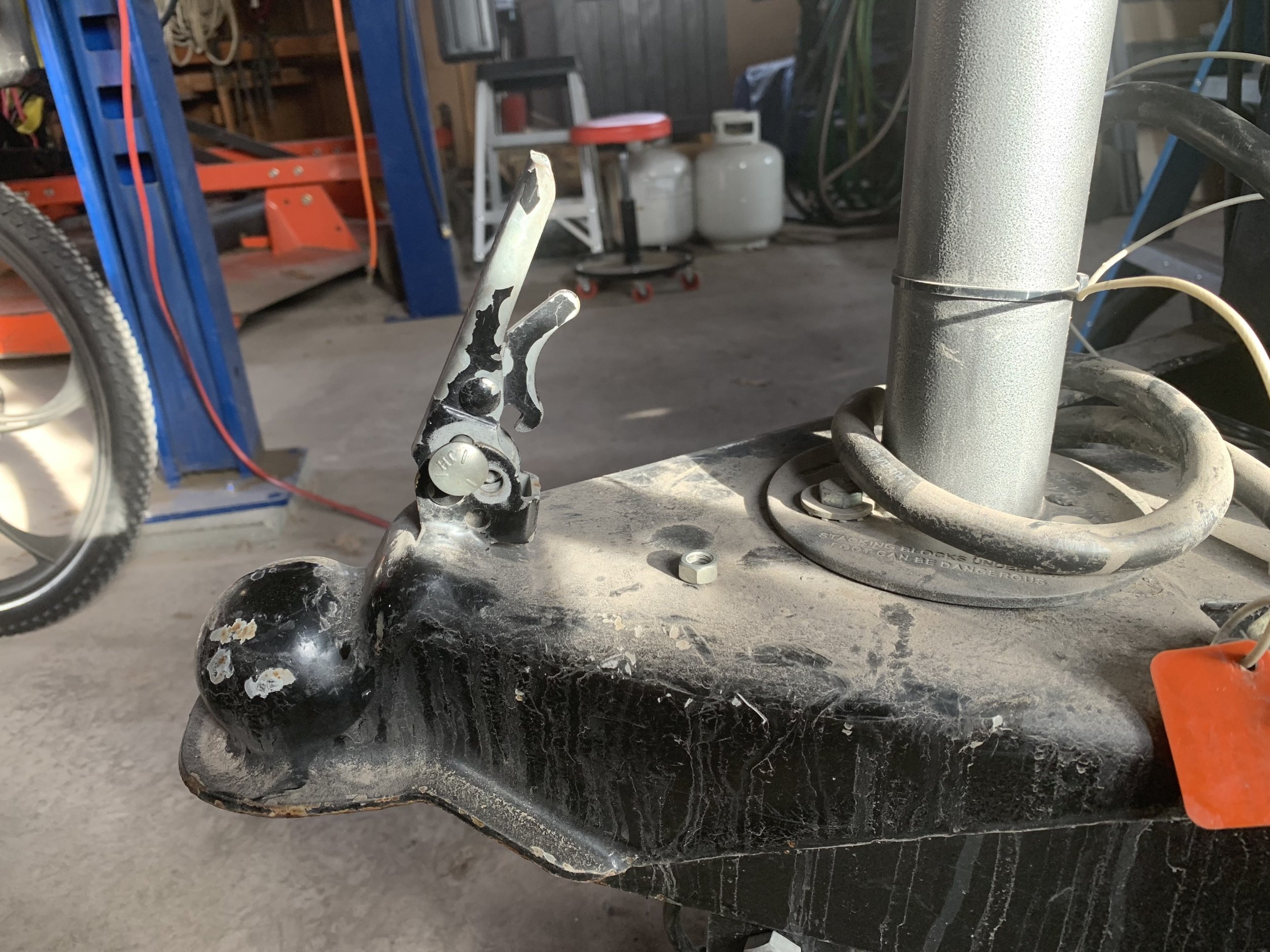

Agree....something sure isn't working like it should. The OP should lay on his back and take a good look at it from below.
Not particularly with 7,000 pounds of trailer above him on a hill.
However, it would be worthwhile to give it a gander once unloaded and in a safe location. Practice with the trailer when empty.
I do have to disconnect my trailer with a load on it from time to time. However, I also use the trailer attached to the pickup to help control how the trailer will react to various forces. Unloading, working on tires, etc.
   / Hitch ball / coupler near disaster
#32
I will do that when I get home. I do have the trailer unloaded now.
btw, I have a Big Tex equipment trailer (same mfgr) and often face identical issues. Seems I am going to need coupler maintenance or replacement.

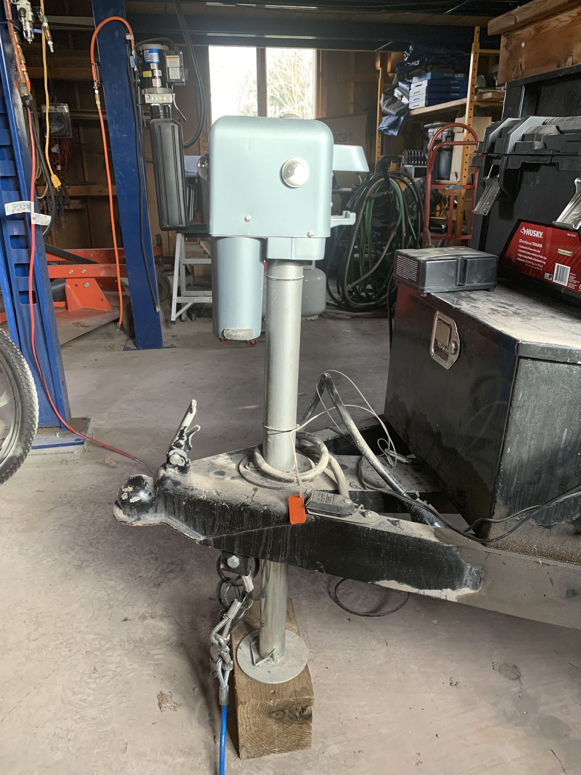

I've been plagued by the same problems releasing the hitch on my 10K dump trailer for many years.
The hitch appears to be similar to the one described by the OP.
I minimize the problem by keeping the coupler well lubed as others have described. I also use the smallest hitch ball with the correct weight rating for my 10K trailer. Dropping even 1/8" in size can make a big difference.
Usually, raising and lowering the trailer jack with the wheels chocked, the tow vehicle in neutral and emergency brake applied, does the trick.
Finding that release point by raising & lowering the tongue can be a hassle. This electric jack, powered by the dump trailer battery, makes the process a snap:
When all else fails, removing the hitch pin and driving the tow vehicle forward is necessary. Make sure the trailer wheels are chocked first.
Whoa... never heard of anyone running any ball size other than the one stamped on the coupler, and would think that has got to be a little dangerous.
When folks were spreading love all over bulldog couplers a few pages back, I didn't mention that the first bulldog coupler I ever encountered was on one of my grandfather's utility trailers, and after so many years of use, was somewhat worn. I saw the damn thing pop off the ball twice in use, a correctly-matched size ball at that.
I would think running any ball other than the size stamped on the coupler is just asking for trouble, in terms of the hitch popping off the ball on a bumpy stretch of road. I would also think it could eventually stress the capture pawl assembly beyond its design point, as you're going to have to adjust that to take up the slack, and now it is taking a greater fraction of the braking force of the tow vehicle, if brakes are not set absolutely perfectly.

Right!!! There are a thousand different couplers.
My favorite type of couplers are the Bulldog Clam Shell couplers. Once locked down, they don't come off. And once the side is popped open, it will come off.
I usually start jacking until the trailer starts pulling the pickup up a little bit, then climb onto the bumper and jump up and down a couple of times. If everything is set right, it breaks the coupler loose every time. And in your case, you'll largely be out of the pinch zone.
Life isn't always flat. Make sure you have some good wheel chocks.
The bulldog clam shell couplers are awful nice. I had a trailer with the same issues as the OP. I removed the problem coupler and replaced with the bulldog. No more problems.
