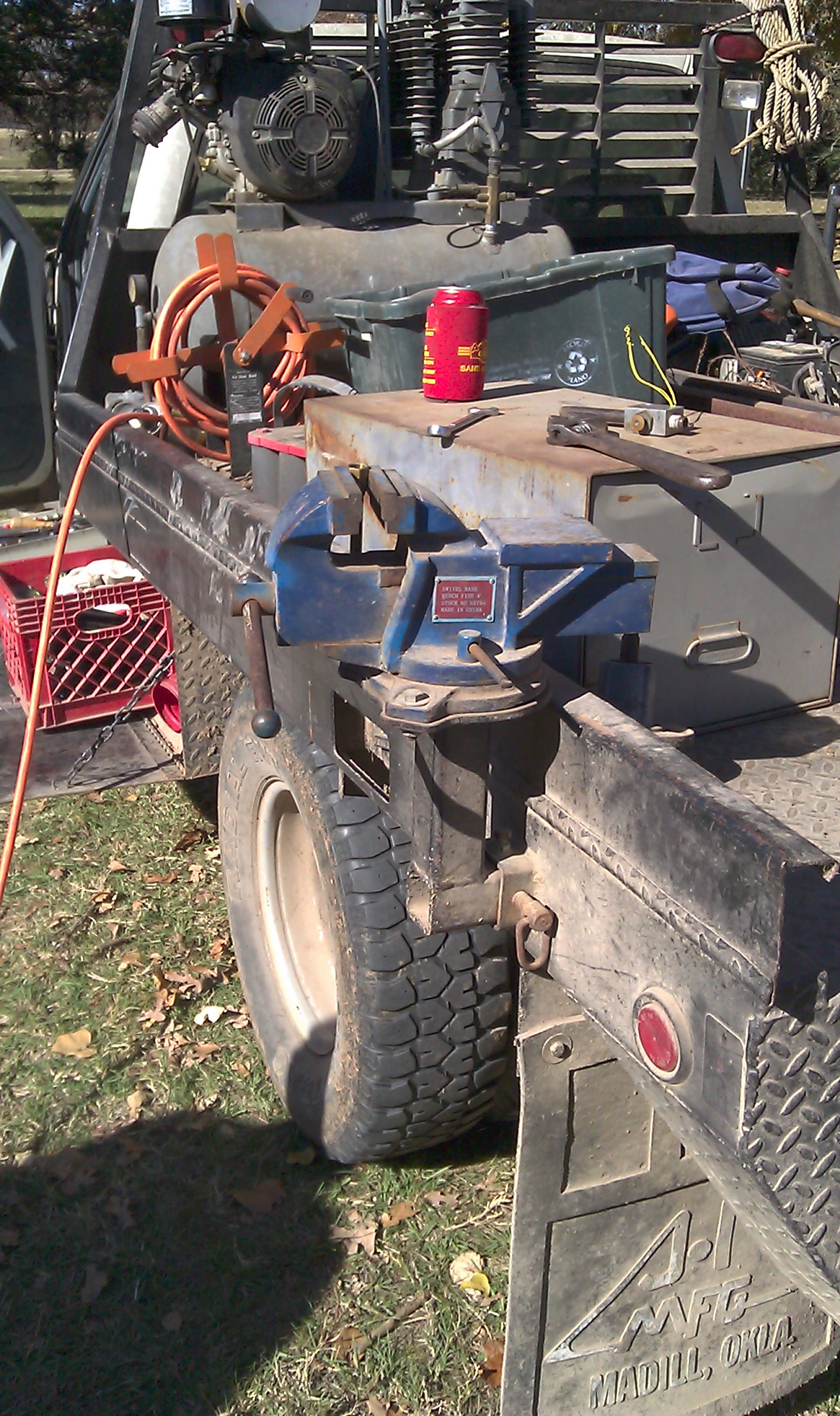

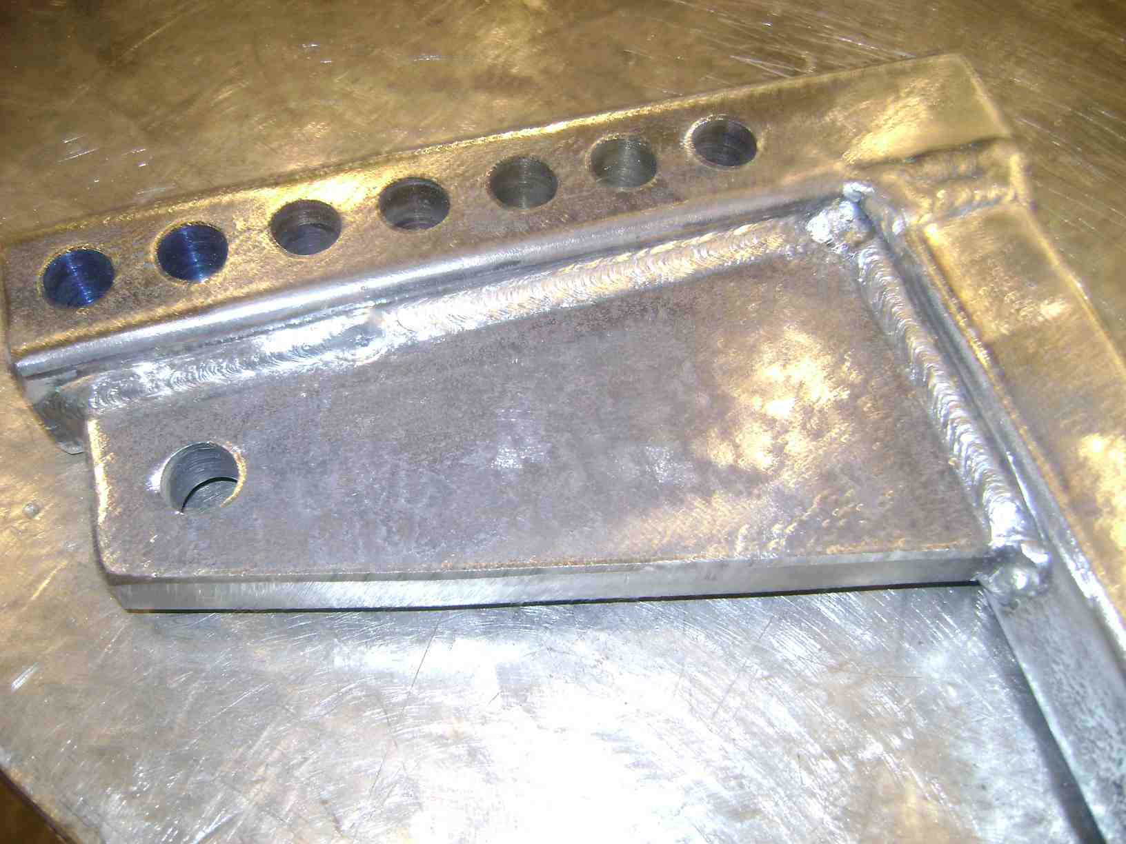

However I also made one that fits into the side of the flat bed at the farm at a much better height to work from.
The mount has 5/8 holes in all sides so you can take it out and turn it 90 degrees to hold a lot of different things without needing a swivel vice. I also drilled and tapped the reciever so I can jam the bolt down, taking out any slop.

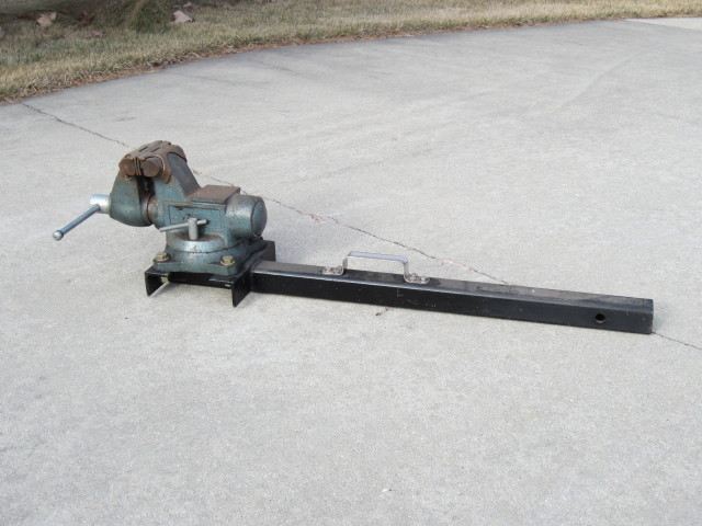

This is the one I built. I made it long so I'm not banging into the vehicle.001_1.JPG
