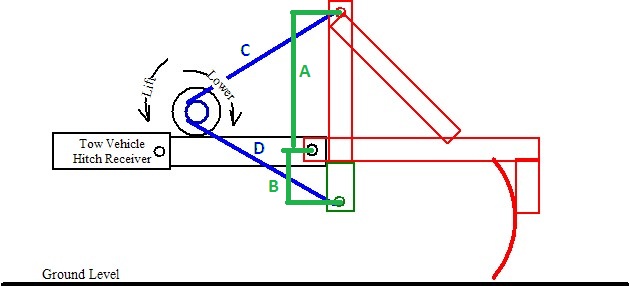

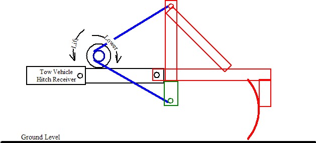

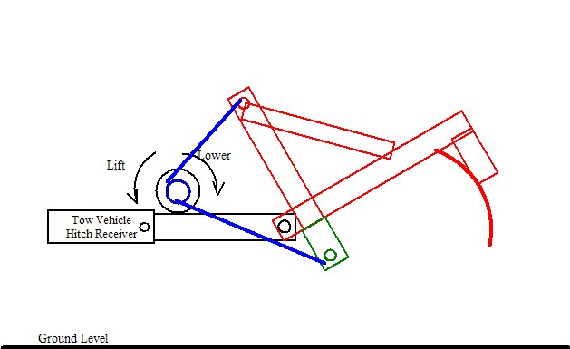

   / Hitch 'N Plow #17
Here's how I would do it. I would use a bi-directional motor and wind the cable around the motor shaft (axle) about 3 turns and terminate each end of the cable at the implement. I would modify the implement to add point of attachment about 4 inches lower than the lift pins.
Then I would one end of the cable to the top link and one to the added lower link.
Turn the motor counter clockwise will raise the implement, turn the motor clockwise will lower the implement. The cable at the top and bottom connection points will keep the implement from bouncing around.
See attached diagrams for up position and down position: Now can I get rich?

   / Hitch 'N Plow #19
OK, now can I get rich please?
Only if you figure out how to get the cable to draw evenly from the top and bottom with different distances between the cable attachment points and the pivot point. I might suggest separate pulleys of differing sizes for the top and bottom cables, otherwise it will rip itself apart.
In the above diagram, A≠B, thus the distance moved by C ≠ distance moved by D
I get a 10% cut of any profits for devices using my design :D
Aaron Z
   / Hitch 'N Plow #20
I think your right. The winch or other motor needs to be on the same plane as the center of the pivot point and the cable connections equidistant from that plane. So, make a 3 point fixed connection so the blade fixed to a pivot that is fabbed with pipe in pipe setup with the winch mounted to center on the same plane. I tried to draw it but could probably mock it up with material easier than draw. You get 10% of the profit I get. That'll be a lot, right?
