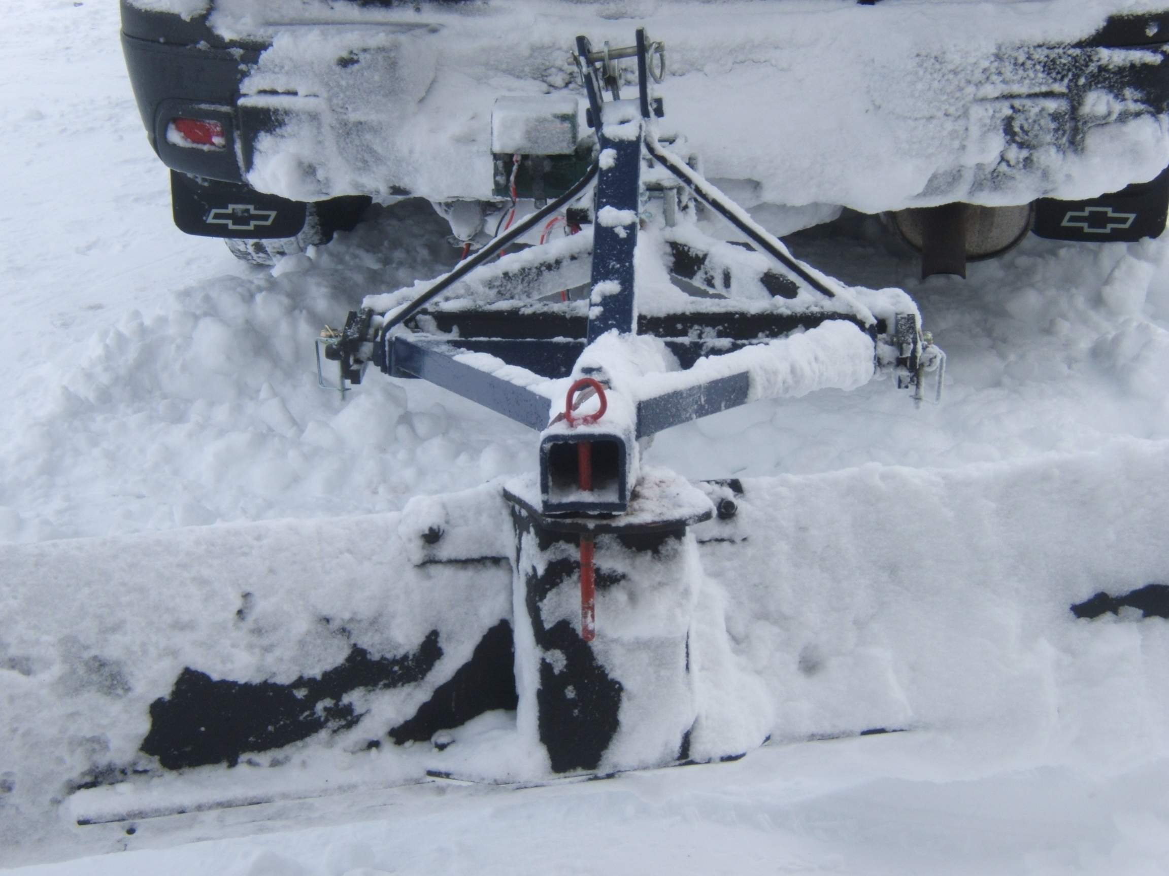

I bought one at the beginning of winter 2009. Its Great. I have a 800' driveway and it makes quick work of a tedeous job. I'm in NE Ohio and it takes out 10" of snow in no time. I am literally "hooked up, plow, and parked in the warmth of my Trailblazer in 30 minutes. Spent less than $300 for everything. Wish I bought it 5 years ago.

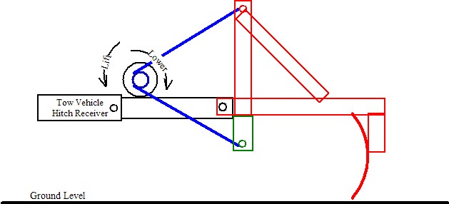

I've had this in mind for a while... though I plan to use it to grade my driveway and trail...
I found this;
T-Point lift vehicle 3 point hitch
It would give downforce, but I worry about the length and leverage that length would cause. I'm not against replacing my rear shocks with rigid bars...
Here's my rig;
Also, I worry about the height required to get proper angles... I think my hitch is 24" off the ground if I remember correctly... or maybe it was 29". I measured once. LOL

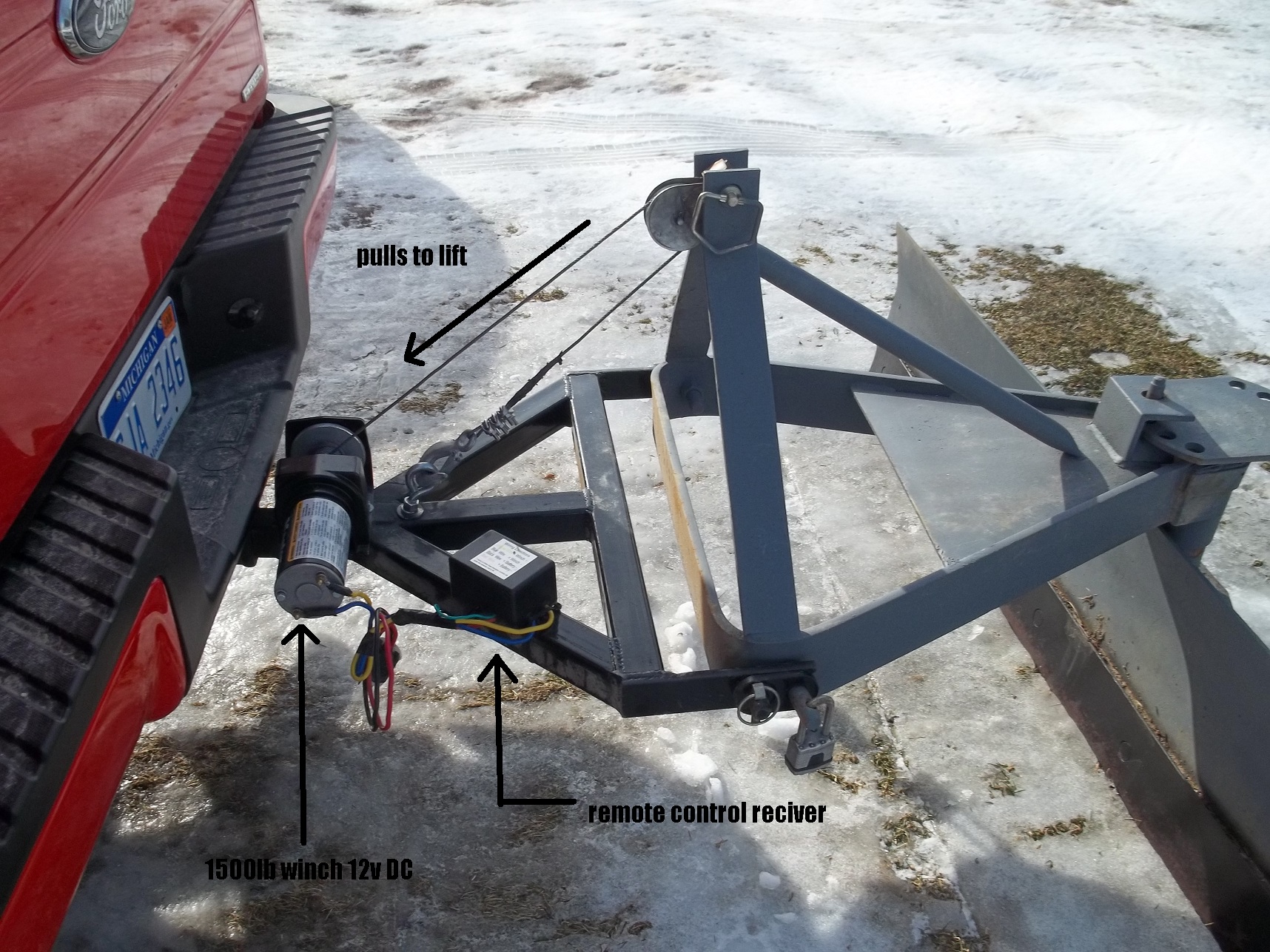

I've owned a Hitch-N-Plow from Bob Schmidt for 3 years now, I know all it's little quirks. Bob says NOT to push snow with it, you can take that to the bank because you will either break the cable on the winch, or break the hitch-N-plow right where the single tube goes into the "Y". I've broken mine 3 times (easily fixed with some steel and a welder), once this winter and it was from pushing going backwards. I'm running a 1500lb MasterLock ATV winch, it works well but I've replaced 3 winches in 3 years and the MasterLock seems to hold up the best (Walmart...$75 out the door). I do keep a spare winch on the shelf because if it does FAIL, you're not plowing without it. I bought a wireless remote to run the winch which isn't expensive, and I'm not running wires from the winch to the inside of the cab to control the winch. Bob says up to a 6ft blade, I'm now running a 7ft on the back of a 2013 Ford F-150 4x4, last year I ran a 6ft plow but replaced it last summer with a 7ft. As mentioned in this thread, having a place to deposit the displaced snow is a MUST. I clear my drive and all of my front yard in the beginning. As winter progresses, I fill my front yard with displaced snow. Last year by winters end, I was just started running out of yard because of displaced snow. In my opinion, the design is a solid concept and works as advertised as long as you follow Bob's directions for use to the letter. It is built with LIGHT steel square tubing, but is welded together very solid. I don't like the fact that the winch is SLOW in raising and lowering the blade, but it's better than buying a $4000.00+ plow for my truck. If all you're going to do is move snow or grade a long drive, no problem. If you hit a solid object of any kind, it will break so just keep that in mind. You do have to LEARN how to use it as well. If your plow vehicle nose goes down in a dip, the blade will go up unless you spool out enough cable on the winch so the blade will float across the ground with the rises and dips. This adds time when you have to raise the plow because you have to spool in the excess cable before the blade starts to rise. I do like mine, and it performed great last year when I had a massive amounts of snowfall. Another tip, angle the rear view mirrors to observe the blade. My 7ft plow sticks out 1ft on each side of my truck so I can see it. The 6ft plow, I couldn't see it behind my F-150, but I could see it behind my Ford Ranger.

I am glad you like my Hitch 'N Plow invention. I appreciate the feedback and I think the clarification you have provided will be helpful to other people using this product to plow snow. I licensed this to Behlen Mfg. in 2014 so they are now producing and distributing. They produce 3-point implements so this is a great because it helps them sell more implements. They offer Hitch 'N Plow (without winch and blade) on Amazon for $199 with free shipping if you are an Amazon prime member. Also available on Amazon Canada now. I am looking for videos if anyone has any good shots of Hitch 'N Plow plowing snow. I would like to get permission to use these to create a new YouTube video. Go to hitch-n-plow.com for my contact info. Also, if you have any questions you can email or call me directly. Best Regards, Bob Schmidt
/ Hitch 'N Plow #33
Bob...I just hope Behlen can weld this thing as well as your original welders did. That was aircraft grade welding and is bullet proof. I also noticed an engineering revision from welded studs to bolt on pins. The welded studs on mine have not offered to even MOVE let alone break so I cannot speculate why the change was made. I don't feel the bolt on pins would be a problem either, and a lot easier to fix should they bend or break but that hasn't been an issue for me.
I wouldn't mind doing a video for you, but we gotta get a decent snow AND I gotta recruit someone to freeze their tail off first. Maybe I can get one decent storm to show what this thing can really do. I would pit it against a front mount any day of the week as far as plowing large volumes of snow but the only drawback is that it is SLOWER because of the winch speed. I thought about using a linear actuator rated for 1000lb push/pull to replace the winch but that would create problems I'm not willing to tangle with, not to mention the price of an actuator being in the $300-$400 price range.

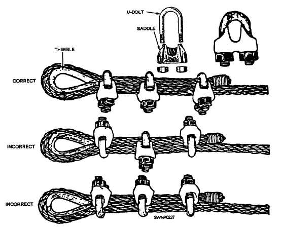

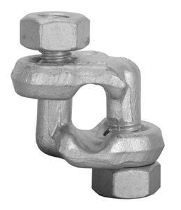

I would like to offer two changes here. One is the cable clamps. In post 31, he has the clamps all facing the same way. I suggest the middle one to be flipped 180. My dad has taught me to alternate the location of clamps as its what he learned in the army. Second is with the backblade down all the way on level ground, I suggest adding a chain to take the tension off the cable and as backup if the cable breaks so it doesnt cause a catastrophe on the road while either backing up or driving forward.
/ Hitch 'N Plow #36
Don't alternate clamps. All the same, facing the right way. The U-bolt crimps and weakens the cable. You want the U-bolt side closest to the end of the cable..
And for those who can't remember which way the clamp goes:
Bruce
/ Hitch 'N Plow #37
well -- call me shackled- I stand corrected - the right way to clamp.
thanks bcp
/ Hitch 'N Plow #38
Bruce
Best way I was told to remember this in a rigging class once was "You never SADDLE a dead horse". So the Saddle never should be over the "Dead" end of the cable.
