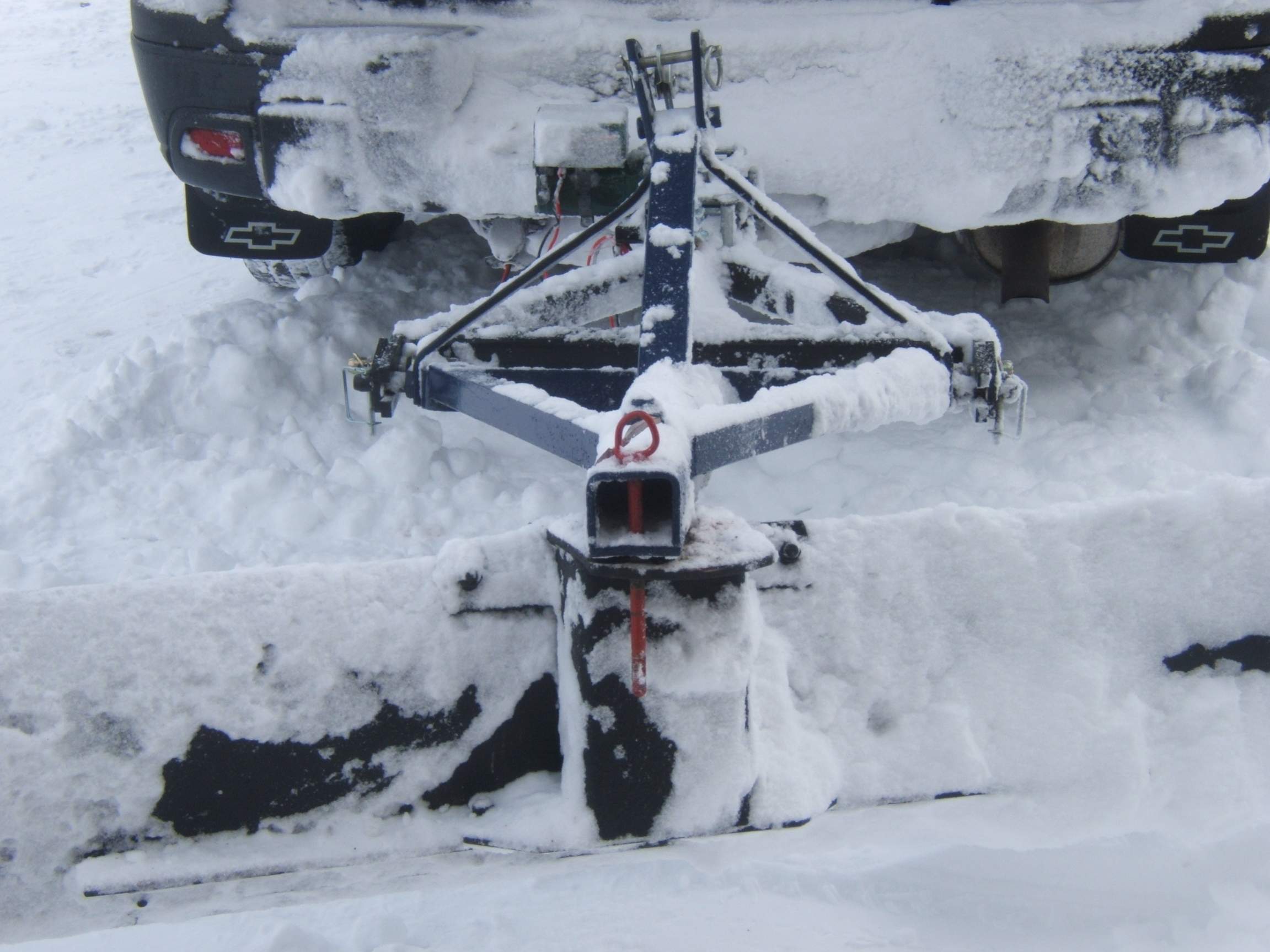

I bought one at the beginning of winter 2009. Its Great. I have a 800' driveway and it makes quick work of a tedeous job. I'm in NE Ohio and it takes out 10" of snow in no time. I am literally "hooked up, plow, and parked in the warmth of my Trailblazer in 30 minutes. Spent less than $300 for everything. Wish I bought it 5 years ago.

Having a limiting strap or travle safety chain won't stop it from bounching... it will just take the load off the winch... the blade is still going to bounch around a bit.. I ended up having my hitch modified with some gusset plats to make it stronger.. I ended up bending it to the left and right a couple times... worke great last winter... I know work for a landscape firm and we take the plow trucks home during the winter.. sold mine hitch n' plow last spring for $400..
