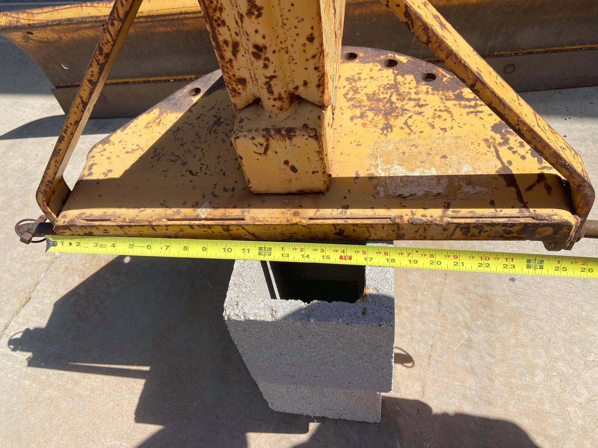

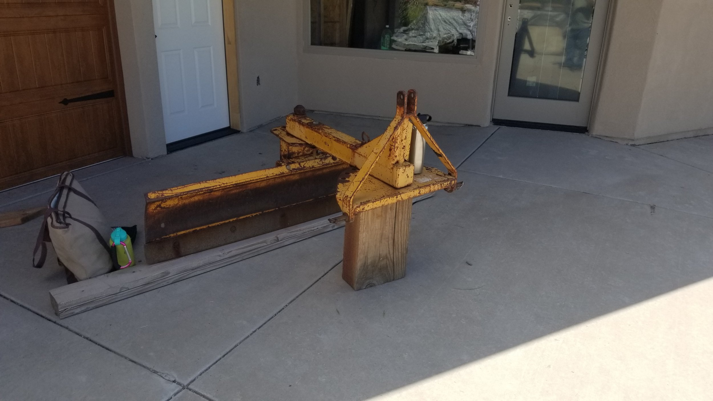

My scraper blade I bought is very old.
It requires a 6" long pin however 3/4" fits very loose and 7/8" is too big to fit at all. Is this normal?
The holes are all still round and not at all damaged. Is it possible it takes a metric pin like 20mm?

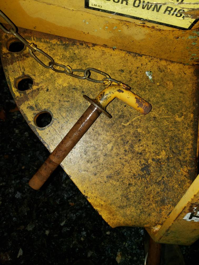

well I should have been more clear it is the vertical pins for adjusting the blade arm for angling the blade or to offset the arm.

Some of the holes have never been used and the fit is the same. So they are not worn. Just seems odd. I'm thinking a metric bolt like 20mm may fit better so I may look into that option. I thought possibly there were metric pins used in Europe.

I have the same blade, the original pins are made from 3/4 hot rolled bar stock.

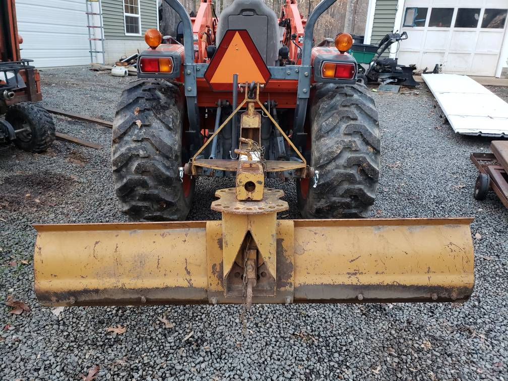

My rear blade, while it is fix (does not off set as the one pictured) the pin is slightly loose for the angle adjustment. I figure if it was real tight, the blade would run a risk of binding. As it is, if the pin does not want to pull a kick to either the front or rear of the side of the blade depending on the tilt of the pin has always freed it up. The looseness would only allow for a minor angle change and since the work being done is not rocket science, the slight play is not critical.
Now I am jealous of that swing at the front of the frame as shown in the photo!

They aren't a tight fit but I wouldn't say mine have a lot of slop either. A little movement is good, keeps everything from seizing up!
/ Hitch pin size #16
Agreed! As a wild guess I would say the opening is perhaps 1/32-1/16” larger than the pin.

All of my pins are loose on the Ford 785A and Massey 21 back blades. This is preferred to having the pins rust in them. The locking pin for angle on the MF21 is tight and when I cleaned it up it took me hours to free it up. I would have preferred it looser like the 785A as it would not have seized up solid. Back blades are dirt moving tools so looser tolerances don't hurt the work, but do make hooking them up, and adjusting them easier.
My Massey 18 box blade had tigher tolerances and the thing was seized solid after the prior owner used it to move cement. It took me hours to free it up. I do not like crazy loose tolerances, but loose enough to prevent seizing is nice.
