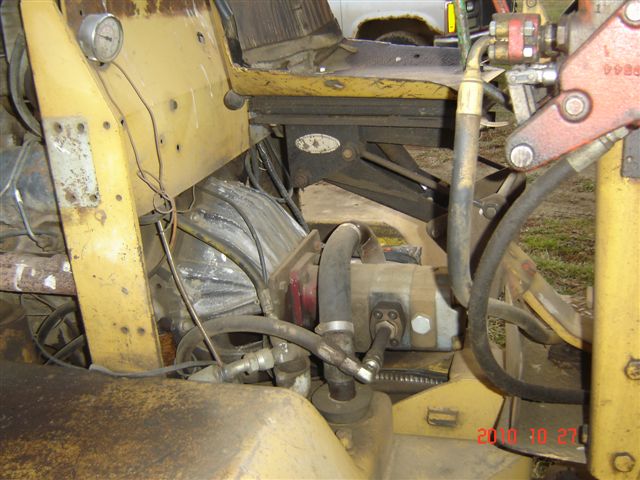

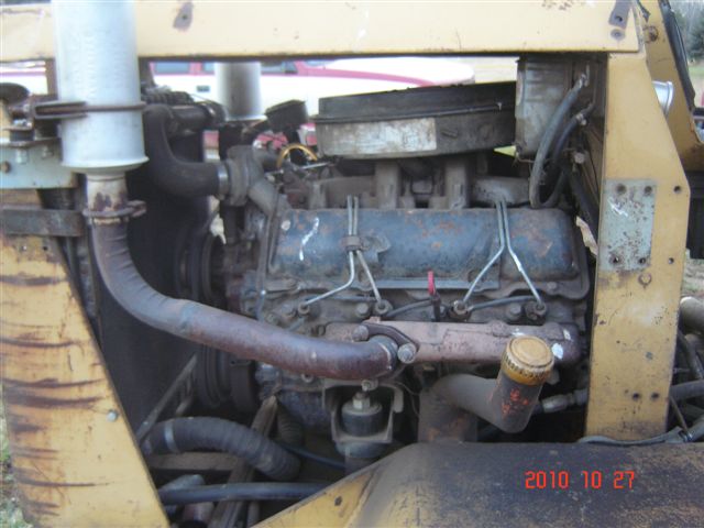

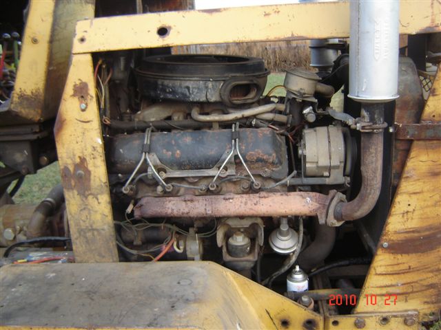

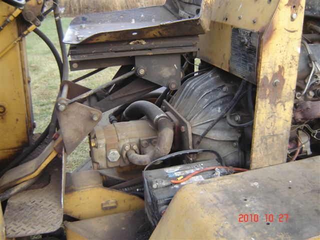

I bought this loader for $500 without engine and with a worn out hydr pump.
I repowered it with a GM 6.2 diesel i had sitting and a stackable commercial pump with the right output i had laying on the shelf.
It took a bit of juggeling to get it in there,but it looks like it belongs there now.I needed to shave an 1 1/2 of the pan to set it low enough so the hydr pump would not interfere with the seat.I swapped the exh manifolds left to right and upside down to get the stacks at the rear
it has a 2 sp tranny and can clip along pretty good in second
It took a bit of juggeling to get it in there........it has a 2 sp tranny and can clip along pretty good in second
Welllll I recon! :thumbsup: I think about the biggest option was around 80 HP in the newer loaders...that one probably came with a Ford industrial in it originally. I'll bet chains on 15" tires aren't exactly bogging it down or anything. I like your style! OH yeah, kind of got off track with the "more power" thing...great dozer blade as well.
I needed that extra traction,not enough grip on them truck tires;)
I can make it still spin out,i wonder why;)
