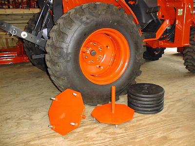

You're using all-thread for the posts? That seems to be mild steel, and bends easily in my experience. Maybe you could order large grade 5 or grade 8 bolts now that you know what length you need.
   / Home building (rear) wheel wts
#22
20051229
[just got back to catch up]
That's a thought, but like with too-stong a shear bolt, would there be more risk to the rest of the setup with more strength in the rod? Don't want to have an argument/forums/images/graemlins/shocked.gifbetween bolts attaching the plate to my wheel and that one, etc.
Perhaps if the higher grade bolt was more brittle, it would simply snap off cleanly if "stressed" /forums/images/graemlins/smile.gif?
My spouse's thought is cut the rod shorter this time. Something about the idea that if it ain't in the path, won't get hurt /forums/images/graemlins/crazy.gif
Work is at a standstill at our farm with all the wet stuff round here. Slippn' n sliddn's no fun on a big blue tractor.
Jim

Here are couple of pic's from March 1999 I think they are from the former Mike Simpson site.

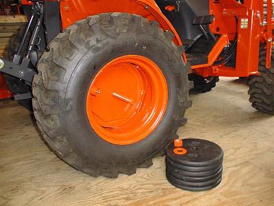

   / Home building (rear) wheel wts #26
Another

Here are mine.It was kind of funny with Mike. I made mine before I even knew anything about his site and then something was said and he got upset and said I stole his idea. I don't know what he thought about the guy that was selling them a while back. I have had mine sense 1999 or 2000. He did have a good site with several good ideas.
