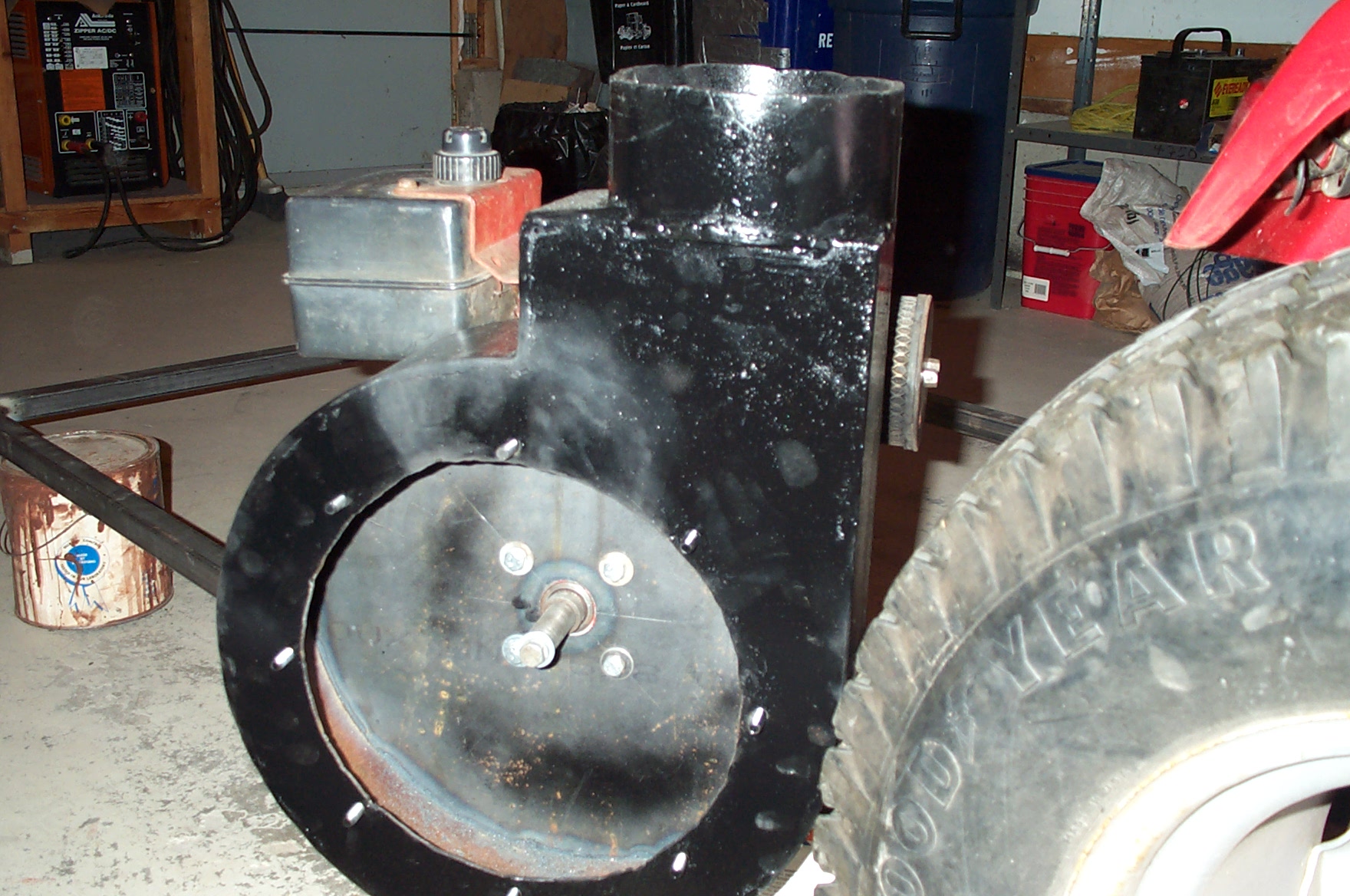

Does anyone know where I can find the parts to make a pull behind leaf vac? I need the part that hooks onto the motor. I have the engine and the cart just need the tubes and the suction device.
/ Home built Leaf Vac #2
Thats the heartbeat of the machine. I plan to build a 16-20" impeller with 3" guides. I will belt drive it off a counter shaft for the correct rpm. The reason for the extra vacuum is I have tons of pine needles to pickup and this will provide the added suction to remove them. I have tried smaller factory units and they don't work as good as I would like. Haven't figured out where to get it ballanced as of yet. Good winter project. Keeps the bandsaw and mig tuned up.
/ Home built Leaf Vac #4
We had blowers to dry cleaned chemical tanks. When we needed to repair an impeller we were wondering how to have it balanced when one of our drivers, a stock car fan, mentioned a local shop used by the local stock car owners called 'Raceweld'...try to find out where the local engine builders get things balanced...

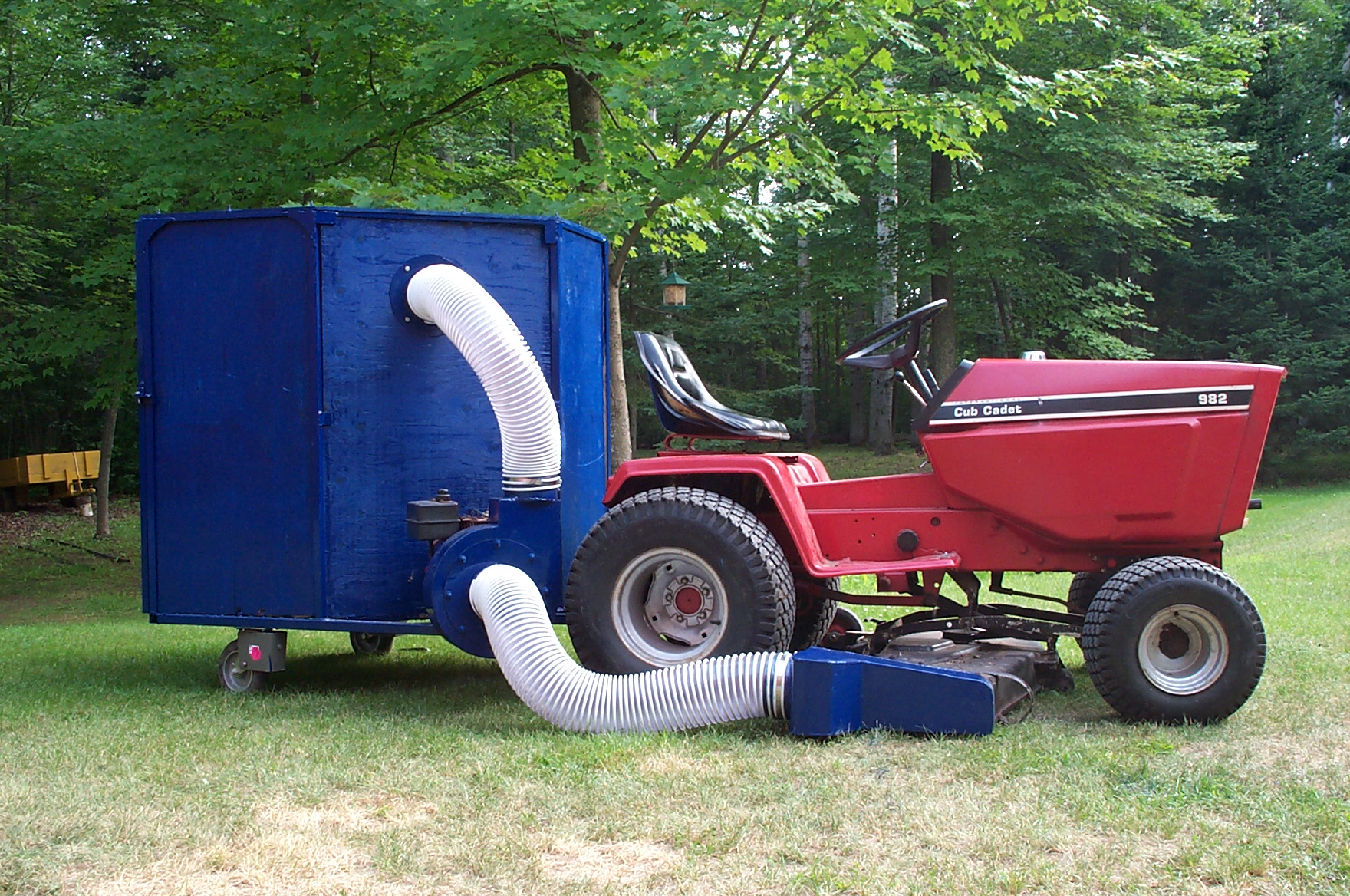

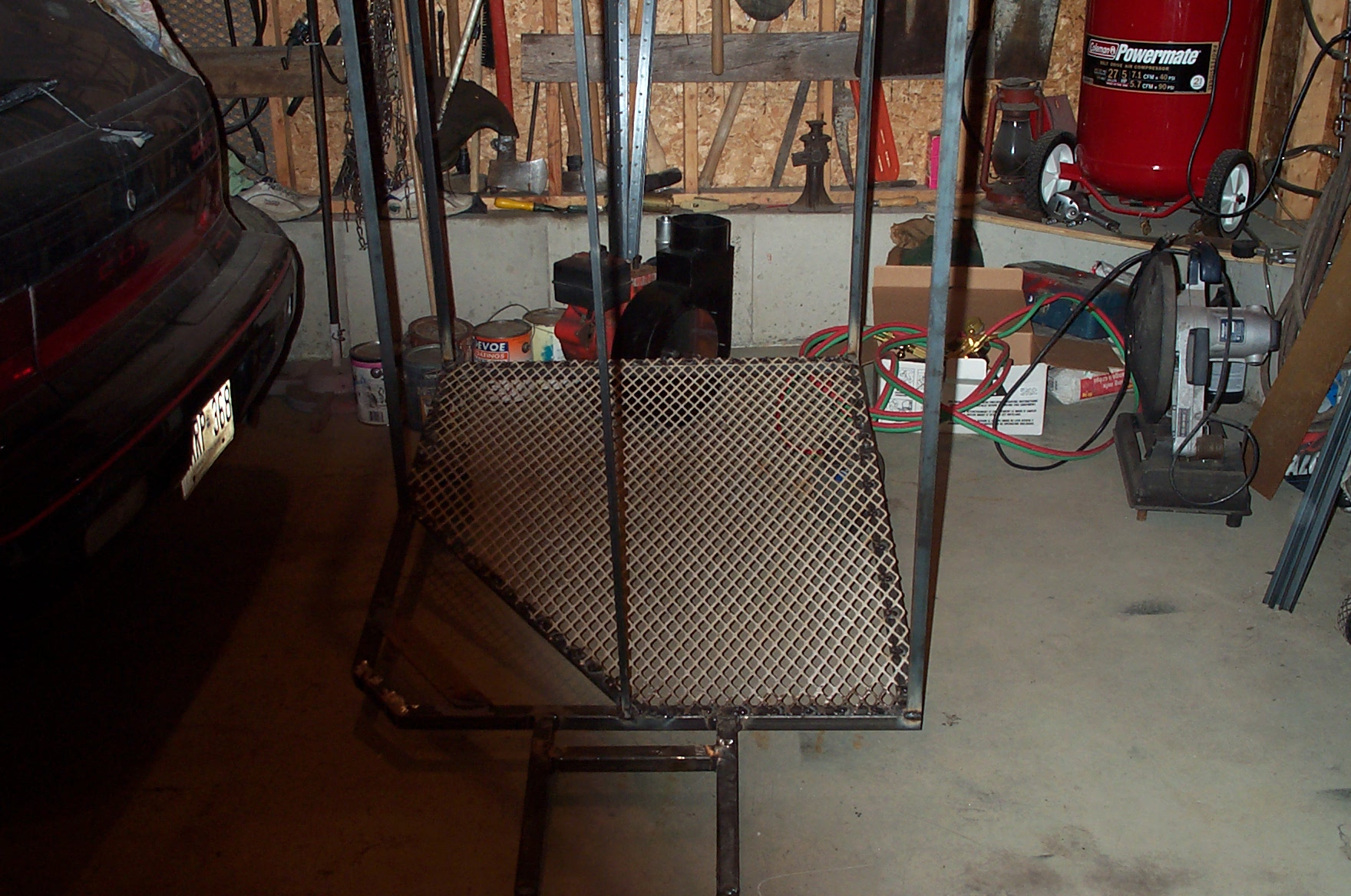

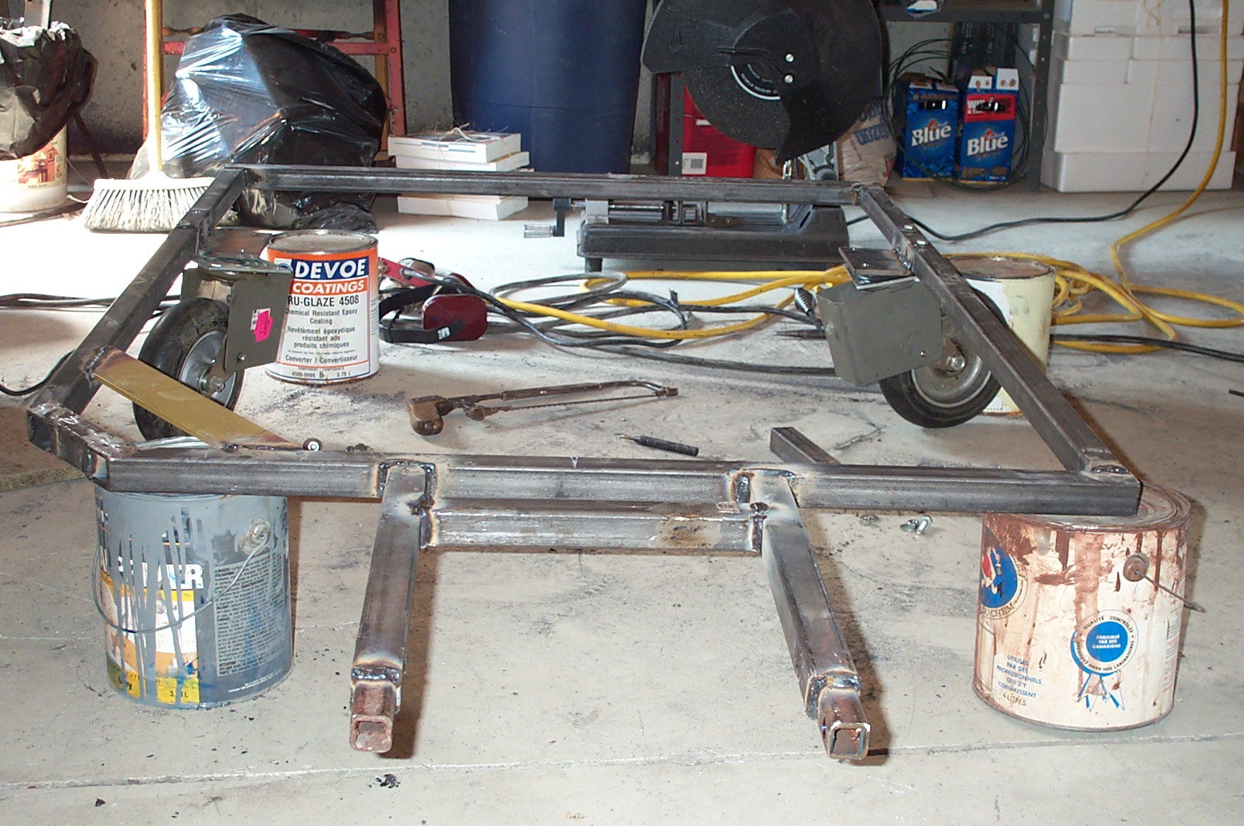

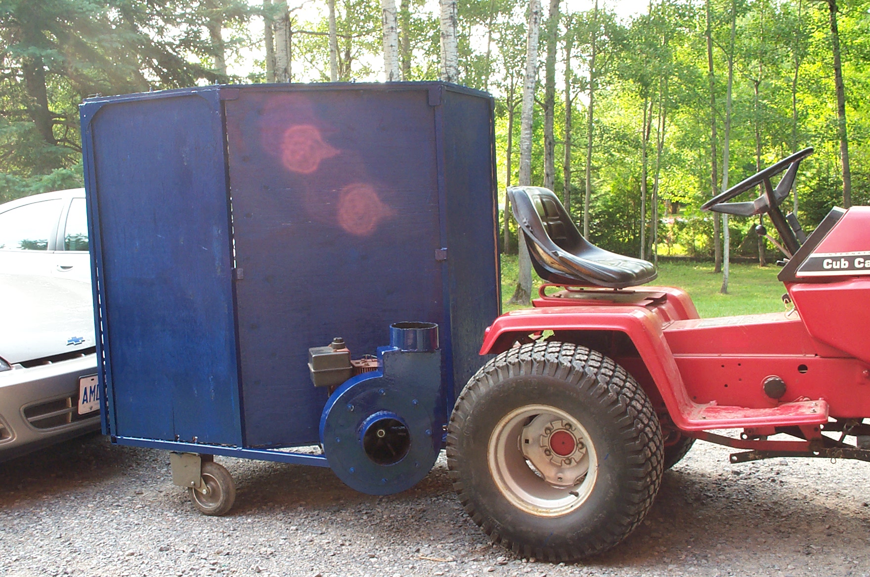

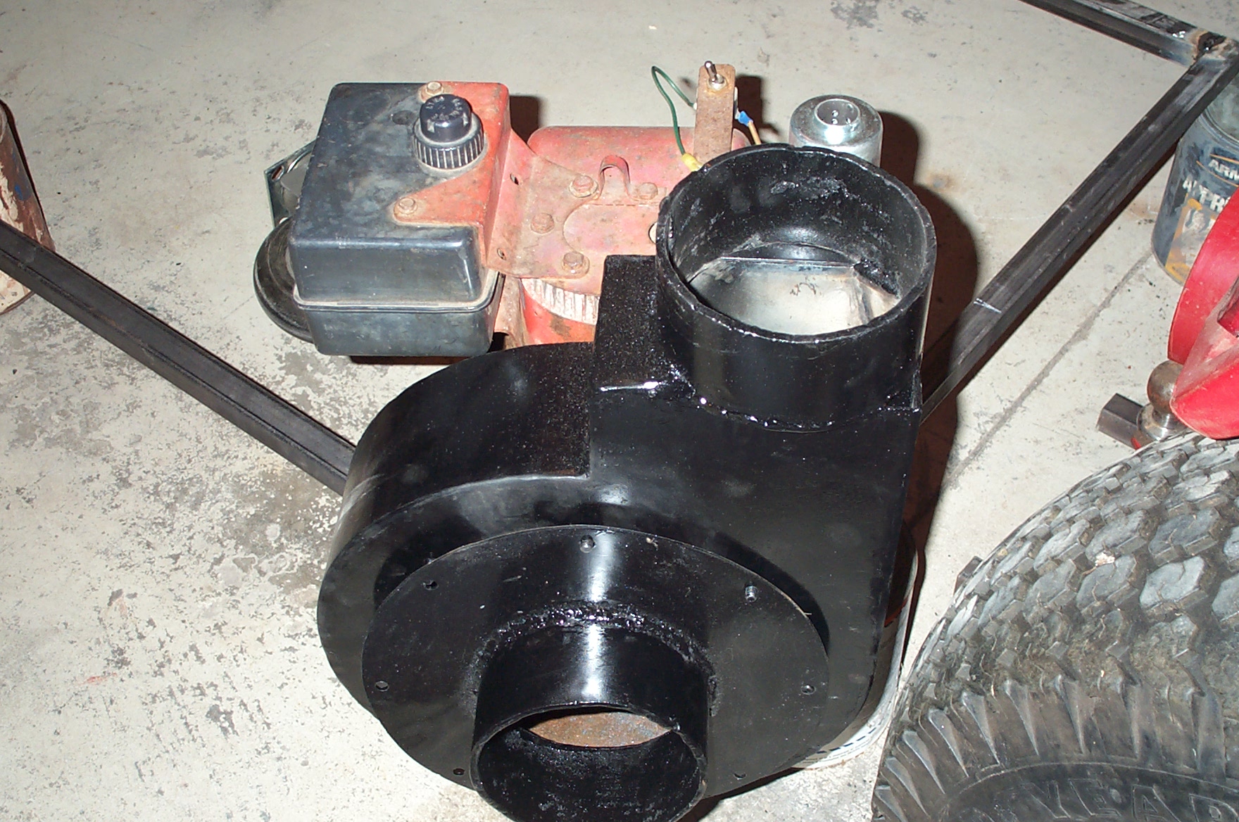

Hello Mr. Warburtonplayer ...
Interesting, I finally find someone else who wants to build one of these.
I built mine about 8 years ago. It was originally designed to mount to the the rear of my Cub old 982. I actually had it sitting for a few years and this last summer (having moved to a new property (75ac) I modified the mower deck scoop to fit my new B7800. The compartment itself measure 4' x4' x 36" wide, and has 2 large caster wheels mounted dead centre of the body. So what I did was attach the frame of the trailer to the 3pt hitch (with no top link attached) and I let the weight of the trailer ride on the caster wheels. This provideds a verticle uncoupling (so you can ride up & down over bumps in the lawn and yet keep the trailer tracking straight behind the tractor.

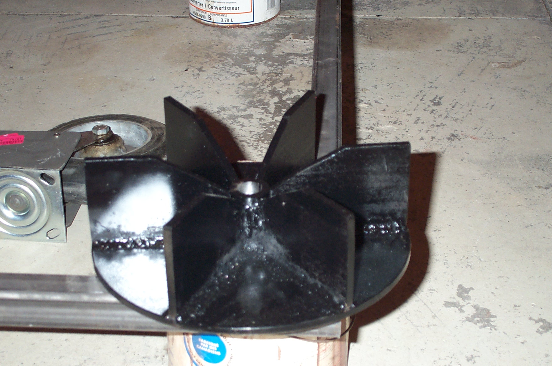

I manufactured the impeller of 1/4" material, (mostly so I could mash-up twigs & pine cones), welded 6 paddles to a 1/4" plate and then used 1/8materials for the impeller housing. I had originally wanted to power the unit an 8HP engine, but settled for a 6HP, all I had at the time. The hoses tubes from the mower deck to the blower and blower to container are 6" dia.
I had originally built this contraption because I was sick of raking pine needles for a 3 weeks and then poplar leaves for another 2 weeks. It works very nicely on grass and will chew-up small branches too I hope this helps
Best of the season to you ...
Dan
I値l attach a few photos.
