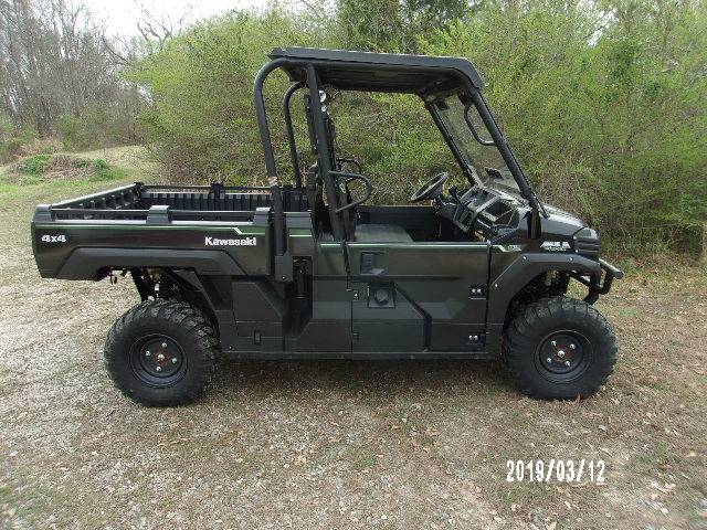

we have 2 Mule Pros, an FX and an FXT. They are awesome. We did the EPI clutch kit on both (white primary spring) and changed to the HD springs- both huge improvements. We also changed to the UNI air filter for the Teryx on both, disabled the seatbelt interlock on the 2018 and added rock slider rails on the rocker panels
The FX is a 2016 we bought used with 65 hours on it for $8,500, came with roof, brush guard and windshield. The FXT is a 2018 we bought new for $14,500, with roof, 27" tires on 14" wheels, brush guard and windshield. No sales tax on either one.
We previously had a Ranger (piece of junk) and a Mule 3010 we sold with 3,000 hours on it. The Mule sold for what we paid for it 5 years earlier.
Tell me more....Why the spring upgrade? Picture of the rock sliders porfavor.......!
Check out the Mule Pro group on Facebook it will provide all that info.
The stock suspension springs are really soft so a lot of body wallow and lean.
EPI clutch kit for much more low end power and acceleration
Rock sliders are just 2" angle iron bolted on
