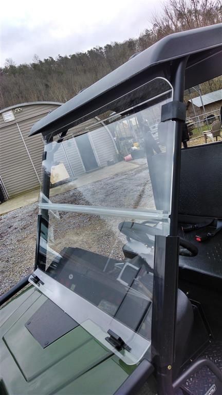

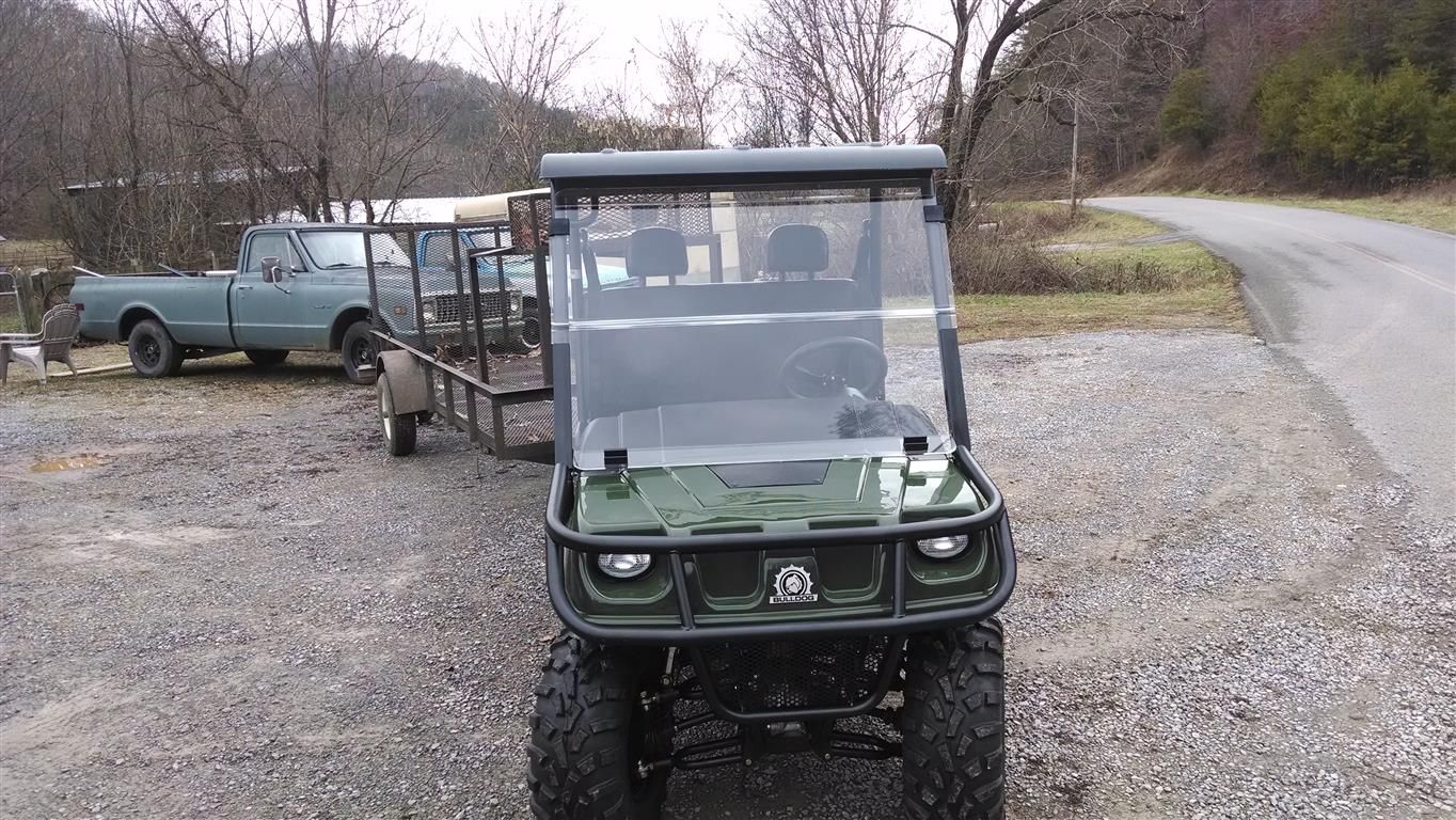

Picked it up today, first thing was to put on the windshield:
It snapped on with no tools other than a rubber hammer & fit perfect:

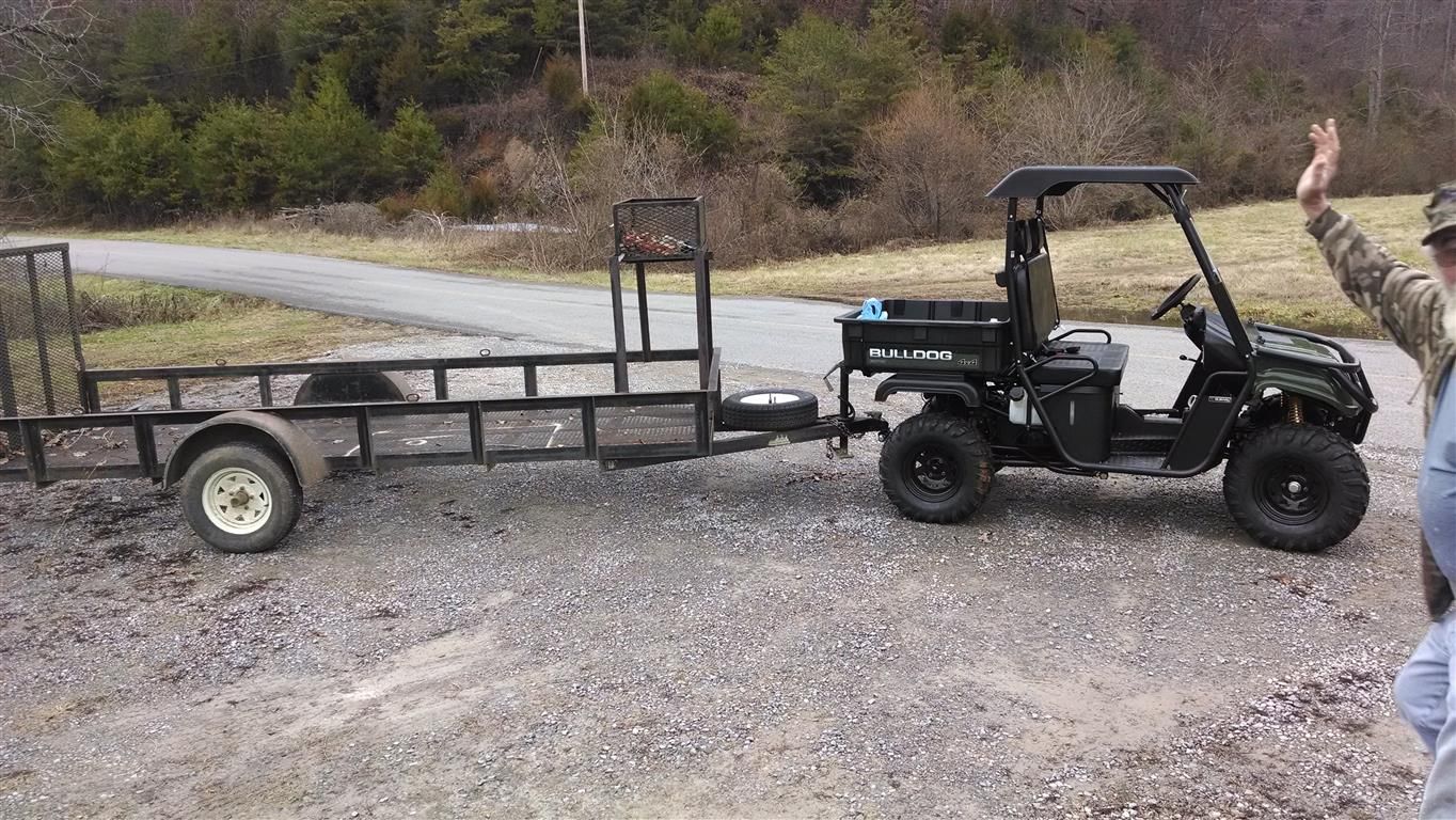

I will add more to the list as I notice things. It accelerates quickly and then feels like a governor kicks in at max speed(will gps speed later). We hooked up the trailer I used to pick it up(800lbs-ish) and pulled it 2 miles down the paved road...I could tell it was back there but it pulled it fine even on a moderately steep gravel driveway.

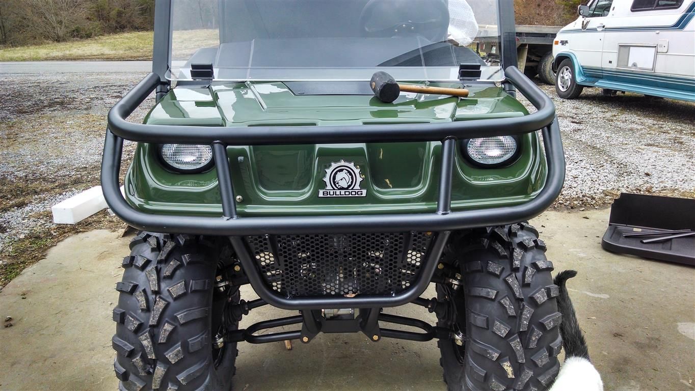

I had to re-adjust the front bumper/grill guard as it was off center quite a bit & required a few washers to center it back up.

Grill guard before straightening:

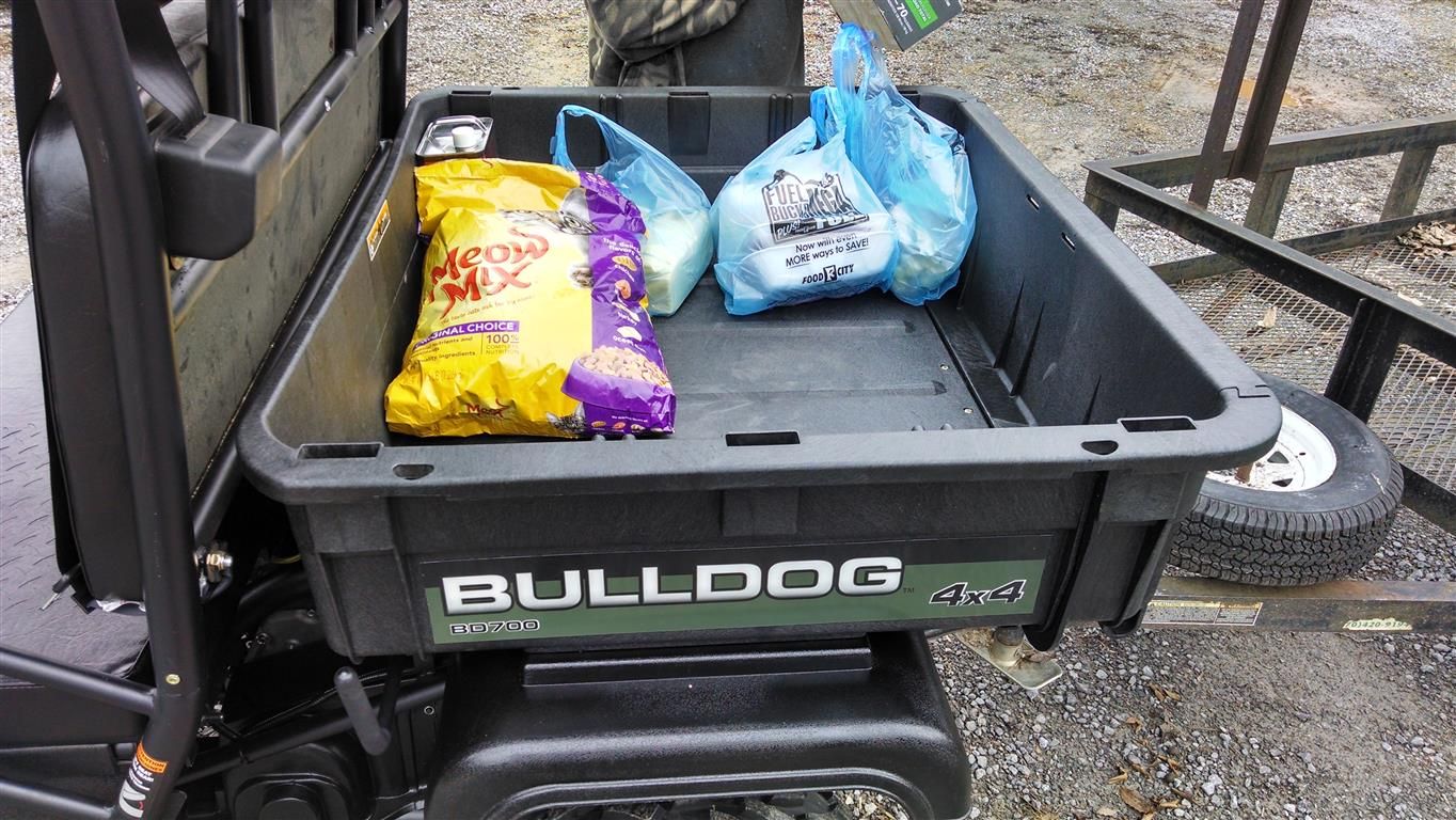

Even hauled some groceries:

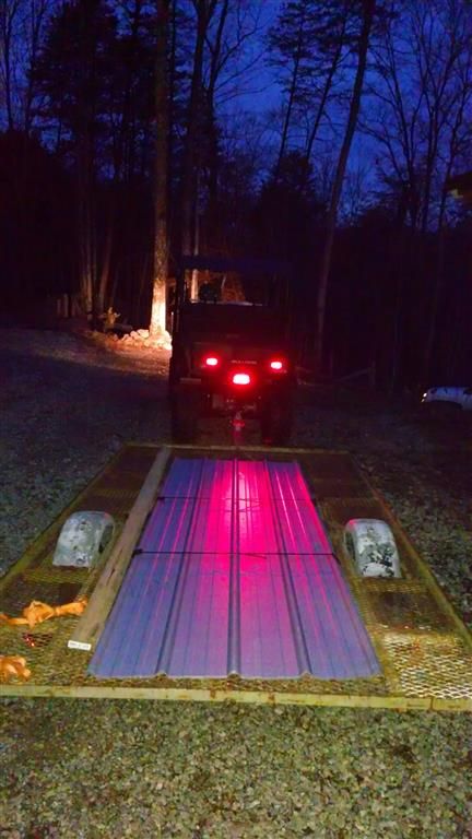

LED tail/brake light(those are reflectors on the right & left)
Headlights:

The side view picture with the guy waving, it looks to me that the front tires are bigger than the rear????? Just wondering...
