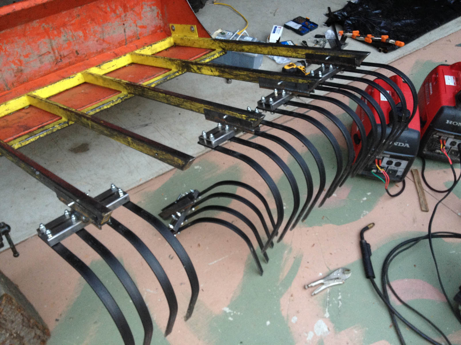

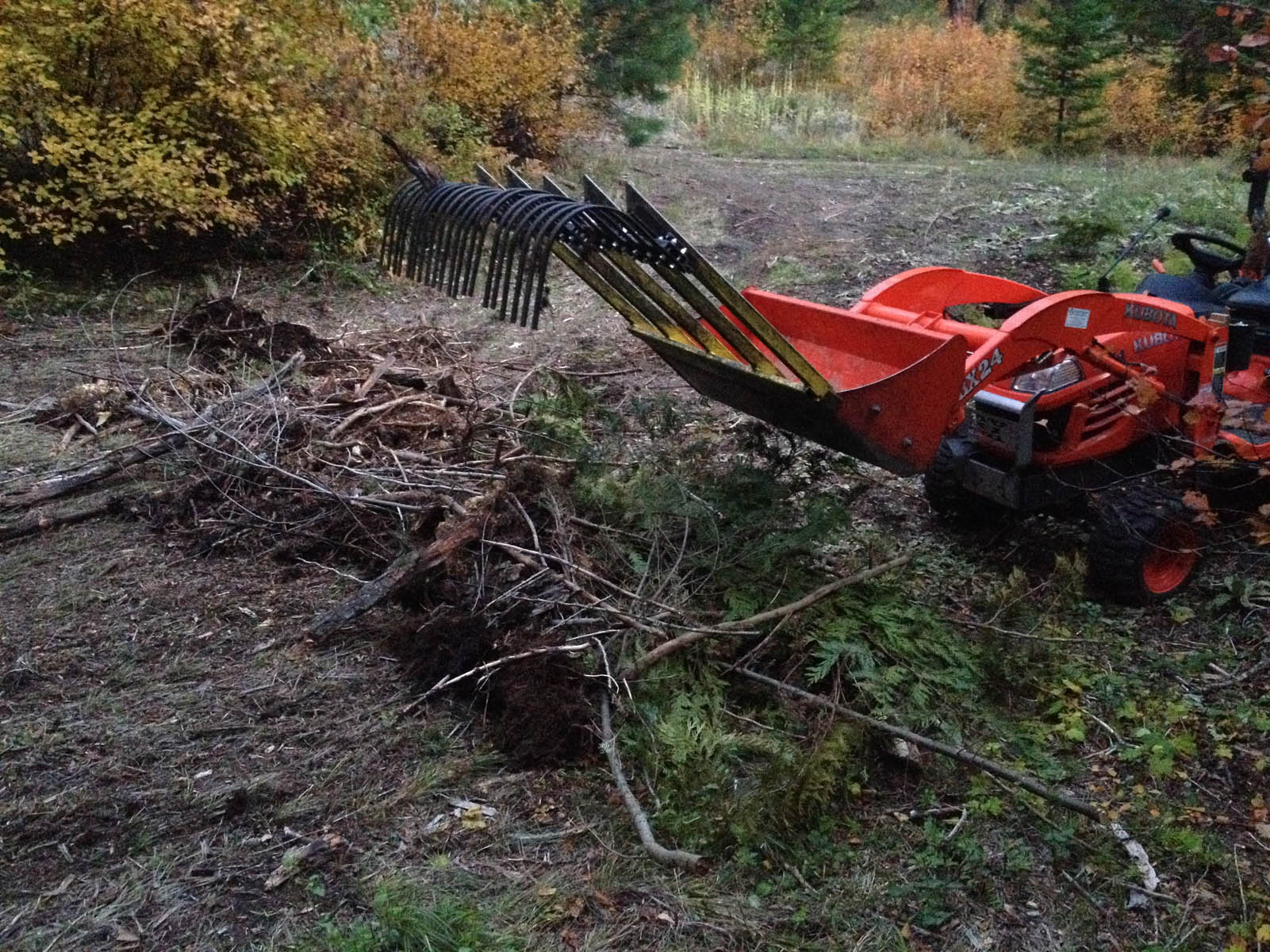

I made a brush fork for the Front End Loader of my (sold) BX-24 tractor, it became my favorite attachment.
Then I made 5 mini-stick rakes that pin onto the tines of the brush fork.
374056d1399422460-home-made-attachments-forkrake_pile-jpg

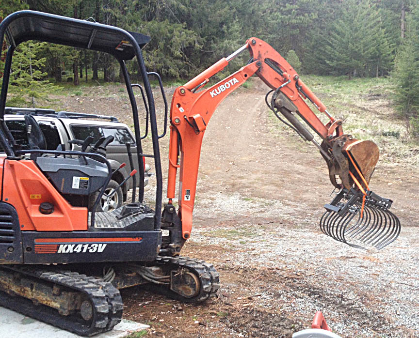

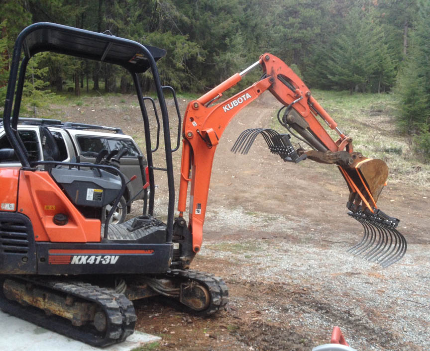

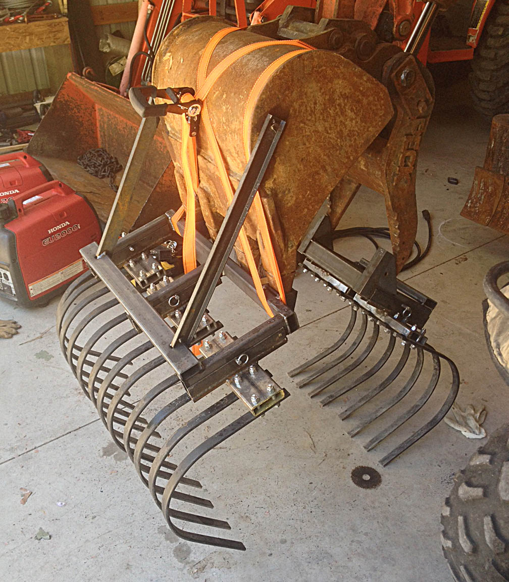

Then I got a mini-excavator with a thumb.
Recently started adapting the mini-stick-rakes to the excavator. Not tested yet but hoping be able to rake up sticks like its nobody's business! ….and drop them on a trailer…..then tow the trailer (with excavator) to the burn pile……and toss it on the burnpile with the X! Fun stuff?
374060d1399422827-home-made-attachments-kx41_stickrake__testing_open-jpg
374059d1399422794-home-made-attachments-kx41_stickrake__testing_closed-jpg
