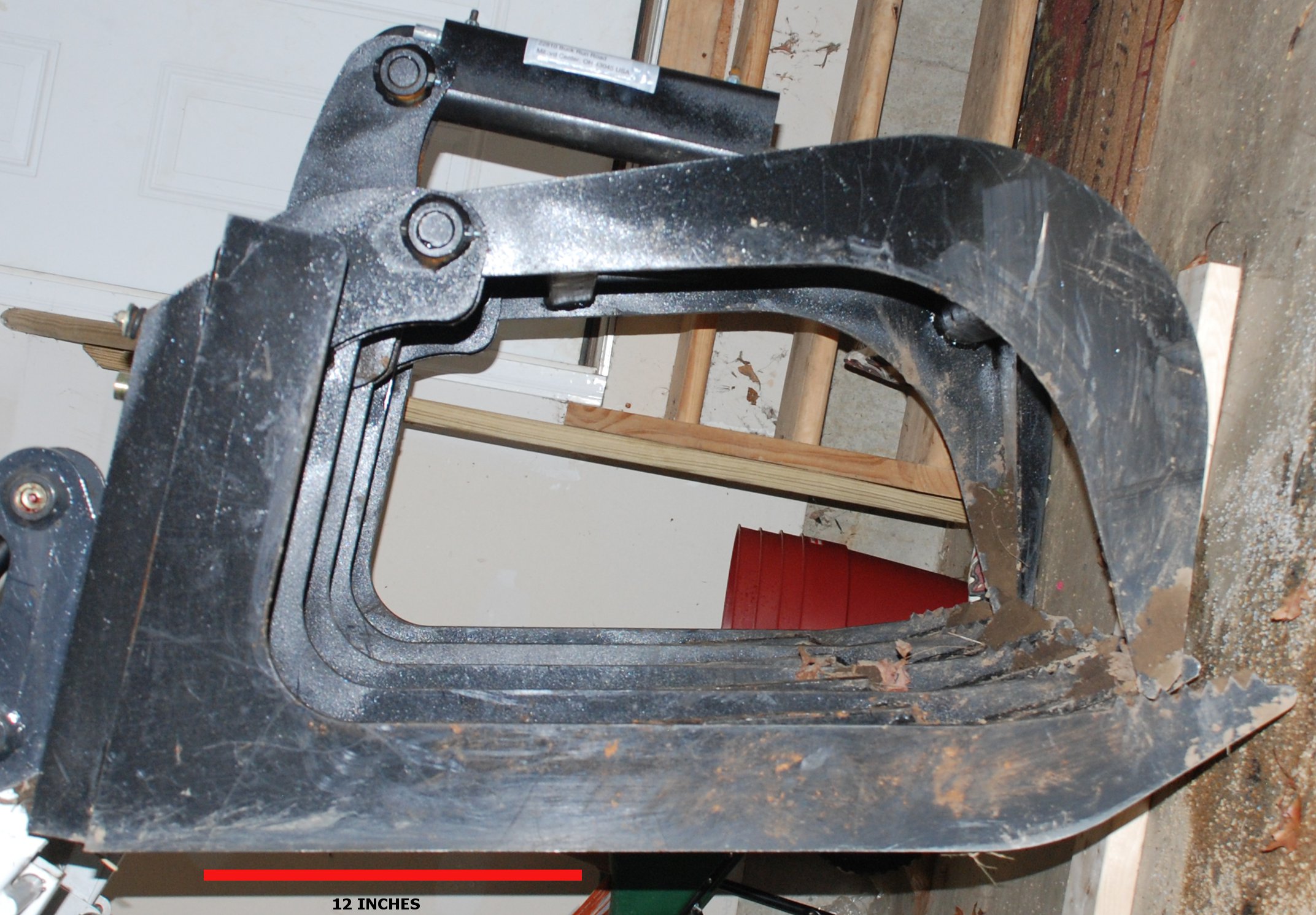

The guys that have grapples, how long are the tines and how thick are they. I'm wanting to order the material next week so I can have a winter project.
3/8 inch is fairly standard for a typical light duty CUT grapple. Length will vary with design but close to 32-36 inches is a rough guess. I'm figuring the measurement from the back of the grapple to the tip and part of that would be the rear frame.
You can figure measurements from the photos below if you calculate based on the standard skid steer plate dimensions. If you need accurate figures let me know.

Measured bottom grapple tine from tip to surface of quick attach plate: 32inches. 3/8 mild steel. Upper grapple arm is about 24 inches from mount to edge. Frame is 3x3.
   / Home made Grapple #23
Thanks IslandTractor thats the info I need.

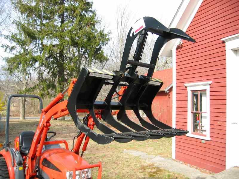

   / Home made Grapple #36

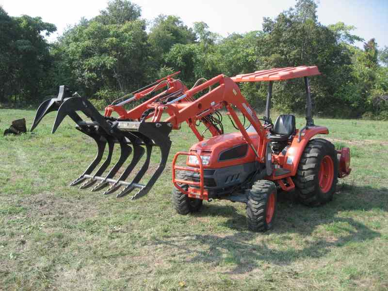

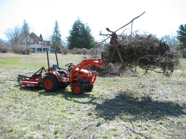

I'd go with a narrower grapple myself. My standard bucket is 72 inches. My grapple is 48 inches and perfect.
Regarding tine size and spacing, 3/8 is fine in the design I have. Note carefully the different shape of my grapple tines. They are thick at the root and tip but narrower in the middle. Custom CAD/CNC would be necessary but engineeringwise I think it is better than just a straight piece.
My tines are about 8 inches apart as I recall, maybe 9. There are times I wished they were closer but not for brush. Brush is sticky and really doesn't fall out much. Rocks are what I would like to hold onto better. I think 6 inches would be nice but remember that more tines equals more weight.
