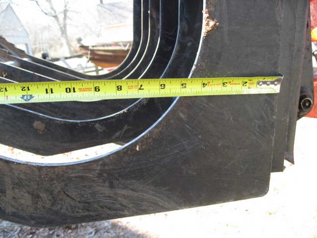

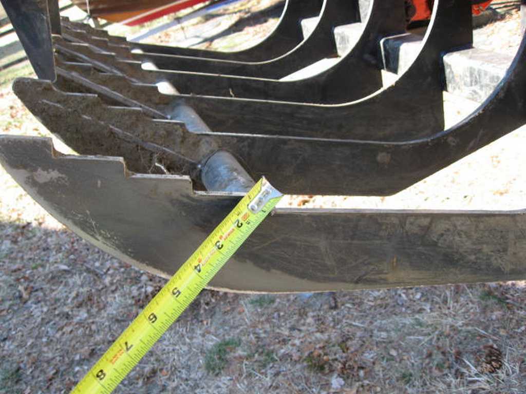

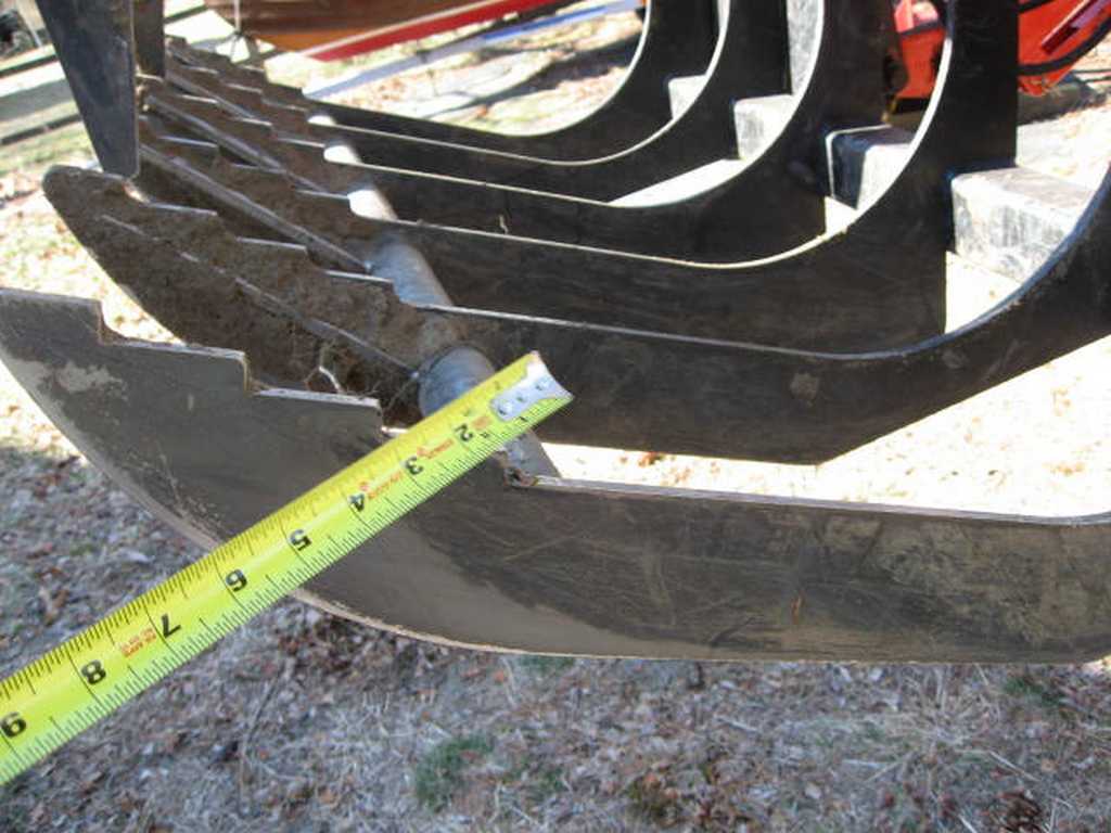

1/2 may be overkill but 3 might be a bit small. I will need to measure but I think mine is 3/8 x 4. Some guys like half inch on the sides but I would put extra steel into an extra bottom tine or gussets for support .

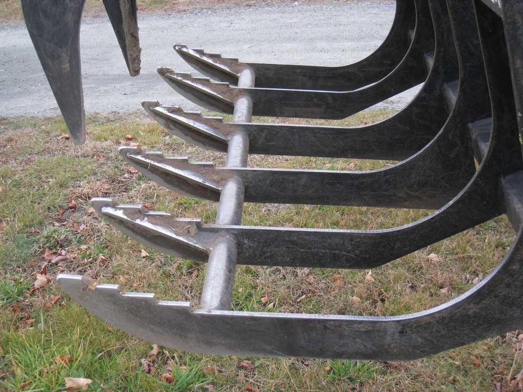

My grapple has curved bottom tines which would be easy with CAD and CNC. I don't understand why more grapples don't use them as I see no advantage to straight except ease of building. That should not be such an issue with computers doing the cutting.

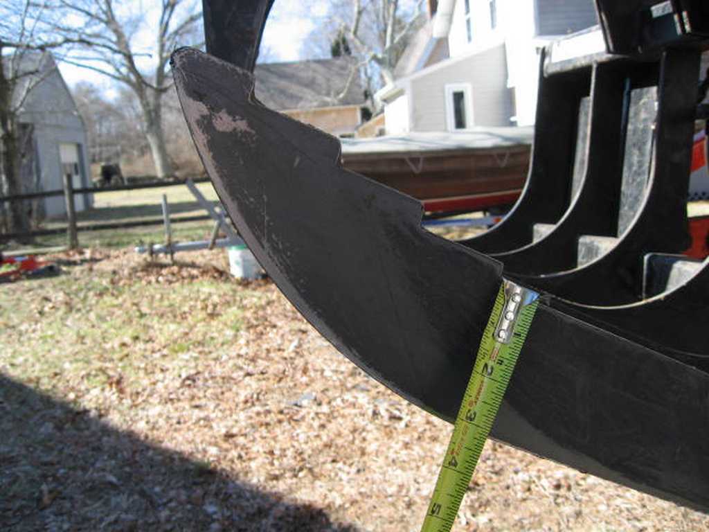

I was wrong about the 3/8 x 4. As the photos below show, 3/8 by 3 is more like it for the middle with even more than 4 inchs in the tips and especially the elbow. However, the bottom tines on my grapple are clearly CAD/CNC fabricated rather than using straight bottom tines like Markham/Gator and WRLong. The "elbow" of the outside tines and the two middle tines are more like 7 inches or so. I presume these variable dimensions were worked out in some engineering program.

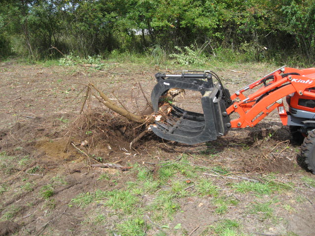

After five years of heavy use grubbing stumps and small trees where I often lift the rear of the tractor or ride up trees, the bottom tines have held up without any issue. Rocks and asymmetric loads are the things that cause problems but those tend to cause trouble for the upper arm not the bottom tines.

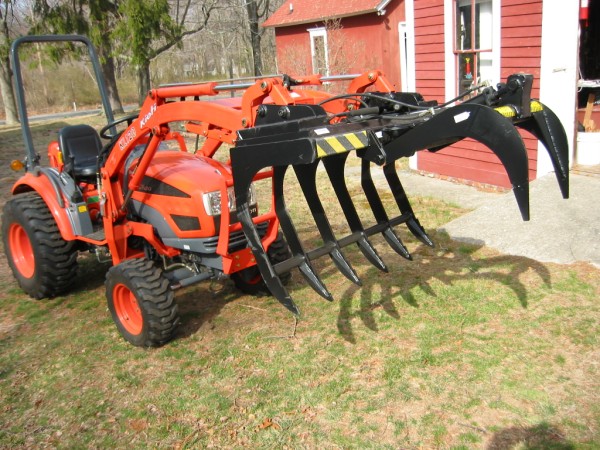

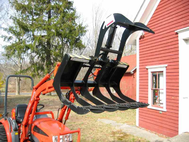

Island....comparing your tines to the Markham design (which I have)....my guess is that your bottom tines are about 6 to 8" less in length or "bucket depth". To me the size you have is a bit better for the average CUT in that is not as "unwieldy" and would not bend as easily with side loads (thus thinner material could be used).
While I lack much seat time with mine.....I've always thought the Markham tine length was a bit much....maybe fine for skid steers....but too much for CUT's....IMO.
It would be neat to have your Milonzi and a Markham side by side to compare the strengths and weakness points.

If you want to come up with specific camera angles and measurements etc, I will try to provide them for the Millonzi. I know there are a lot of guys with the LD48 Markham so those should not be hard to get either.

I measured the Millonzi bottom tines at 32 inches from the back frame. (I don't recall if that included the 3 inch frame depth but probably not).

Do you mean tines or grapple arms? My Millonzi has one arm and two tines. If I ever build another upper arm I think I would scallop the tip so there was a short middle tine in between to help hold logs pointing front/back.
Upper (hydraulically controlled) tines. It looks like all the grapples I've seen so far use only one cylinder. In your case it looks to be centered between the two tines. Are they also 3/8" thick? I was wondering if having a three full tines or two heavy duty ones close to the edge and two lighter ones near the center would be better?

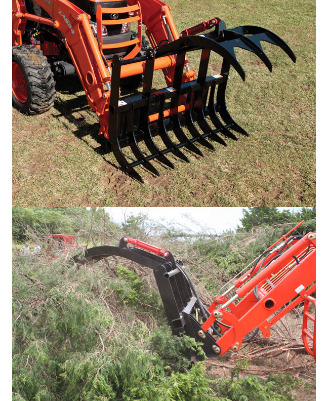

I found this thread recently while comtemplating purchasing or building a grapple. This grapple is awesome!...and it gave me the confidence to build my own. In fact, I have a 10-year old son whom I want to teach to weld, and more importantly teach that we men don't have to buy everything in our lives.
But...I have a question. I have seen some grapples with a design similar to this, where the bottom tines are 25-30" or more long. I have seen other manaufactured grapples where the bottom tines look to be 12" long, and the back of the grapple is much taller. It seems that the latter design would be stronger, but would put more reliance on the top grapple for holding the load (which is probably already pretty important)
I am hoping you guys with experience can give me some advice on this topic. I will be using the grapple to pick up logs, brush, some rocks, etc. The first primary use will be to clean up some log/dirt piles on my property left by the excavator. He used a dozer, and too much dirt was mixed in with the logs...preventing a full burn. I need to sift the remaining logs and brush out from the dirt, pile them, then burn them.
For reference, I have attached a picture of the newer model grapple I am referring to
   / Home made Grapple #57
I found this thread recently while comtemplating purchasing or building a grapple. This grapple is awesome!...and it gave me the confidence to build my own. In fact, I have a 10-year old son whom I want to teach to weld, and more importantly teach that we men don't have to buy everything in our lives. But...I have a question. I have seen some grapples with a design similar to this, where the bottom tines are 25-30" or more long. I have seen other manaufactured grapples where the bottom tines look to be 12" long, and the back of the grapple is much taller. It seems that the latter design would be stronger, but would put more reliance on the top grapple for holding the load (which is probably already pretty important) I am hoping you guys with experience can give me some advice on this topic. I will be using the grapple to pick up logs, brush, some rocks, etc. The first primary use will be to clean up some log/dirt piles on my property left by the excavator. He used a dozer, and too much dirt was mixed in with the logs...preventing a full burn. I need to sift the remaining logs and brush out from the dirt, pile them, then burn them. For reference, I have attached a picture of the newer model grapple I am referring to <img src="http://www.tractorbynet.com/forums/attachment.php?attachmentid=344080"/>
The grapple type your photo shows and you describe is known variously as a claw or rake or RBG or clamshell. It is indeed quite different from the more common longer bottom tine grapple. The claw style grapple works essentially the way your hand does when you pick something up with finger and thumb when fingernails are pointed up. You must use your thumb in a pinscher grasp. The thumb holds the item firmly against the finger and that allows you to lift the object. The long bottom tine style, variously called open bottom, L shape, and other names works the way your hand does when you scoop something up with fingernails pointed to the ground. Gravity keeps the item in your palm and the thumb just steadies the load. Indeed, you can even lift something without the thumb so long as the item is balanced.
Both grapples have advantages but in general, the open bottom or L type is less expensive and can carry a larger load of solid irregular sized objects. Same as your hand. See how many pencils you can grasp with fingernails up. You can certainly pike more than that into your open cupped palm with fingernails pointed down.
The claw style excels at grabbing brush or at picking up small debris. It also holds a single log more securely.
The open bottom style holds much more volume so you can load multiple logs at one time. You can scoop more because you can get the bottom tines under objects. Because the top grapple jaw just stabilizes the load, you can grab one item, move to another spot and grab another easily without having the first item fall out when you open the top jaw a second or third time. Indeed, you can lift and carry something like a big rock without even closing the top jaw because gravity holds the load in place.
Another major difference between the two basic styles is cost. The claw type grapples are much more expensive and heavier because they require full width upper jaws that have to be just as strong as the bottom short jaw. With the open bottom style the top jaw just stabilizes the load so it doesn't need to be as heavily built as the bottom jaws.
Weight is another difference. Claw grapples weigh more so your net lift capacity is less. Not an issue for brush but it can be for rocks and stumps and logs.
In general, unless you have a specific application or reason to have a claw type, the open bottom style makes more sense for most people.
