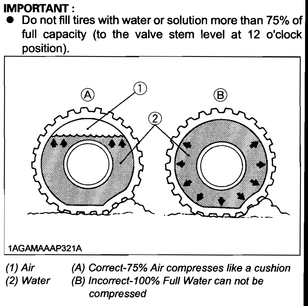

I hear there are setups that you can get out there to fill your own tires. If you do, fill it so that the whole rim inside the tire is just covered. This way you have enough squish in the tire for when you run over a rock or hit a rut and the rim is not exposed to the air in the tire. Oh, and if you have the dealer fill your tires for you when you buy a brand new tractor, the $ should be about $0.60/gal. This, I think, is an at cost price, and they only do it with new purchases.
Edit: Price Correction - I meant to say the at cost price should be about $1.60/gal. My dealer said he put about 50 gal in per tire and that both tires would cost me $150. My tires are 420/70-24.
Good info PhilY, seems easy enough to rotate the tire so the valve stem is slightly above the rim, say 10 oclock and just fill till its full. I checked with 2 tractor dealers, neither does their own filling and 1 of them only uses Calcium Chloride. Ive seen 2 different methods for filling on your own that I have the quipment laying around to do it. One is using a portable air tank and removing the plug and filling with the solution and then pressurising it with air. The faster method is an automotive electric fuel pump submerged in a bucket of your solution. The first method said it can take hours, where as the fuel pump was emptying a 2 gallon bucket within seconds. Do a youtube search, plenty of them out there. I think with either method its important to only put in so much at a time and then burp the system or your going to be compressing the air in the tire which makes it harder to pump in your solution.
/ Home made Rimgard? #11
Also, I was just thinking about the size of the tires that you mentioned. It seems like they could be front tires. If so, I hear that fronts shouldn't be filled if you have a loader on the tractor. I think this could be due to excessive pressure inside the tire since there would not be enough air volume inside to distribute the rise in pressure. With your tires, you should probably put about 21-22 gal in each to hit a 75% fill. At $105 dollars to fill both tires with Rimguard, it works out to be about 2.40 a gal. Not too bad a price considering even Windshield washer fluid is at least $2/gal. I would say the price the dealer quoted you is fair if this tire fill is not being done at the time of the tractor purchase.
PS. I could be over a bit on my gal/tire calc. as I am not sure how thick the tire is. I took off an inch, but I may still be high.
I put a price correction in my response in post #8. Sorry for the confusion.
