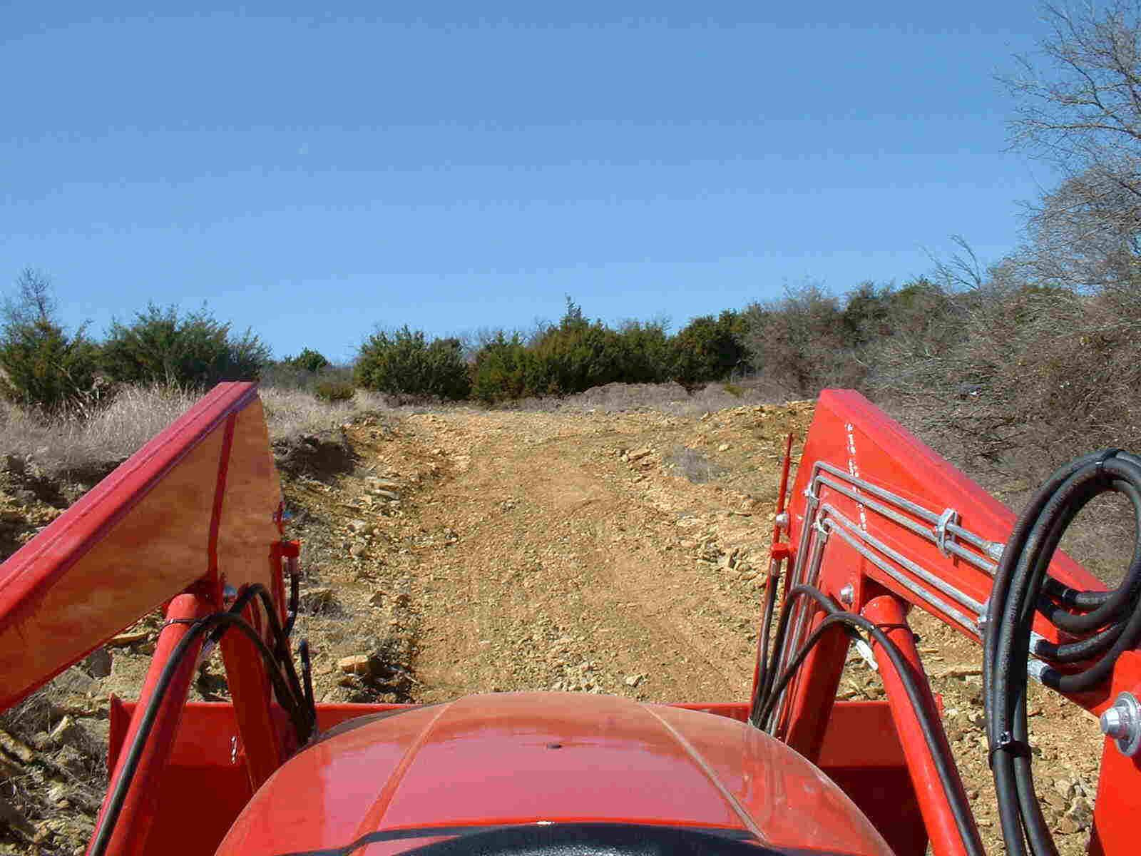

Lots of good thoughts guys - I'll try to respond in a single message so the thread doesn't grow so fast...
Harv - Thanks for the compliment! I really didn't intend for it to be a piece of art, but I guess I got lucky. Even a blind squirrel finds a nut every so often! /w3tcompact/icons/smile.gif
I actually have 8 distinct types of soil on my place (it is on an old <and inactive /w3tcompact/icons/smile.gif> fault line. It ranges from sandy loam to clay - multiple colors too. (and lots of rock in places as well.) Some of it should pack pretty well, while some won't. I've actually used the BB to smooth things out a bit, the problem is the ruts that are now filled in aren't compacted, so if you drive down them with a vehicle, although it looks smooth, you get pretty bumpy ride as you go from "new fill" to "original road" areas and it compacts under the weight of the vehicle. I have decided I don't really like that sensation in a tractor. /w3tcompact/icons/crazy.gif
Ewoss3/dummy/pks - Definitely some innovative ideas I hadn't thought of. The main section I'm complaining about is ~1600 ft. long @ grade, so I'm not sure how many "speed bumps" (be it RR ties or trenches) would be needed. The wood chips are an interesting idea too. Not sure how much would be required, but I could imagine quite a few trees would be needed. Got plenty of "trash trees" I need to clear out, but don't have a chipper. Hmmmm.... /w3tcompact/icons/hmm.gif
egon/gerard - Yea, I understand about the vibration thing. /w3tcompact/icons/frown.gif If I could rig up something to add vibration to the rig, that would be pretty cool, but I figure it would also have some pretty serious drawbacks (most mechanical stuff doesn't like vibration - especially stuff I weld together /w3tcompact/icons/smile.gif), cost, and design (I'm a bit better off than Forrest Gump, but not sure I'm up to designing something in that category that wouldn't require constant repair).
The weight thing is also interesting. I did a few calculations using 55 gal drums - w/ H20 I get about 480 lbs. If I use concrete however, I get closer to 1120. The tractor/loader is close to 5K lbs, so I figure that it could probably handle it fine (BB is close to 700 - it did fine going up/dn and it doesn't roll) so although caution is in order, I think I'd be ok.
Vegetation is a good idea too. Not sure how well things will grow on certain areas (there are some areas that it would work REALLY well). I'll have to look into native grass seed...
Keep the ideas coming - I don't think I'll rule out the sheep's foot just yet, as if it works (even so-so) it should be real cost-effective in comparison to some of the other "better" solutions out there. If I only had a bigger budget.... /w3tcompact/icons/frown.gif
PS: Here's another picture of some other sections of my "road"... (rocky section - mild incline)

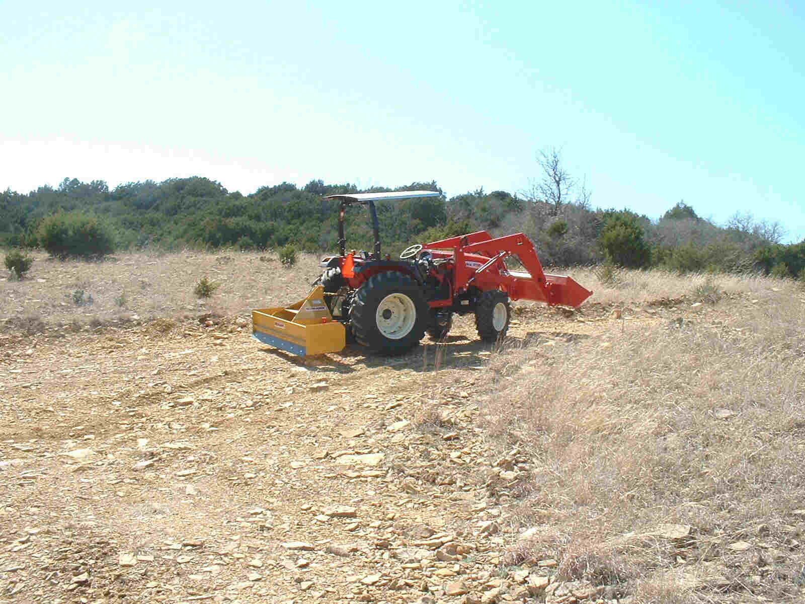

Another pic...

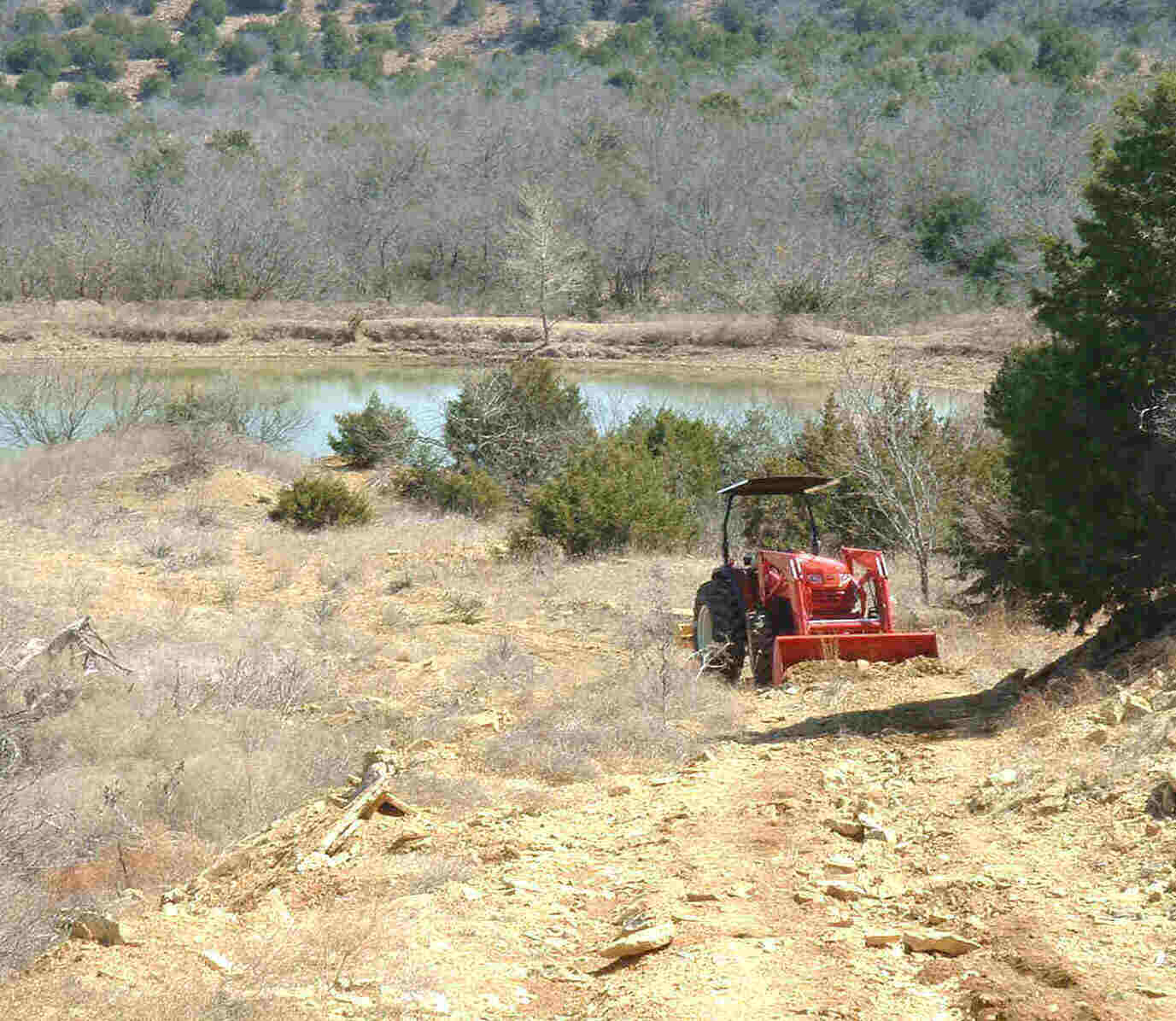

One more....
