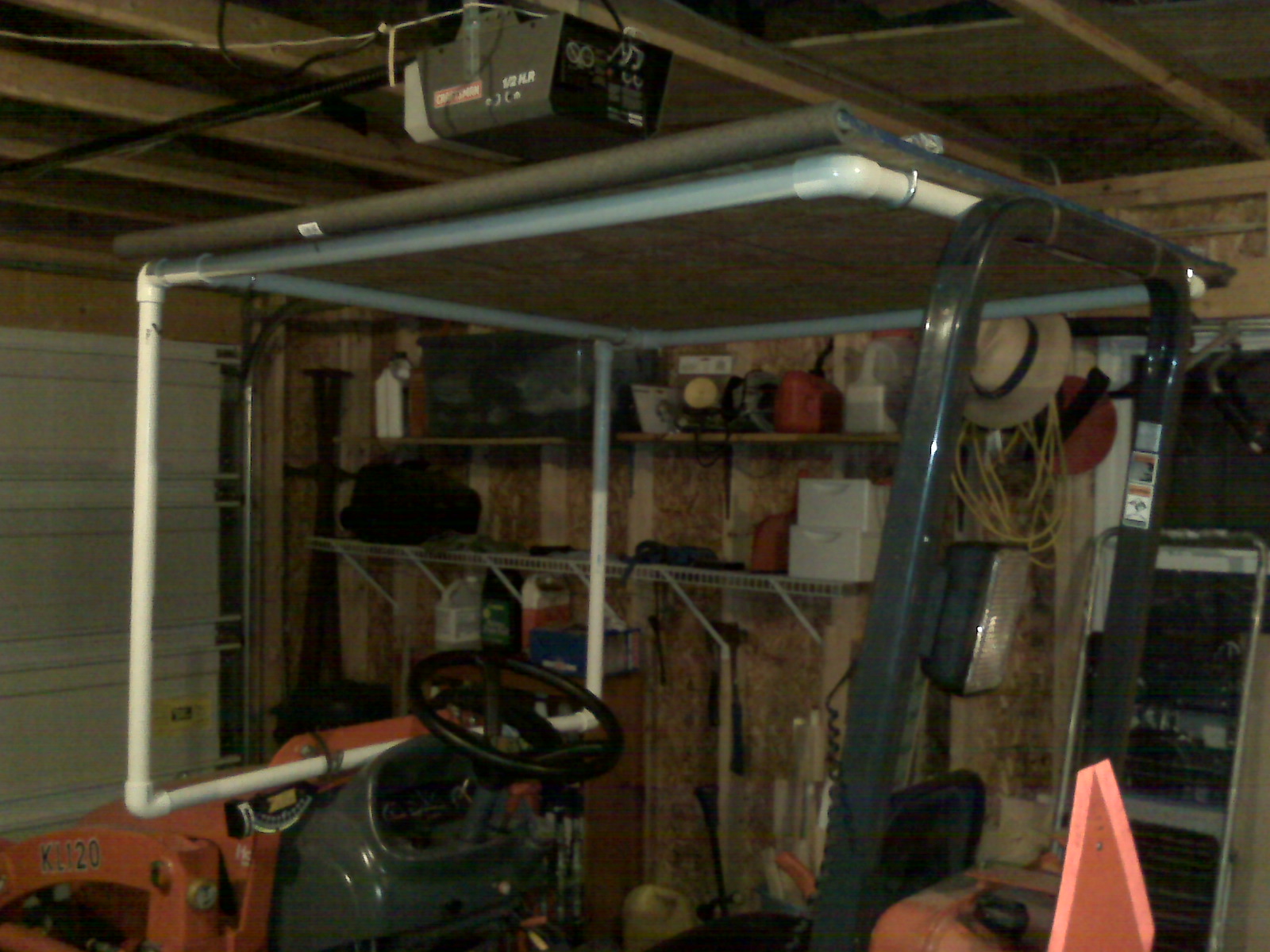

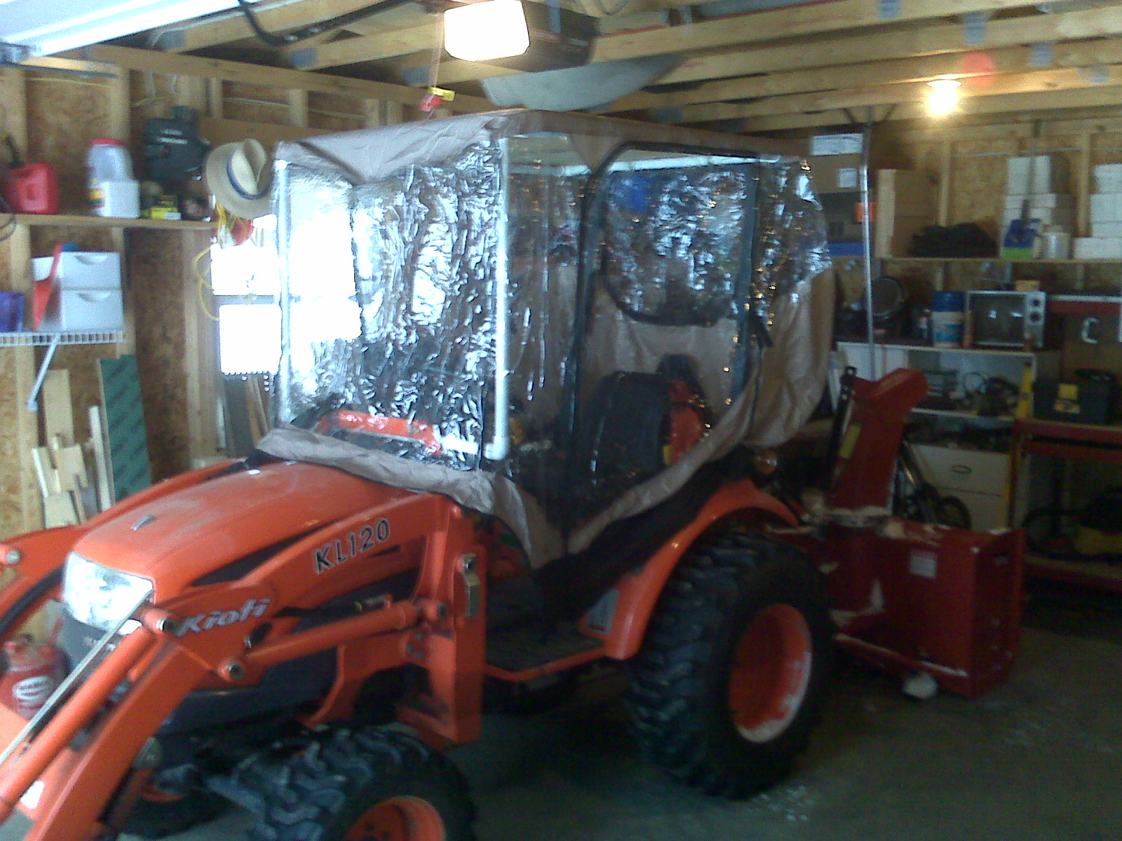

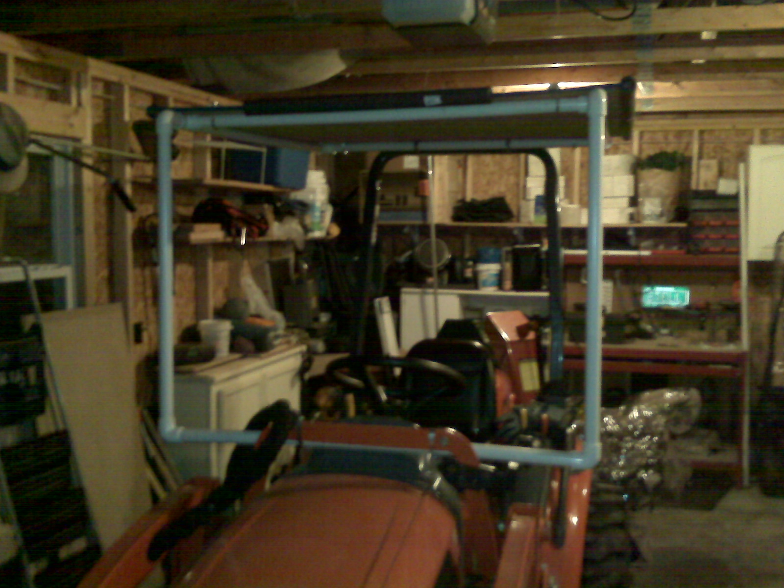

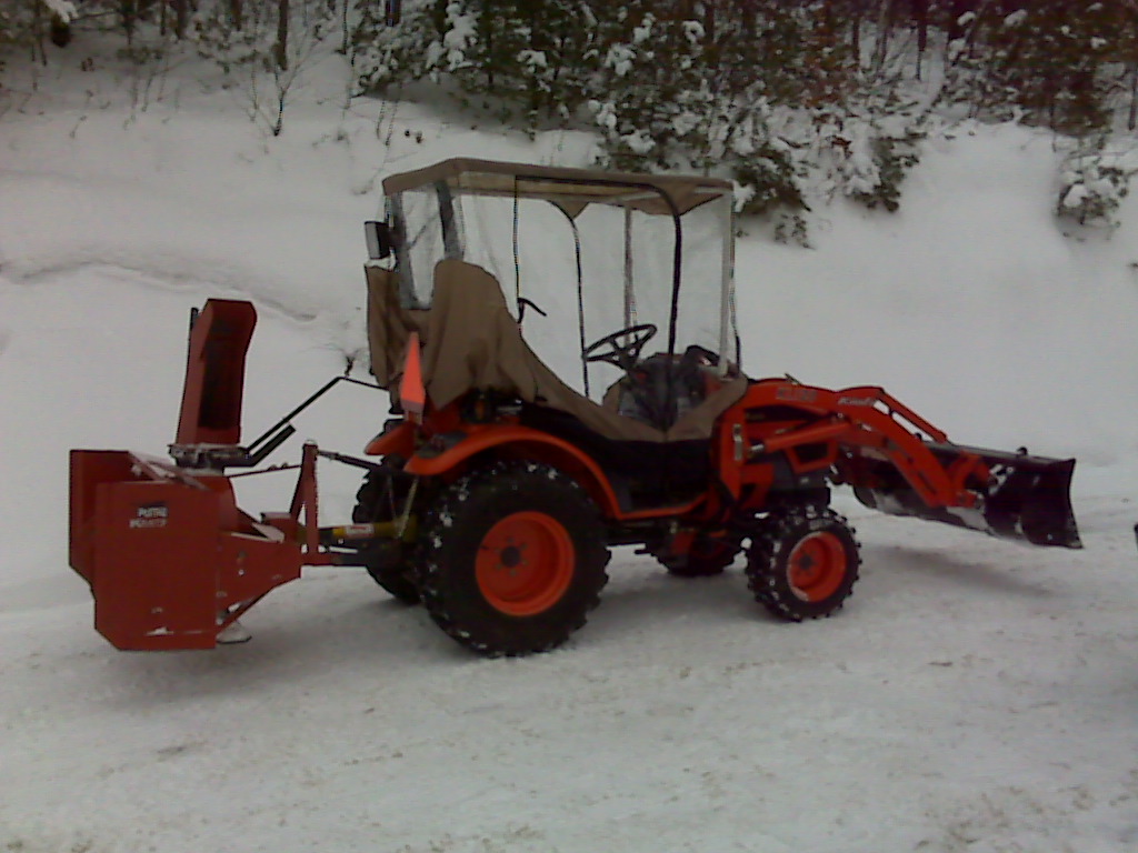

UPDATE:
since it's time to go into "winter tractor mode" i put the blower on this afternoon and will put my home made cab on tomorrow, i just realized that i never posted the outcome of my project from last year.... i thought it might be helpful to others contemplating a home made cheap cab for the winter. as always, the ideas came from some of the other posts on this site, so i just wanted to repay the kindness..... i went with 1 1/2" pvc for the frame, osb for the roof with pipe insulation on the edges to protect the golf cart cover and hose clamps to tie the pvc frame to the tractor. about $85 with the cover... may not look great, but it works... a couple of pics....

nice job. it looks like it will do the main job of keeping blowing snow and wind off of you. also, easy to take off for the warmer weather....
jim
