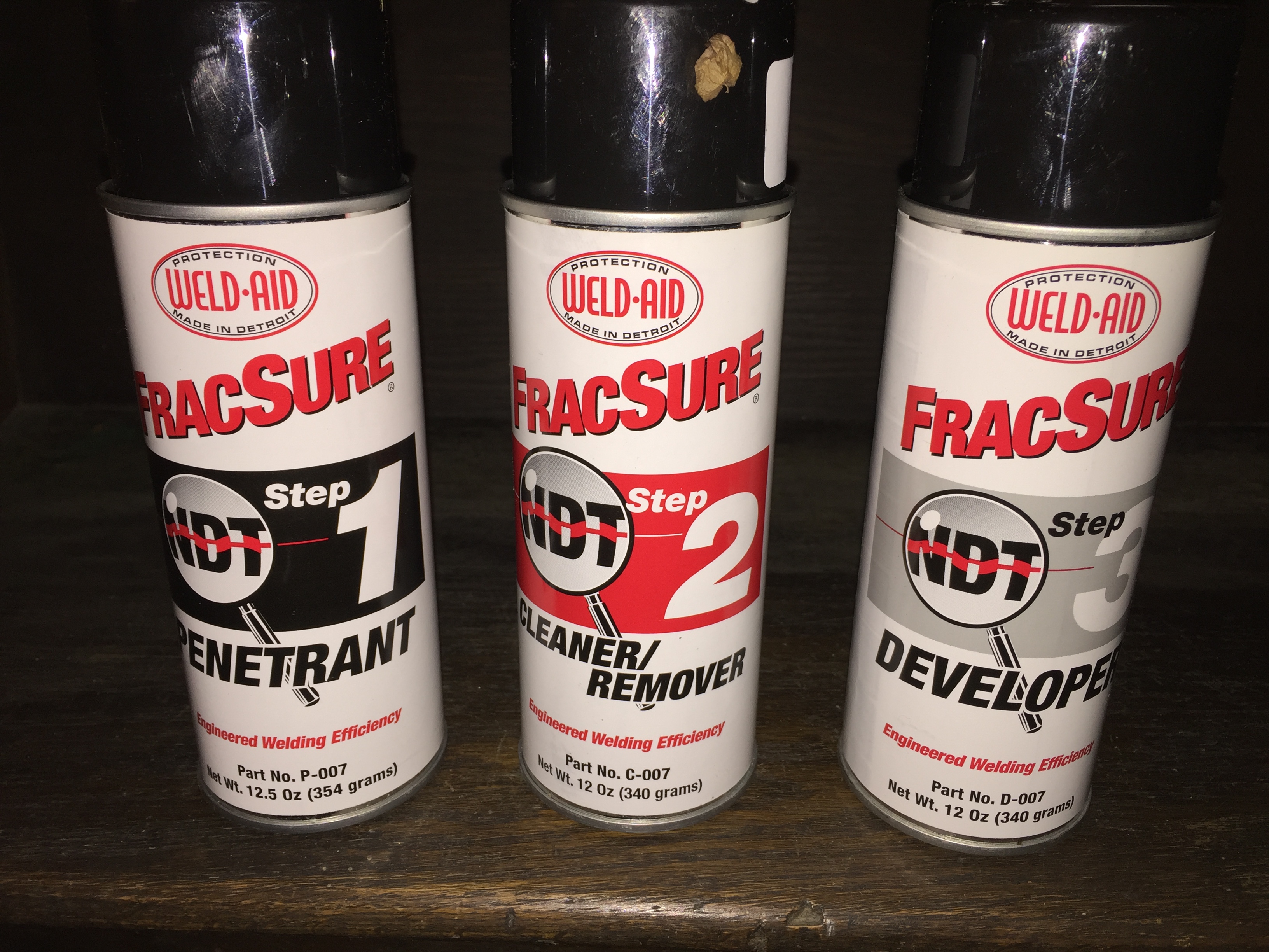

Well, the FracSure came in today. You'll need three cans of product, each costing around $10. I got mine from Grainger and the labels can be seen in the one photo.

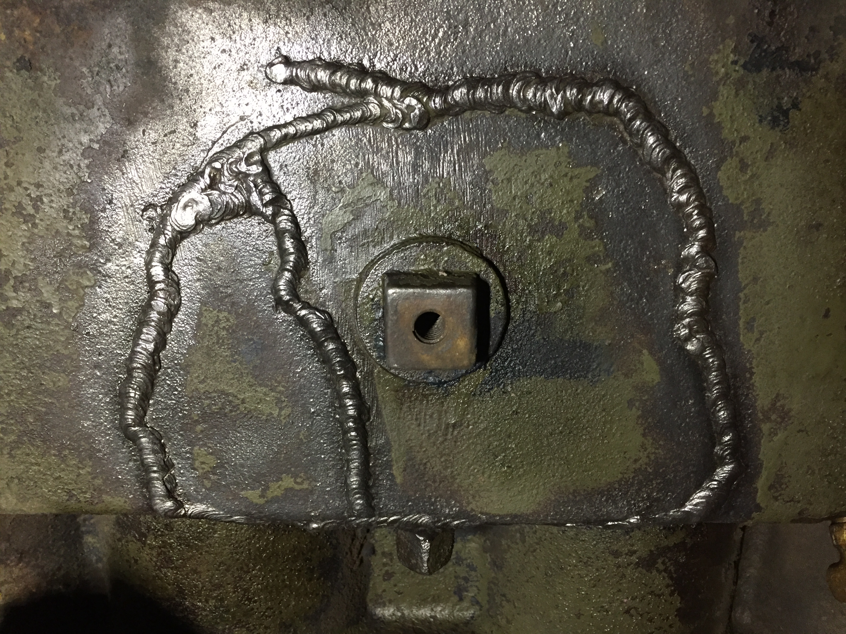

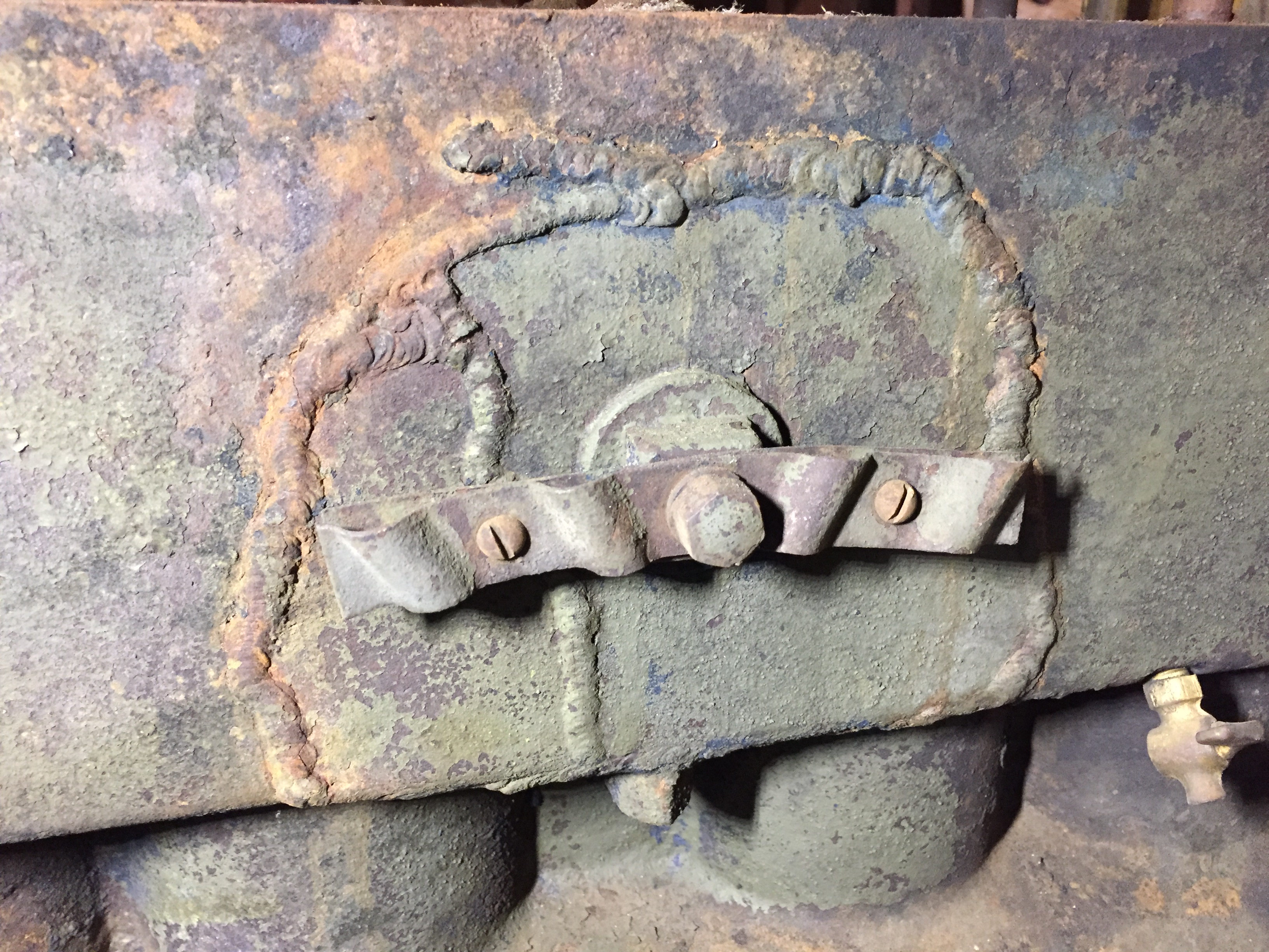

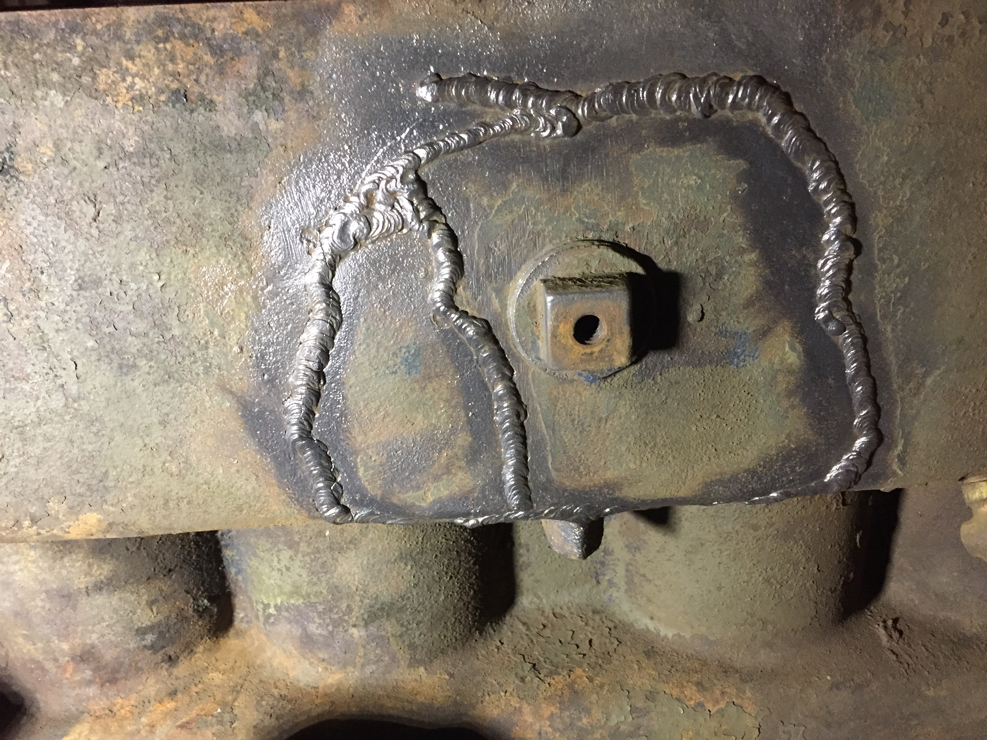

I started by wire brushing as much of the paint and rust off as I could reach. I then wiped the bare metal down using lacquer thinner.

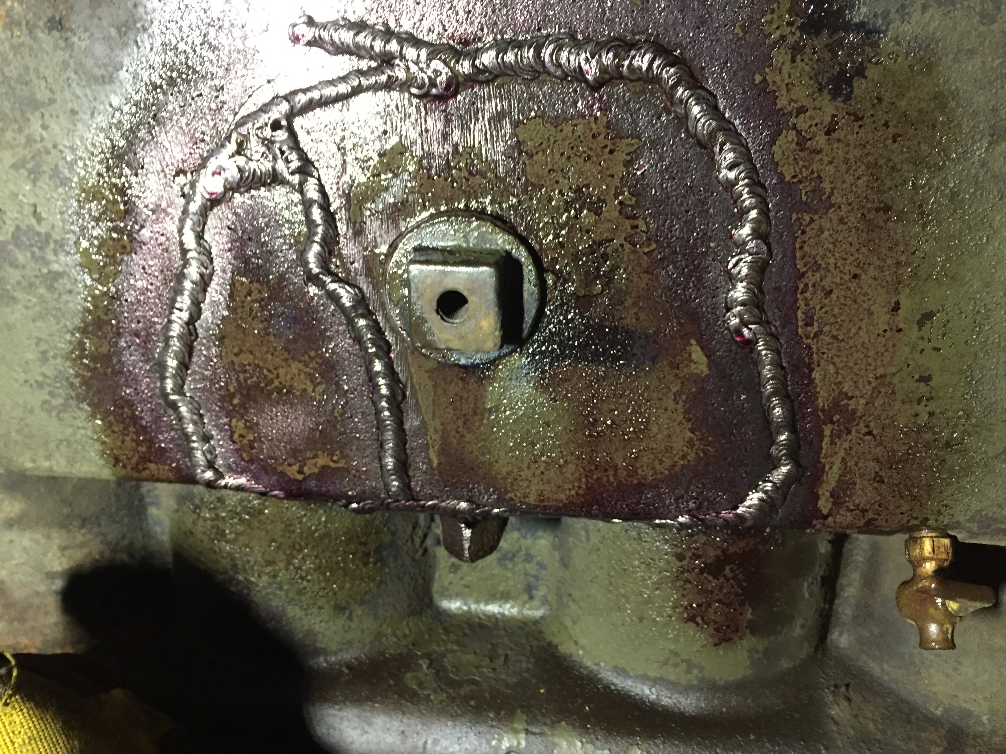

Following the instructions, I then wiped the area down using the part 2 cleaner. Once that dried I then sprayed on the penetrant. The penetrant is like a very thin paint and it didn't take much. I had waited until the surface was dry, but should have waited a bit longer until the cracks had dried. The next step is to use the cleaner to wipe off the excess penetrant.

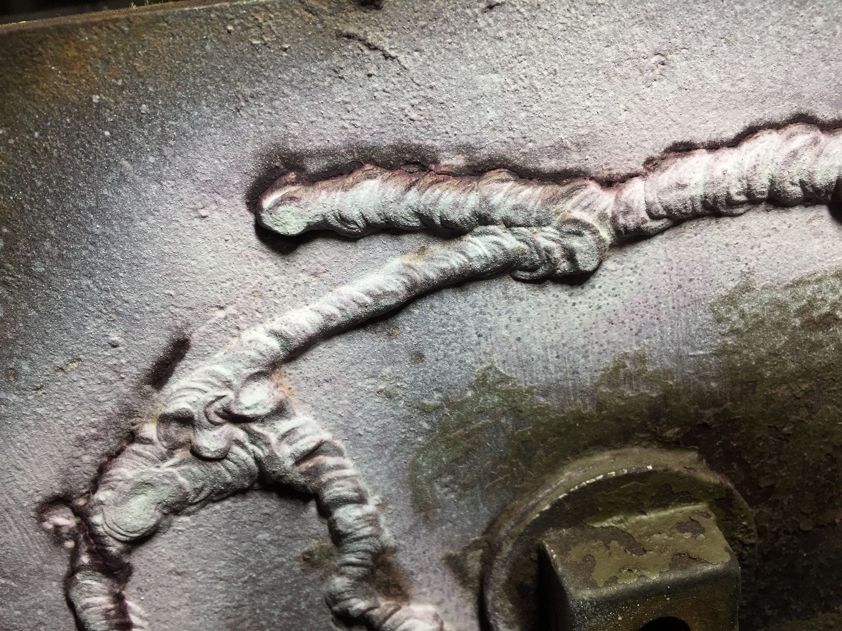

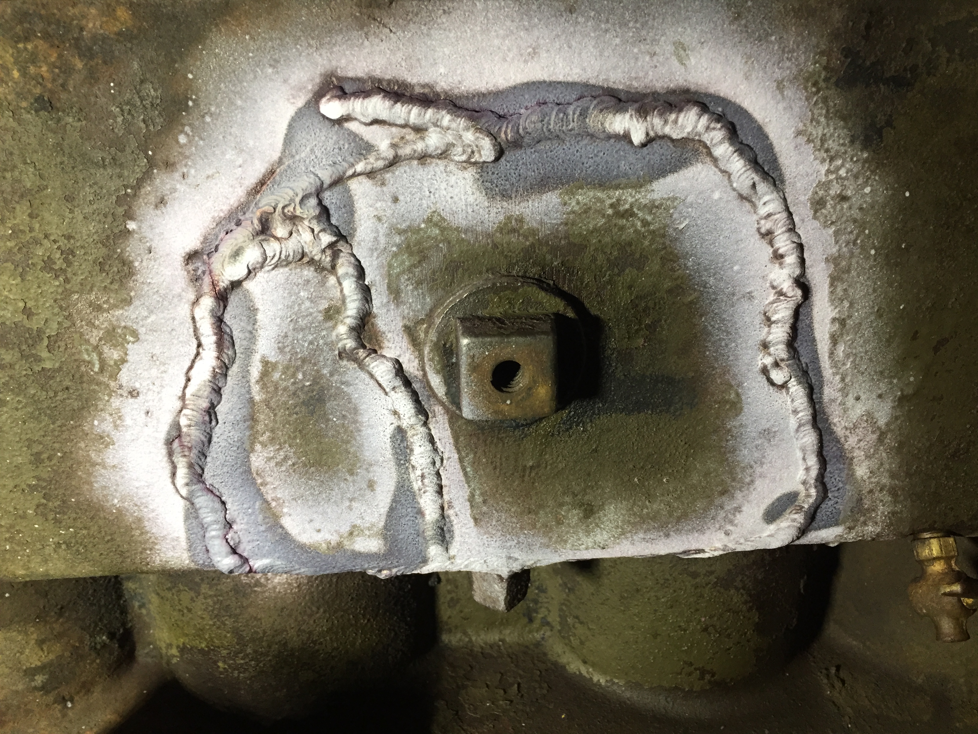

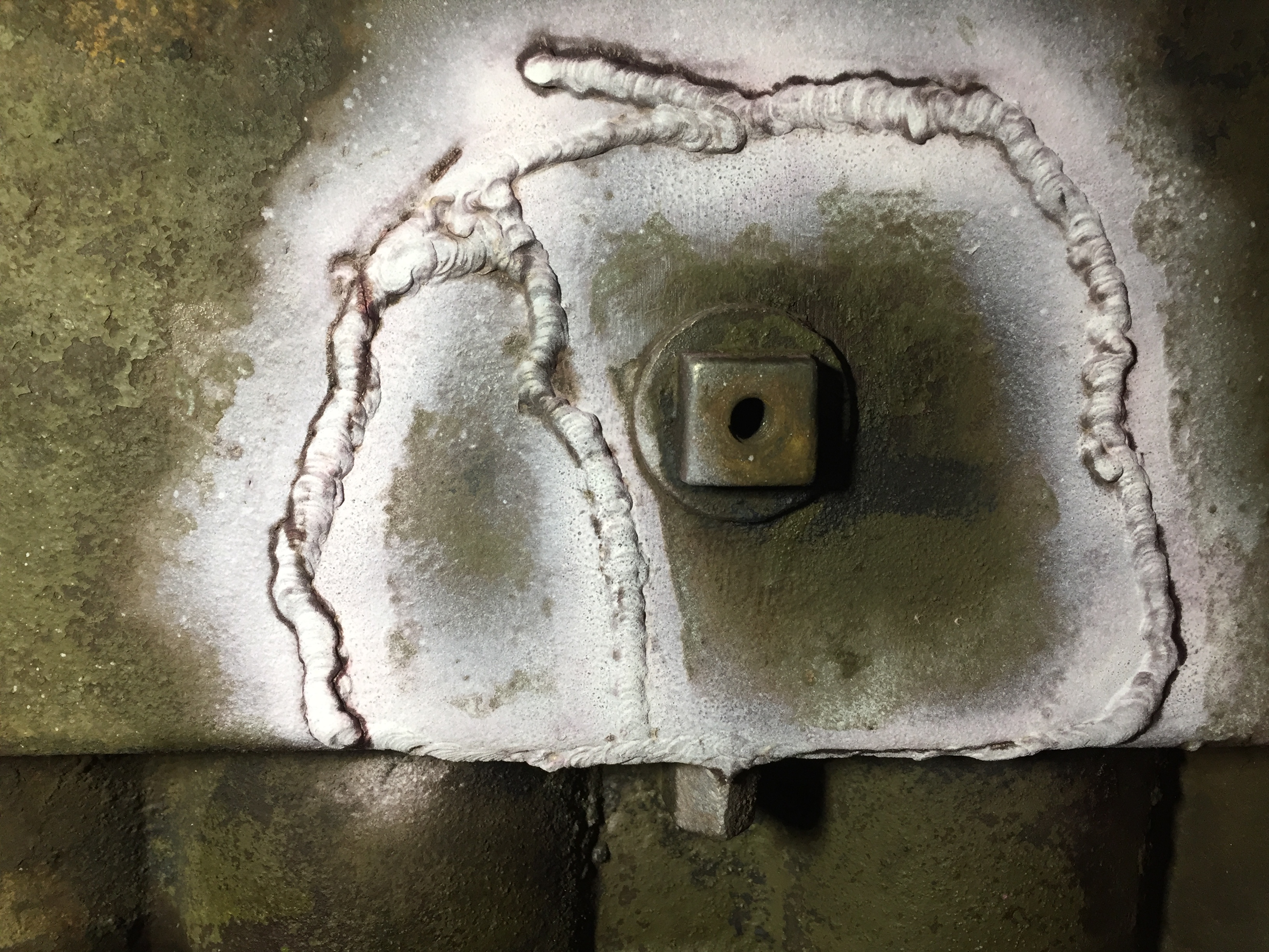

The final step is to spray on the activator. This stuff sprays on like a talcum powder. I must have shook the can for 15 minutes before the mixing ball broke free. Even then, I had to keep shaking the can while spraying so the straw could clog. The cracks didn't show up right away, but 5 minutes later...
   / Home shop crack detection?
#26

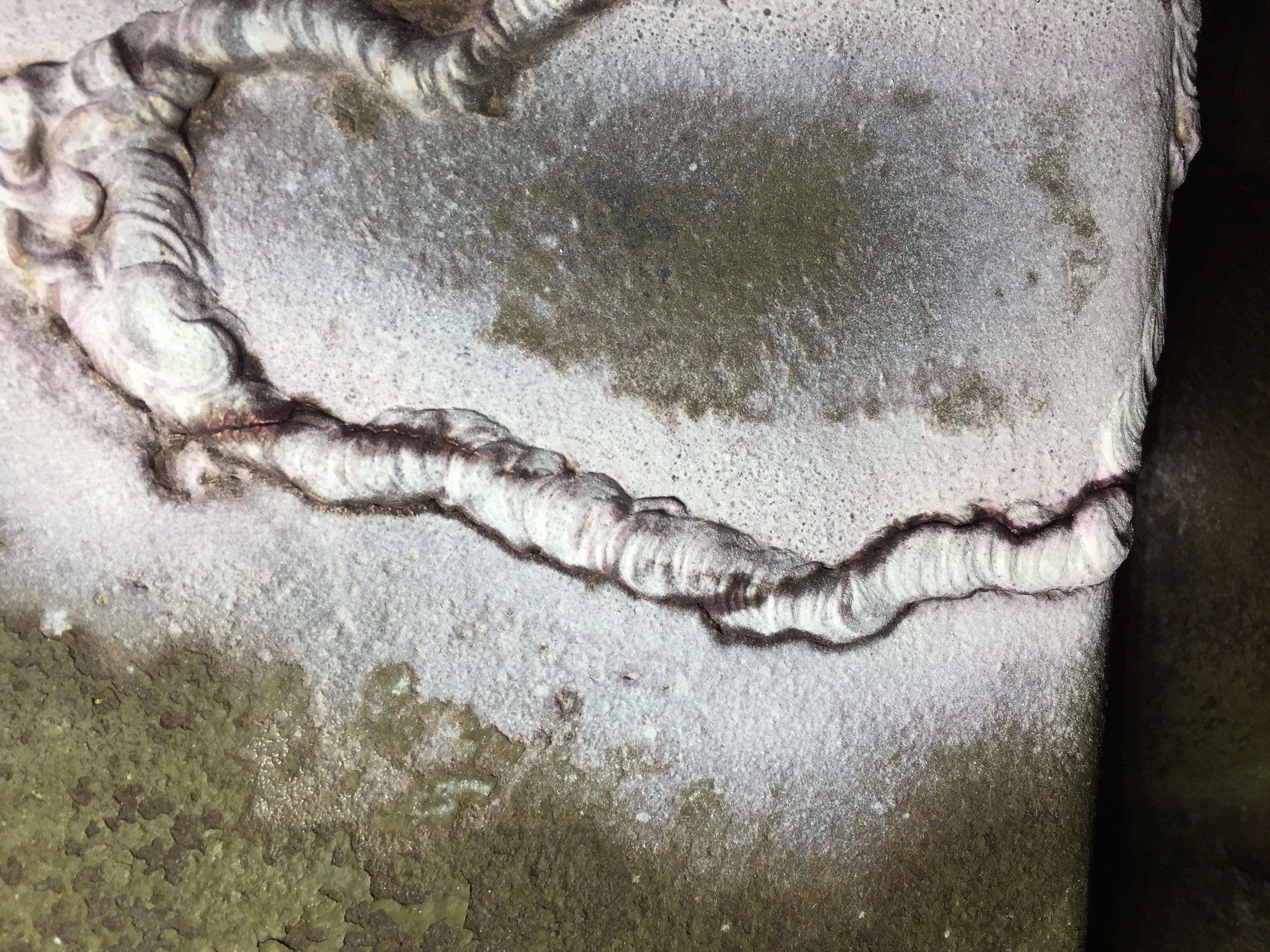

...the cracks become pretty apparent. Not as crisp as magnaflux, but magnaflux only works under black light. With this process I can grind on the cracks and if I lose them, then I can reapply the product. I'm pretty satisfied. It saved me from having to grind out the center weld which was not cracked and I was able to find some additional cracks that I couldn't see before the process. If you compare this picture with the painted or wire brushed photo you can really see the hidden cracks that are now highlighted.

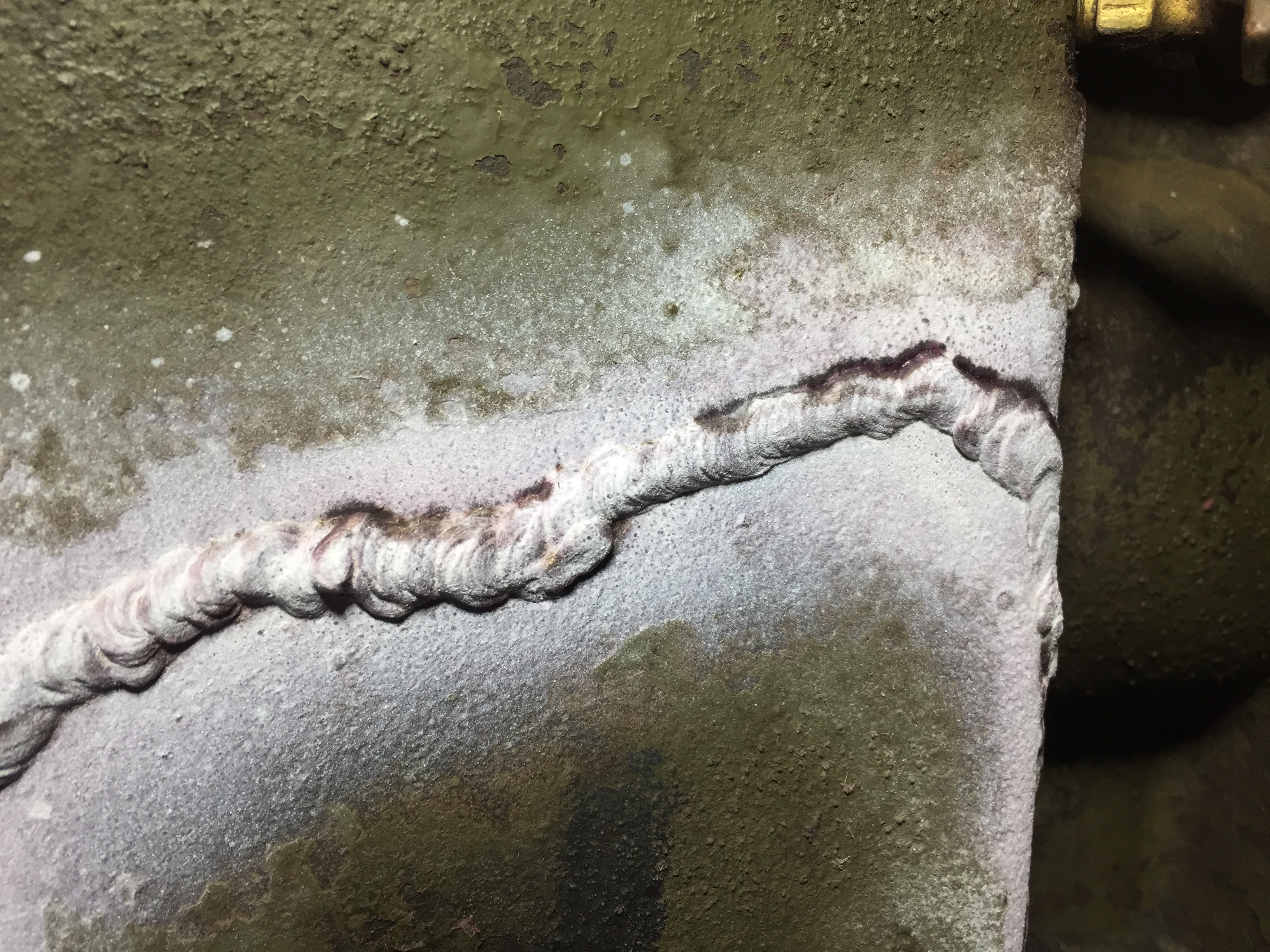

Couple close up pictures showing the cracks. Some of these photos are rotated, I can't seem to get this corrected. My original approach to the repair was to grind out all of the existing welds. I'm now thinking of just opening up the cracks and welding just the cracks. I'm not looking for a structural repair; just a water tight one.
