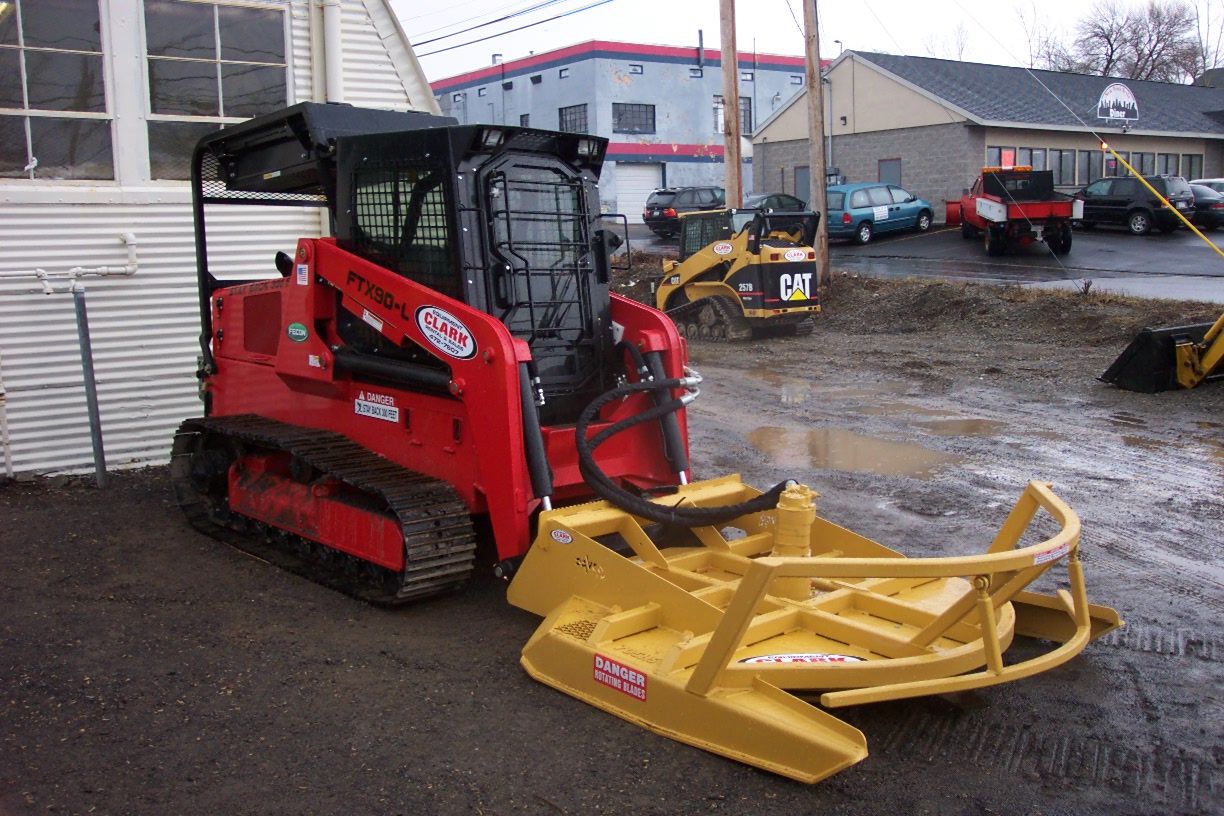

Yes, with a tractor with at least 145 HP. 3/16 to 1/4 in steel deck with heavy duty every thing. A 5 in tree cutter is only $7000. They also make one to cut up to 8 in trees

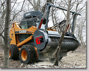

Well JJ posted about the same time I was expressing concerns about a donor deck having the ability to handle 4" trees. I have been around the Brown tree cutters and they are great, it was also on the back of a 100 hp tractor. It still made the tractor work.

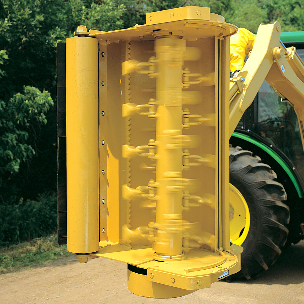

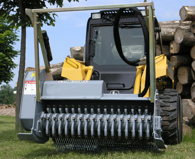

Thanks MarkV MedicShawn and JJ,
Those cutters would be ideal for heavy chipping and mulching, but the flow rate required is way over my machines capacaty. I think my best bet will be to build a five foot or less blade cutter and build it fairly beefy, and just dont use it beyond its means. If I tear it up I will probably be having fun anyways!

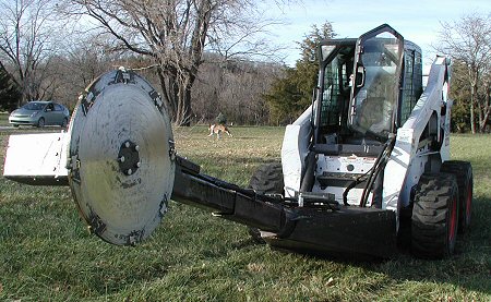

I have 2 1840's right now that I use in my business and at my day job. Im gathering the stuff to build a mower for it to. I think someone here already made one for a friend out of an old hog. I had a saw I made for mine but I didnt have the hydraulic motor vale that lets fluid flow it kept straininging my hydraulic relif valve when I let off. On my cutter I want to put an overrunning clutch on it the motor to the pto shaft to let it coast. Also on the brown cutters what makes them so much better is they have 4 somtime six blades. Thes like putting a fine tooth blade in a saw to to take the shock on the gearbox.
In Votech we made a special stump jumper for an old man that was cleaning up an old feild. We took a 1 1/4 plate and made a flat stump jumper and then bored the cener out and pressed in a splined drive hub and welded it in. We then set up in the mill and rotary table and drilled 4 holes around the edge and put in bush hog bolts. He had the back of the hog cut out to back into pine trees slowly and then it would hack into the base and when they fell over he would mow the limbs and left them laying on the ground flat. He also had us make an adjustable pusher bar to kinda tilt tehm over to make them hack at the bend in the base. Later on when the old Hurricane or hot saw heads on feller bunchers were getting replaced by the newer saw heads every loggger had one in the scrap pile. This same old man had us put a large gea box off a big bush ho and we built a deck for it. and the hitch an left about 1/4 of it open. Then he brought us another splined hub and one of these 3/4 inch saws with a bag of carbide teeth that went with it. we hae t o make a bigger adapter hub but we welded it in place and then bolted it to the mower box. Later we went too see it work man it coull te some trees out backing up. He later put it on a 240 IH that he put a wide front end in. It was the same 240 that hade the reversible box so it could be used backwards as a cotton picker. He efectivly made a super cutter tractor. The man inherited a place in TN and I lost track of him. Hes was sure a go getter and cleaned up alot of land with these 2 machines we made.

BRUSH CUTTER A 4 in tree is not brush
Haha you havent been in East Texas. If you add a little extra metal to the deck and open the front you should be able to cut 4 and 5" brush pretty easy.
Long as you aren't tryin to cut hardwood everyday.
If you can spend $1500 on your own it beats the **** outta $5K plus for a manufactured one
