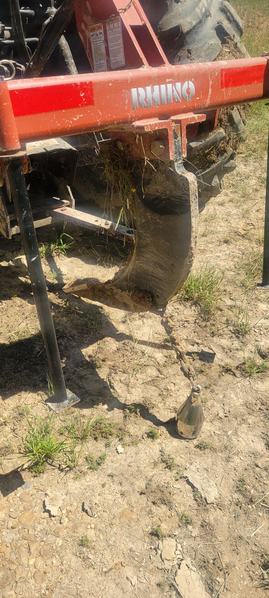

I realize you probably don’t have enough steel but a parabolic shaped shank will lift and shatter the soil better than the shape you have drawn. Either will take some power going deep. I believe allow around 40 - 50 HP per shank and you will need heavy tractor to tie the power to the ground.
Seems like standard spacing on most subsoilers is 30” but that may be based on corn rows being 30” centers.
Works best here to get under the hard pan
