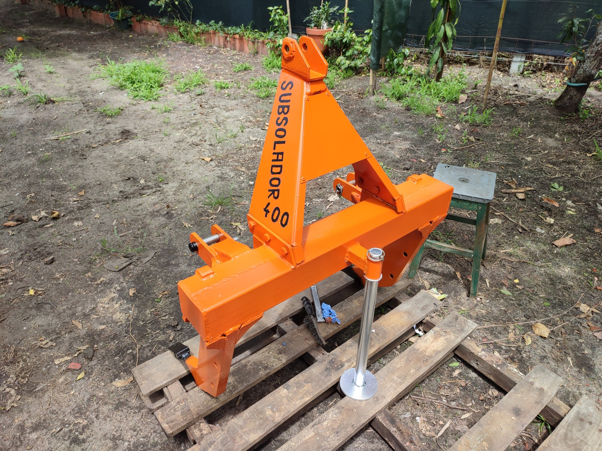

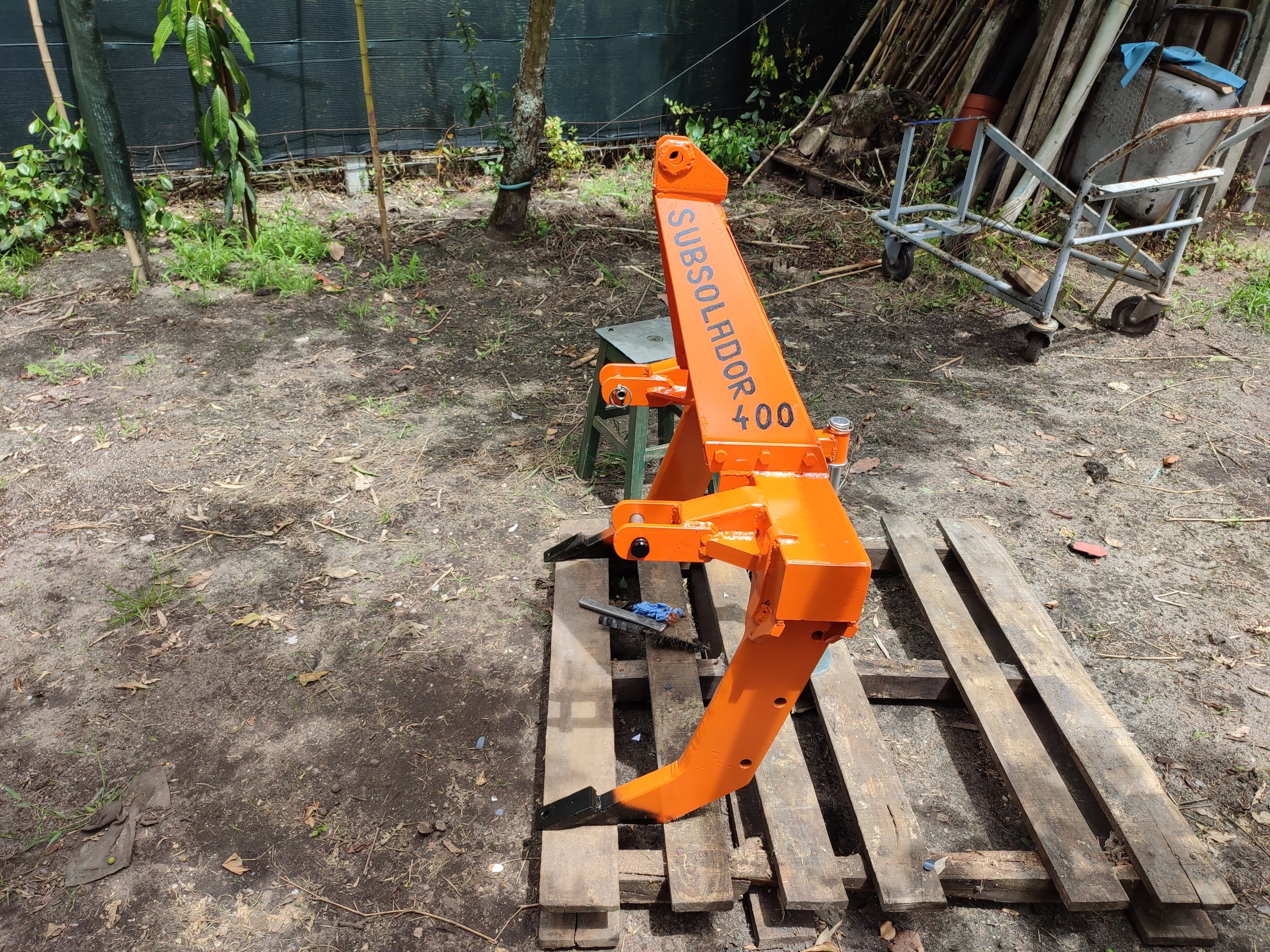

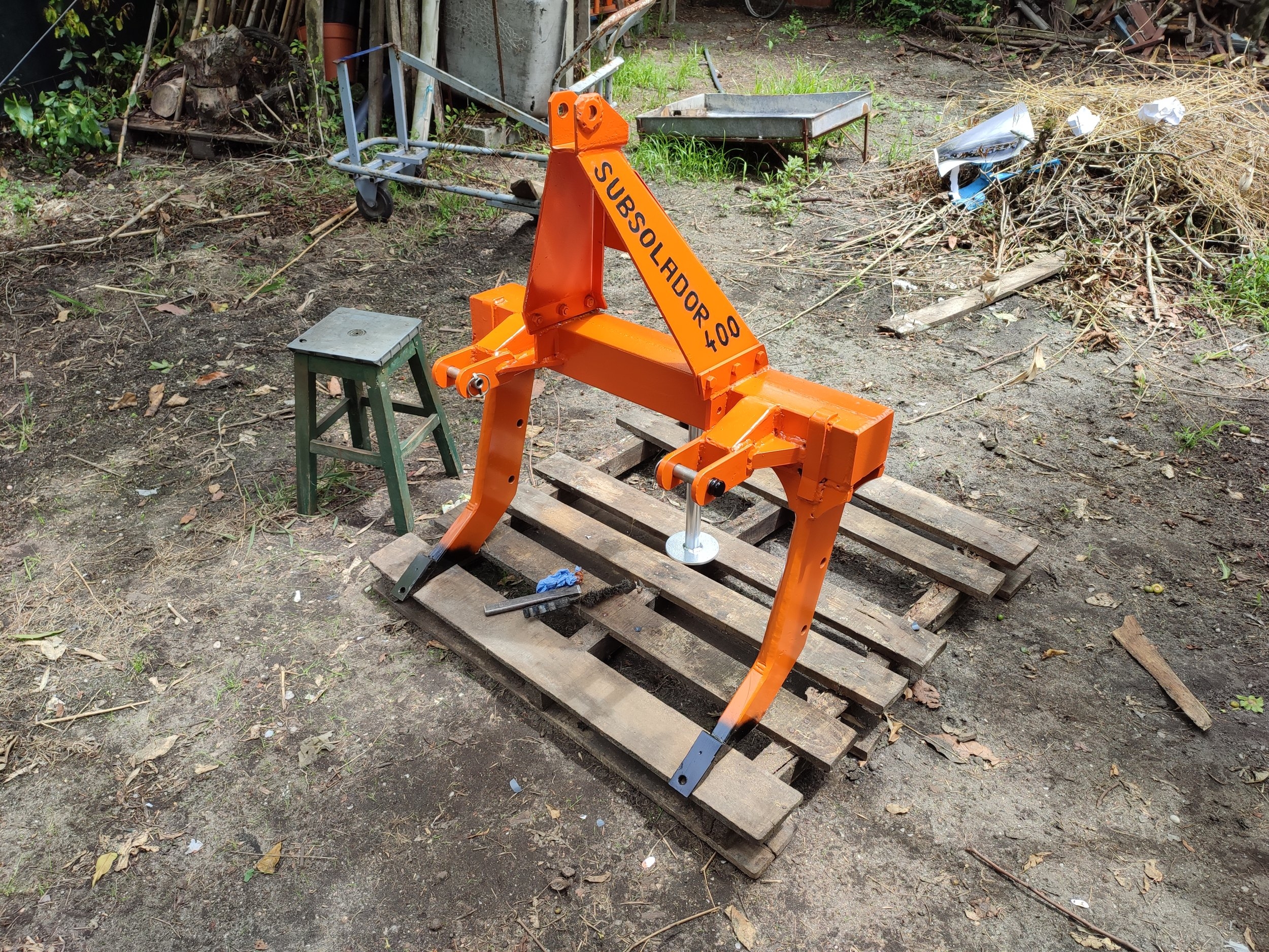

It's officially done. All nice and painted, just don't look too close. :)
More testing to go, specially with the draft control. Just checked the manual to tune the linkage for deep ground engagement work.
Today, I did use the rototiller on the olive grove, where I did all the sub-soiling work. It was a major improvement as the tiller went deep and everything went a lot smoother.

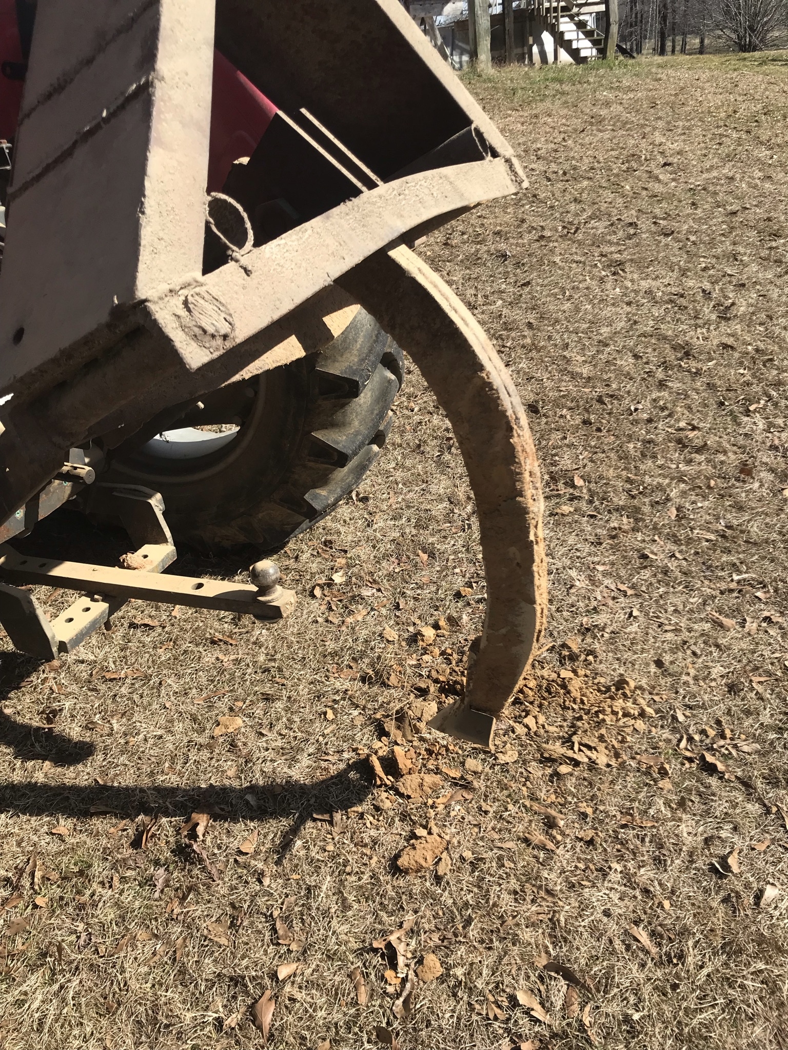

Looking rough but its all my 4025 wants. At times the beam will drag. Stump pulling bent the 10in frame
Plow is from root rake off a dozer.

I imagine the wide tip also requires quite a bit more traction to pull. How deep does it go?
   / Homemade 2 shank subsoiler #69
I think maybe about 24 inches. Really needs a lot of moisture to get deep.

View attachment 805422 View attachment 805423 View attachment 805424
I missed this thread last year!
Why "400"? This looks like at least a 500.
