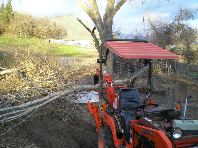

Hey, we had a bit of snow this week, had some losses from my old-growth cottonwood. Nice to have the thumb so I didn't have to "mud it out" ... see attached. I pinched it in the wrong place and it tried to yank my machine over ... I've pinched the wrong parts before and knew just what to do ... drop it and run before she can grab her gun :eek:

I so love your projects Rob. I was waiting for this one to be compleated. I don't have a hoe or any intention of getting one so I had nothing to realy add but it was fun to watch you work just the same. As I watch you guys play with the thumb I realize that as adults we never seem to loose the child inside. I see 2 boys and a little girl in a sandbox with a big TONKA truck LOL. You are truly an amizing individual. The vidios are great, I did miss the sound on the last few, is nice to hear the tractor while your working. Looking forward to the next one
