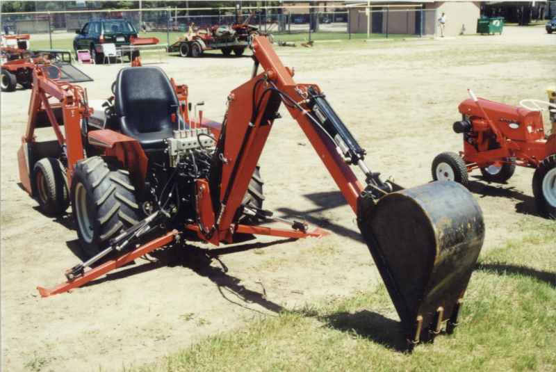

powermaxpaul
Jun 29, 2002
6
Mt. Horeb, WI
Simplicity 9020 (2), Simplicity 4041 Tractor/Loader/Backhoe
I built this backhoe for my Simplicity Powermax 4041. If anyone is interested I have CAD generated plans available. The prototype has undergone some changes since this pic, and could be modified for other tractors. Tractor should have a loader for front counter weight. Also, like the Simplicity Powermax series and AC equivalents, the tractor should be a minimum of 1400# dry weight.

Very nice work. What was the approx cost of the materials to put this togethor? Is it a straight 3 pt mount or is it tied to the frame of the tractor as well?
   / Homemade Backhoe
The total cost of parts for mine was about $1600. While this is less than buying a unit, you need to budget a lot of time. I spent quite a lot of time cutting out pieces in my basement with a Sawzall. I had mine professionally welded by a friend, but could have welded it with my Lincoln 225 buzz box.
I've made up a plan package similar to what you'd get from cadplans, that includes 7 pages of notes, a bill of materials, and 8 pages of detailed drawings. I'm currently asking $75 per set to anyone interested.
Max digging depth is about 5' 6" and has a maximum ripping force at the bucket of 3300# at 1500 psi. Unit weighs about 770 lbs.
This is a pic of the backhoe prototype as modified to date:
Paul

I am extremely interested in your design. this looks like a very great and simple backhoe that would suit me well. Is it attached to the frame of the tractor and how easily does it go off and on? also does it run off the pto shaft? any more info you can provide would be great! I would love to see more pics, especially action shots.
derek
   / Homemade Backhoe #6
Did you cut the triangular gusset-shaped parts with the Sawsall? That must have been very time consuming. If you have a decent steel supplier locally, and can give them a drawing, or better yet a .dxf (cad) file, they should be able to knock the plates out on a burn table in about 15 minutes. A couple of shops I used to work in have them, it's amazing how quickly and accurately they can cut complex shapes.
Interesting to hear that you were able to build for the material price you were. I think I'll look at this project seriously once I get a tractor. This being poor stuff sucks! Nice workmanship and design on your BH. I can't see enough detail, how did you handle the pivot of the backhoe at the #PH?
