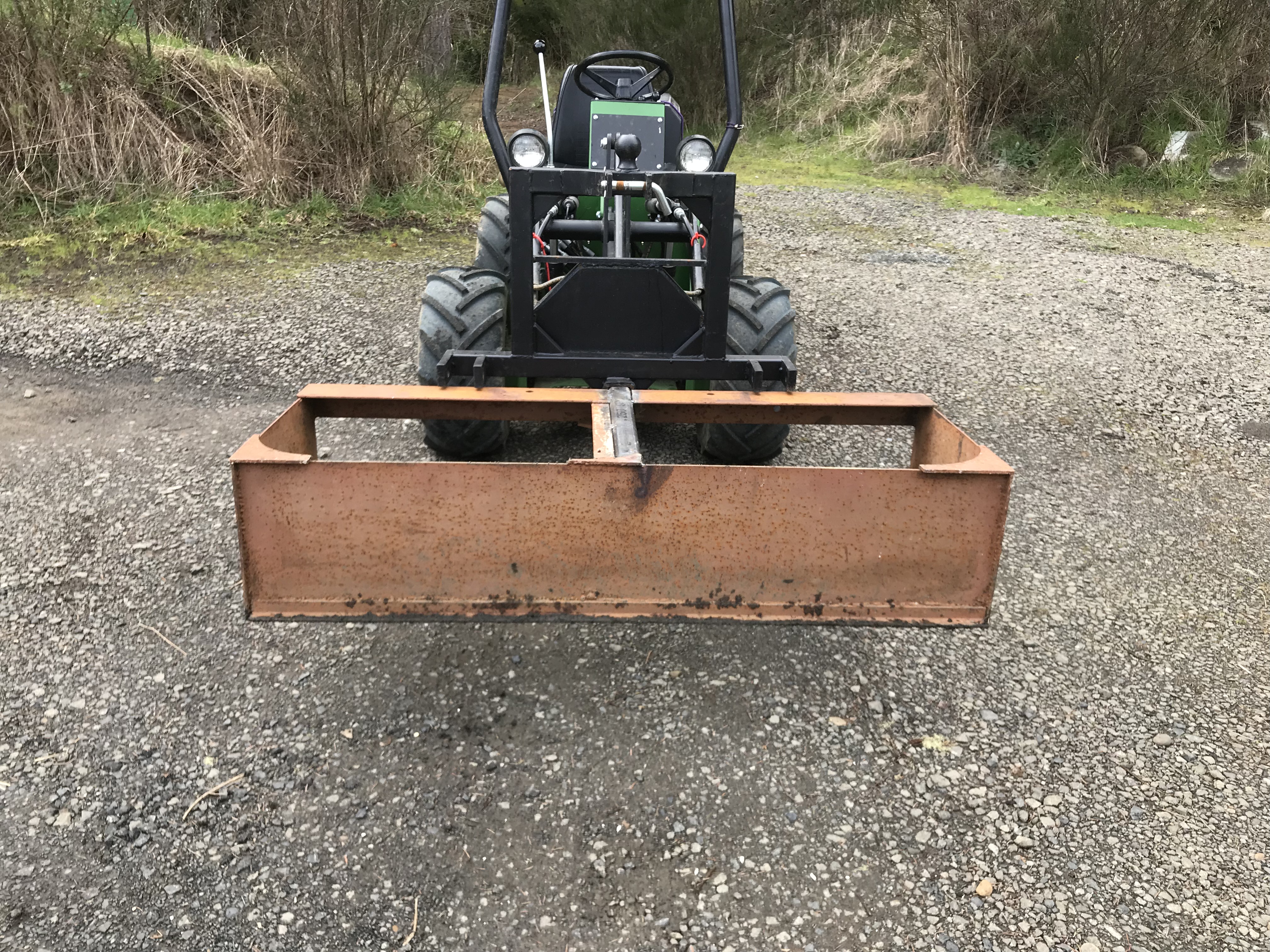

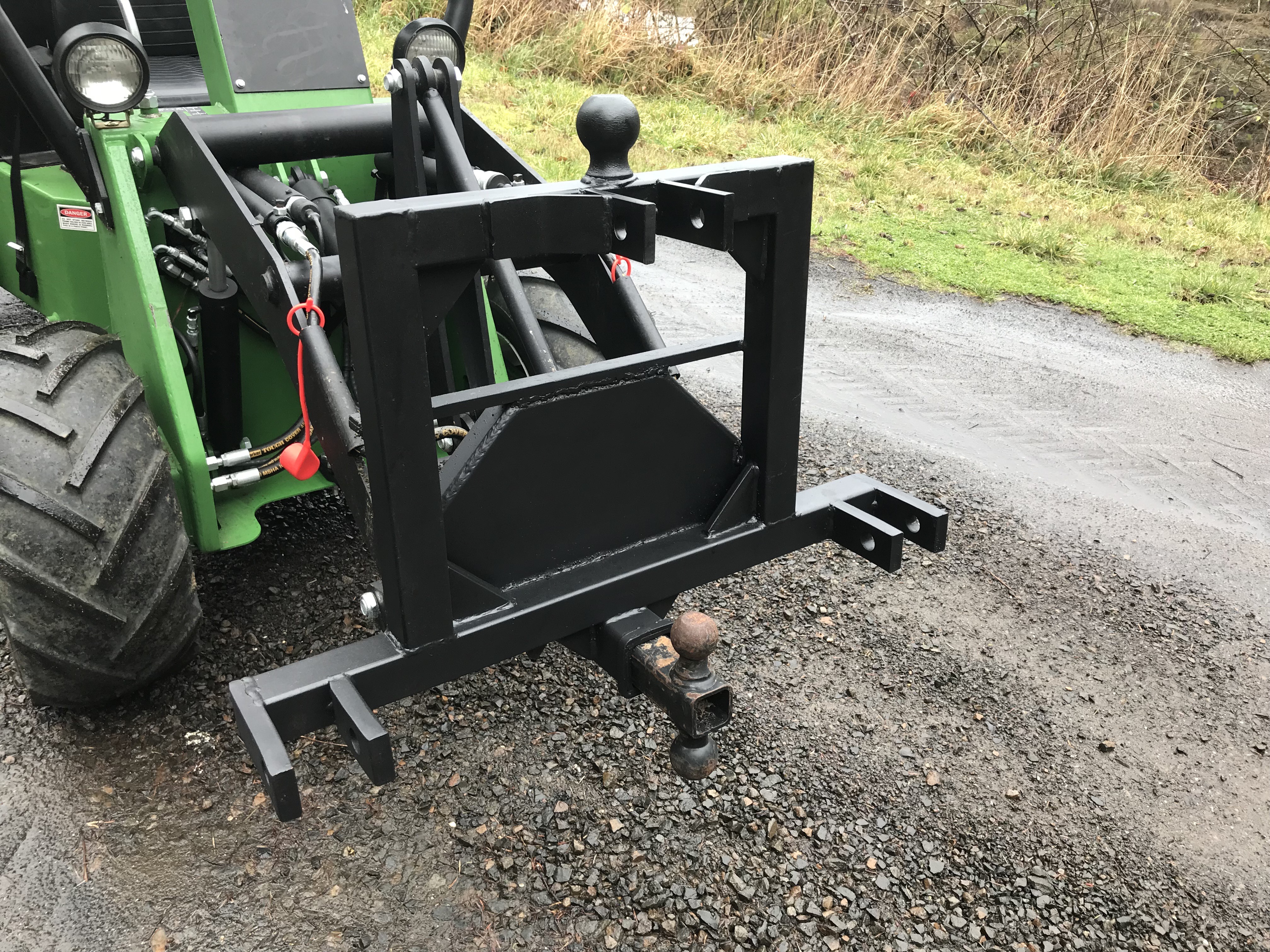

It would be very easy on your set up to add the 3 pt hookup. For yours, you would just need to weld on a plate with a hole in it and then slide a pin through all 3 holes.
The box scraper I built from scratch is 54" wide. I wanted something a little more than 48" but not as wide as 5 feet. It's not nearly as heavy as a commercial unit but that is an advantage pulling it with my 425. I attach it to my 425 using the 3point hitch that I welded to a spare quick attach plate. I still need to weld some pin holders on my scraper to make it a little more firmly attached.
View attachment 549811View attachment 549812

So what do you want to do with the scraper? It may not be the right tool for the job. Can you tell us what your goals are?
/ Homemade box scraper. Push me or pull me?
#24
I have a lot of gravel driveway to maintain. Mostly the box scraper will be used to level the the rough spots. It's light enough that is doesn't overwhelm my 425 unless it's pulling a full load of gravel. I was thinking of having my rear tires filled with fluid to add weight/traction.
I think you should look at a landscape plane. They need less HP and you might even figure a way to push it, altough doubtful.
/ Homemade box scraper. Push me or pull me? #28
There a some made to be pushed by a skid steer, so should be able to modify for a Power Trac.

X2 on the landscape plane. Much better for the task in question. Even if it isn't, putting a single scarifier on the 425 to loosen a problem area would still put you ahead of the curve.
