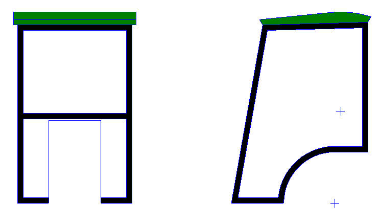

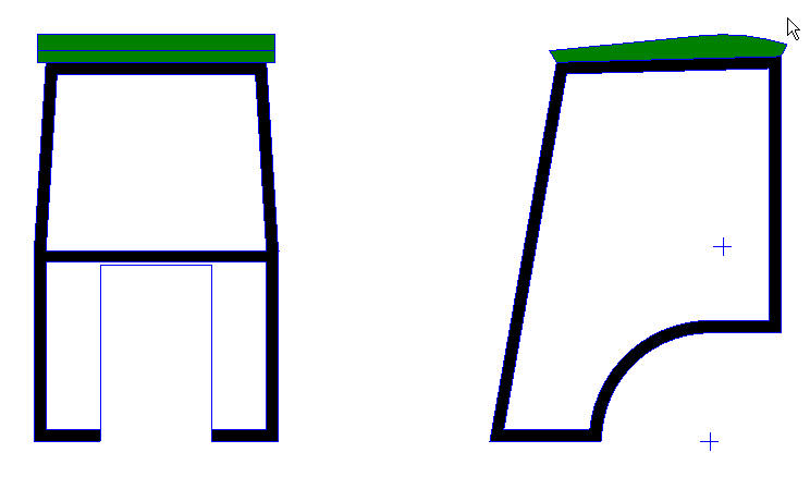

Stage 1. Design and Mockup
The first step was to get out the level and tape measure and get some rough measurements off of the tractor. Dimensions like the height of the cowl above the floor, overall width at various points, etc... I sat in the seat and rasied the loader to determine how high the windshield would have to be to allow me to see the bucket with it fully raised. I tried to judge how tall the door would need to be to get in and out of the cab easily (I'm 6'3")
The next thing I did was to mock up some of the major pieces using 2x2 lumber, a little thinner than the 2x2 tubing I planned to use, but close enough to get the visual and check dimensions...
Even though I had planned to keep the sides straight vertical for easier fabrication, once I had the mockup set on the tractor, I decided that the straight sides made it too boxy, didn't look right, so sloped sides were back in...
Attached are some side and front view sketches done in CAD to help visualize the taper vs. straight sides...
More to come, need to get to bed right now though...

   / Homemade Cab for Deere 2320 CUT #3
Keep us posted on this project and remember, we like lots of pictures.
I would suggest removable doors instead of a removable cab.
The plan is to have the doors and possibly the front and rear windows removable as well as the cab. The idea is, when spring sneaks up on me and I haven't gotten around to removing the cab yet, but the lawn needs mowed, I can pull the doors and stuff off and get by without roasting.
I have been avoiding a permanant cab because we have a few trees with low branches I need to mow close to and because mowing the sides of the ditch out by the road might be a little too exciting with the extra weight on top of the tractor (gets a little iffy without the cab).

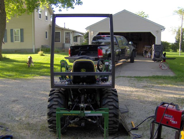

Stage 2.1: Fabricating the rear frame
The rear frame consists of a outer perimeter of 2x2" x11gauge steel tubing with 1 cross piece made from 2x2" x1/8" angle (to save weight) The upright pieces were split through 3 sides and bent inward to give the cab it's taper. The top crossbar also had to be mitered slightly to fit with the sloped sides. THe bottom crossbar and angle bar (which will be what the bottom of the rear window closes against) are straight cut.
Great care was taken to cut the tubes as square as my old beat up chop saw could manage. After lots of measuring, tack welding, measuring, tweaking, tacking, measuring, and tacking, I was able to weld the frame and it stayed very flat and square (to my surprise). :D
Once fully welded, the welds in the bottom front corners were ground flat to allow the horizontal tubes to be welded on. Then, two 1/4" thick plates were cut and drilled to make the mounts. I bolted the mount plates to the tractor, clamped the frame to the plates, got things square to the tractor, and welded them solid. The resulting rear frame is very rigid side-to-side, but without the rest of the cab, it's a little wiggly front-to-back. That'll change when things are all tied together.
