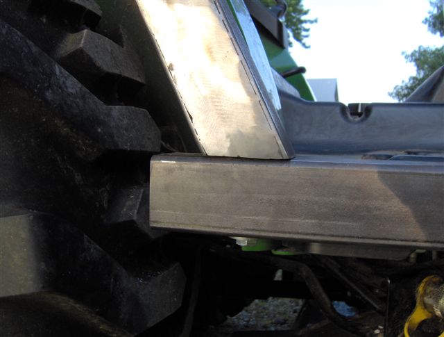

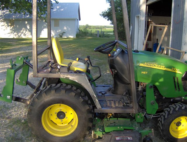

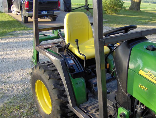

Stage 2.5: "Fender" tubes
Yesterday, I finished up the second roof tube and welded it in place like the first. Really started to get the cab pretty strong.
Next up were/are the pieces to bolt in along the fenders to join the bottoms of the two frames. These are tricker. Originally, I was going to make curved pieces that were 2" wide all the way along the fender. This posed some problems. The biggest issue this would drive was when I got to fabricating the doors, that extra curve might complicate things. I got to looking, and with the factory handholds on the fenders, a "straight-over, and angled down" line really didn't get in the way any more than the handholds do when entering the cab. Plus, that gives me a more normal corner when I get to the doors. So, plan "B" took effect today.
These pieces are basically fabricated channel iron. The twist with "plan B" is that It's not a constant height.
I pulled out the 4x8 sheet of 18 gauge cold rolled steel I bought along with the other steel. Using one of a couple of new toys, err, tools for this project, my new air shears, I cut off a large chunk to set aside for the roof.
Using posterpaper, I did some tracing on the 2 stub tubes from the front and rear frames and worked out a template to trace onto the steel. I cut pieces of 18g 1/8" smaller all the way around than the template. Straight lines were cut with the shear (which is an awesome tool) and the curved part was cut with my other new toy, the air powered nibbler, also cool. Next, I cut and bent/formed 2x1/8" flat iron to form the top and bottom flanges. Some adjusting, persuading, and cussing, and I had them tacked/welded together.
To attach to the rear frame tube, I welded 2 3" pieces of 1.5" flat stock to the inside of the top and bottom flanges of the new "channel". These slide into the tube on the rear frame. I lined up the tube and channel and drilled holes through the tube and those tabs. After opening the holes up to 3/8" and tack welding nuts to the inside faces of the tabs, That end was done. On the bottom end, I welded in a small plate across the bottom of the channel, drilled a hole in it and welded a nut on the top side. A hole in the bottom tube of the front frame lines up with this, and a bolt can come up from the bottom of the frame to tie the two together...
Tomorrow I'll have to weld up the second channel piece and drill the holes. Both of these will probably get some Bondo work to pretty up the seams on the outside before paint. There's plenty of weld on the inside to hold things together, but I don't have the patience to weld the outside and grind it perfectly right now...
Next up, the roof. Problem is, I have a design in mind that will probably require me to build some special tooling to make it. Not sure how I get myself into these things! :rolleyes: Either that, or I will continue to put off tackling the roof and work on doors instead...:cool:
