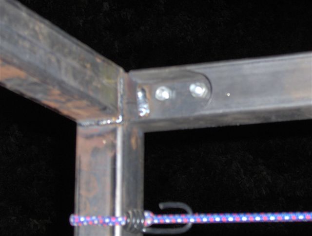

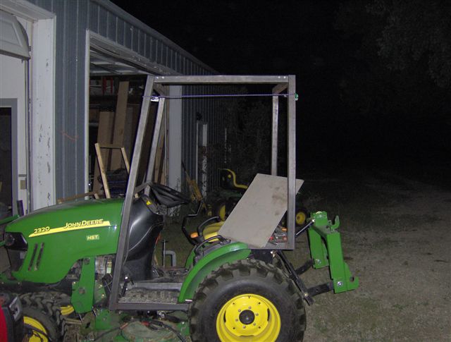

Stage 2.4: Fabrication and fitting of fore-aft tubes at roofline
After tacking up the front mounts to anchor the front frame in one spot, I got back to work on the bolt-in tubes to tie the front and rear frames together at the roof. I had managed to get the tubes cut a few days ago, with goofy angles on the ends and everything. On the side of the tubes that would face to the inside of the cab, I used a hole saw and the grinder to cut 4" long notches in from the ends. These will allow the tube to slide in onto tabs which are welded to the frames and provide access for tightening the bolts.
Tonight, I got to work on the LH tube. I cut 2 pieces of 3/16"x1.5" stock about 3 inches long, one for the front and one for the back. I adjusted the ends of these pieces to match the angles of the tube ends. Next, I clamped the pieces on the inside of the tube, up tight against the top wall and drilled 2 3/8" holes through both pieces. (I actually drilled smaller pilot holes through both, then openned them up individually). Once all the drilling was done, I bolted the tabs into the tube. I clamped a couple pieces of scrap steel to the outside surface, extending past the tube ends. These were used to lay up against the outside of the frames to get this tube sitting flush with them. I clamped the assembly in place and welded the small tabs to the front and rear frames. I'll now be able to unbolt the tube and finish some welding on the tabs later... I only got the LH side done before it got too dark to keep going, but just having that one tube in place has stiffened up the cab frame tremendously, and the bolts weren't even that tight yet. :D
Pictures below:
