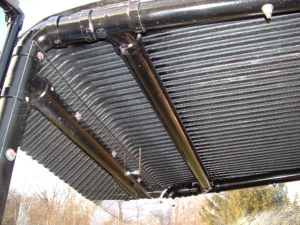

   / Homemade Cab? #46
Tom
I also used an old bed liner, cut it down,turned it upside down and used it for my roof. I heated up the front edge and bent it down. I'll try and take some other pictures if you need any specific info.

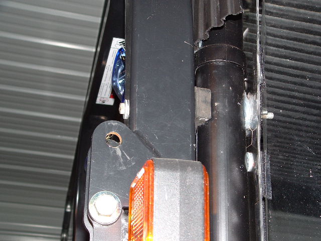

Some additional pictures of the following areas would be very much appreciated.
- A close up of the fender area. How did you do the door fit in this area ??
- A close up shot of how you secured the PVC to the TRactor Body.
- An inside rear shot showing how you secured the PVC to the ROPS. (At least thats what I am assuming you did.)
- What type of heater did you use ??

   / Homemade Cab? #50
Here's a photo of the cab mount to the roll bar. I drilled a hole through the roll bar and the cab and placed a rubber block between the rollbar and the cab and used a lockwasher and wingnut to hold it in place.I picked up a coil spring rubber block at the auto store.
