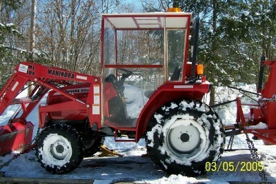

I made a cab from 2" pvc conduit.It's lightweight and is easily removed. It has lexan front and rear windows and removable doors with clear vinyl sheeting held in place with velcro. It's nothing fancy but it breaks the cold winds. The cab heater also helps keep it toasty /forums/images/graemlins/grin.gif
Bernie
/ Homemade Cab?
#44
Bernie,
I like your cab - nice, simple, and light. Is there a windshield wiper on the front? I can't tell for sure. I've heard that Lexan is expensive. What made you choose it over, say, plexiglass?
If you can give any construction details, like how you attached the Lexan and the doors to the PVC frame, that would help a lot. Thanks for your post.
Tom
/ Homemade Cab? #45
Tom
I chose lexan because it won't shatter or break like plexiglass. I picked up a 4x8 sheet for $100.00. I used self tapping sheet metal screws that have a rubber washer attached ,just like you would use on steel roofing to attach the lexan to the pvc.I do have a manual wiper fixed up on it .I used removable pin hinges on the doors so i could take the doors off easy. I'll try to attach some other photos.

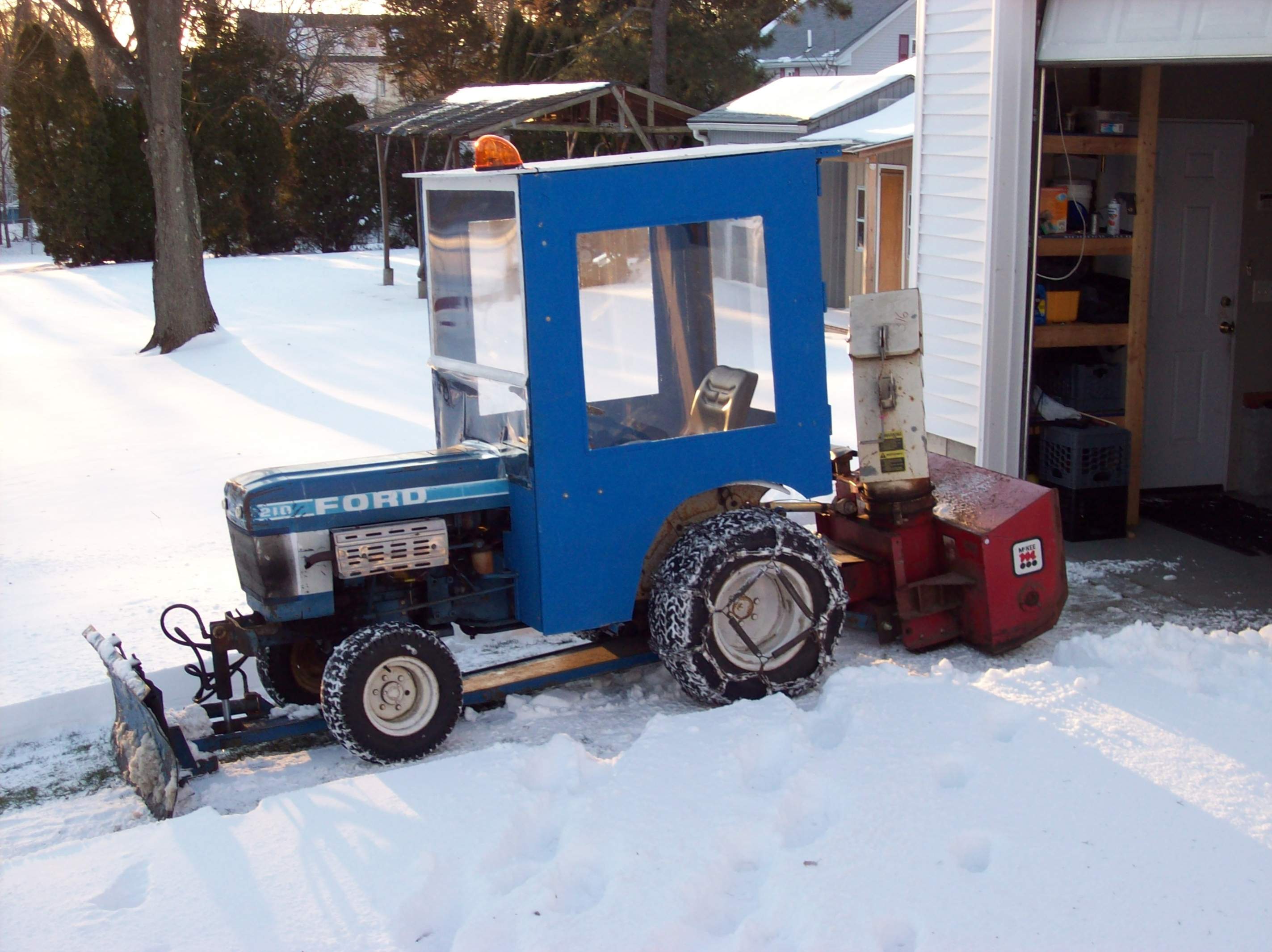

I built my own temporary cab(pics attached) from angle iron and plexi from Home Depot. It has a 3/4" plywood top. Its not air tight but it keeps the wind off me when out moving or blowing snow. Cost about $400 to build. Northern sells a cab heater that hose connects to the engine for about $150. though I dont have one yet.
