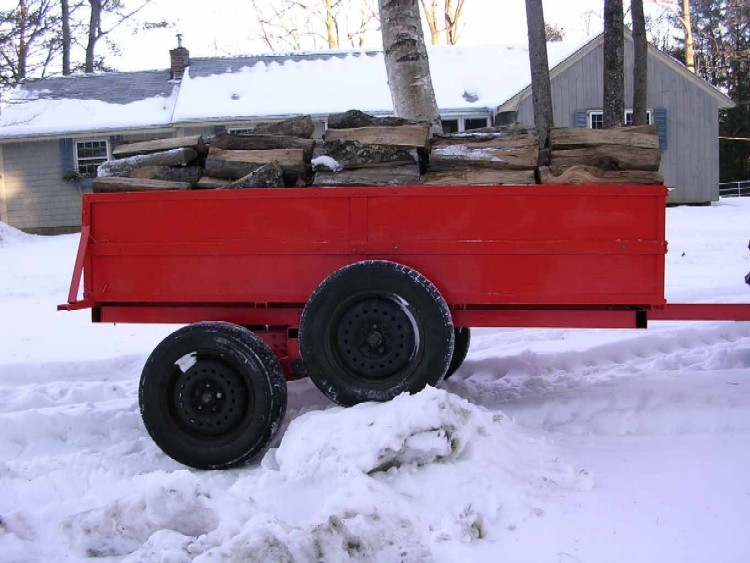

I made a smaller trailer a few years ago to tow behind my 30hp. Kubota. The trailer bed is 8 feet long and just under 4 feet wide, I wanted to be able to reach one side from the other.
The wheels and axles are form the rear of a Dodge Caravan and the frame is square steel tubing and the bed is framed with angle iron. The walking beam is a piece of 2 x 4 square steel tubing with a pivot in the middle.
The trailer has about 4 years of use and abuse. The axle beams were at first connected to the frame with a flat bottomed U shape bracket. After a slight failure I connected the brackets together with a tie rod. If I was to make another one I would just make the pivot connection members longer.
As far as load goes I have piled on 3/4 of a cord of green oak. It handles rough terrian very well.
Randy

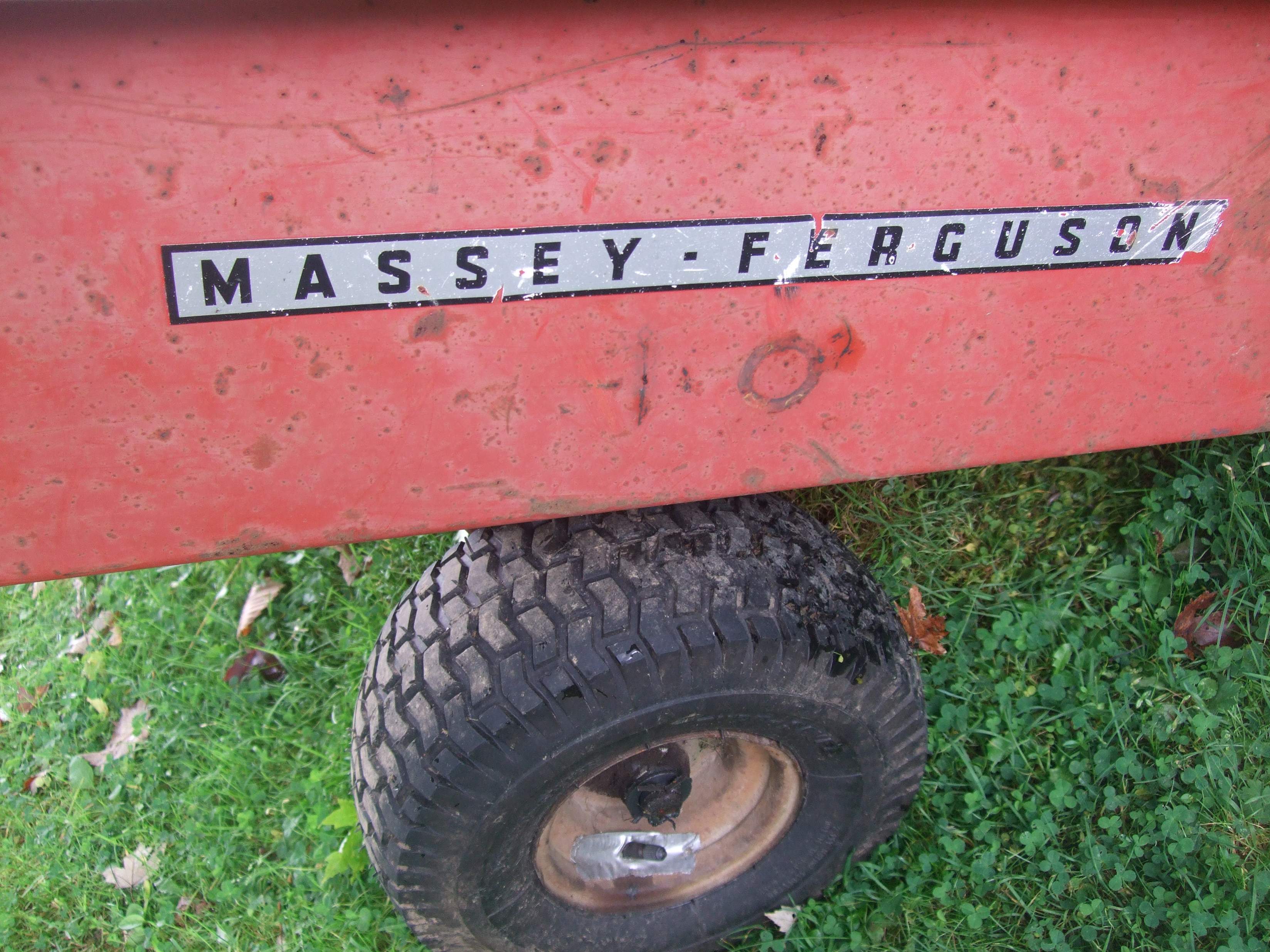

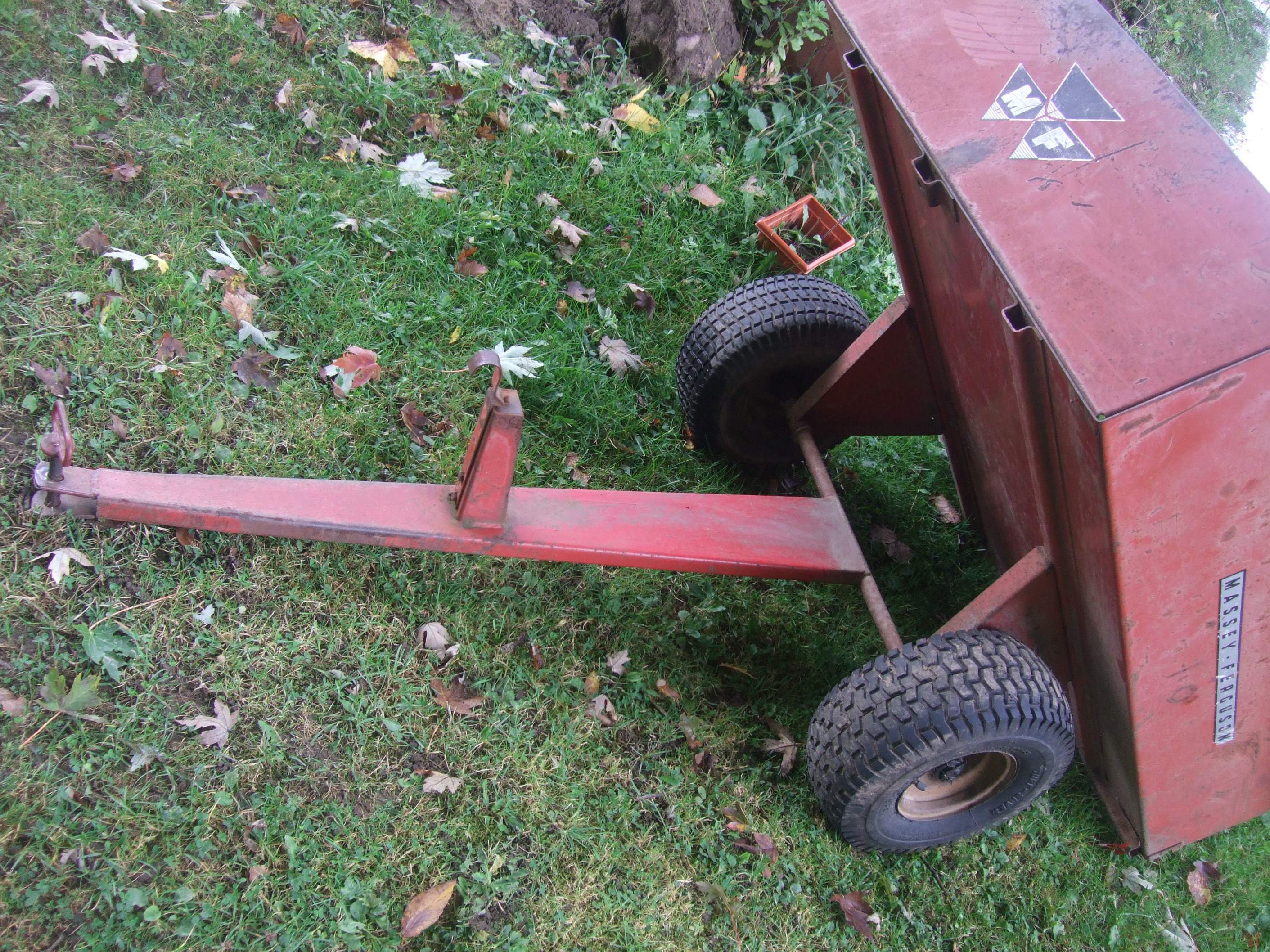

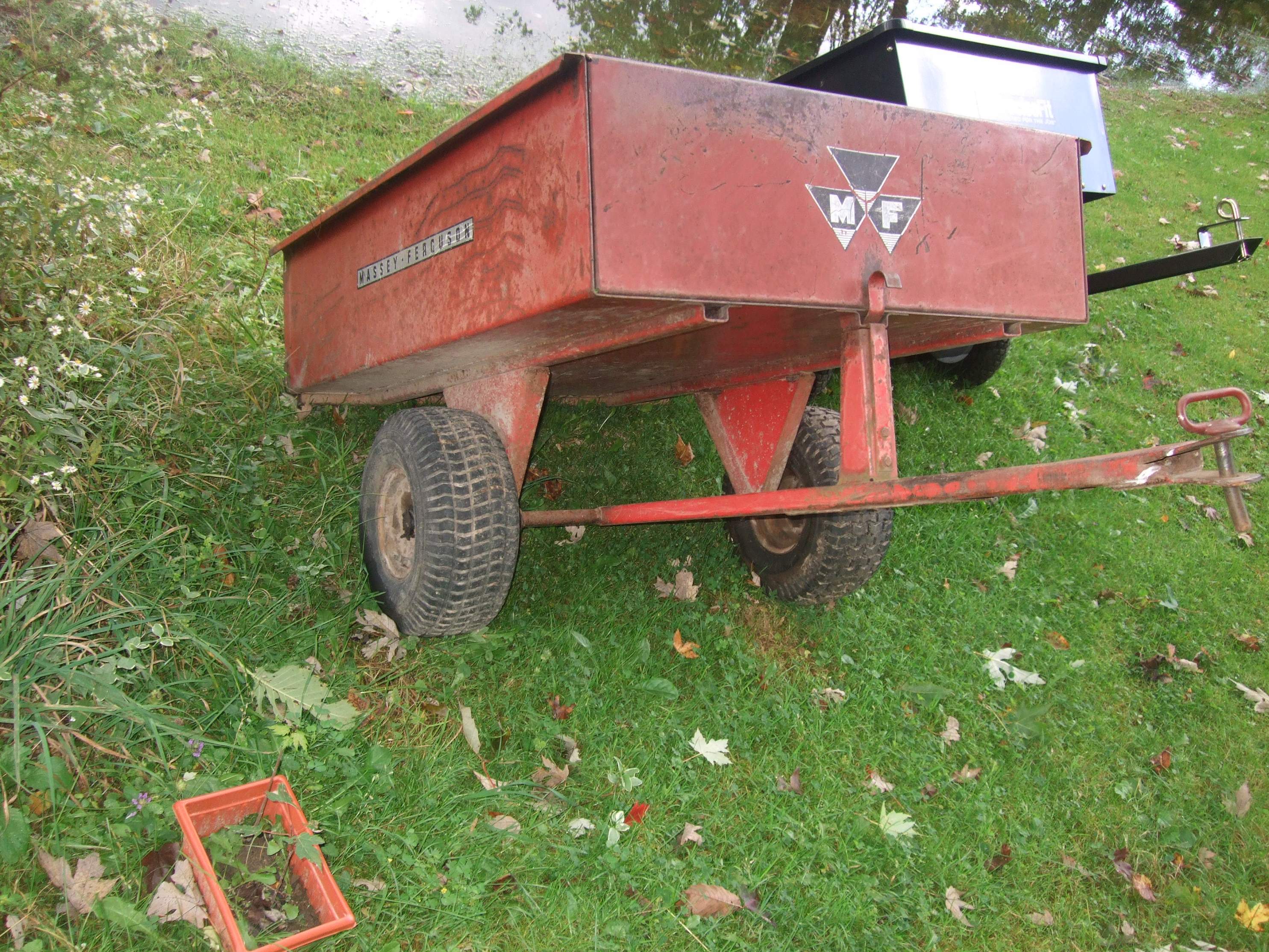

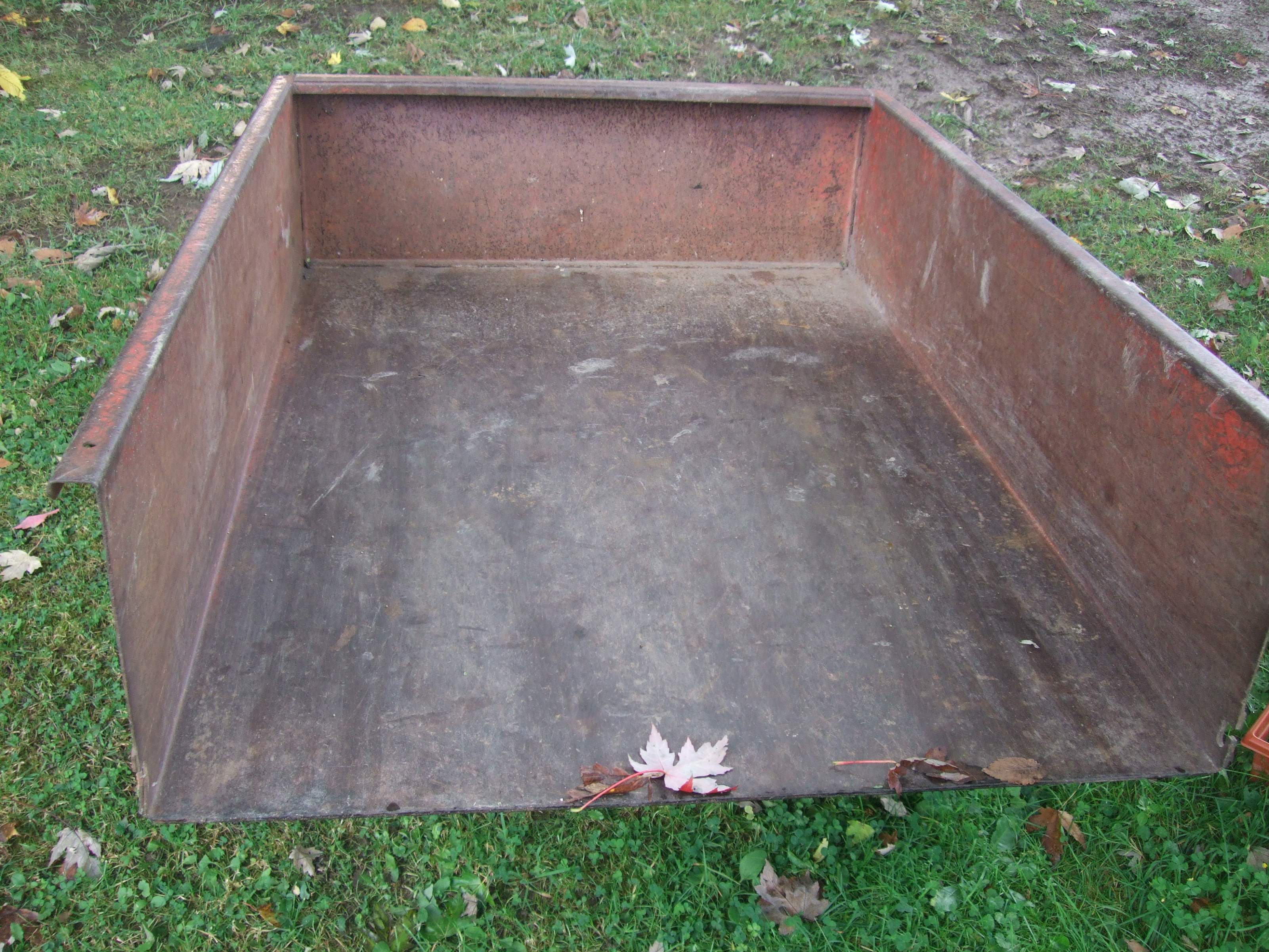

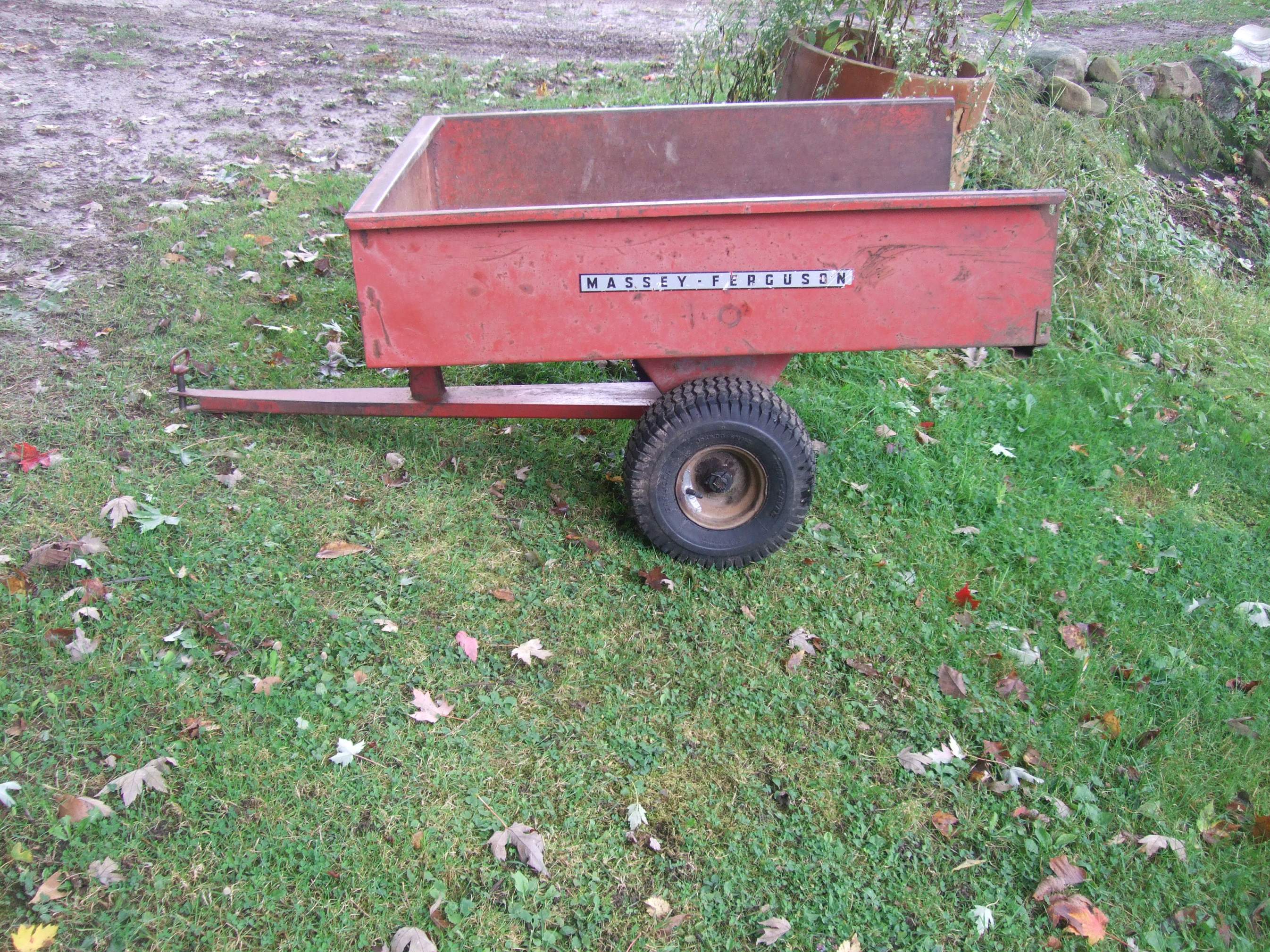

You asked, you shall receive. The sheet metal is basically bent from a long sheet. When I got home after snapping pic of the trailer, I forgot to take a picture of how thick it really was- it seems to be about 1/4 inch thick I think. I envision a trailer just like his only 4 ft wide by 5-6 ft long, it just depends on what kind of a sheet metal I can find. I beleive his trailer is about 38 inches by 4ft.

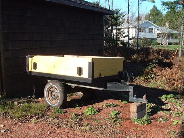

This was one I built from scrounged materials about twenty years ago with the exception of cylinder and hoses. It's four by six and dumps to about 50 degrees. It is way over built as far as the frame goes (2" X 6" channel). I've had as much as two ton on it. One thing I will say is that the best thing I ever did was put tubes in the tires so they rarely ever go down on air, I think I've only put air in them 5 or 6 times in 15 years. I've also been throwing around the idea of a dually for the purpose of making it road worthy for local trips.
