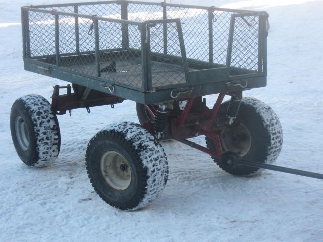

Here's a variant on the same idea. I used lawn tractor front axles that have the frame of a Home Depot garden cart sitting on top. I then fabbed up linkages to make it 4WS.........
It's still a work in progress.......

Very nice! I see you added shocks too.
   / homemade dual axel trailer #36
I'm not really pleased with the shocks I ended up using. This project had a very tight budget so I ended up using gas scooter shocks and in this case, they really aren't compliant (read - have the travel I needed or wanted and are way too stiff). But they were cheap and they do stabilize it. I'll probably end up using snowmobile shocks (oil filled) in the rear.
Despite those limitations, It has been able to crawl over small logs with a load, so that I'm pleased with.
My needs required a trailer/cart to be light & small yet be able to negotiate some rough terrain. So far so good. I pull this with my old Wheel Horse and it seems to be a good combination........
