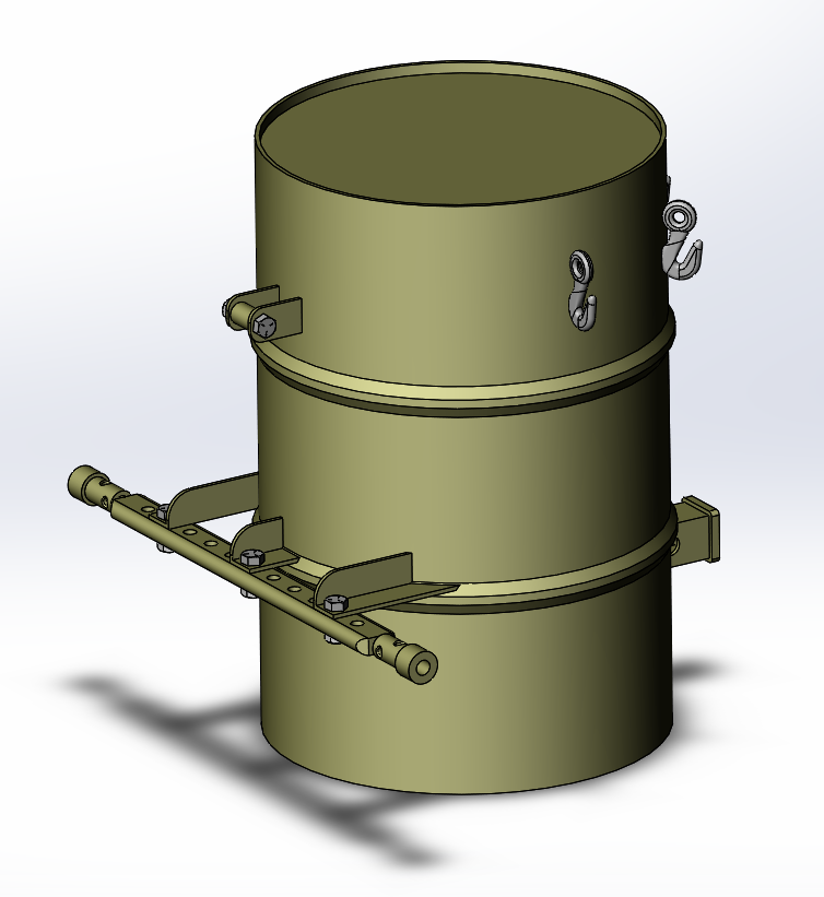

LD1, you're right. I weighed one on the bathroom scale and it is 44 pounds. So it does retain moisture. And there is a small amount of re-rod in it.
GE222, Regarding steering. I was out today and moved it off my trailer and drove it back to the barn to park it. I put it in 4wd Hi Range. There was a dusting of snow on the drive and yard. It steered very easily with the 4 blocks in (250 pounds total on the front).
This is so much better with the extra weight on the front. It was too light before and I was having trouble getting it to behave and steer where I told it with the heavy 3pt blower on the back. I was kidding my wife about just building a seat up front for her to sit on and then I would also have a 'wench' on the front. But she didn't like that idea much.

Thanks again, guys. It was fun. Went through a few changes on paper before I built it. Next project....(after fluid/filter changes that I'm doing now) ......... Front End Loader!

I also recently made the discovery of how well ballast can improve the capability of a small utility tractor. I run a FEL on my New Holland TC40DA so am already running weight on the front axle. I needed ballast on the rear so I fabbed a similar concrete 3pt ballast box. I used some 3/4 plywood that had been laying around to frame it, plenty of screws, and some ingenuity to hold my top link mounting and bottom link mounts with steel I grabbed from the scrap pile.
Turned out really nice, I built it to give 1,800 pounds of ballast using just a hair under 1/2 yard of concrete. Only difference is I took my empty form on a trailer to a local concrete plant and got some left over mix at no charge. I had a cap premade for the ride home so it wouldn't slosh around. Re screeted the top as soon as I got home and let it set for a few days. Used it a few times already, and it's a world of difference. I recommend it to anyone with a FEL and some spare time to fab it up.
