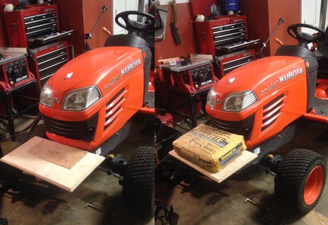

I needed a fast way to create some front ballast for my BX2360 as I bought a very heavy rear aerator from EverythingAttachments - thing is awesome and weighs over 600 pounds. I didn't have access to welding nor did I want to spend the money for something I will use two or three times per year. So I built a front tray and used angle iron underneath to fasten it to the front frame. I will x-it on firmly with some bungee cords. I will paint it Kubota orange and I ordered orange pillow cases for the 80 pound bag of quickcrete ($6.00 instead of a buck per pound!). Another possible solution for lighter duty guys with big yards............. BX2360 Ballast.jpg

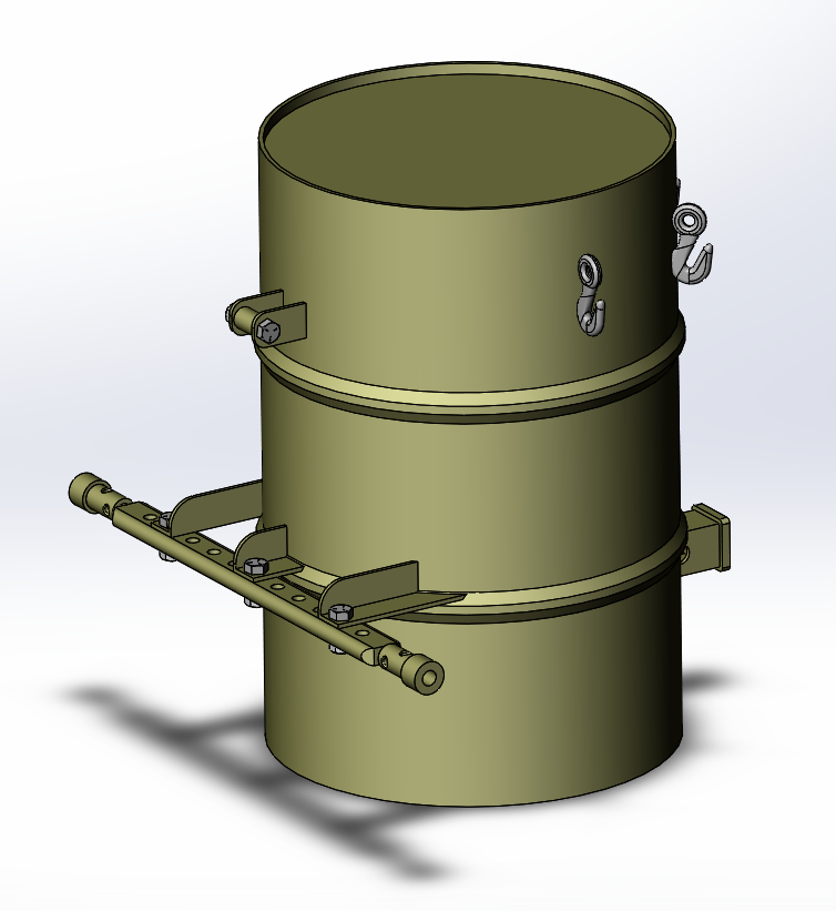

Here is what I designed, and will build this spring. Uses a removable draw bar, just in case I ever need one. It is quick hitch compatible. Had a trailer hitch receiver and tow hooks. I will put pockets in the concrete to put a chainsaw and misc. other stuff. I think it calc's out at like 1200 lbs.

I hope there is actual framework inside the barrel and not just welding the stuff to the outside of the barrel.
   / Homemade Front or Rear Ballast Box #25
What, isn't concrete strong? :laughing:
Yeah, there certainly will be (it isn't built yet.....spring hopefully)

The concrete is strong. THe barrel...not so much. Surface welding a few tabs to the barrel and then loading with 1200# of concrete.....they would tear right off

The concrete isn't strong enough to hold itself together either. My dad had one that broke in the middle, because it didn't have rebar in it.
