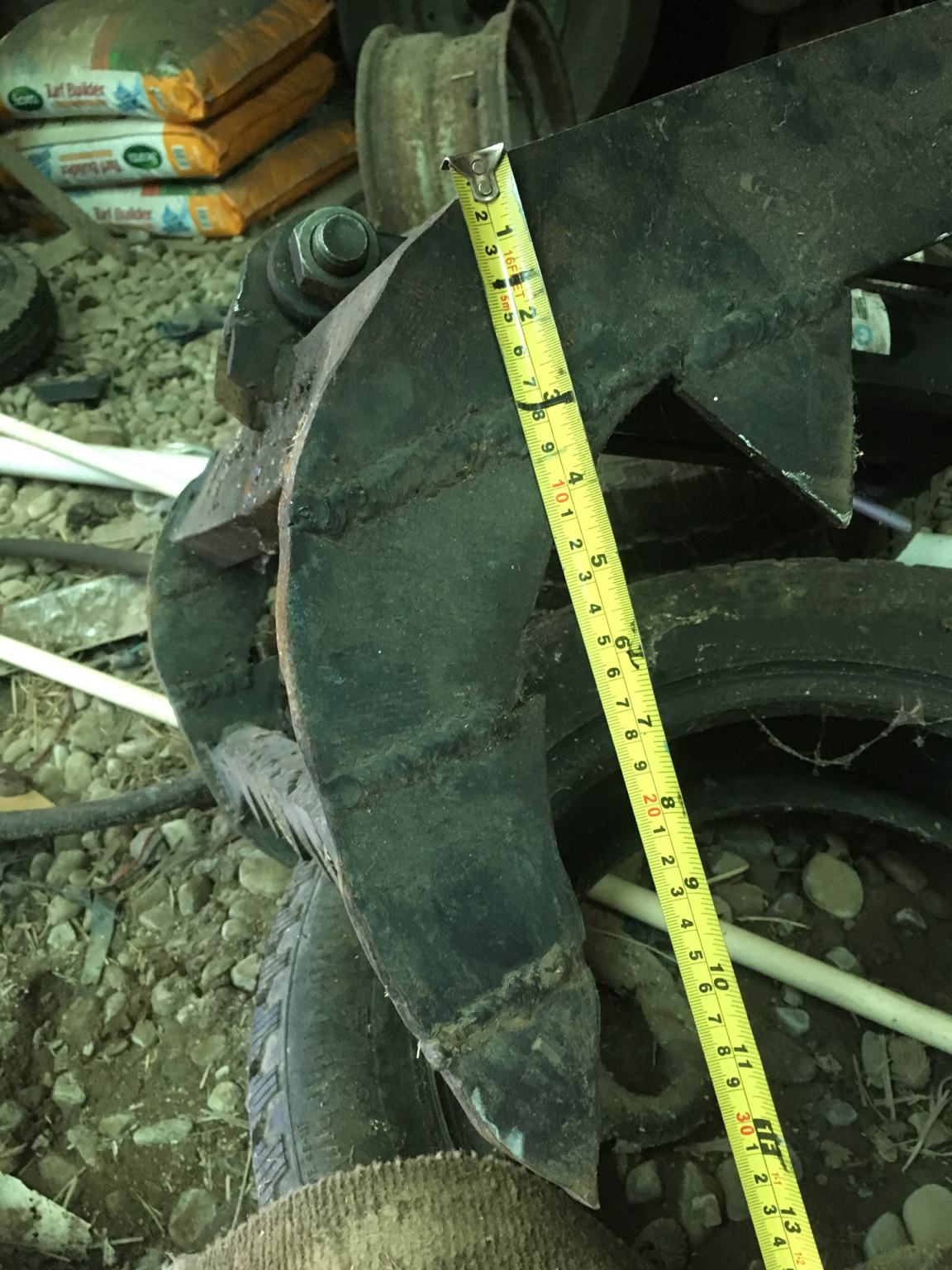

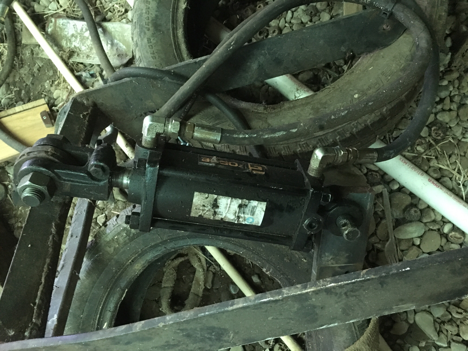

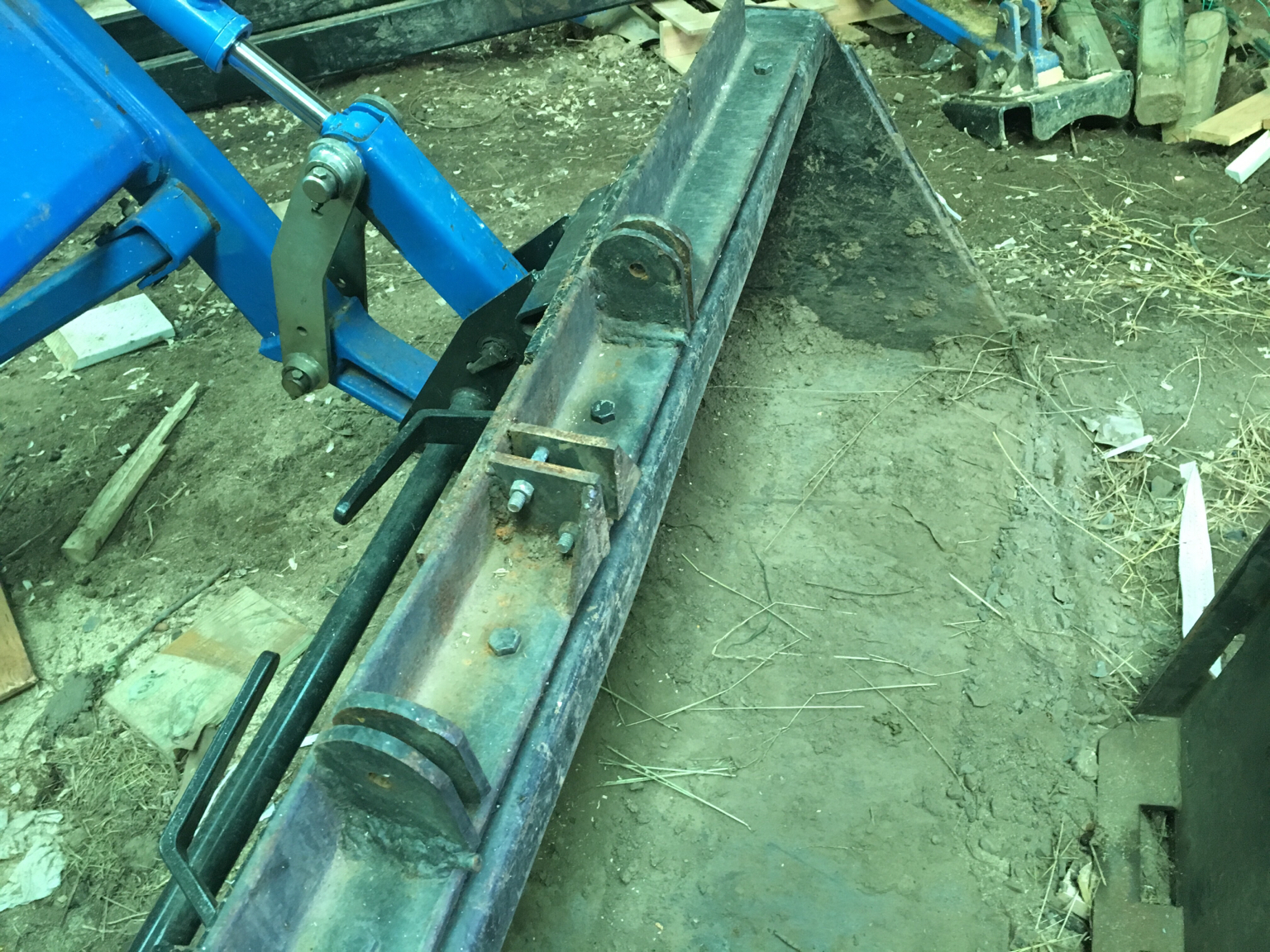

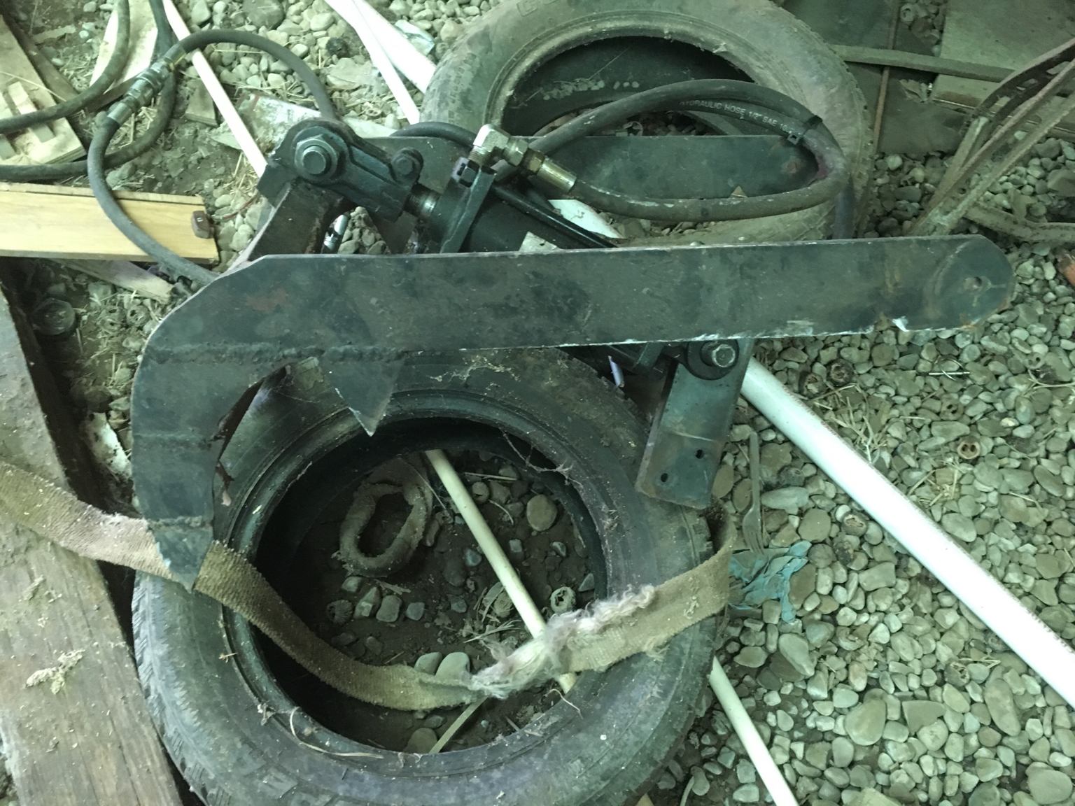

I made a couple a couple of years ago, I'll have to dig up pictures - I made mine to go on top of my bucket. I ran into the same problems as you asa far as finding plans. I ended up making full size templates out of luan that way I could get everything lined up. I could also get the strike right ! But I will tell you I bought 2 cylinders on Amazon 3" bore 16" stroke WAY TOO BIG, but I got both of them shipped to me total for $53 total I think someone a amazon screwed up!

/ Homemade Grapple #8
Not sure if this was directed to me but here are some pics IMG_0368.JPGIMG_0369.JPGIMG_0370.JPGIMG_0371.JPGIMG_0372.JPG
As you can see I currently don't have it on-it is handy as all **** when I do use it!

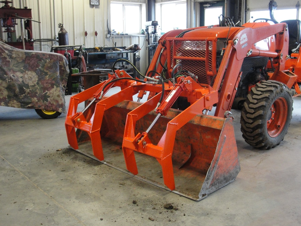

Thanks Oldpath, I didn't quite understand the the Bill Monroe part either. I just assume it was a sign of respect for him.
That grapple you built was beautiful. I built one similar using a land pride as a reference. I should have put gussets between the tines like you did though.
I kept bending my tines while moving some big rocks so last week I cut them off and welded a piece of 1/2" steel across them and welded on nine bucket teeth.
Funny story though, My neighbor lost a huge oak tree last year and 2 days ago I saw him and his dad starting to clean up the mess. I noticed they were sawing off the limbs and were using a small atv to pull them to the back yard so I offered them the use of my tractor and grapple and within about 4 hours they had cleaned up the entire mess.
Needless to say they were very appreciative and amazed what they could accomplish with this combination.

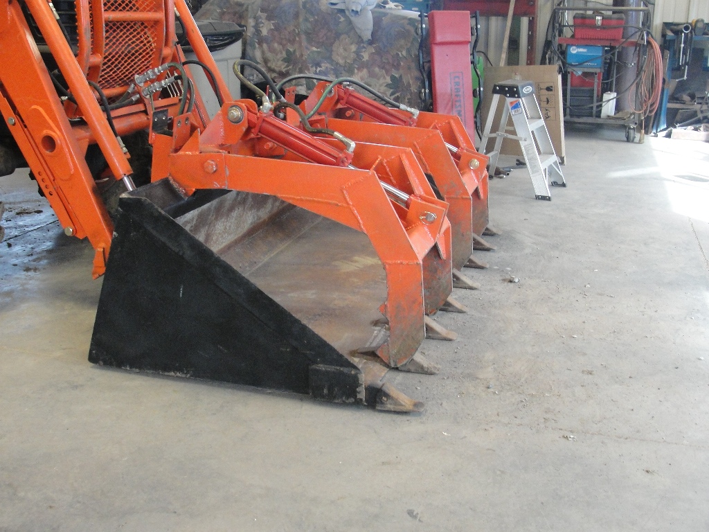

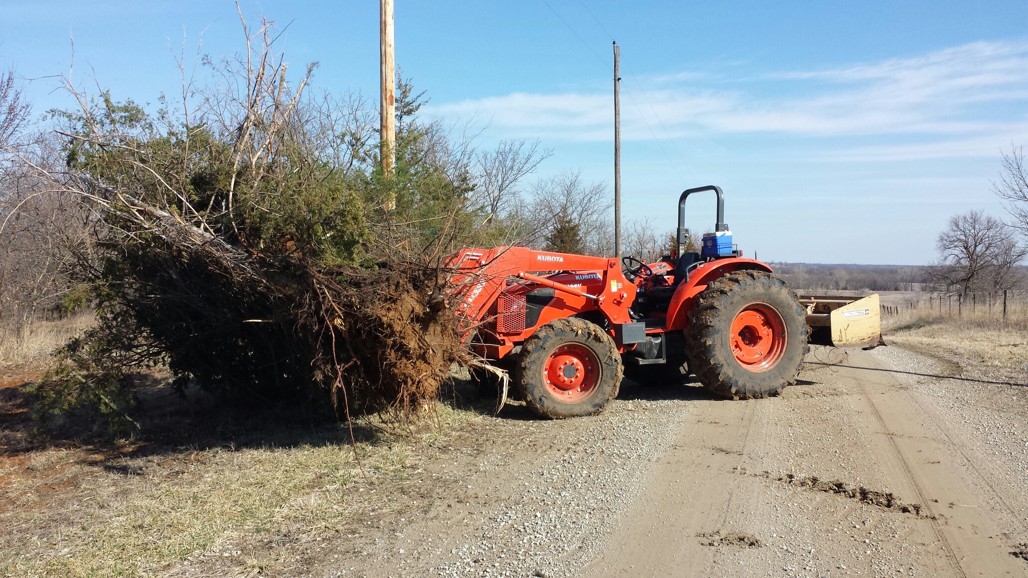

/ Homemade Grapple #17
Everyone's expectations are different in regards to a Grapple. I wanted the most versatility. I started by building the grapple on the FEL frame. I could switch buckets, etc., and the claws stayed with the FEL. Immediately realized that wasn't a good idea. So I bought a used Bobcat LoPro bucket and moved the double claw grapple to that. Can grip a very large pile of brush. Or odd sized objects such as rocks. Or haul a bucket of loose material. No change of tool required.
Tines are built from 1/2"x4" flatbar. Cylinders are 2"x8". I use the snot out of it. Had to recently rebuild the claw hinges. I didn't use bushings in the beginning, just swiveled the flatbar on pins.
/ Homemade Grapple #18
Very impressive, sure have those front tires squatted.
/ Homemade Grapple #19
If you add a Grapple to your FEL you will test it to the maximum as well as the front axle/tires of your tractor. I've carried many loads with one rear tire off the ground.
