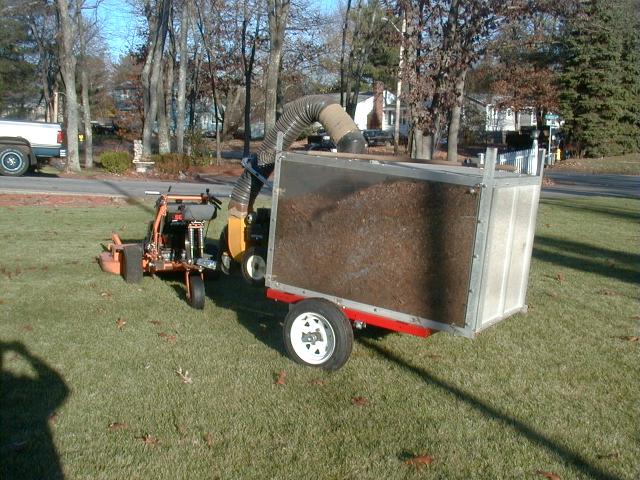

I really like the clear sides on the leaf vacuum.
Don
   / Homemade Leaf Vacuum #42
Very nice looking machine! Hope to see more pictures and a thorough description of the project! I would love to do something similar. My problem is finding the impeller for the vacuum.

You can only leave so many chopped leaves.
With gator blades its fine to leave some, but 56 hardwood trees on 1 acre and most being oak, It's too much. In the fall I end up with about 20 cubic yards of MULCHED leaves. I figure the Gator blades and the Blowers impeller reduce to about 8 to 1 or better.

therrien: did you say lexan?? for the price of that stuff around here, we could probably buy a really nice leaf pickerupper....especially 9/16: but it doubt it would look as good or work as good as the one you built: great job.
