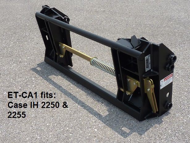

et-ca1.jpg <<<This must be the one your talking about, it does look stronger and better and looks like it attaches and detaches from one side with one lever, that is a plus, but over a $1000.00, ouch, think I'll have to settle for the cheaper one @ $200.00 and walk around both sides.
Cutting steel with grinder is a last resort or small job, cant imagine trying to build a loader that way. A plasma is still on my wish list, I do have oxy/acetylene its great for stubborn bolts, maybe this winter I'll find one of good buys on a plasma that everyone else seems to get.
