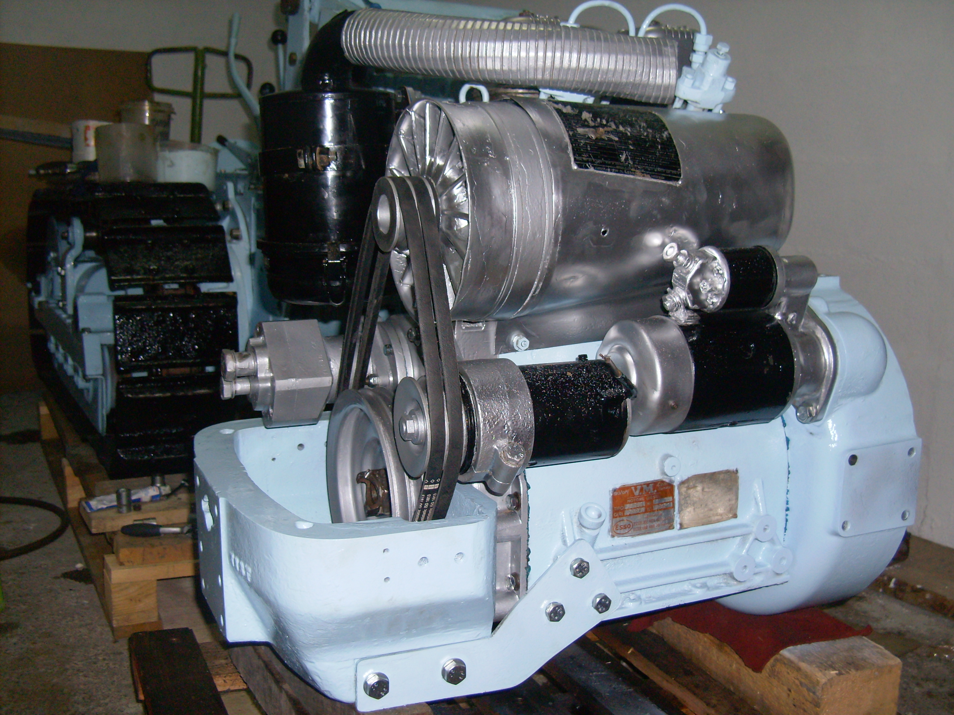

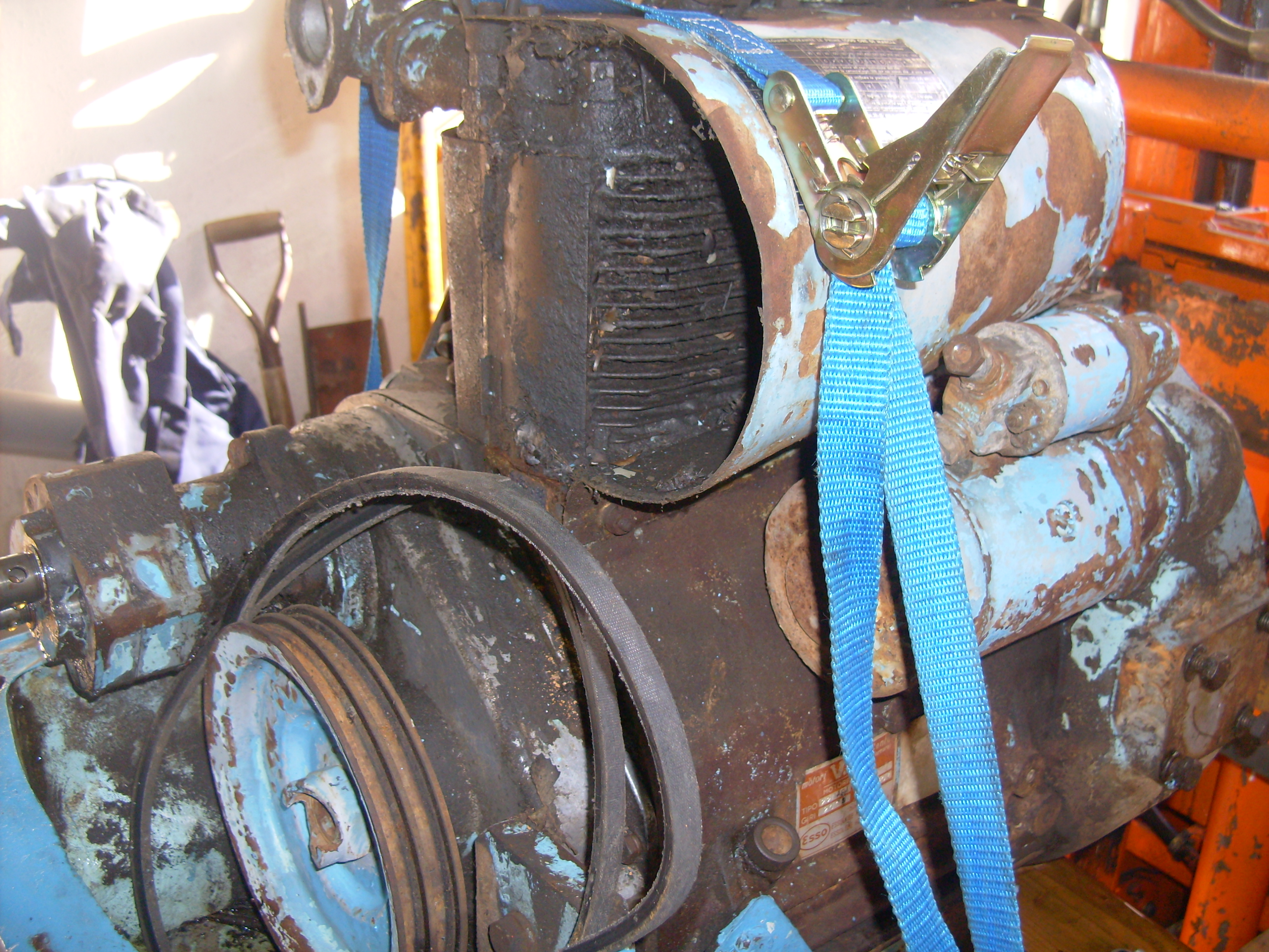

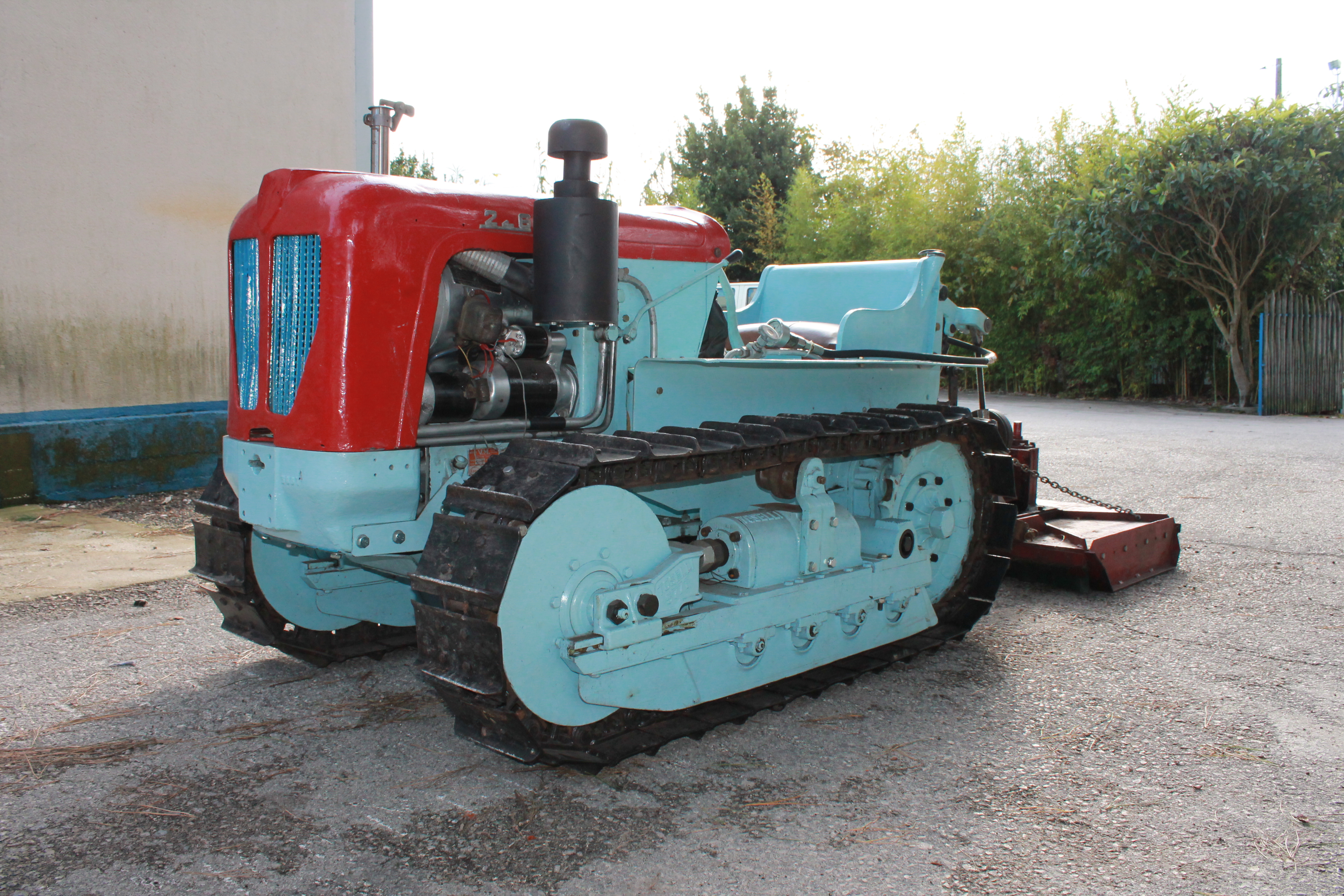

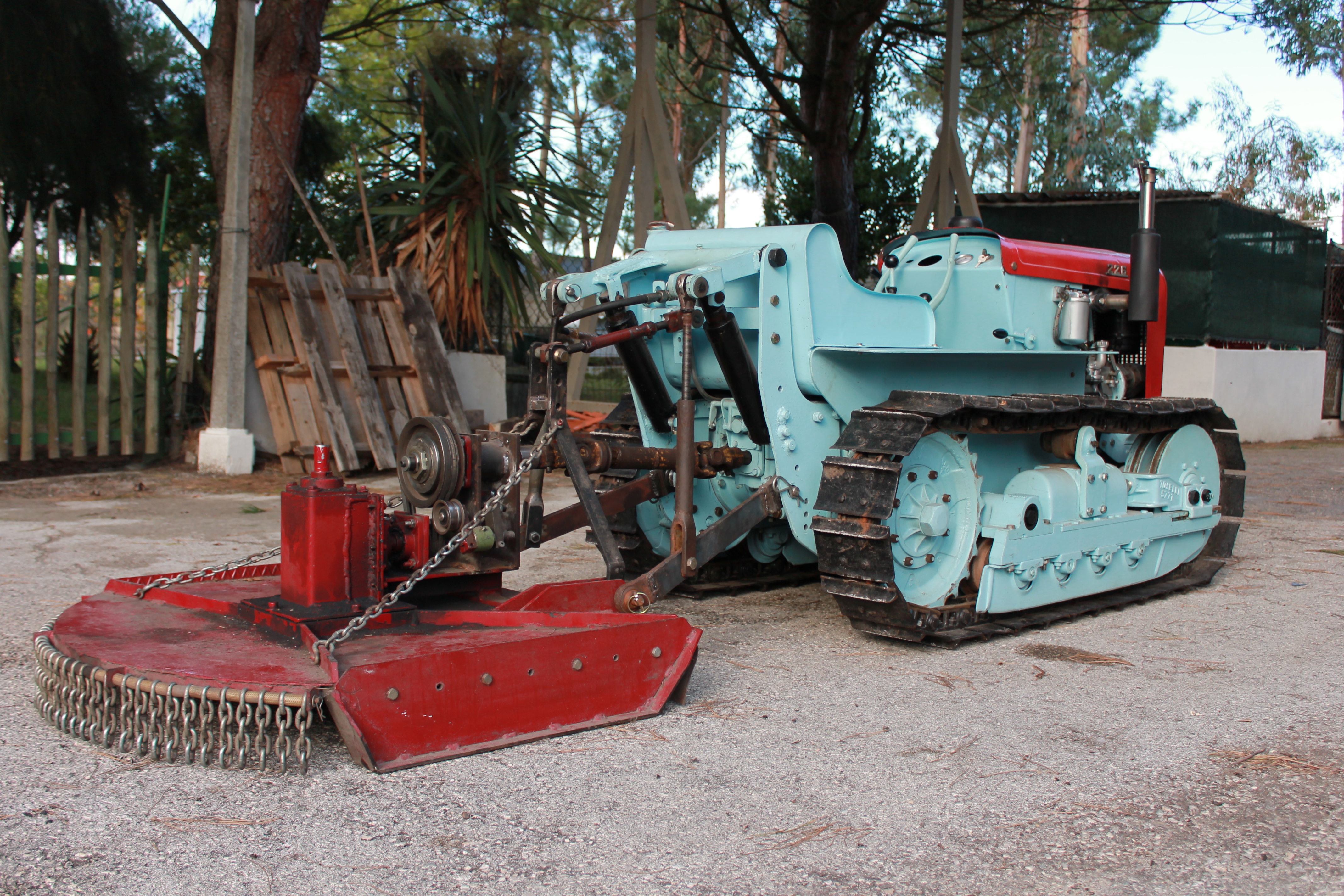

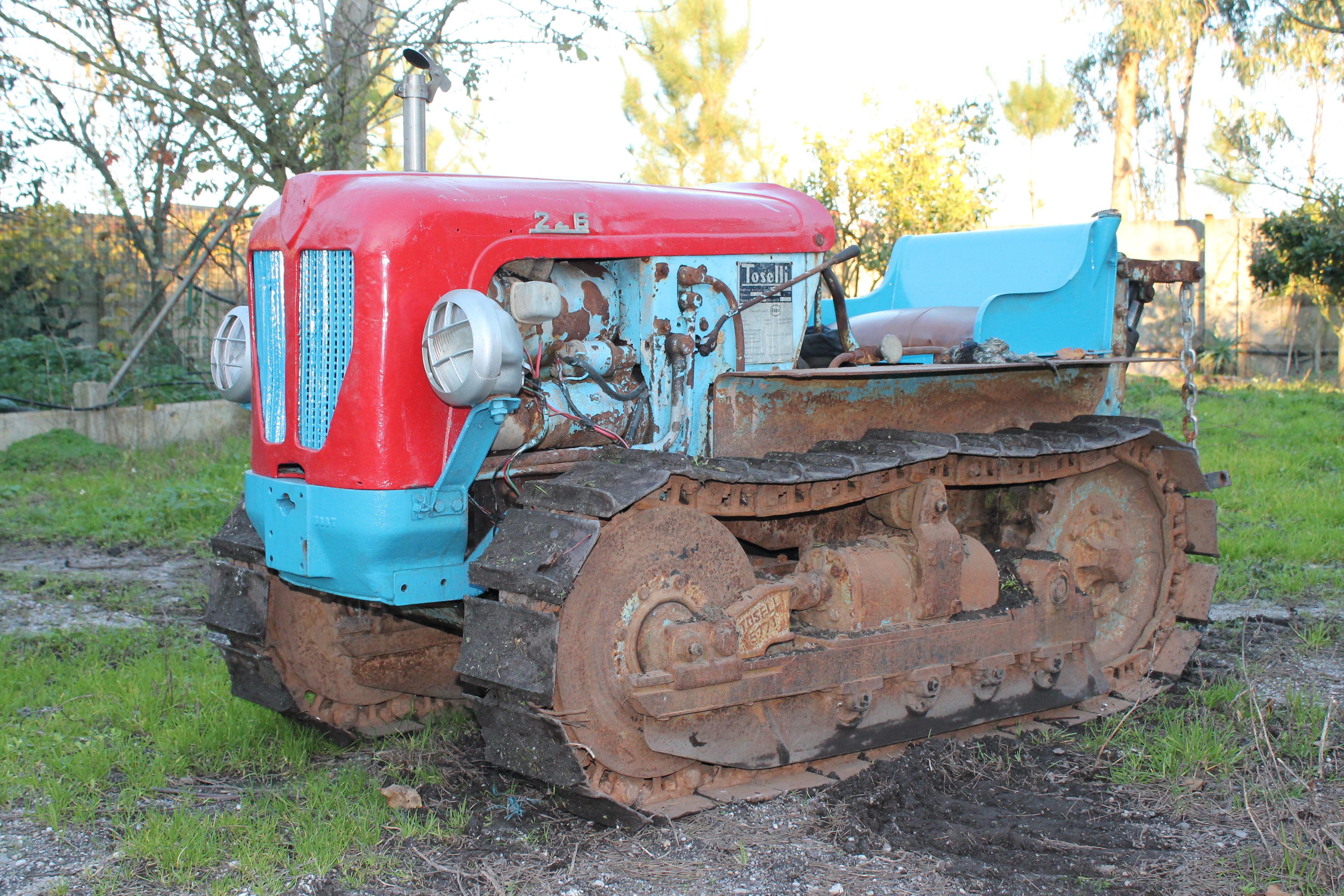

Since we're at it, here is another project. I restored a 1962 Toselli 226 crawler tractor. It's an Italian machine, 28 HP, 2 speed PTO, 6 forward and 2 reverse gears. I don't own it anymore as I trade it with the small Kubota B7000 for this new tractor. The Toselli is sadly sitting outside in the dealer out in the elements.
I could probably do a video like the loader. I do have lots of pictures of this restoration.
Some before and after pics:

What was the original purpose for a crawler with no blade and what's that big silver round thing on the motor that two belts are on? What happen to the headlights? gotta have headlights.
To bad a old machine or any machine is sitting out side to the weather, you ever wonder what stories that old crawler could of tell................

The crawler tractor is meant to be used exactly as a wheeled tractor would. It has PTO, 3 pt arms, drawbar, etc. It's very common to be used on steep hills, uneven terrain and such, specially with orchard and vineyard farming. It's a very stable machine on hills, plus it can just spin around 180 degrees on the headland to go to the next row. Farmers use it for mowing, tilling, plowing, spraying, and pretty much everything. When I had it, I used mainly for mowing brush and tilling.
The headlights kinda got postponed and ended up trading the tractor before I could finish the headlights. It would need lots of work to bring them to mint condition as I wanted. The grille was broken on both and they had lots of dents. I still have them in a box.
The engine is air-cooled. So the belts go from the crank pulley, to a fan inside the shroud. It also spins the generator. The hydraulic pump runs of the cam shaft.

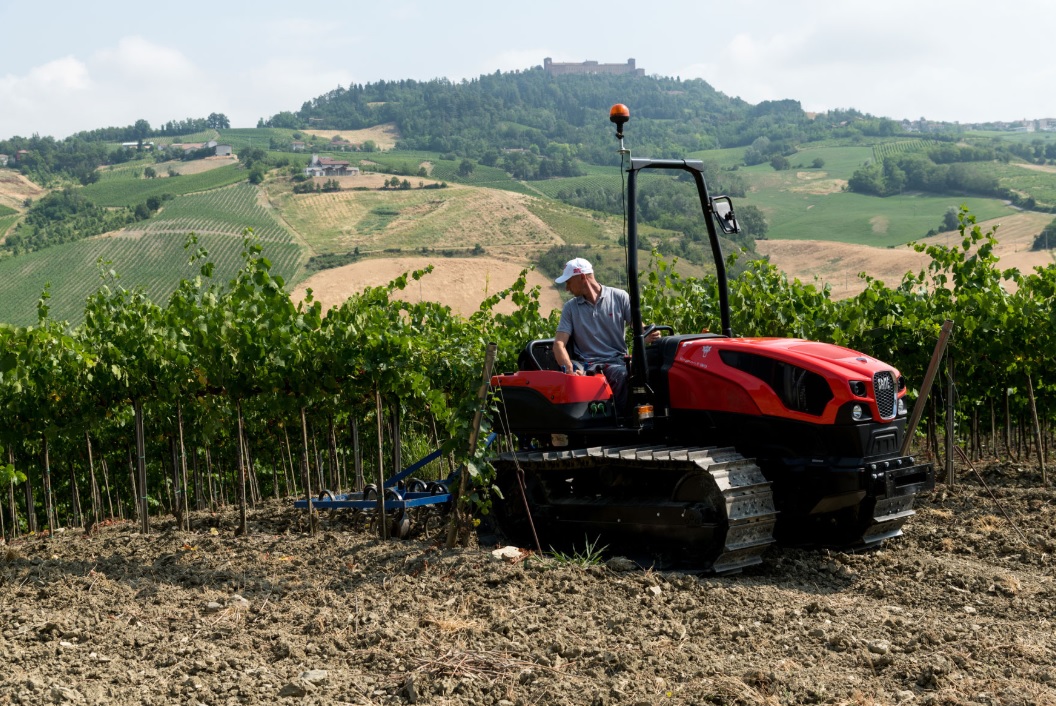

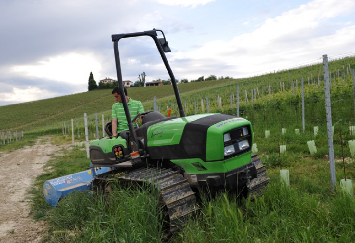

I had two crawlers tractors. First was this 226 on the pictures that I restored. A few months later, ended up getting a Toselli 340. Basically the same as the 226, but with 39HP and 3 cylinders, longer chassis and wider tracks. This one got sold to a English guy living here, without me doing any type of work on it.
Here is a few examples of crawler tractors:

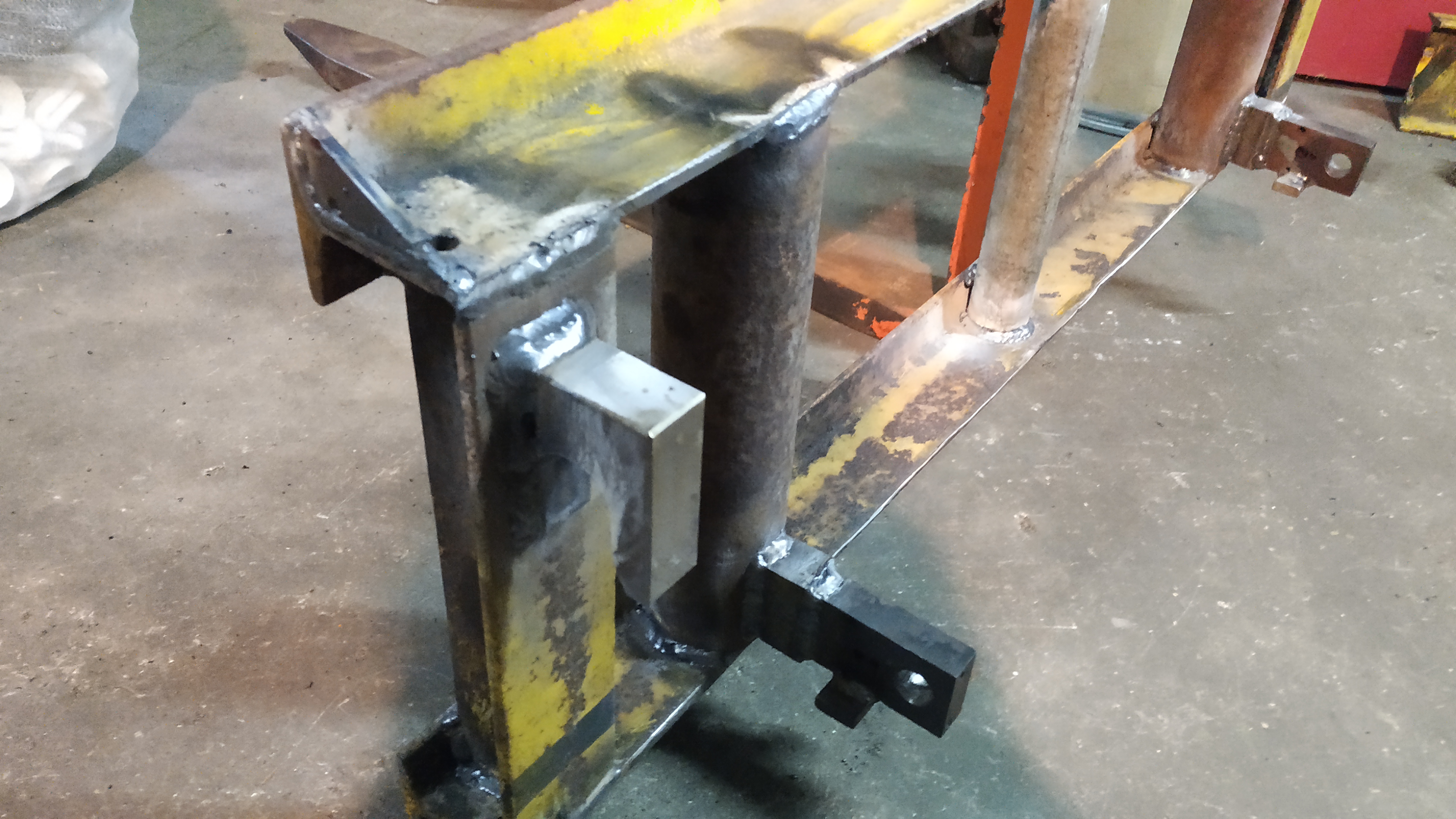

Time to bring this thread up as the time as come to build the forks for the loader.
I need to move some piles of pallets off road and my 1976 24V Electric forklift will sink right up after leaving an hard surface.

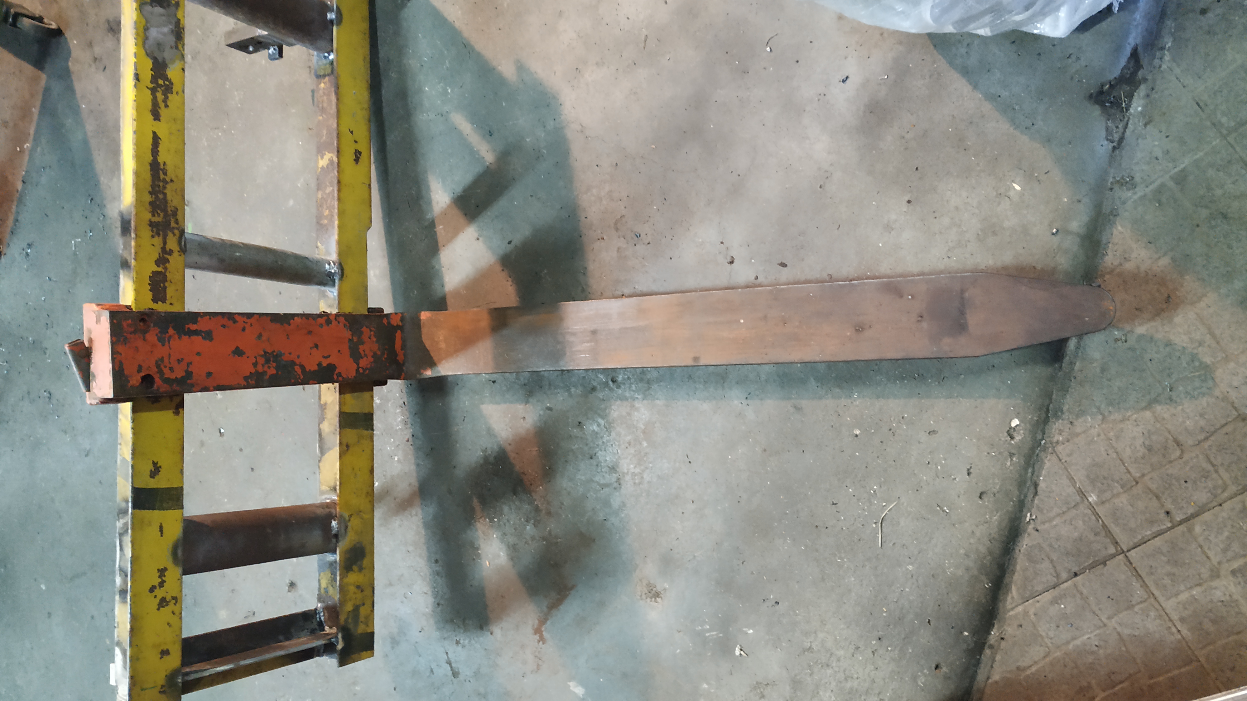

I'll borrow the forks from the forklift and I have to say, they just don't build them like this anymore. Each fork weights easily 50 kg (110 lbs) each and the forklift is rated for 1500 kg (3300 lbs).
That being said, all I need now is to build the frame for the forks.

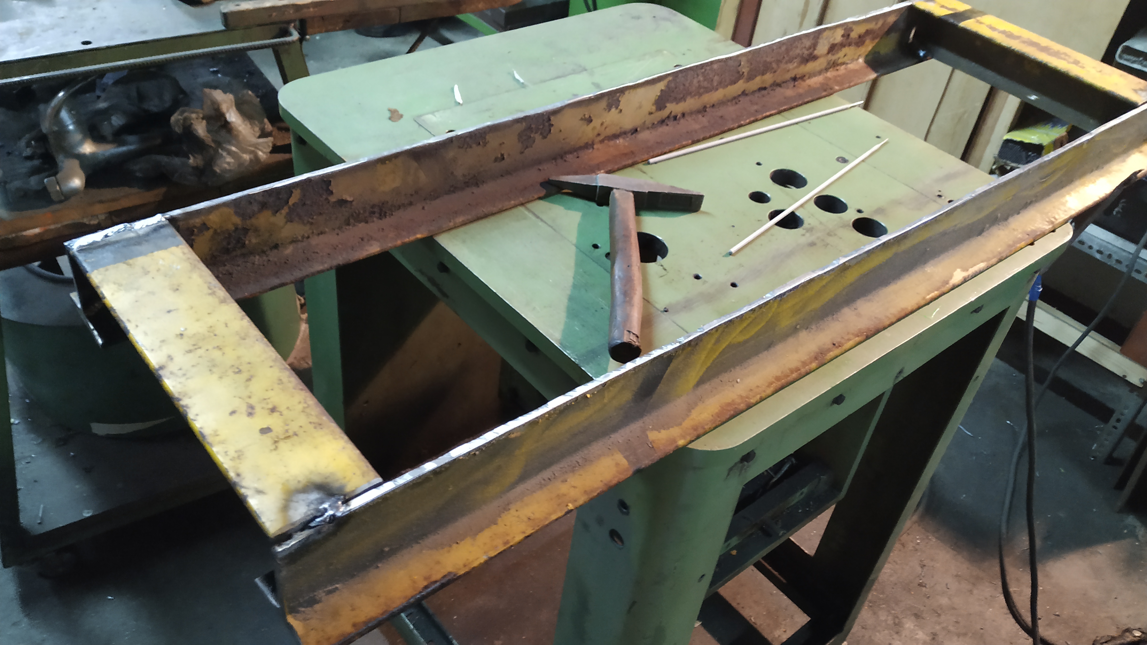

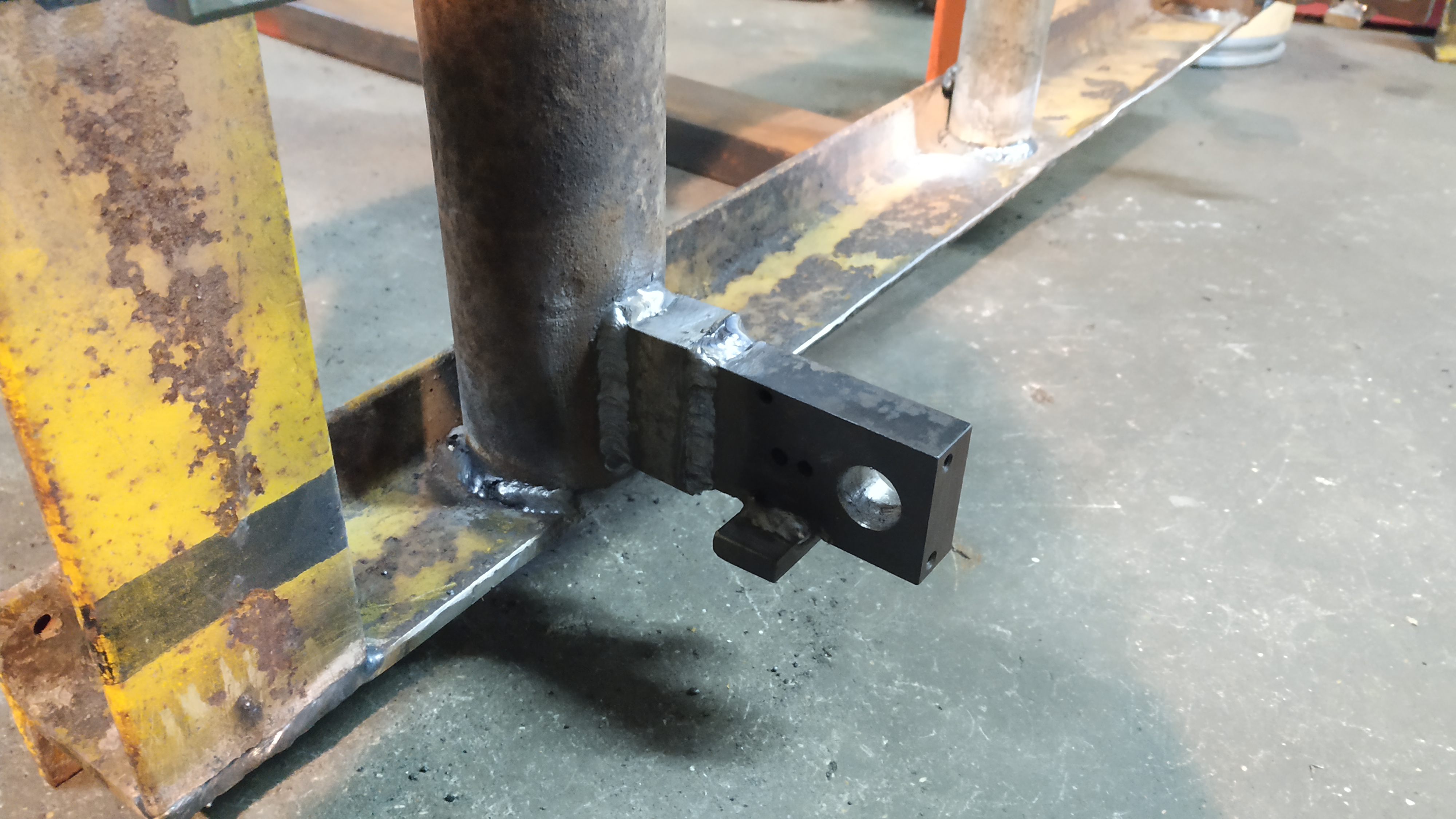

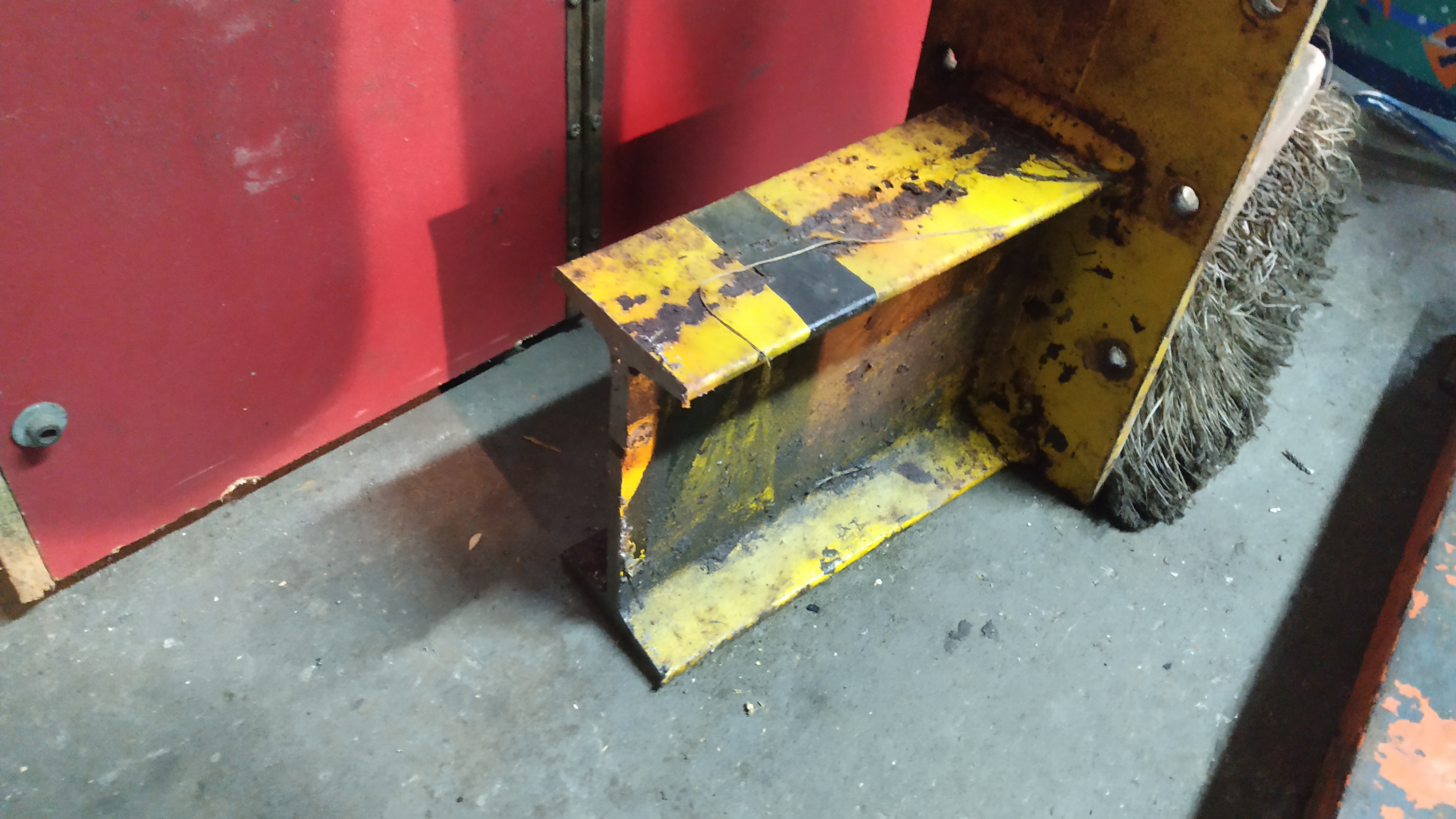

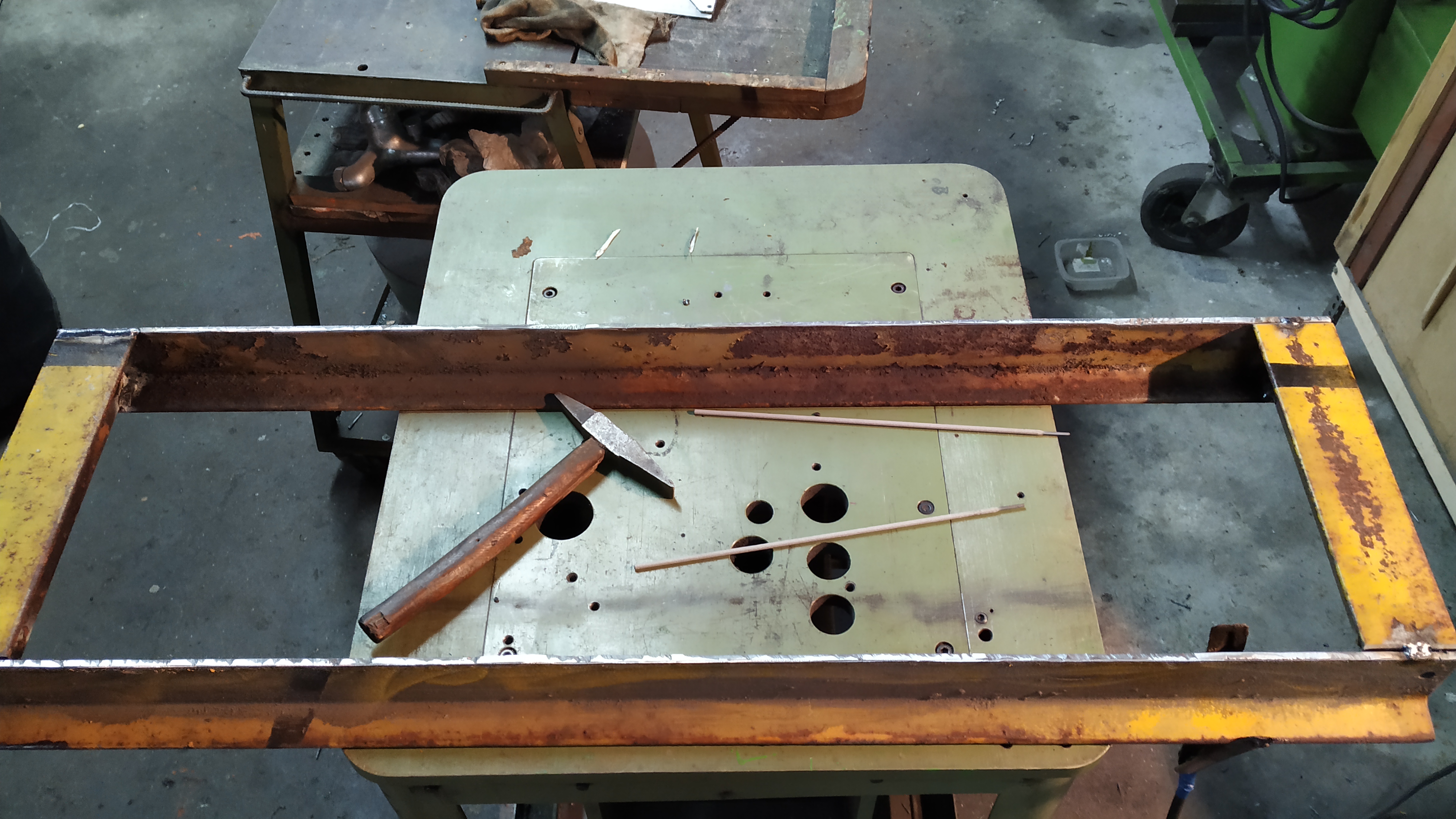

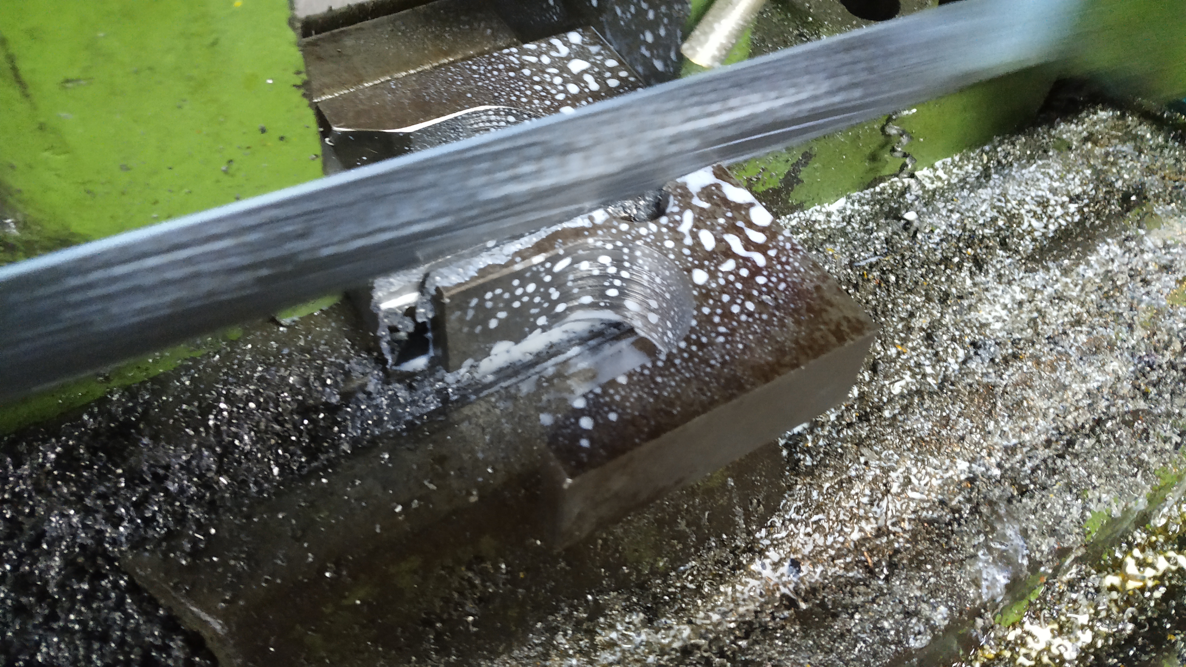

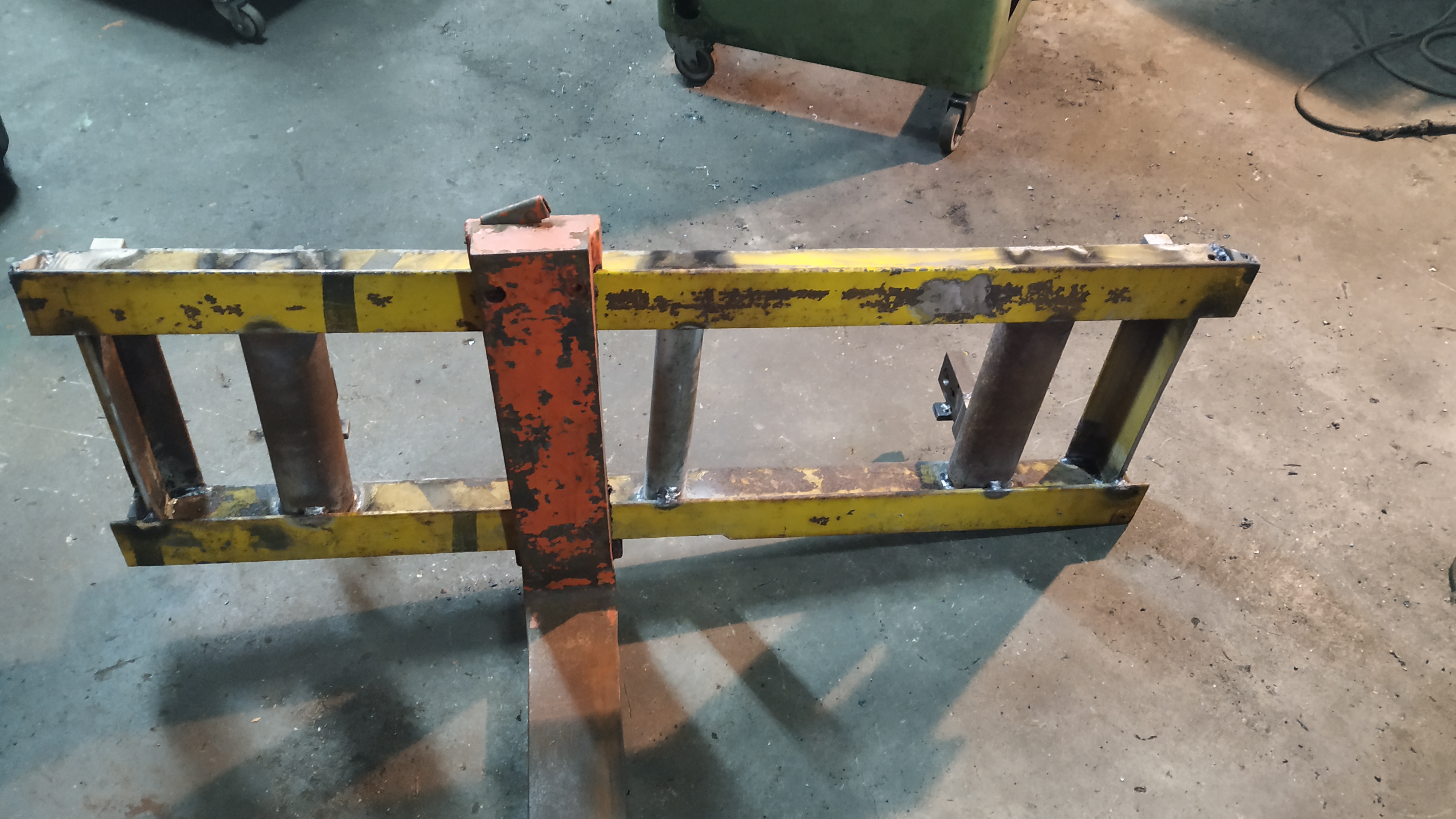

The frame is made out of a 140 mm (5.5") I-beam sliced in half as it makes a nice base for the forks to slide. Everything else is made out of drops I had laying around. The top hooks are made out of 30 mm (1.18") thick plate and the bottom mounts are made out of 22 mm (7/8") thick bar. The bottom mounts look a bit funny because I had to extend them a bit so I would get some tilt back with the loader close to the ground.
The start of the frame and the leftover price of I-beam:
Machining and welding of the hooks:
IMG_20191219_122500.jpgIMG_20191219_164634.jpgIMG_20191219_170020.jpgIMG_20191219_172844.jpg
And the final product:
IMG_20191221_164729.jpgIMG_20191221_164734.jpgIMG_20191221_164756.jpgIMG_20191221_164813.jpgIMG_20191221_164809.jpg
I'll share more pictures once I get it mounted on the tractor with both forks. And it will get a coat of paint once the weather cooperates. The frame weights around 40 kg (90 lbs) which brings a total of 140 kg (310 lbs) for the whole attachment.

I was under the assumption that the tips on forks face down to floor not up, least my home-made ones do. I also assume that your forks will slide in&out and looks like the forks hooks on the I-beam lip, so is the lip strong enough to hold the weight?

I made a cut out on the bottom rail so I can insert the forks in. I did weld a stop at both sides so the forks wouldn't accidentally slide out of the frame.
Regarding the lip holding the load, I think it will be ok. But if it starts bending, I do have some room to add a piece of flat bar to reinforce the lip.
