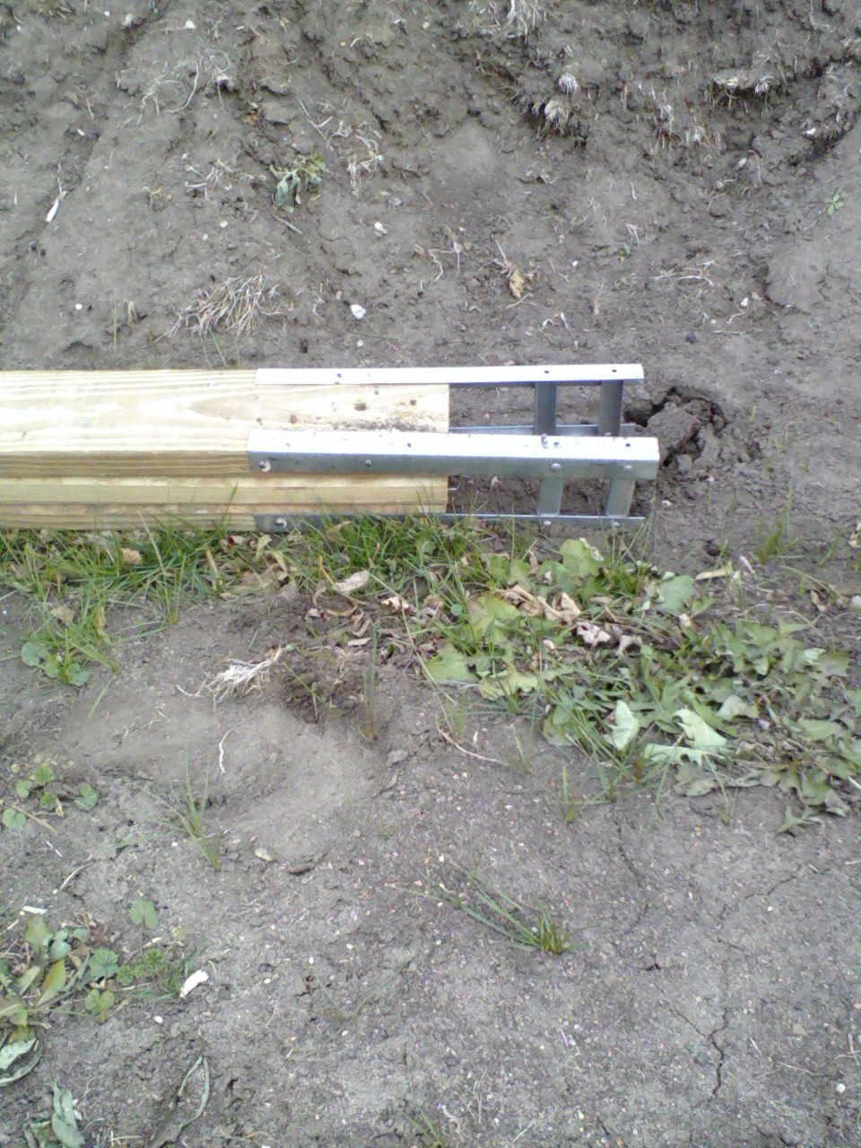

I'm a civil/structural engineer, and I cringed 😬 a little when I read your post-to-footing solution. That one stick of 1/2 rebar will provide absolutely ZERO resistance to uplift, and next to absolutely ZERO resistance to lateral forces. I fear you'll be sorry (and sooner, not later) if you proceed that way. Use either the wet-set Simpson brackets in Sonotubes, or the PermaColumns, and you'll be good-to-go (y)! Also, I love the laminated, untreated post idea, as long as you keep the base of the wood at least 4'' above the finished floor elevation, which is easy to do with PermaColumns (I'm a big fan of these and used them on my own Shop Building). "Dipping" the bottom of the posts isn't a bad idea, especially if you're closer to the FF like you would be with the Simpson brackets... or you can start your laminated posts with treated 2x6's at the bottom. Happy building!!

Yeah, don't do your idea. The rebar inserted in the wood is the problem. With the grain into the end of a post like that, it is the weakest way to attach wood to anything. Expansion/contractio, wood splitting on the end is a recipe for disaster.
Think about firewood - you split it from the ends, not from the sides where it is MUCH stronger. The permacolumn type things work because they sandwich the post from the sides and the fastening bolts or screws go across the grain.

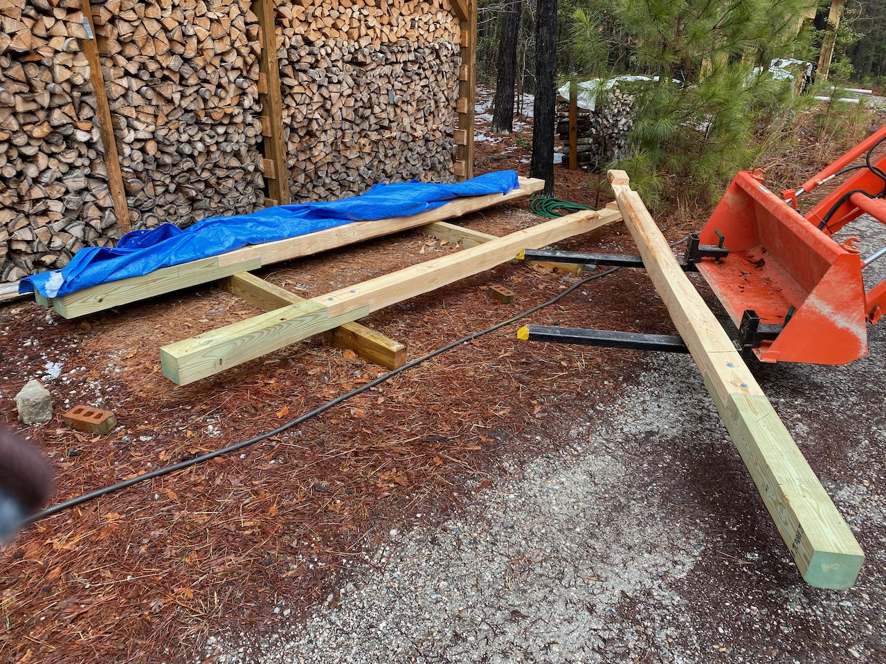

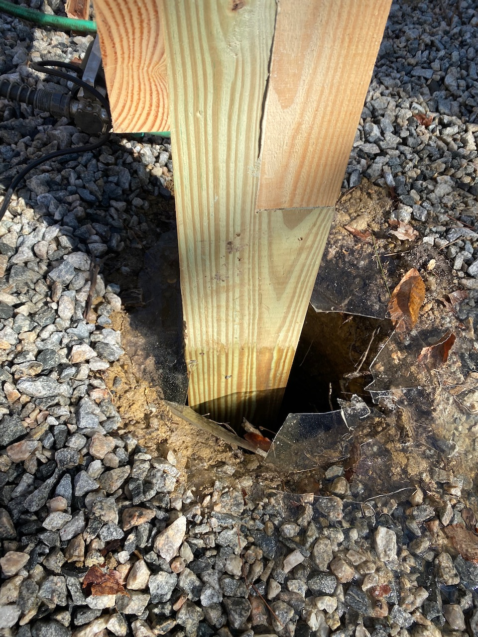

This is what I have been doing to marry my rough-sawn posts to a treated base -- marry up a 4' section of treated lumber on the bottom with a lap joint, construction adhesive, and 1/2" bolts. I hate to even spend the money to buy the short sections of treated lumber, but it lets me create 16' posts for *way* less than what it would cost to buy them nowadays.
View attachment 702655 View attachment 702656
Yep. Love that. Nice work.
You put anything through the post bases (rebar or fasteners) to prevent pull out from the concrete, or do you feel comfortable with the concrete's grip on the post?
And what tool(s) are you using to make that joint cut?
