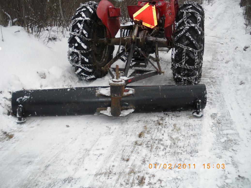

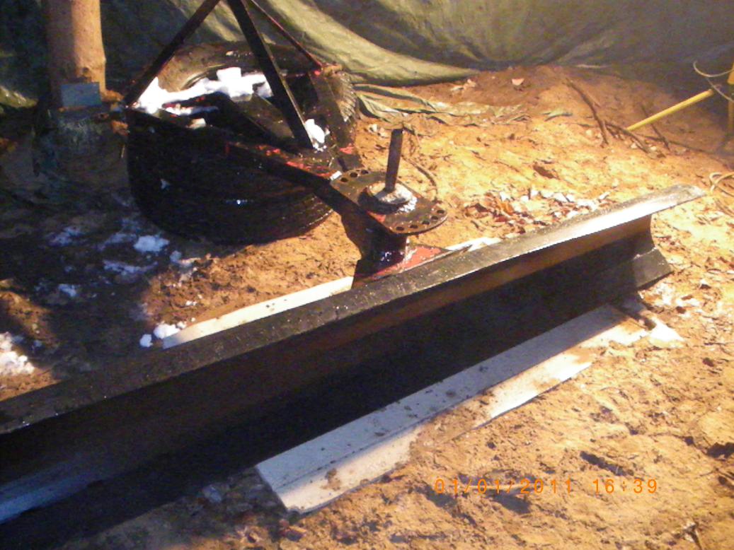

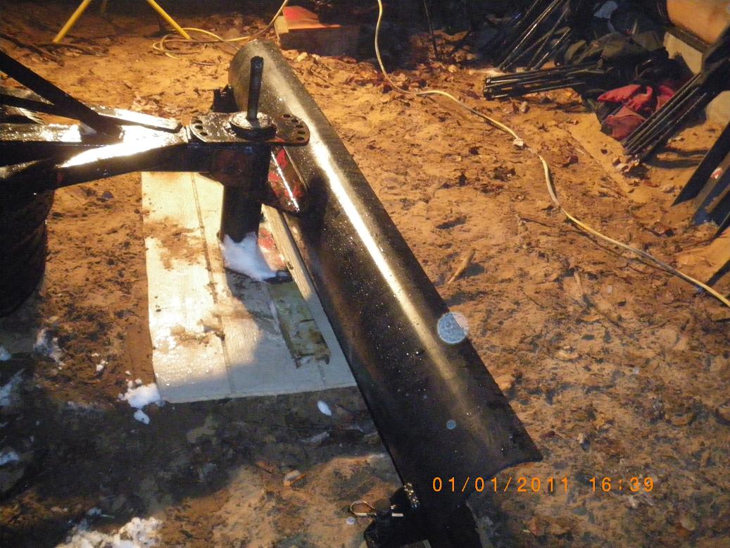

So my wife and I went up to camp in the rain on New Years day. It rained most of the day and with 24 hours of 50F weather the snow pack went down. The road was about 4 inches of slush. I had to get my plow blade together that night before every thing froze up. I had brought a twin 500 watt light, welder and generator. My generator has a 13hp motor and claims 7,500 Watts peak and 6250 running. It has 4x20 amp outlets, 1x30 amp 120v and 1x30 amp 220v. My welder calls for a 120volt 25 amp circuit. At home I have never blown the 20 amp breaker on the circuit using the welder on its highest setting.
Anyway I could only weld for about 15 seconds and the main breaker on the generator would blow, not the individual 20amp breaker on the outlet. As I did not have a three prong 30 amp plug, I wired up 1/2 of the four prong 30am 220 plug. Still would blow the main fuse, even with the 500 watt light off (using a flashlight to see). I ended up turning the welder down to a lower heat setting and making multiple passes. I was dissapointed that this generator did no better then my 4k generator. I will try it again once I get a 3 prong plug on the 30 amp 120 outlet, but not holding up much hope as its the main breaker that goes and not the smaller breaker on the branch circuit.
Well I got the job done and managed to clear the road, man I have to get a rear light on the Massey, plowing by flashlight is tiring. Here are a couple of pictures and I will try and post a day time video. As the real work was done at night I did not take any videos.

The blade looks good. I see you rigged your chains almost exactly the same way I did. I have a 5 gal bucket of extra crosslinks so just ran some of them them back and forth over the tread to keep them on top. Those few warm days we had caused a bear to stir up and walk across my son's lawn to the burning pit in search of a meal.
   / Homemade Snowblade
#18
I see you rigged your chains almost exactly the same way I did. I have a 5 gal bucket of extra crosslinks so just ran some of them them back and forth over the tread to keep them on top. QUOTE]
I had my Bear Banger handy during our walk. Problem with a good melt, a wolf track can look like a bear track.
While I made the chains for my Kubota, truck and everything else, these chains came with the tractor for an extra hundred bucks and are manufactured. (by someone else)
