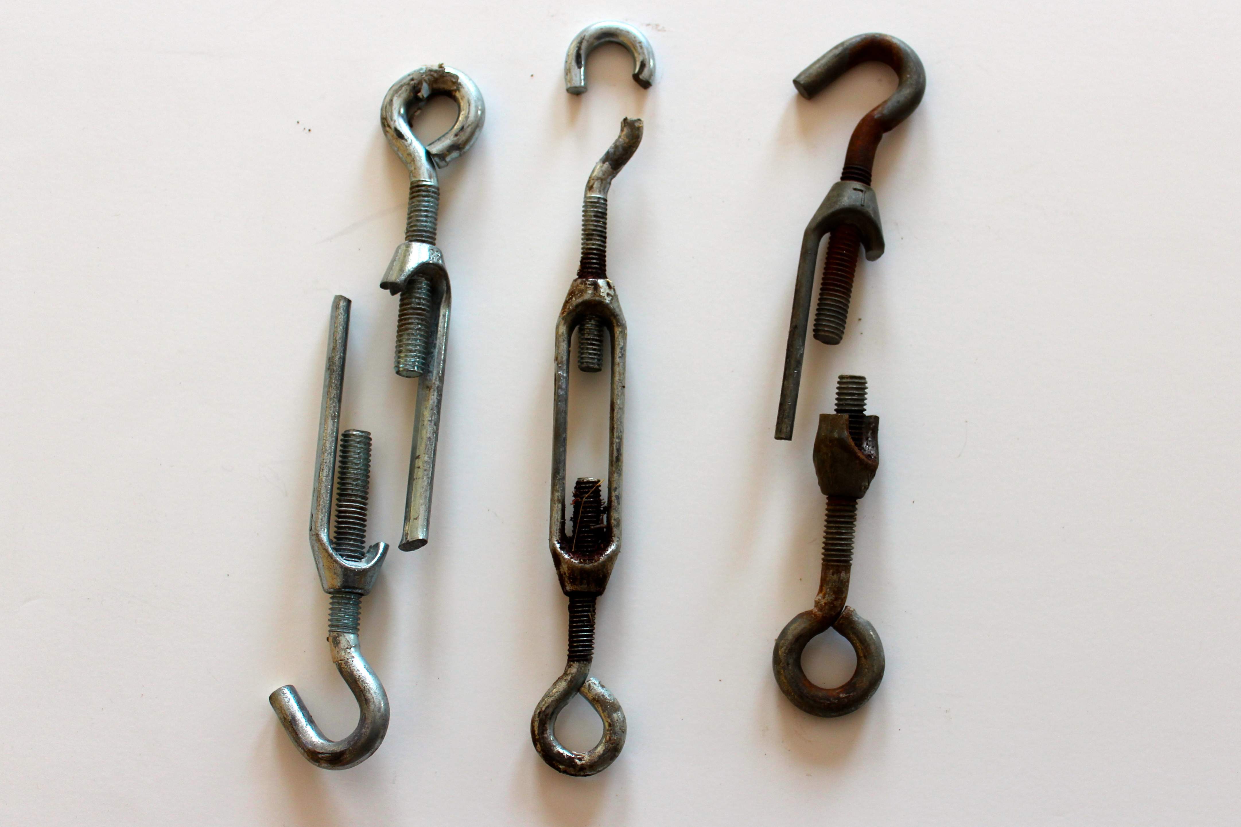

If that turnbuckle is for belt tension, it's also transmitting vibration to the rest of the device and in doing so its attachment points would be taking a beating. Perhaps it could be eliminated and the idler pulley used for tension, even another added to keep slap to a minimum. There must be enuf hp there to overcome a bit more friction in the drive train. Loosening that connection might also mean a lighter bob needed on the top pulley.

Very insightful comments old grind! Here's a photo of the three turnbuckles (belt tensioners) that have failed. This has been the only failure on the machine so far. The second photo shows a top link, that if it were small enough, would be the ideal replacement for the turnbuckles that I have been using. Two of the turnbuckles shown have been used extensively in other applications prior to being used on the screener so that might make a difference. The planes of the two turnbuckle mounting surfaces are not in alignment on my screener, so this puts a pretty hefty non-linear load on the turnbuckle. If everything were perfectly aligned the turnbuckle would be alternating between tension and compressive loads only. That would be bad enough with cheap turnbuckles I have used but with the misalignment we also get extra metal fatigue thrown in and that might explain the resulting breakages shown in the photo. When adjusted and tightened, the turnbuckle, vibrating pulley, bearing mount and screen frame are intended to be a "solid" unit that vibrates together.

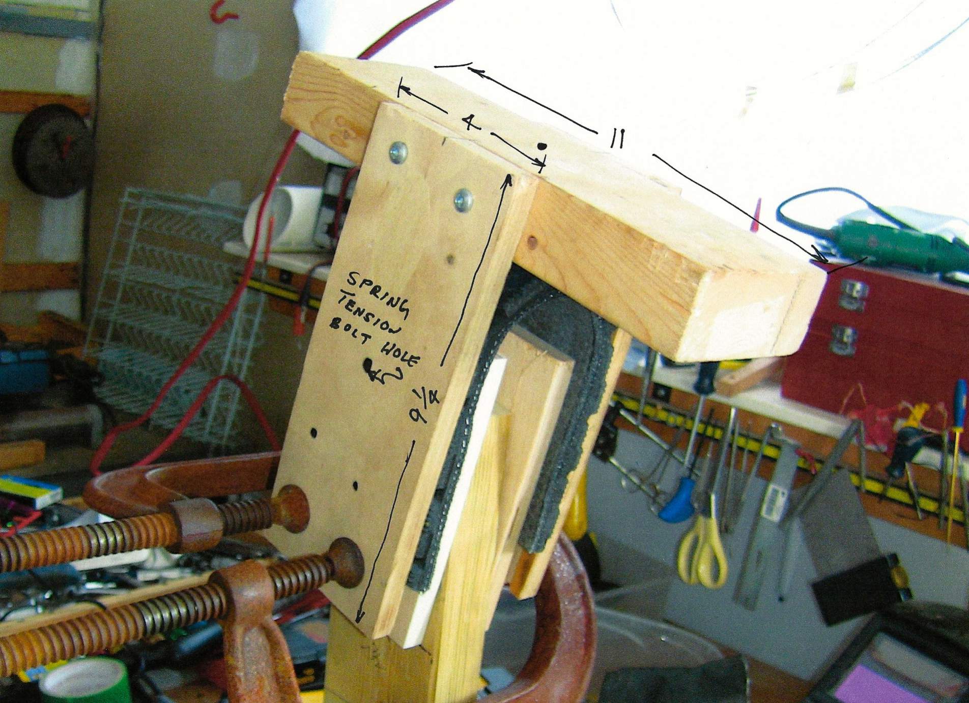

No problems at all with the tire springs and tire hinges. I thought that the two springs might sag with time and usage so I built-in a provision to make an adjustment for this by making two in-line holes at the "bulge" of the springs through which a bolt and nut can bring in the bulge if needed. (I will post a graphic of this a bit later).
Think that doing away with the turnbuckle spring tensioner might be another approach that could be taken. But have to say that I'm more than happy (and a bit surprised) with the operation so far.

tractorgp; No problems at all with the tire springs and tire hinges. I thought that the two springs might sag with time and usage so I built-in a provision to make an adjustment for this by making two in-line holes at the "bulge" of the springs through which a bolt and nut can bring in the bulge if needed. (I will post a graphic of this a bit later). \[/QUOTE said:
As promised here's a graphic showing the holes made in the tire springs that are intended for a bolt and nut and washers. So far the springs have held up fine so no need for the adjustment feature to be used.
