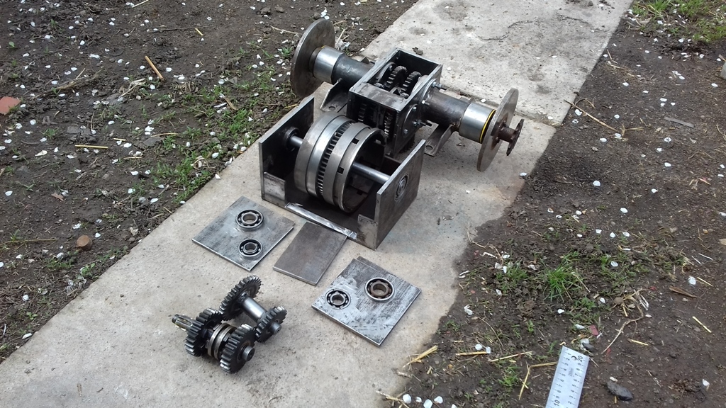

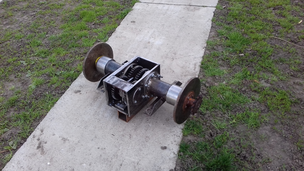

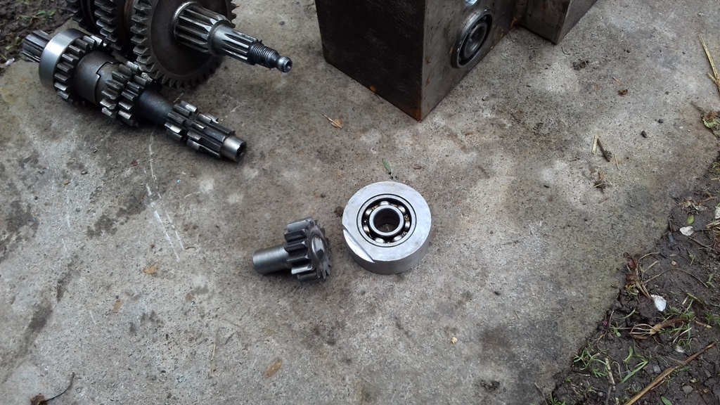

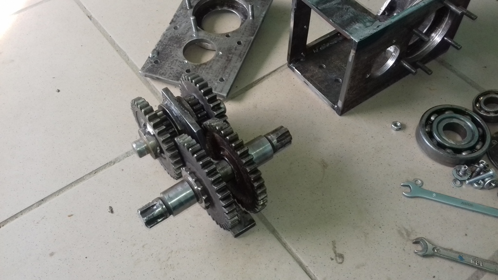

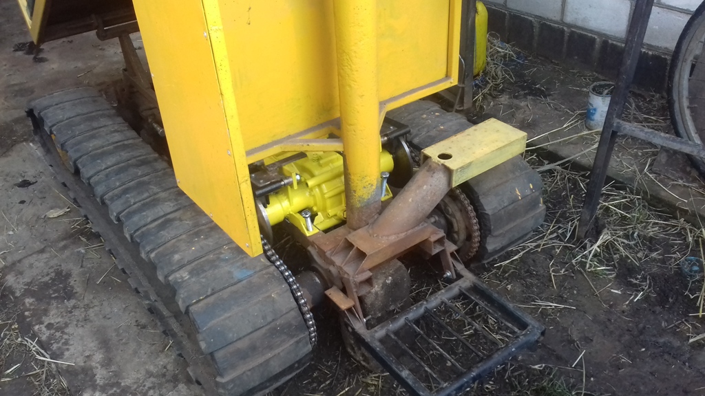

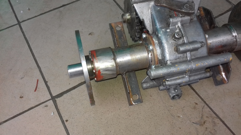

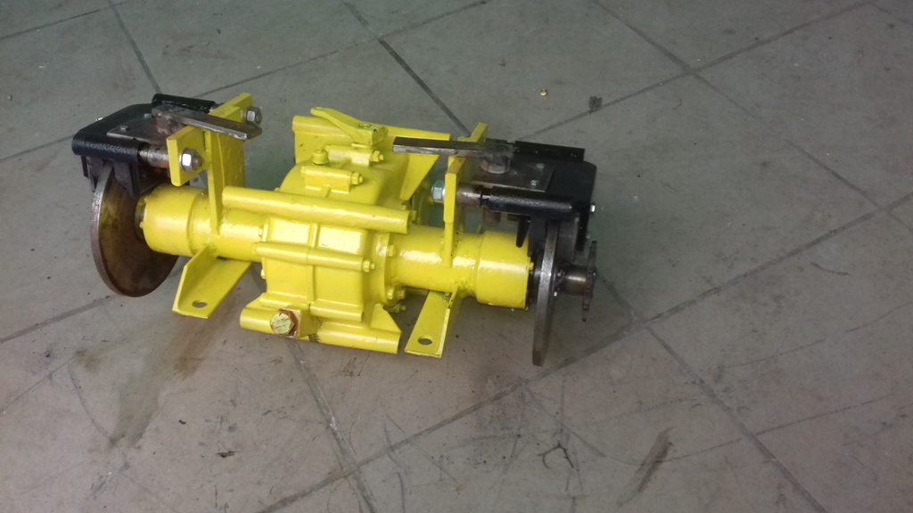

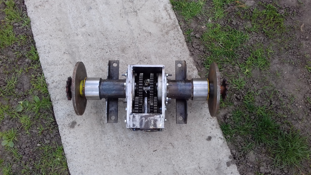

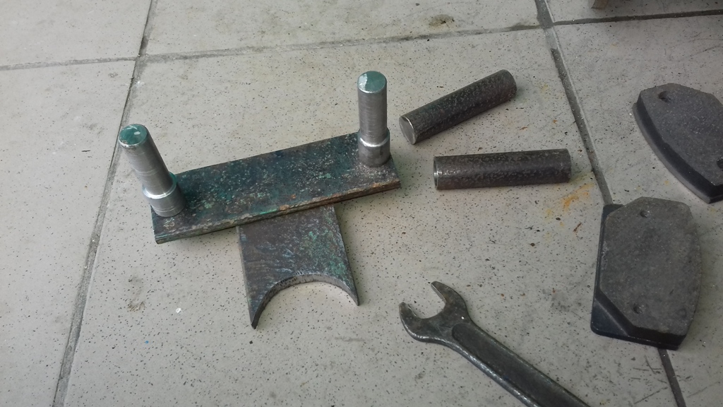

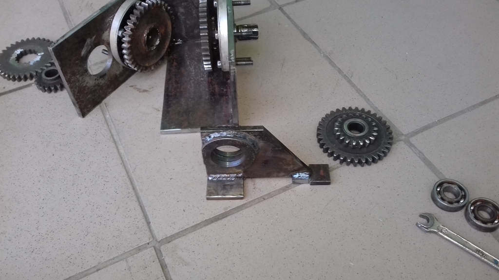

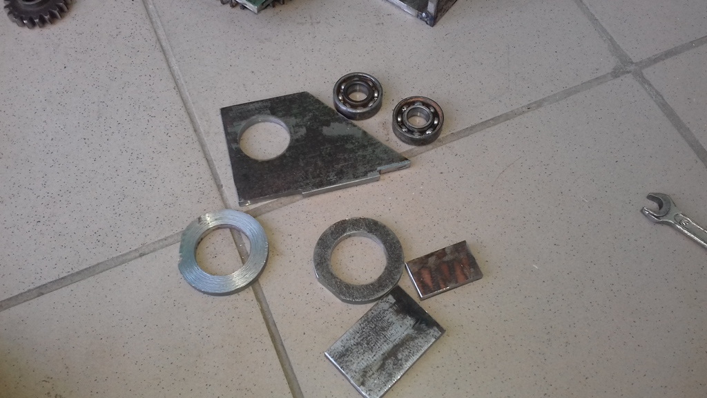

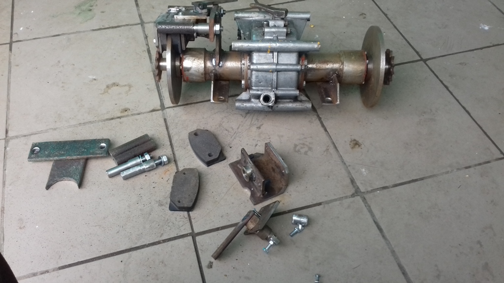

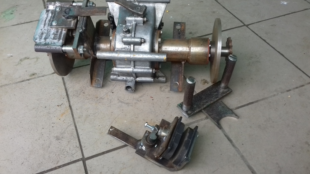

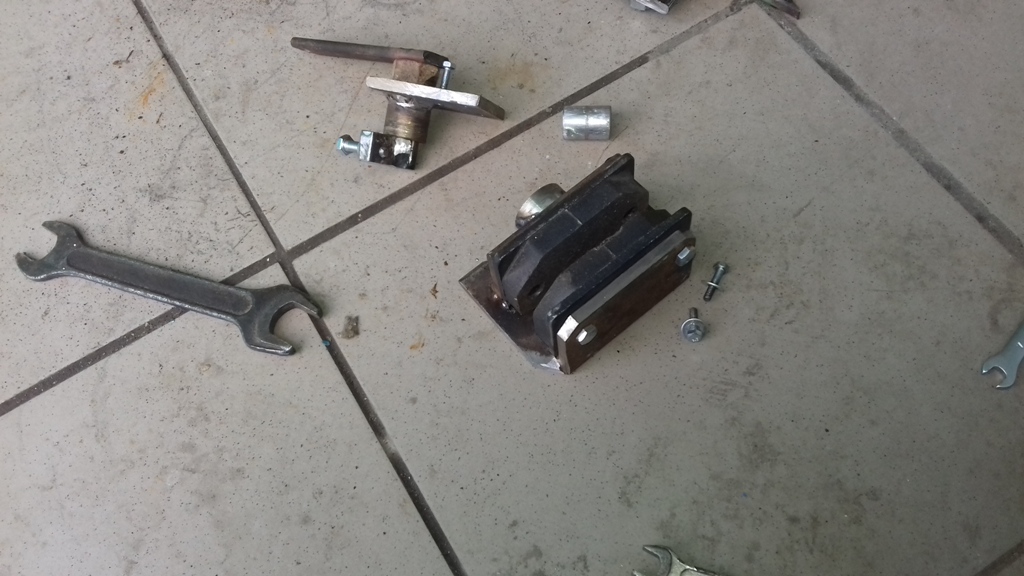

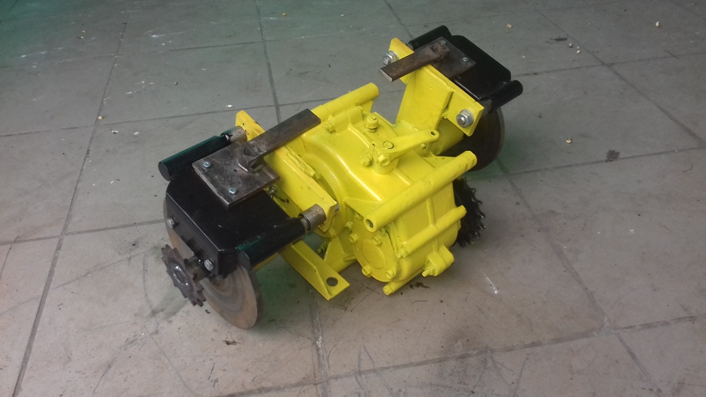

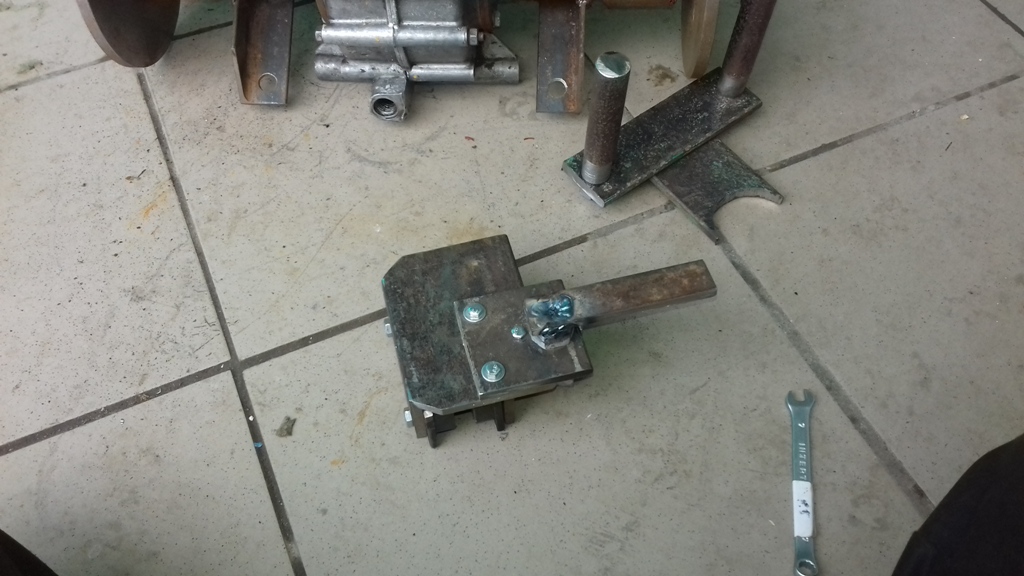

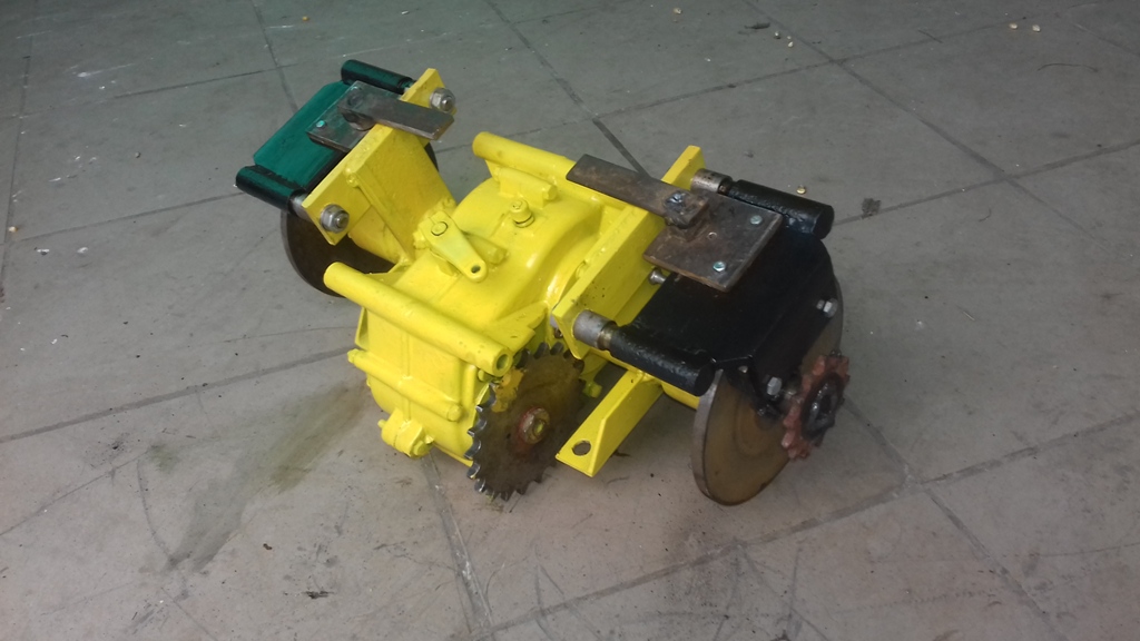

Fixing bearings. The next step will be the manufacture of brake support
20190129_143333.jpg 20190129_143439.jpg 20190129_155246.jpg 20190129_155625.jpg
   / Homemade Tracked mini dumper #35
Looking good, lots of progress :thumbsup:.
   / Homemade Tracked mini dumper #36

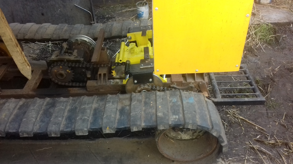

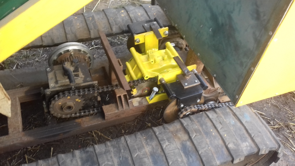

Welcome back and thanks for the update. Is there anything that holds the track on? I would be concerned with it walking off with no center sprocket. Keep up the great work! One thing in the video, it's just weird to me seeing the piece move and the drill bit not spinning...LOL
a little convex shape on the wheels would keep the track on, that's what is used on old machinery that use a flat leather belt, works great..

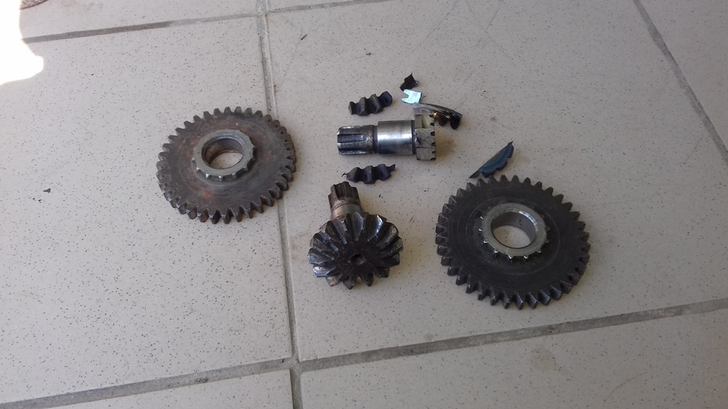

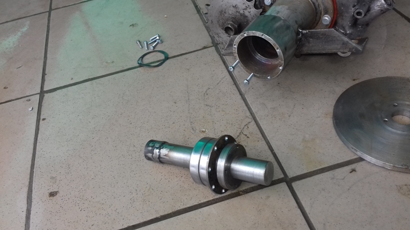

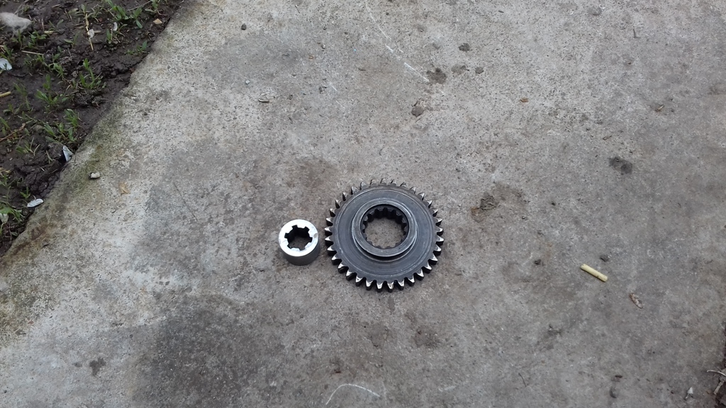

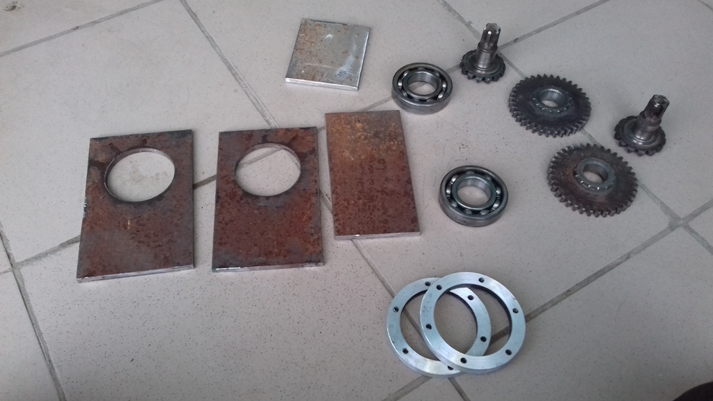

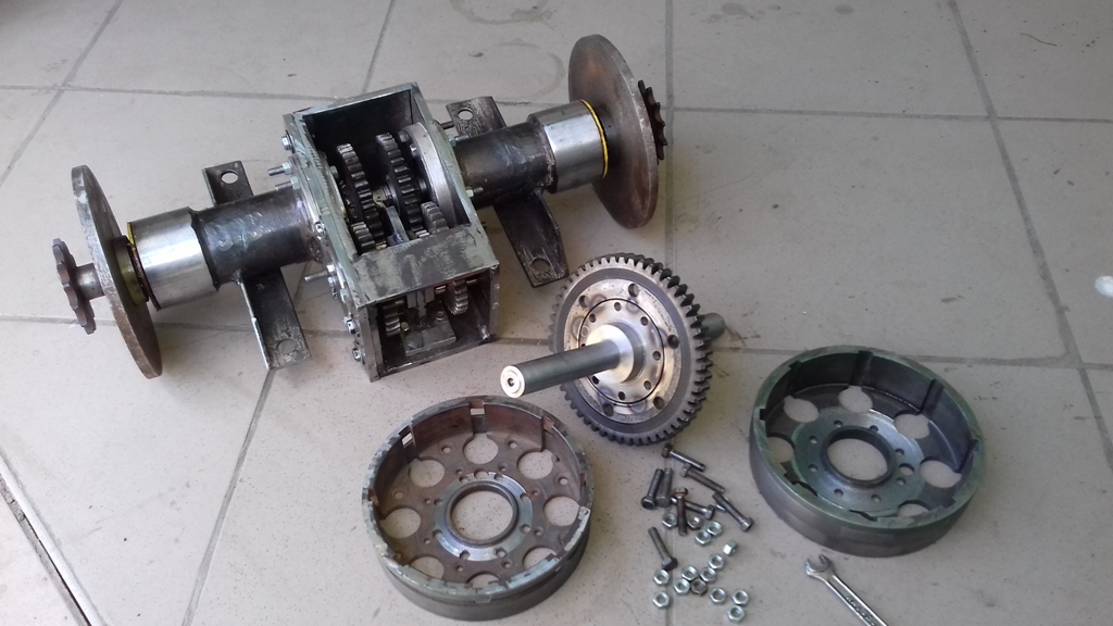

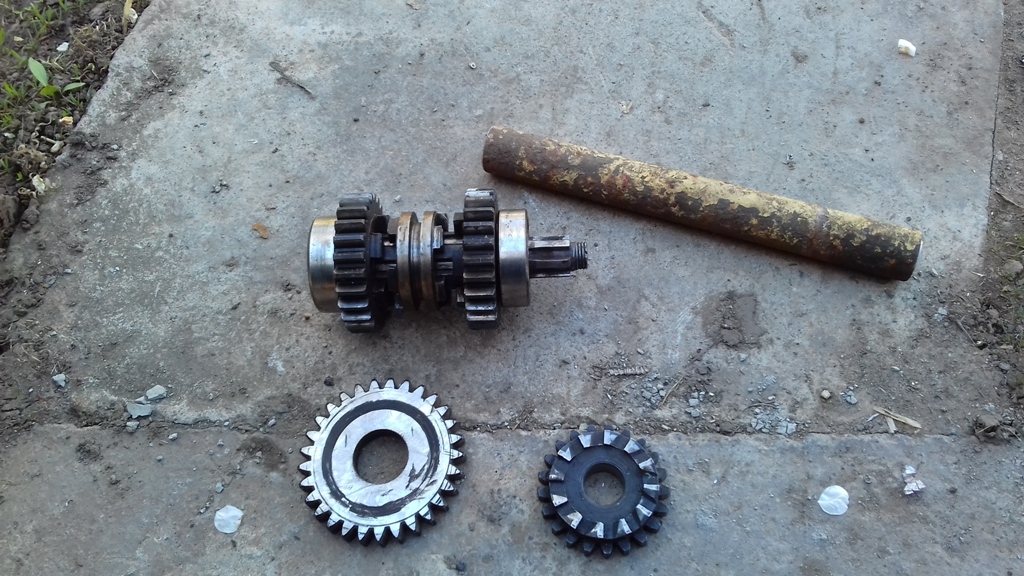

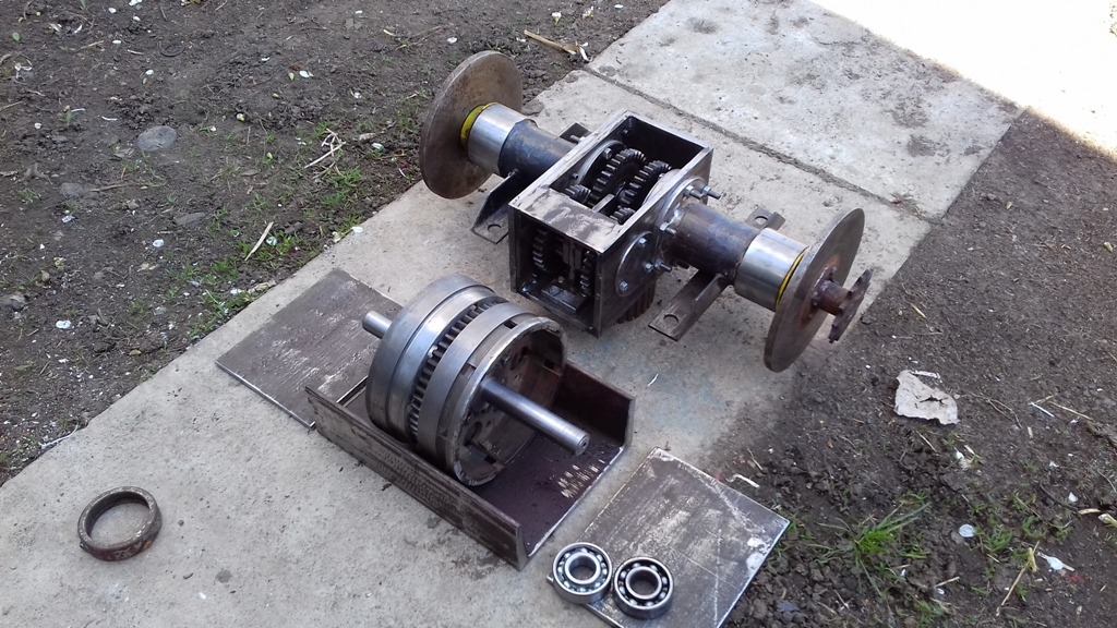

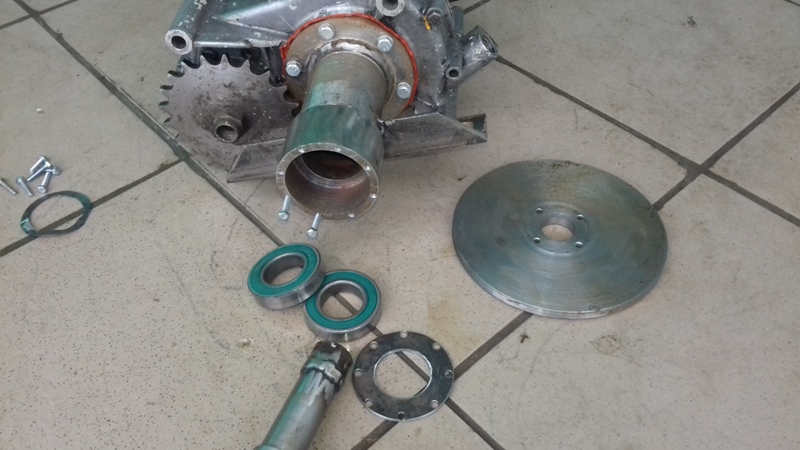

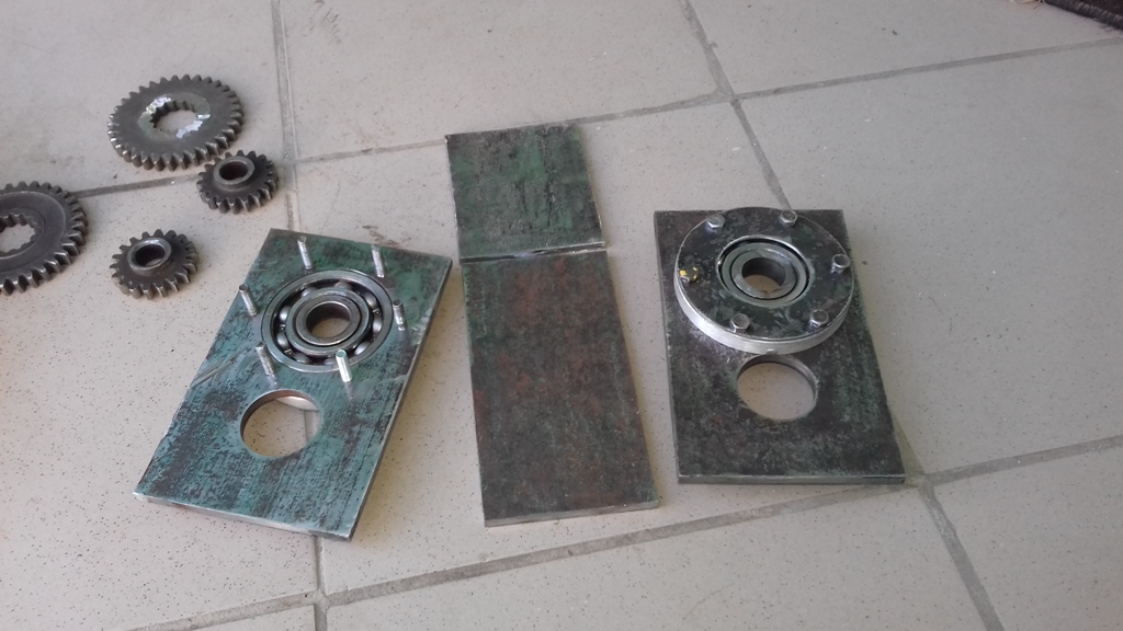

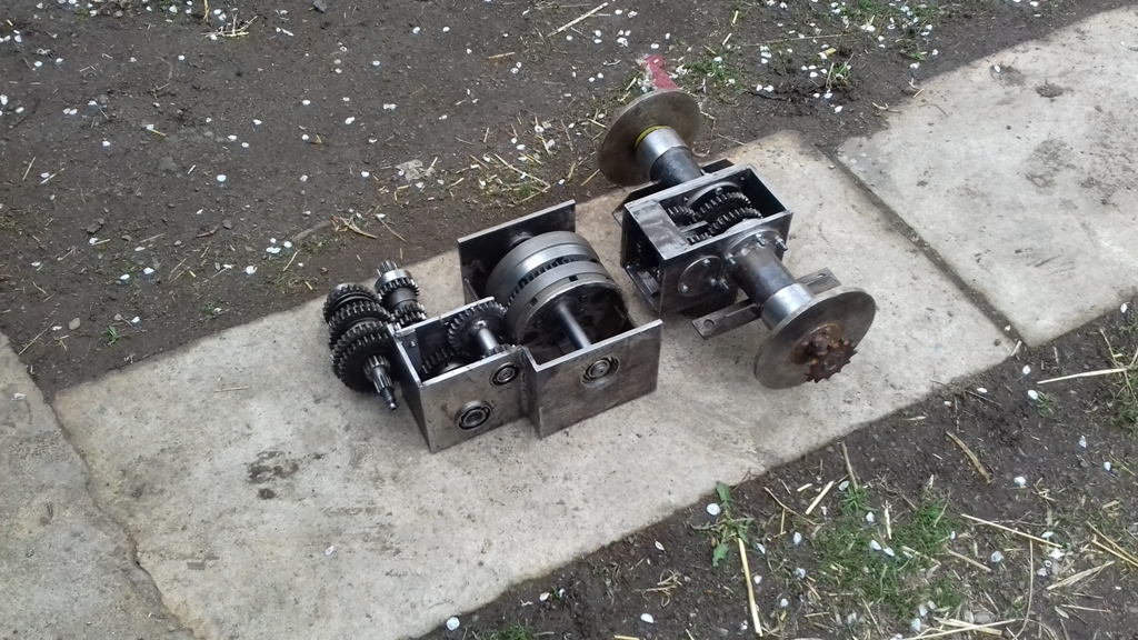

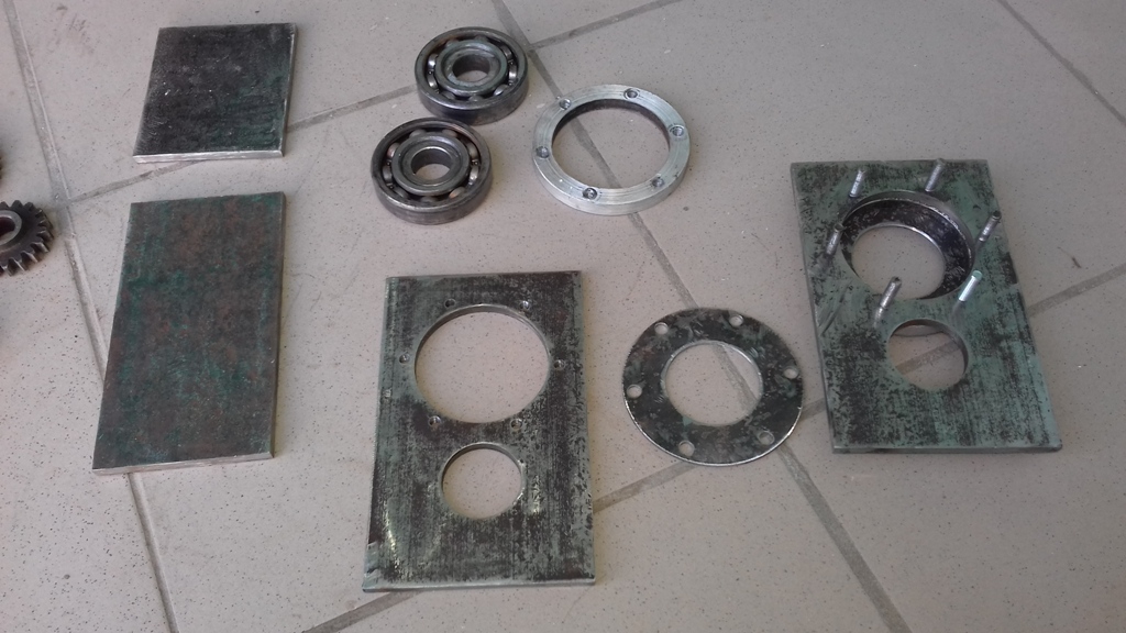

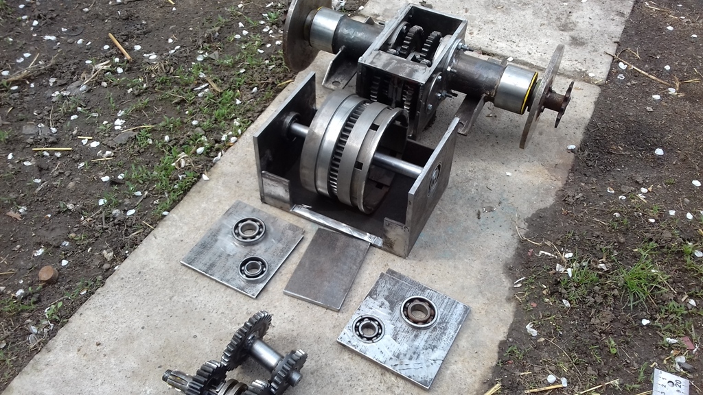

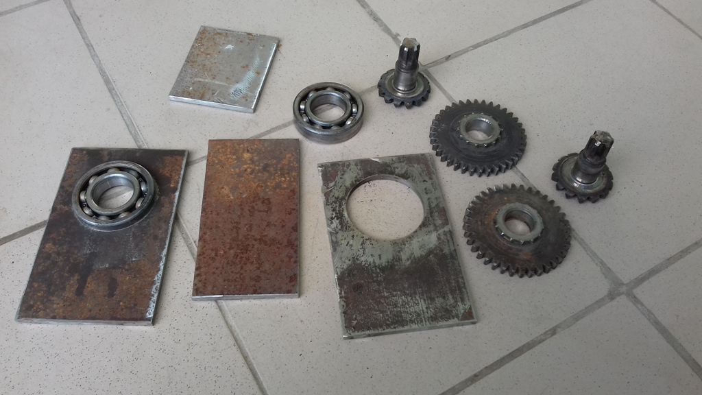

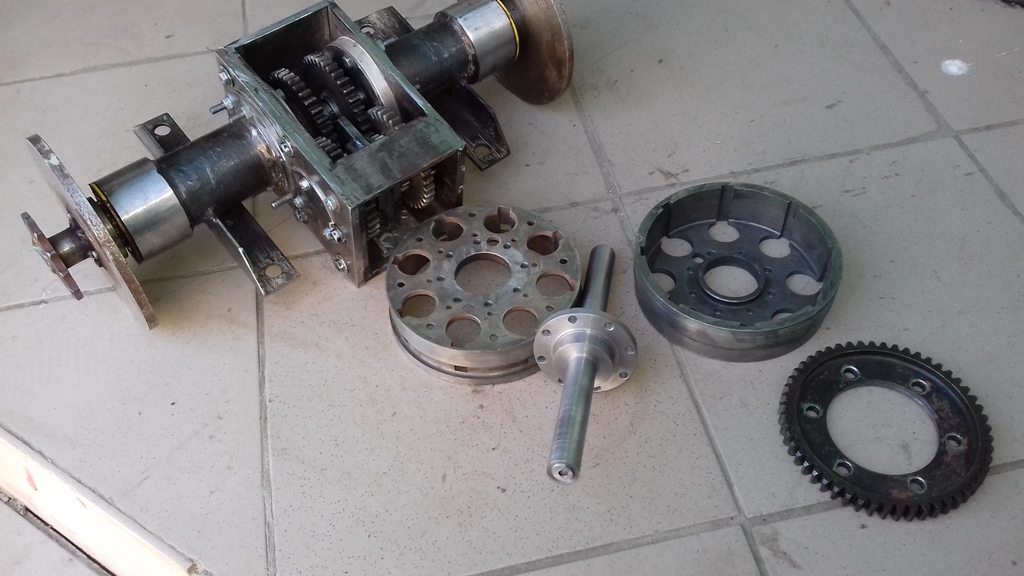

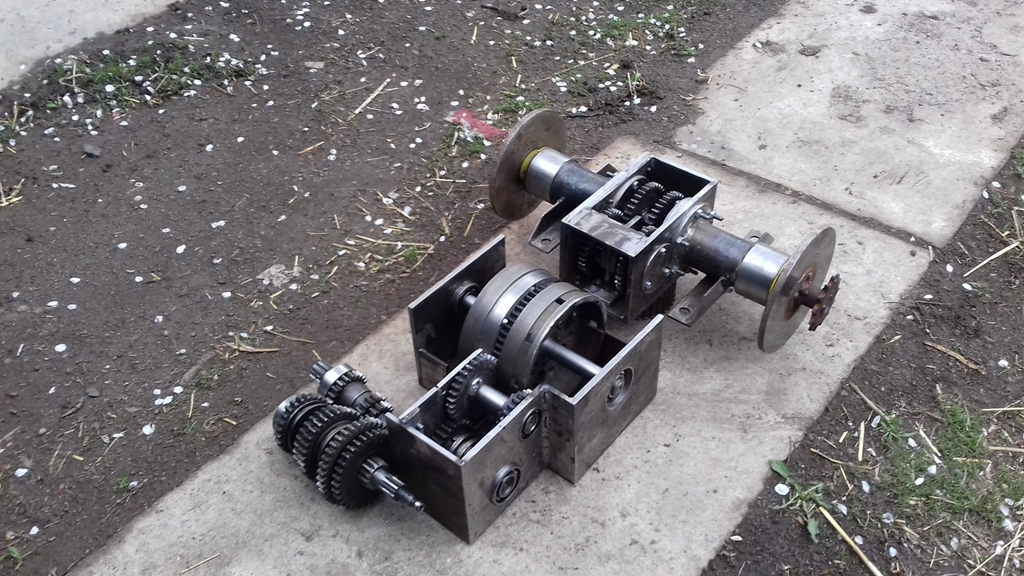

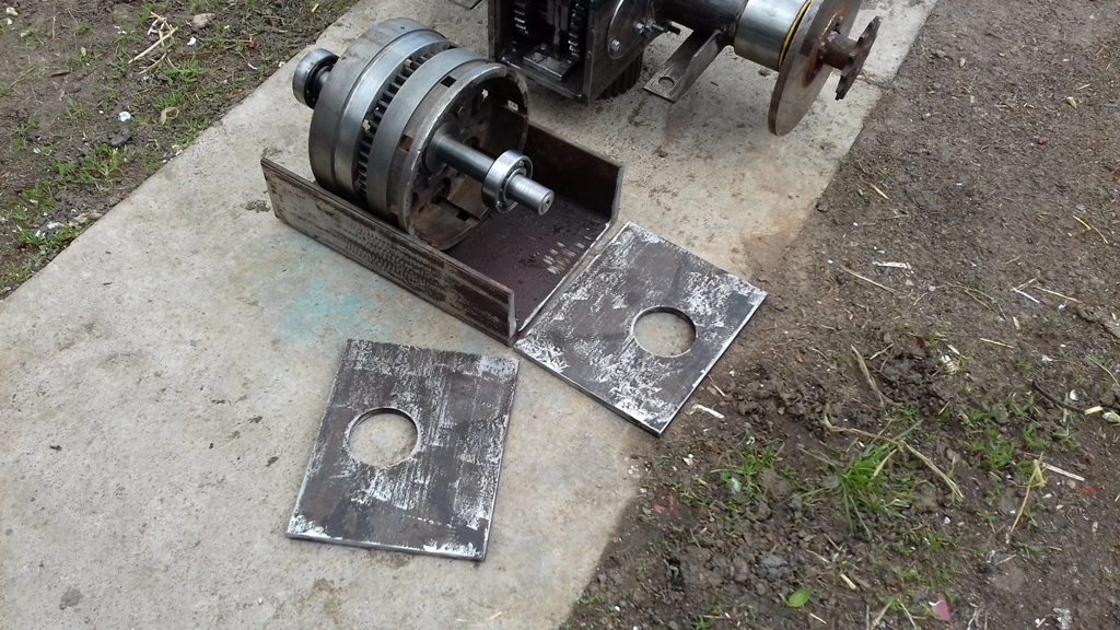

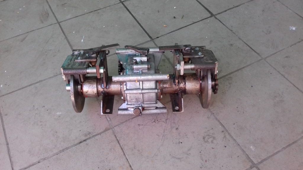

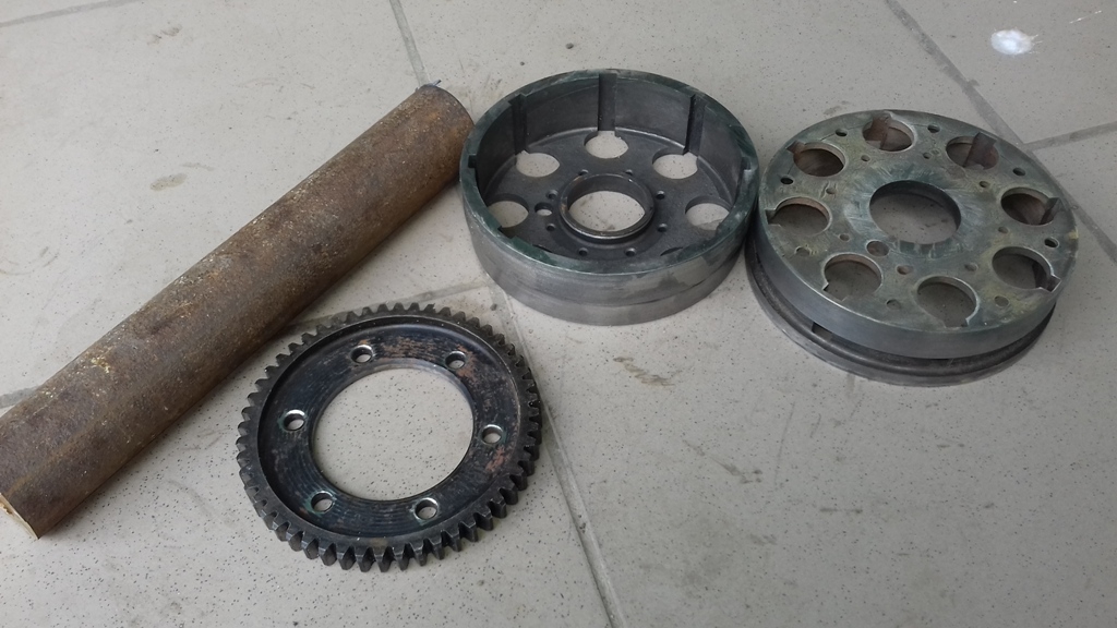

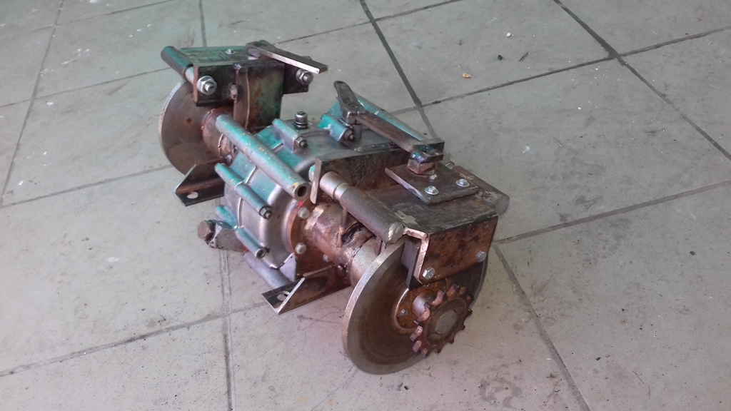

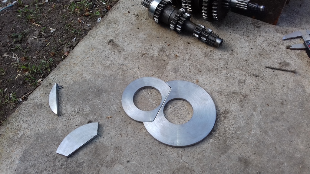

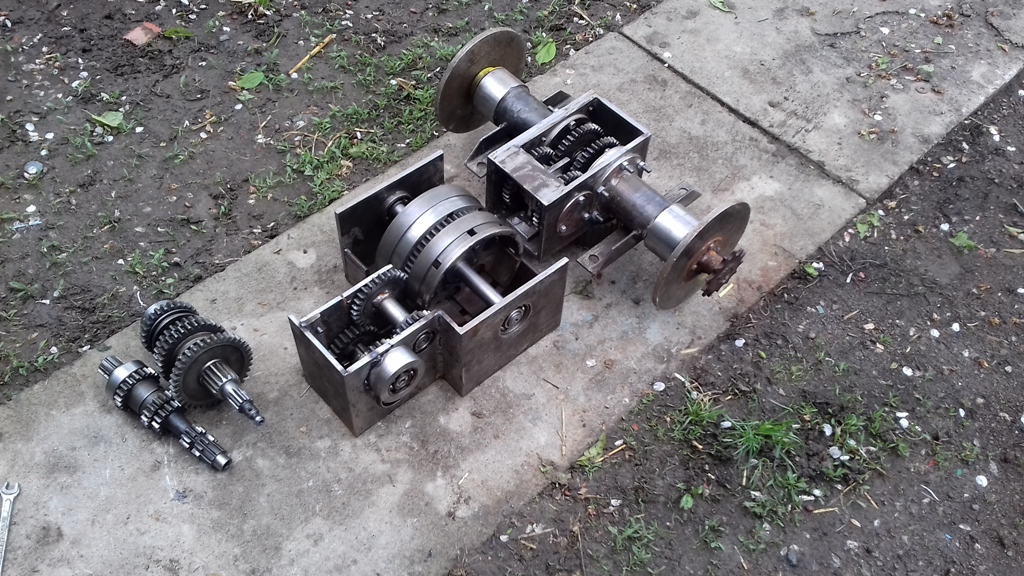

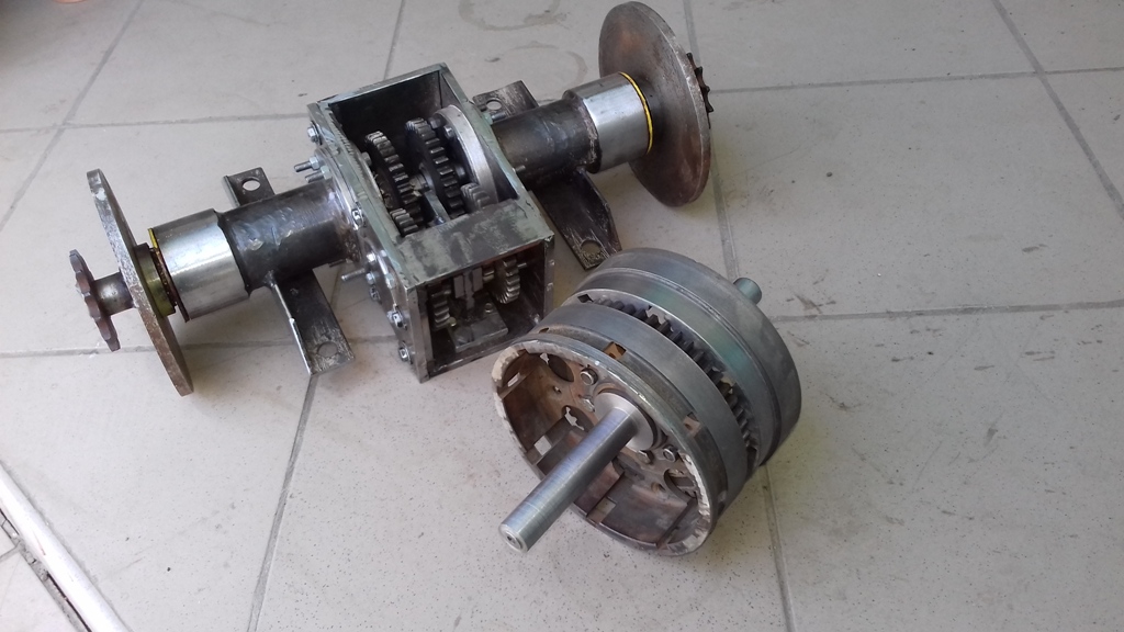

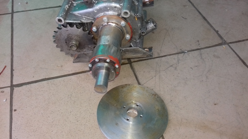

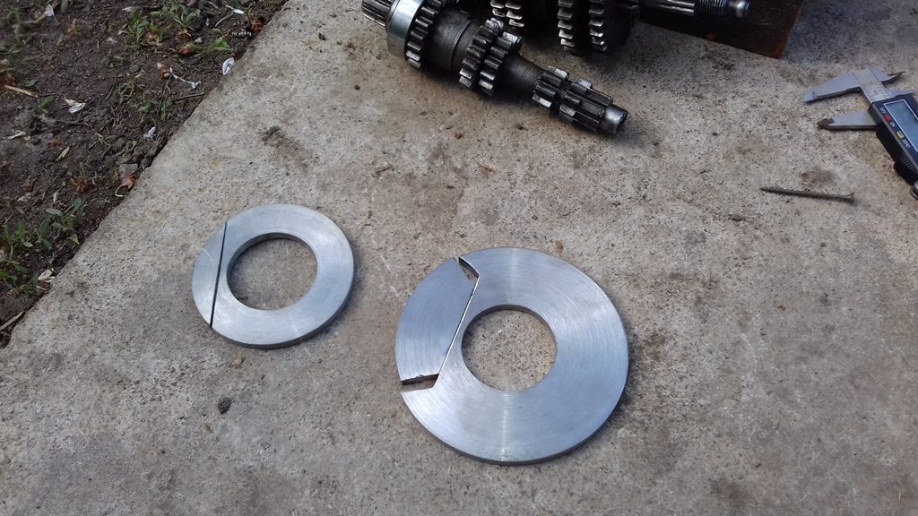

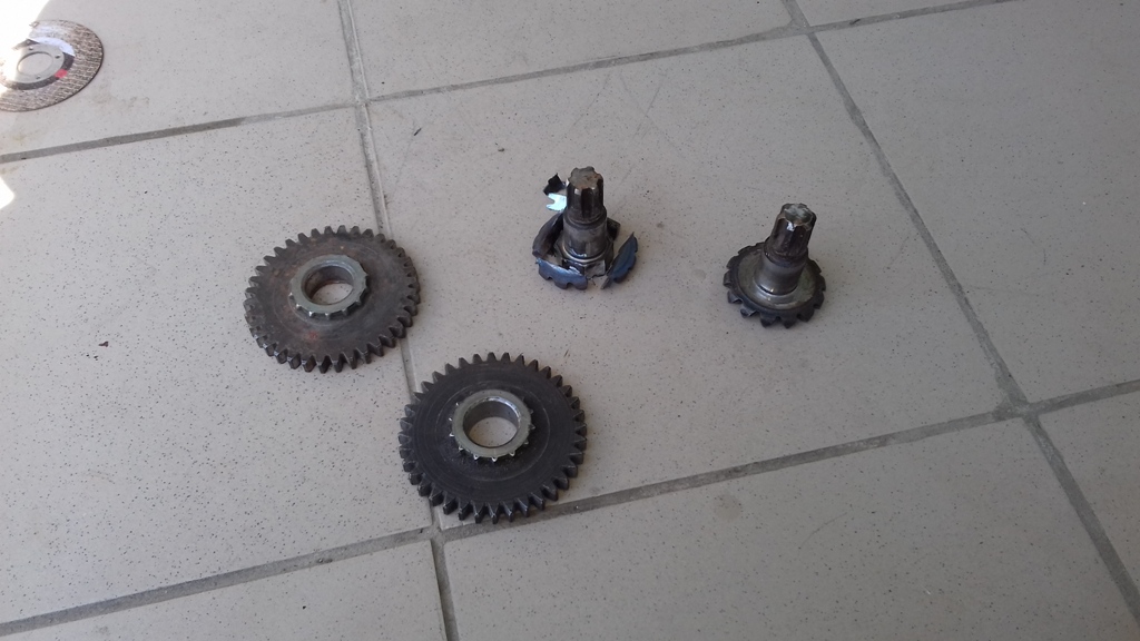

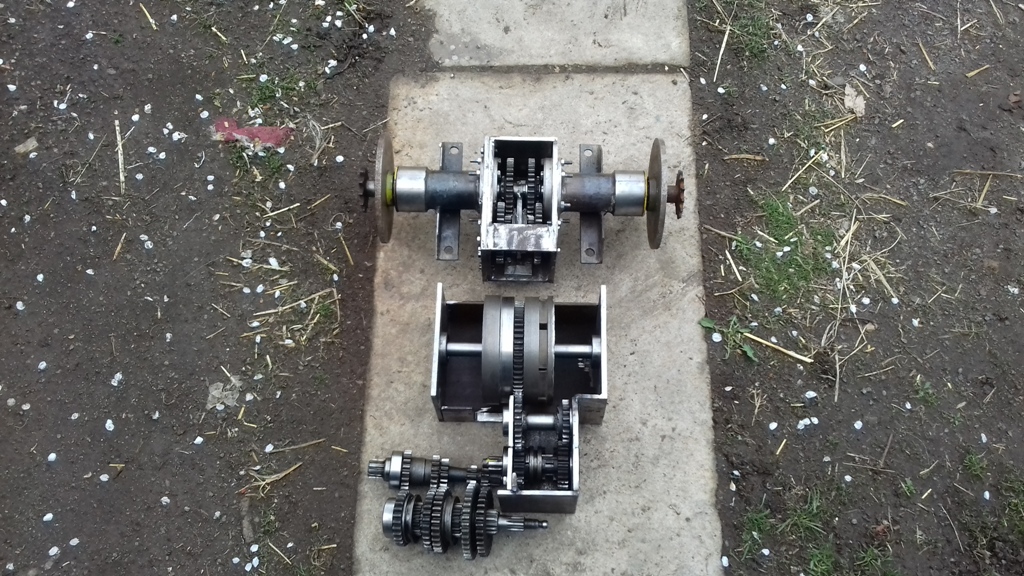

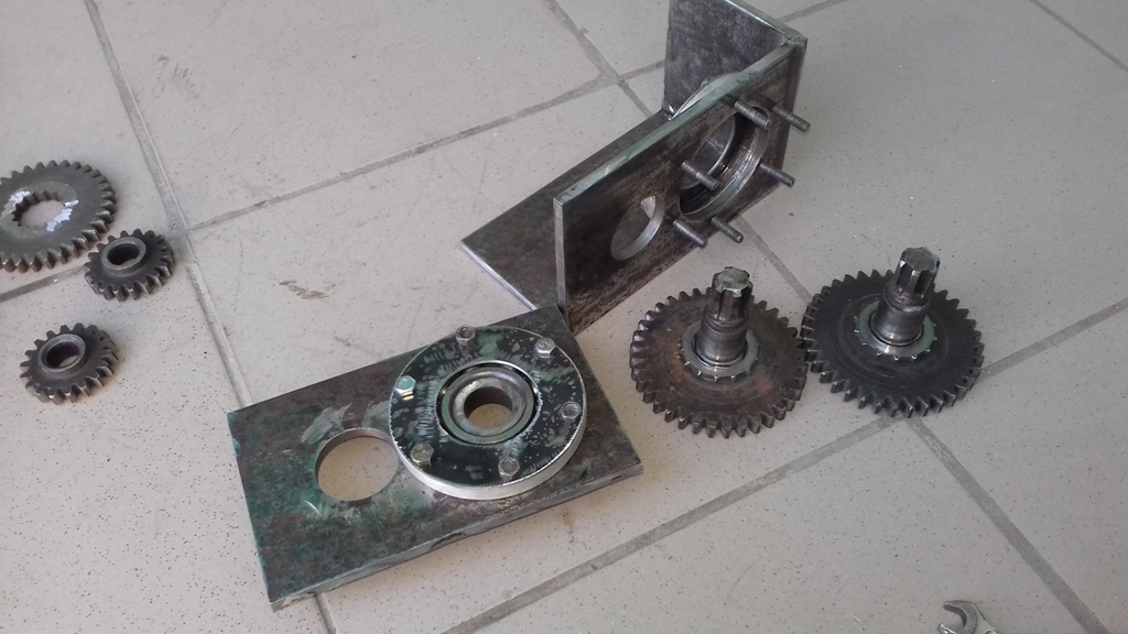

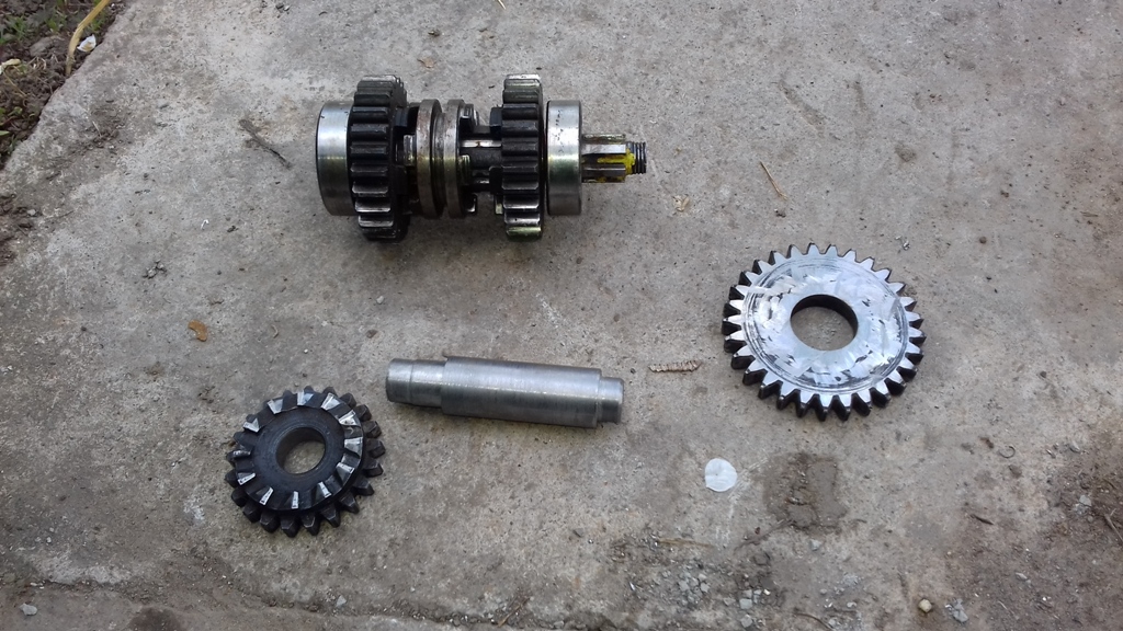

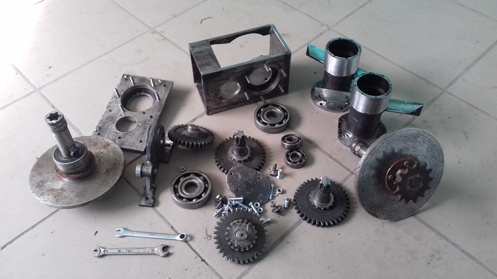

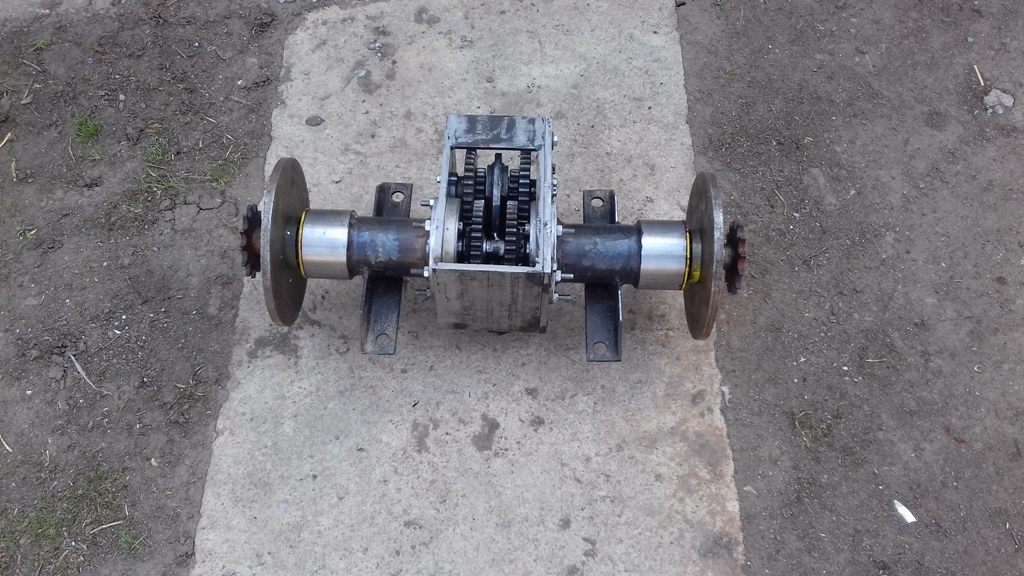

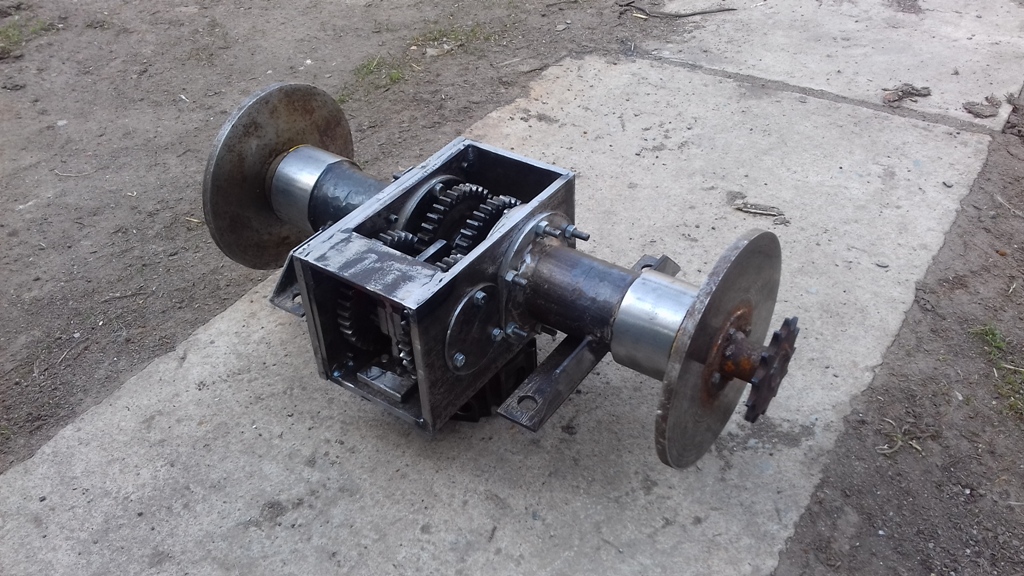

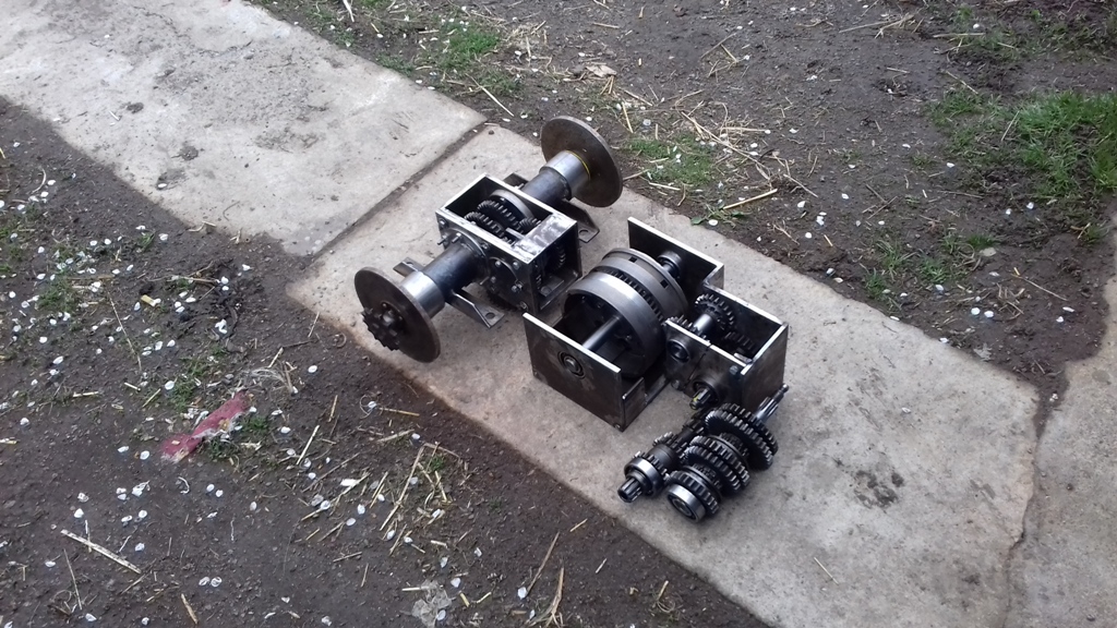

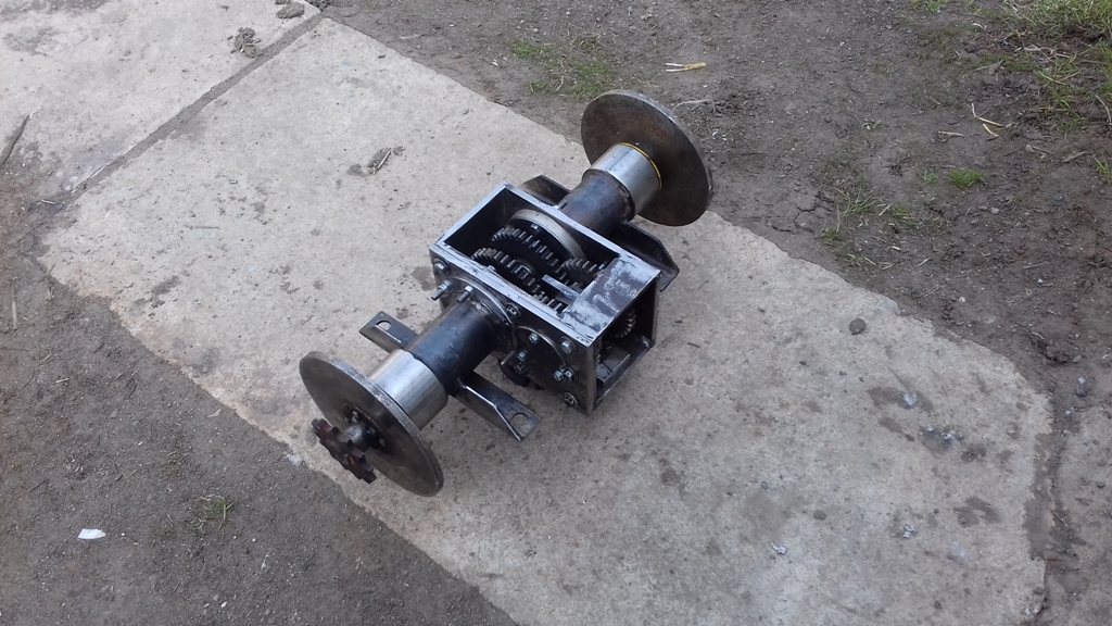

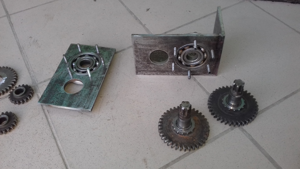

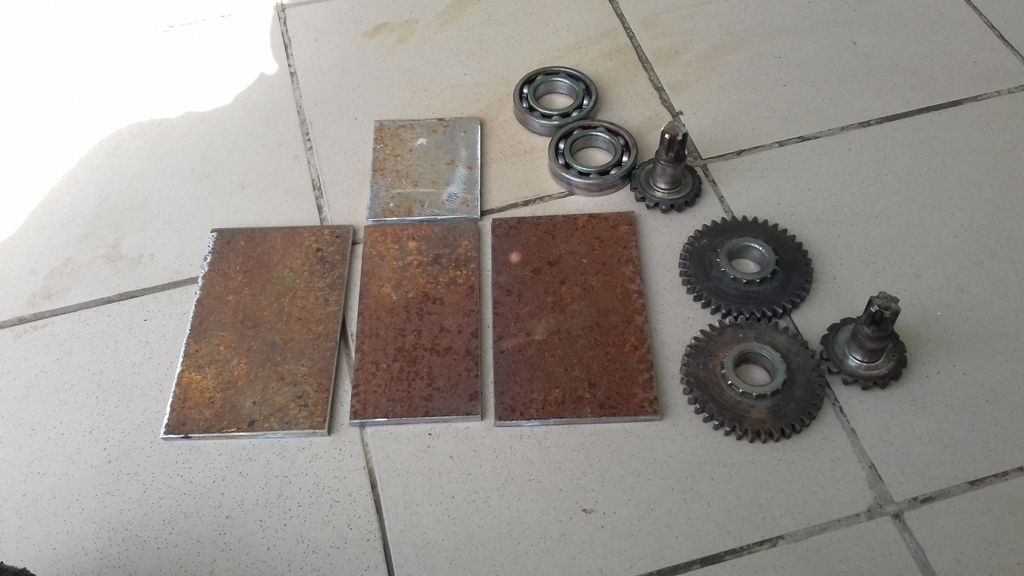

Hi. I start all over again. The transmission will be 100% new. I gave up the differential, I use two clutches for onboard turning.
20200409_094354.jpg 20200401_144629.jpg 20200402_140514.jpg 20200401_172557.jpg 20200409_093952.jpg 20200409_090040.jpg 20200409_085236.jpg 20200402_140555.jpg 20200409_094122.jpg 20200401_165005.jpg
