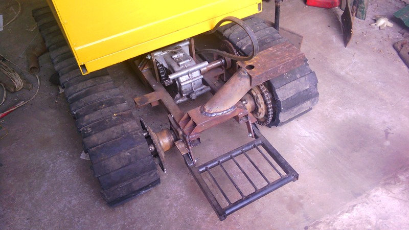

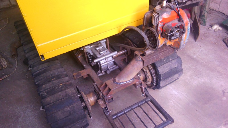

Installing the engine. Two stroke gasoline engine, 100cc 5 horsepower. I know it's a bad idea, but I do not have another engine. The engine made in 1982, but I set a new piston with the cylinder seals and bearings. After I'll change the compression ratio, set a petal valve and a new carburetor.
