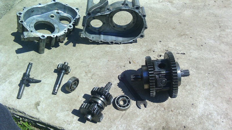

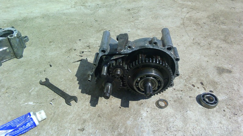

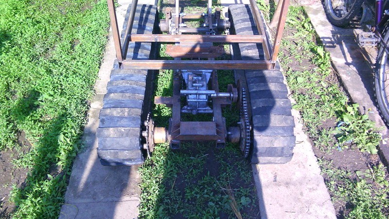

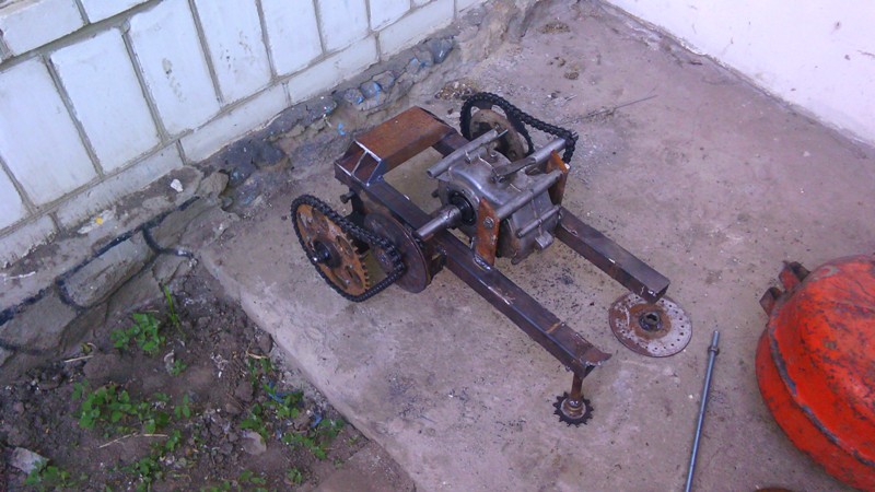

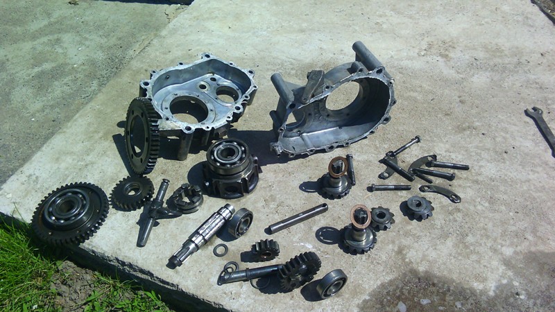

As used gear rear axle of a motorcycle. It has a built-in differential and reverse.
The structure of gear
/ Homemade Tracked mini dumper

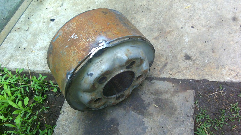

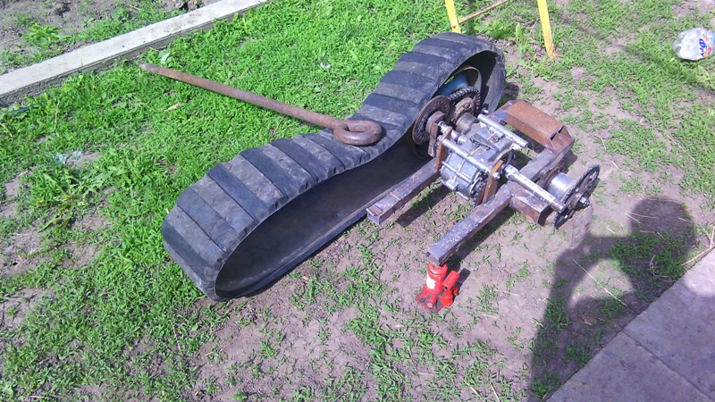

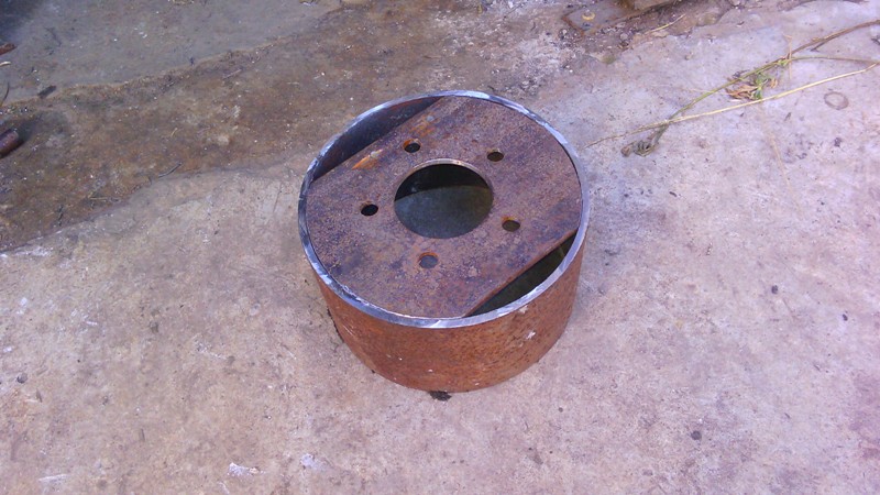

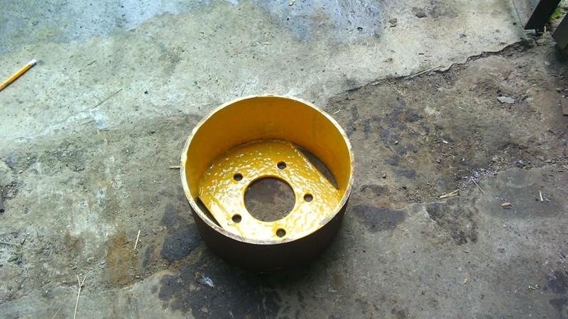

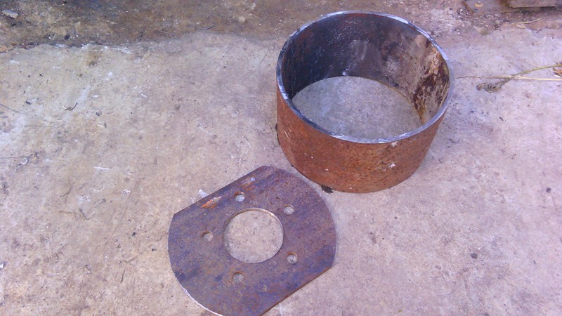

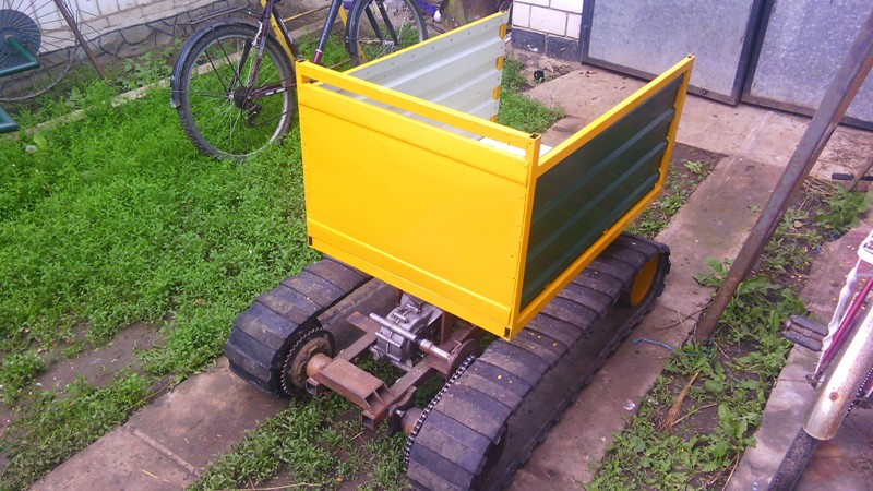

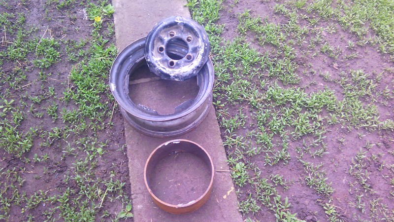

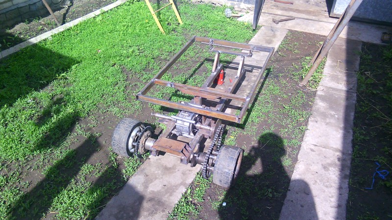

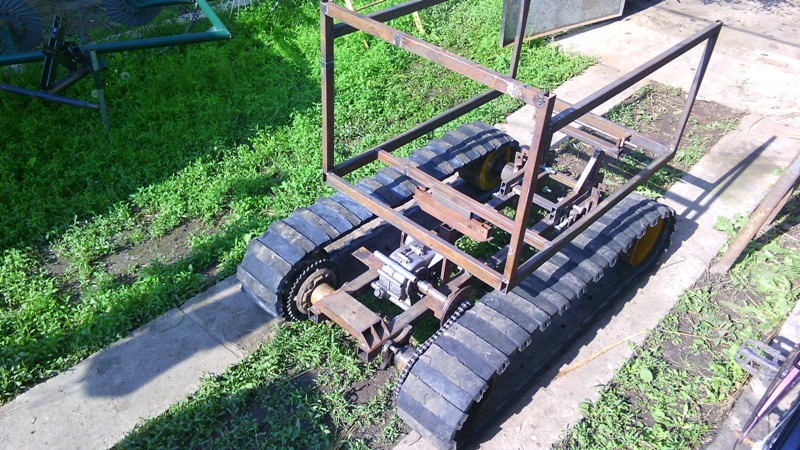

I will use differential turn, that will be installed on each disc brake tracks. Stopping the left, the right will spin and thus will run turn dumpers.
Tracks are made of old tires from the truck. I cut out the treadmill and cut a new tread.

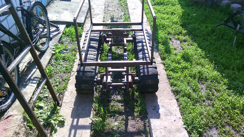

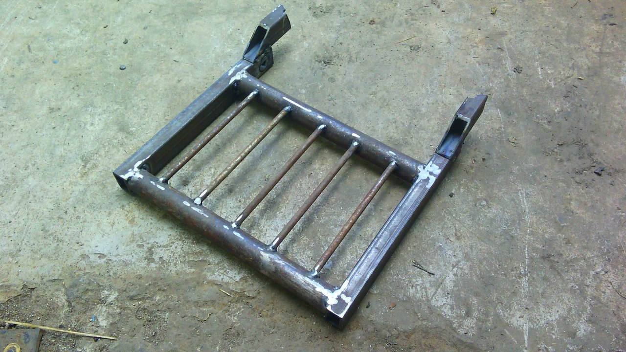

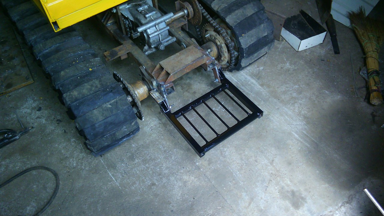

I will be able to go near dumpers, or ride it standing. For this made footrest, if desired it can hide.

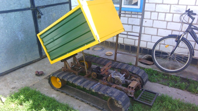

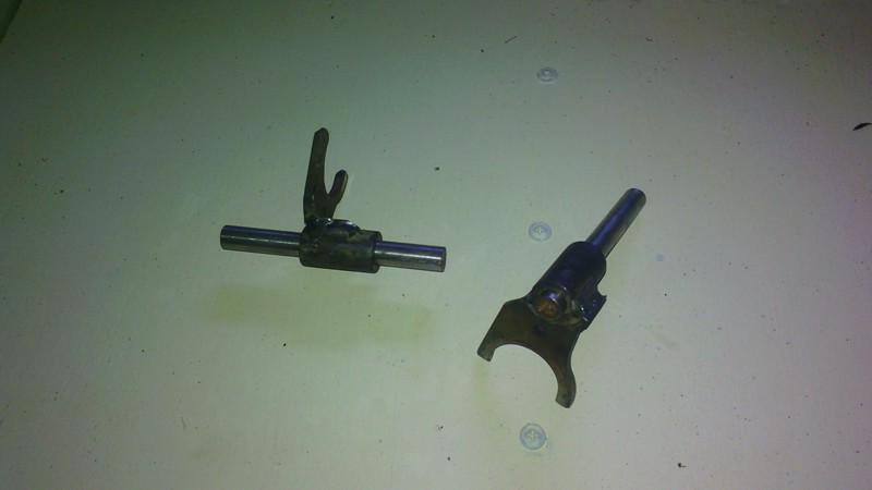

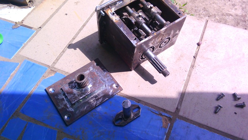

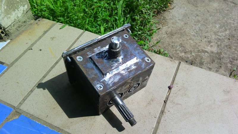

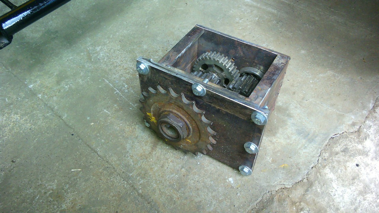

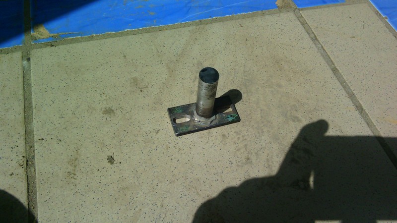

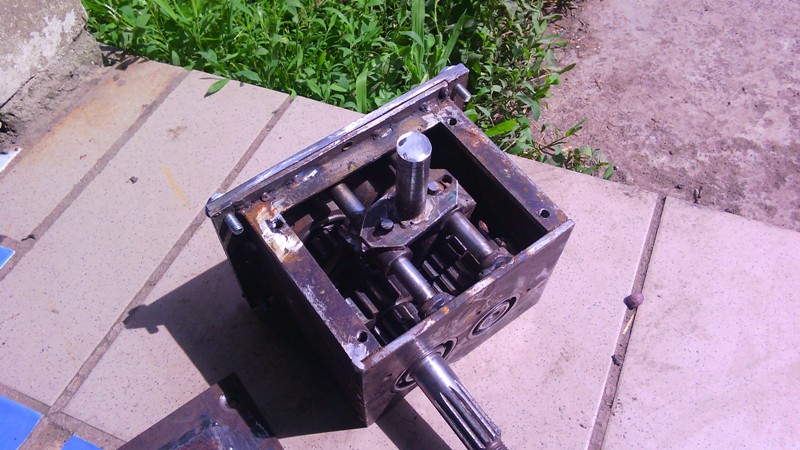

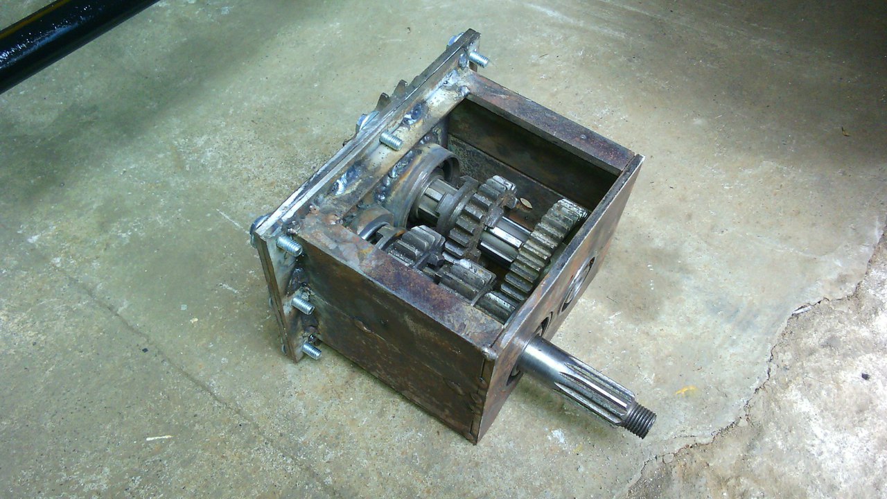

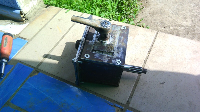

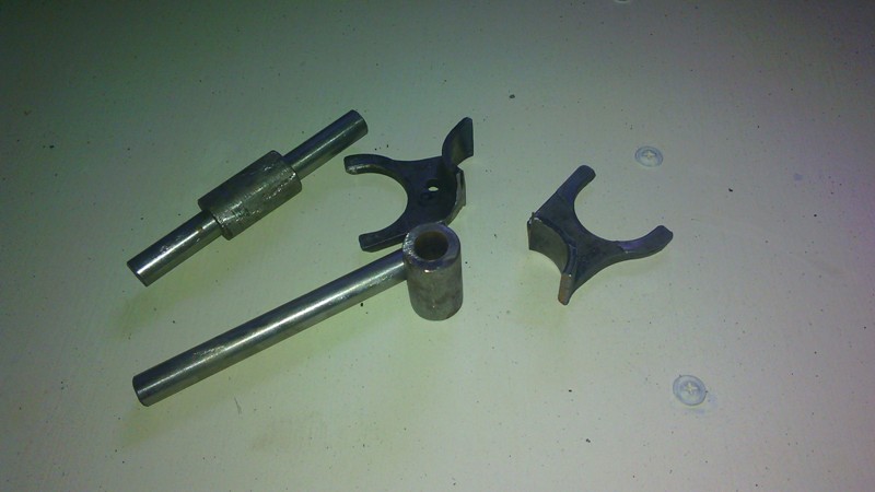

Homemade gearbox has 2 speeds, would be 2 speeds forward and 2 back.
/ Homemade Tracked mini dumper #8
That my friend is a great piece of machinery. The idea with using the tire for a track is a new one for me and a good idea.
Hope the rest of the project goes as good as what you have completed. I'll be watching and thanks for the ideas and pictures of your progress.
I need to find me a tire from an old logging skidder and make some tracks for my skidsteer. :thumbsup:
/ Homemade Tracked mini dumper #9
that is beautiful, well thought out. love your idea. is there a need to have adjustable tension on the tracks to keep them from rolling off?
The tire is an excellent material for making tracks, it is readily available and cheap. And pretty strong, in the rubber is steel wire rope, synthetic yarn.
#14
In the front wheels is screw for adjustable tension caterpillars. In order to not slipped caterpillar in future I set metal guide plate. Now the lack of free time, so the project was suspended. Later I will show to be a lot of photos and videos.

Great project. Nothing better then doing it yourself!!!! Are you going to add any rollers to the bottoms of your tracks to increase surface pressure?
How far are you from Kharkov? I have family there. What about Dnepropetrovsk? My brothers girlfriend lives there.
Thank. Later I will make 8 rollers, 4 pieces in the each tracks.
